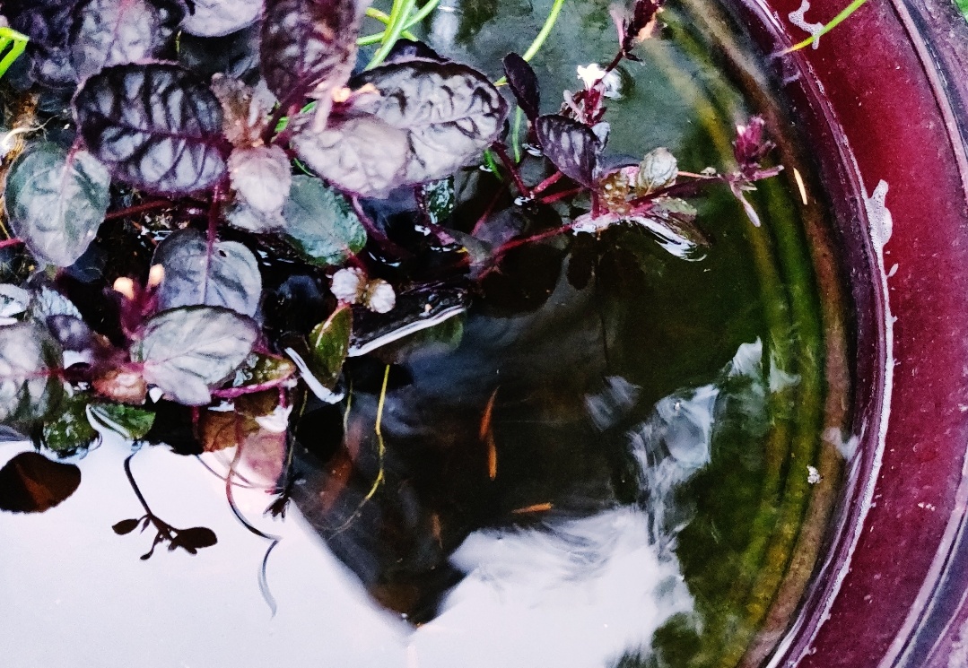

You're right, I just checked and the midnight soil temperature is 60Β°F/15.5Β°C which is what I was waiting for. Stocking will be White Cloud Mountain minnows and Variatus platies. I've kept the minnows for several years now and a few of the ones I'm putting out were hatched in my own tanks back in 2021. Have not yet tried the platies but I've had decent luck with other live-bearers.
I'd love to do goldfish again but they're relatively messy and I'd have to keep them in a bigger tank over the winter. (I do have a 40 gallon tank but it's already full of mollies, gouramis, and catfish who like the water too warm for goldfish... You're not kidding about them not liking it too warm!)

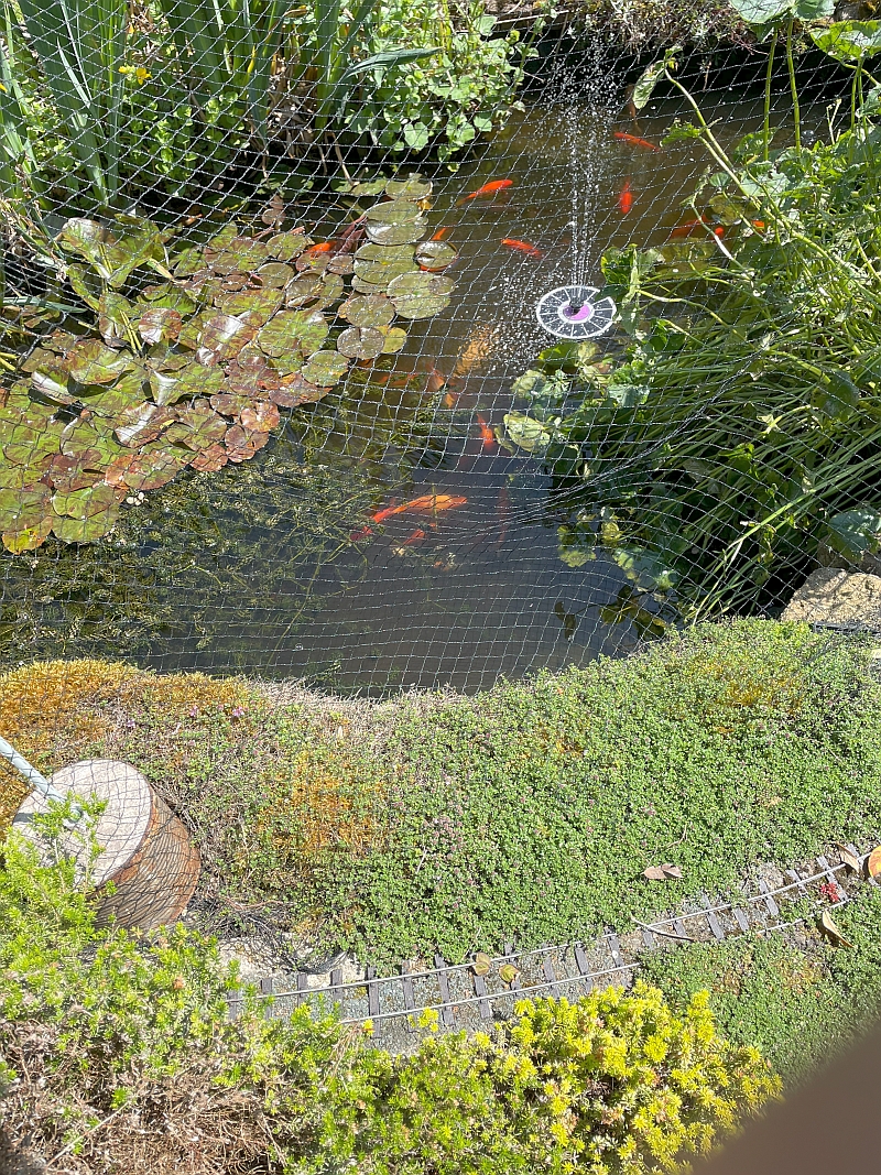

Same here, although the UV filter hasn't worked for a couple of years and doesn't seem to make any difference either way. :dontknow:
WE've only got goldfish, som eof which are black, and one Shubunkin who is blue and black and white - can just see him nearest the camera in the piccy. We've had him ( her?) for about 10 years.
...and Yes, the track maintenance gang are slacking, but they don't work when its raining, which it's done most of the time for ages.

Nice looking pond there Philip. How long have you had it now. because you have so much plants in the pond you probably don't need a UV light now hey. I really like your fish too. We have tried Shubunkins, but everyone died unfortunately, so Anne said "No more of them" she couldn't put up with the heartache of losing them, or me to be honest. Funny how you get attached to something that doesn't love you back...Although one of our Goldies now always comes to Anne only to get food of her, me..no chance.. :lol: :lol:

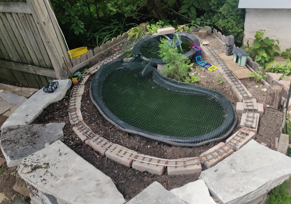

I bent the last piece of track and cut it to length on Friday, now we (theoretically) have the full phase 1 loop. The brave little diesel completed a few trips around in each direction but required assistance or rescue at most of the joints. With some tweaking at those joints and a few places along the track bed, and some ballast and fill, we should be running regular services in no time*!
*which is to say, probably by Christmas

Hi Drew,
It will soon be running with your locos and running stock. You have made tremendous progress in the short time for when you started.
Keep going and you will enjoy it and have fun, that's the main thing. :thumbright:

Thanks Rod, as always I appreciate the encouragement. I managed to get a few trains to stumble around the loop today with temporary rail joiners in place. It feels so much closer to completion now that I can see something running around on it!
I am starting to see some downsides of using secondhand tubular rails, namely that they have a tendency to twist when bending into curves, and they can be difficult to lay flat. I've had to trim the ends of most sections to remove mangled ends from old connecting pins, and even pried out a few connecting pins that had lodged inside the rail. The hidden costs of using cheap track I suppose :dontknow:
Then again it is allowing you to see what is possible, at minimal cost. Once you have it running properly it may spur you into upgrading, as and when.

That's exactly it, if I waited until I had saved up enough for solid rail I'd still be dreaming, and I'd probably never get around to it. My wife was skeptical of the trains until she saw them running outside, so phase 1 has already been very helpful as a proof of concept!
Here's a slightly longer video showing a full loop:
This little molehill of a garden layout does feel like a mountain sometimes, but it's certainly gratifying when it comes together!

Hi Drew. Nice to see your video clips .re your tube rail what is the diameter ? would it be possible to insert fence wire to enable you to bend the rail without it creasing ? Your fish pond is looking very good.

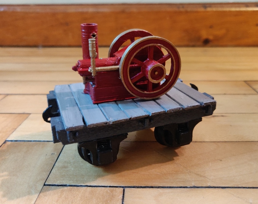

Dull month on the NVT as we've been traveling and busy with other (arguably) more important projects. I was playing around a bit with designing some new axle boxes and thought it might be fun to put actual springs into some of them...

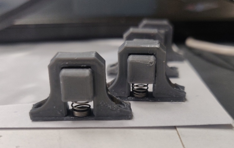

Still trying to find a load or wagon type that would visibly benefit from having sprung axle boxes, and given the apparent recent popularity of stationary engines I printed one from Thingiverse to try it out. It looks a bit too fresh from the factory so I'll need to hit it with a bit of wear and grime, and some tie-down straps as well.

Those axle boxes look neat Drew. Have you got an stl for them. Also the stationery engine is well printed and I like the colour too. :thumbright:

Thanks Rod! I was digging around for a long-neglected tube of green paint when I came across "engine red", so I thought why not? Four coats later and it's almost covered the primer! :lol:
When it's "finished" I can post the STLs, but for now here's the Tinkercad link: https://www.tinkercad.com/things/d5NPWH ... svF0sM5AO0
It's sized for 1/4 of the spring from a ballpoint pen, and a 1/8" axle. Should be able to resize the axle to suit whatever wheel sets you use, or maybe even a thin bushing. The bolt holes were meant to fit M2 screws... Due to some sticker shock at the hardware store I am using SAE #2 wood screws which stick out a little bit but are much cheaper here.

That stationary engine looks very good Drew, I may have to join the "Stationary Engine Club" myself. :lol: :lol:
I do like the sprung boxes. Have you done any load tests to see what they can cope with without bottoming?

Completely unscientific, but it seems to spring nicely with a 12oz can of soda loaded. Cursory research suggests that would be about ΒΎlb or 370g. No particular reason for choosing that unit of measurement... :mrgreen:
