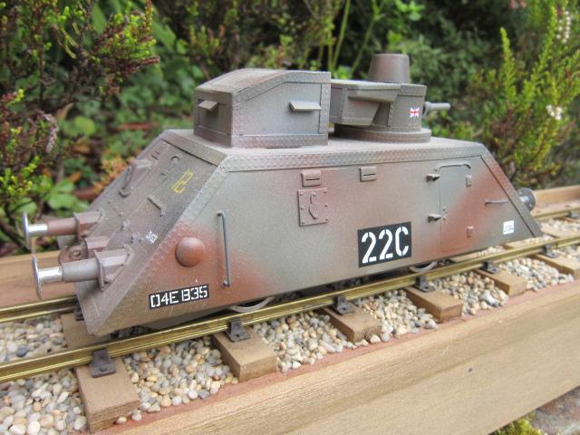

I have made some military vehicles on rails before. Here is one of them:

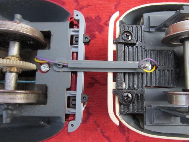

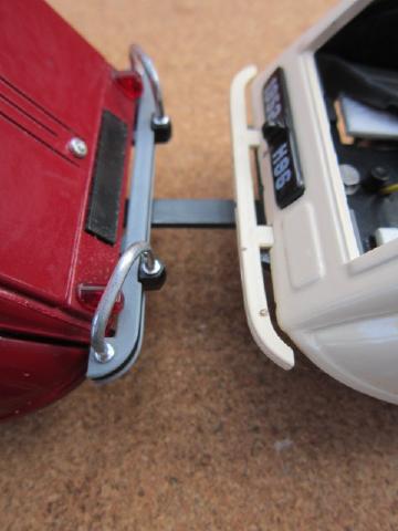

Back to the 'push-me-pull-you'..... As previously mentioned I needed to connect the two vehicles. This is done with a brass flat strip soldered to a square tube underneath the flat. The tube contains the wires and keeps them out of sight. The flat is drilled at either end and screwed/bolted to the chassis allowing the cars to flex .
Next..... switch and batteries (to follow)

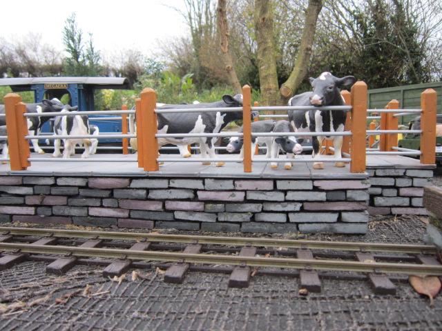

Cattle Dock time......

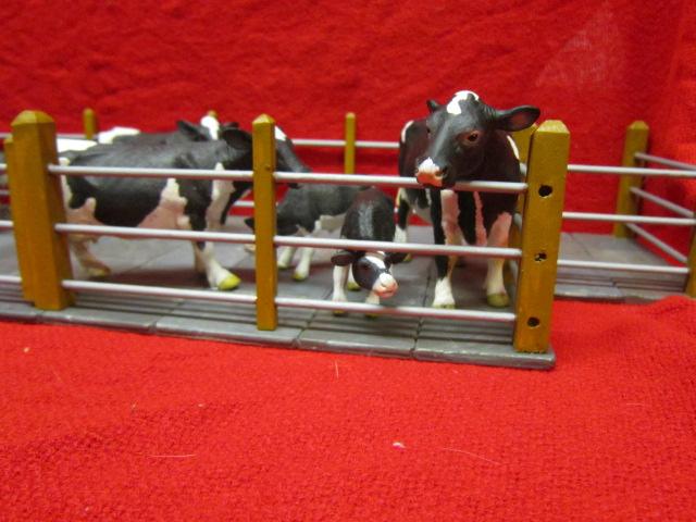

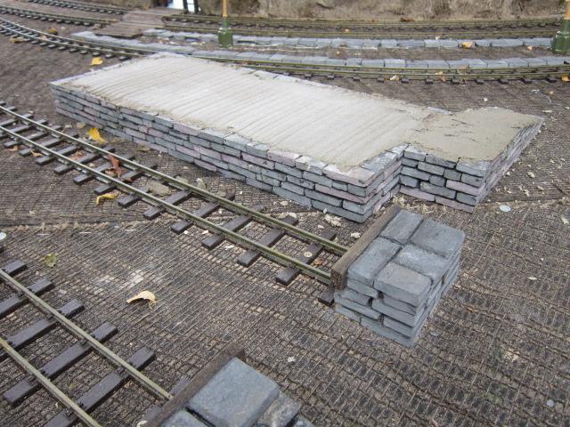

I have already explained how I made the slate base for the dock, now I have continued with the top and animals to fill it.
 I decided not to keep all of my scenic features outdoors.  I have room to store them in my 'Engine Shed' underneath the layout so anything which might be ruined by damp/frost etc. will be brought in.
The cattle dock falls into this category so the slate effect base is made from a large sheet of plasticard topped with small, random sized plasticard blocks with the edges scraped to show signs of wear, then painted with acrylic colours to give a slate effect.
A coat of varnish seals the paint.
The fencing is made from hardwood strips and steel rod.   Each post is drilled at the same height using a jig to ensure they are all the same.  The steel rod is then threaded through and superglued in place with smaller section timber posts representing gates.

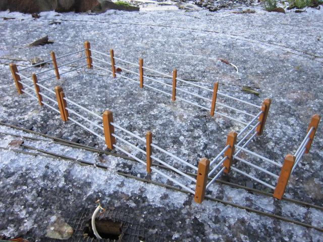

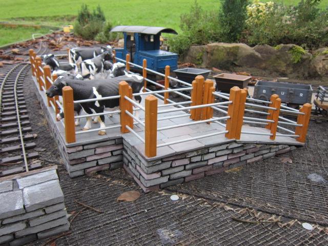

A site test to see if it looks ok and I'm happy with it so far.

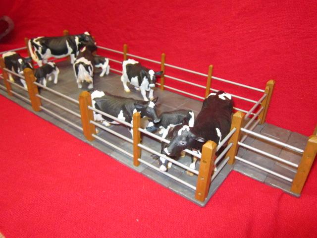

Finally my heard is permanently attached to the base with screws up into their feet.  (no animals were harmed during this process!)
I'm sorry it is on a red background as it looks like they are already in the abatoir.  Unfortunately it has been raining so heavily I couldn't get out to photograph the finished item on site.

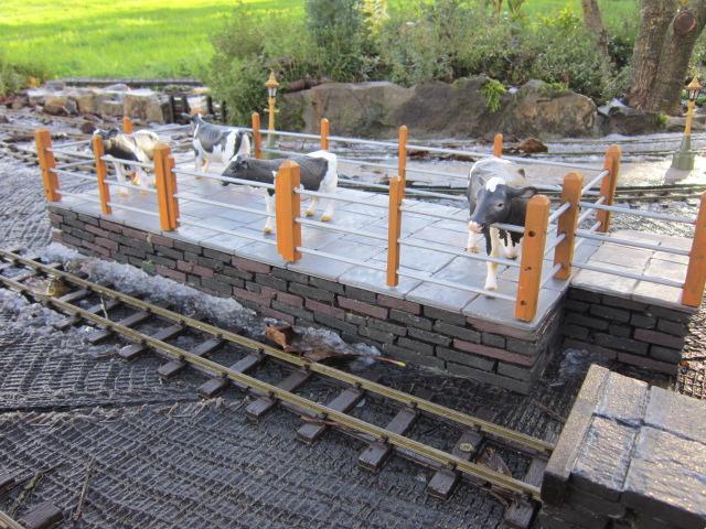

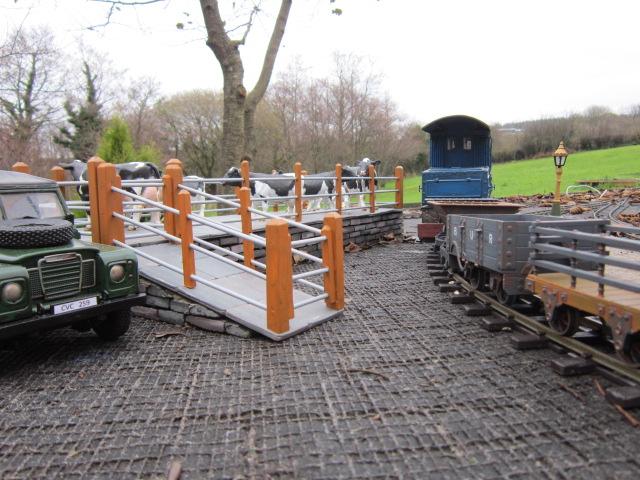

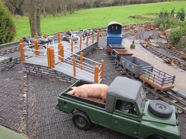

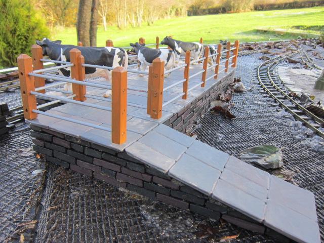

The cattle dock is complete......
Pictures show it on site with all ten cattle and calves installed, ramp attached and all fencing and gates in place. It's not designed to stay out and just lifts off when I'm finished.

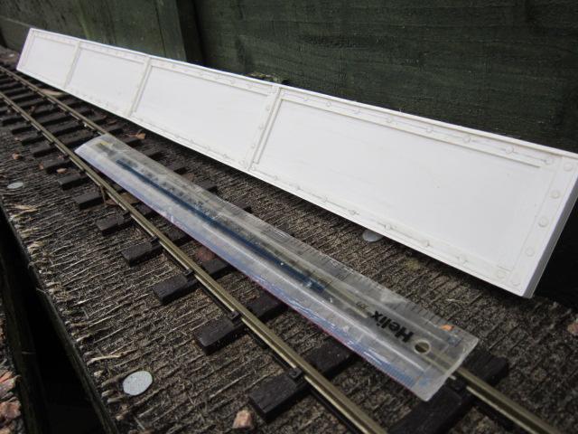

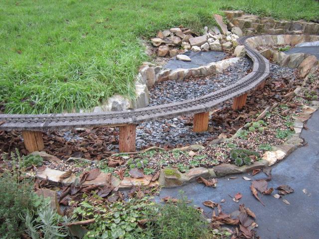

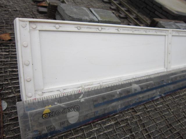

The viaduct needs side girders which will be made of plasticard with frames and plastic rivets. I have promised myself this will be a winter project and finished by next season.   Only 14 sections to make, each a different size as it is on a curve!

Peter Butler:92249 wrote:The viaduct needs side girders which will be made of plasticard with frames and plastic rivets. I have promised myself this will be a winter project and finished by next season.   Only 14 sections to make, each a different size as it is on a curve!
Oooh, keep us posted on that one... I need to build a bridge (possibly this winter) and was thinking of a very similar technique. My plan was to add a plasticard shell around a ply interior for strength, but I'm wary of using the wrong glue and then watching the whole thing fall to bits. Could use little pins instead of some plastic rivets I suppose, that might help keep the plastic and wood bits joined together......

My sides will be made of 2mm plasticard which is cut into strips from large sheets in one piece. Added to this are narrow strenghening pieces and framework to give the impression of panels. Rivets made from punched plasticard are stuck onto the frames.
There is such strength in this that I will not be using any other material. Certainly not plywood as it is sure to swell and delaminate in the wet.
The unknown factor is how it will hold up against UV from sunlight? I'm hoping that a good plastic primer and top coat will protect it from this.
The viaduct is on a curve but each section has straight sides so no bending will be needed.
Post by Andrew » Wed Nov 27, 2013 11:10 am
Thanks Peter, very helpful - I shall draw appropriate inspiration. Or, more likely, just blatently copy you! I guess the glue you use is the stuff you mention further up-thread?
