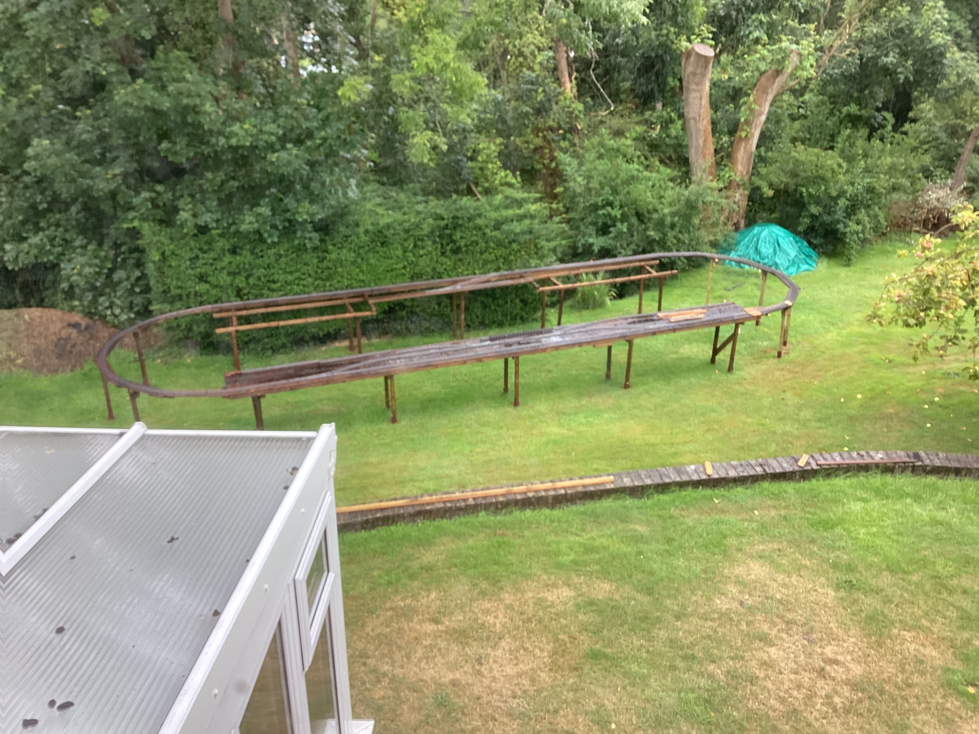

After a dry start to the morning during which I managed to do a little soldering outside to fix the last 30cm or so of track into place in the oval the rain began so outdoor play was suspended.

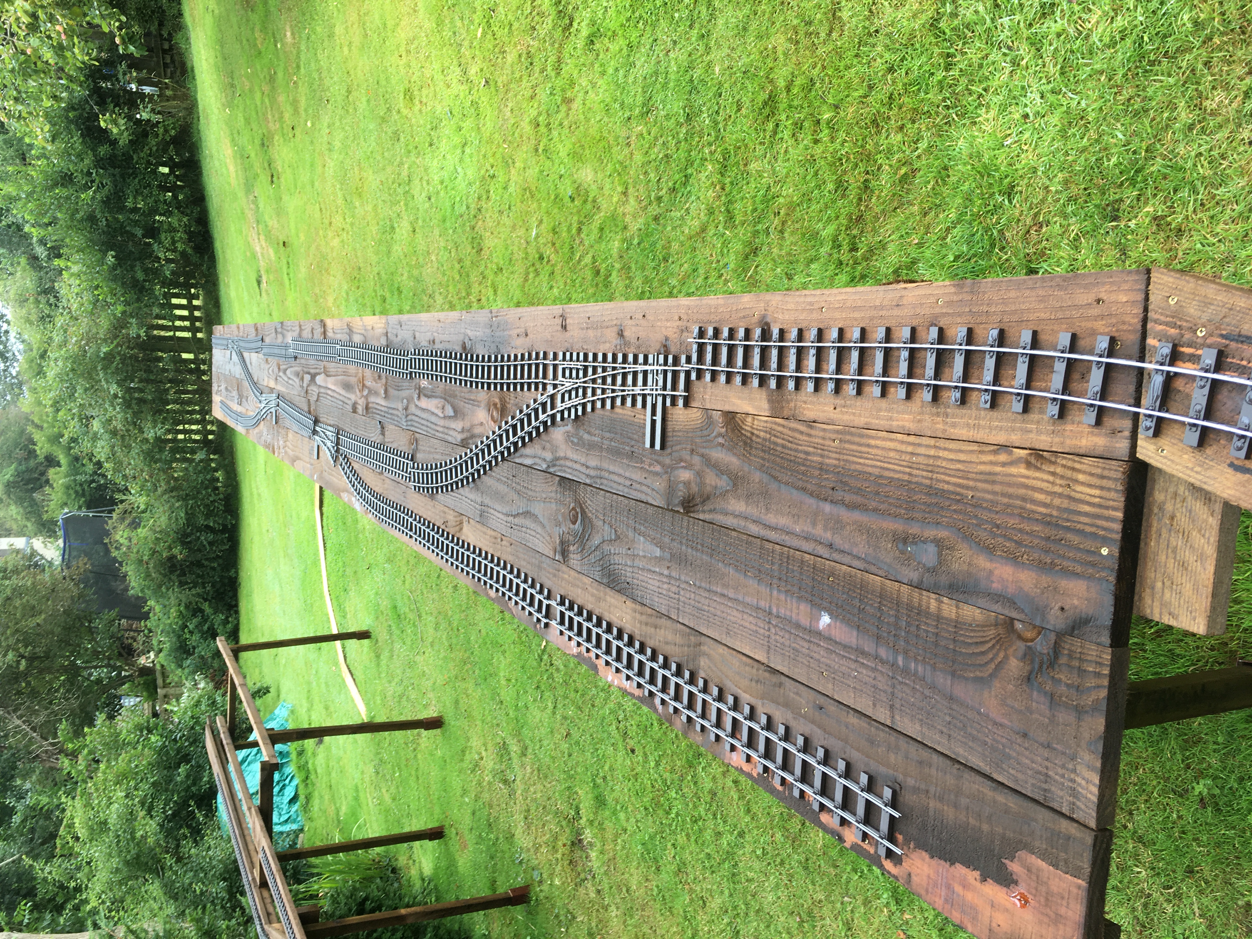

The two ends were lifted up onto legs about ten days apart, the second appearing last Thursday. Once I had assembled nearly all of the track a loose lay on the table got a tentative layout:-
At the far end of the table I have made a lifting flap for access into the centre:-

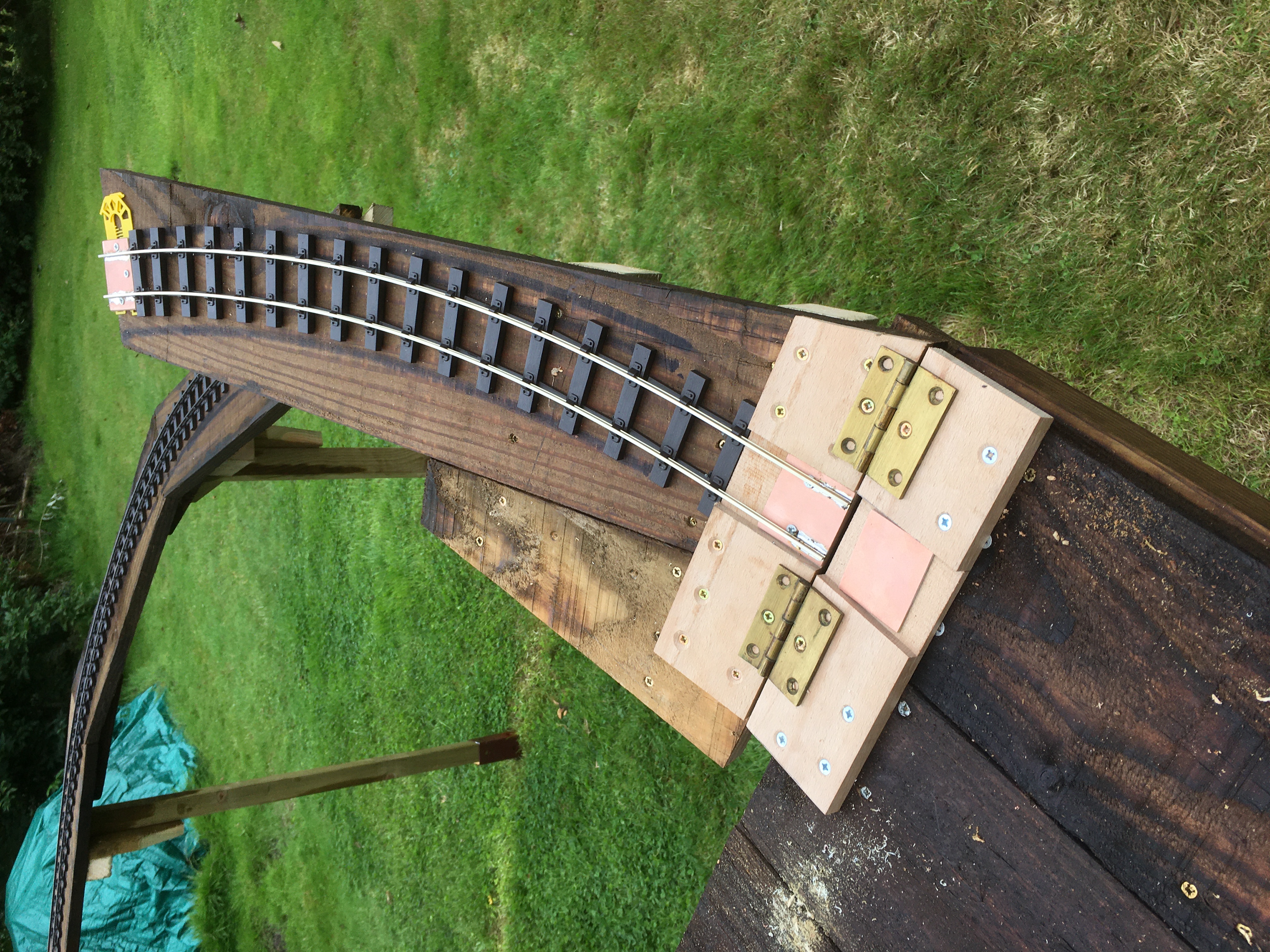

This shows it lifted. For this short section I have used nickel silver rail (the rest is stainless steel) since it is easy to solder to copper clad circuit board at the joins. The piece I soldered this morning meets the flap at the end of the table. There will also be two short pieces of NS track where the scenic boards are attached. The track was pinned down on the table yesterday and Clara had a trial run around the oval, bar the gap. All was well apart from one of the rails joints on the left hand end semi-circle had split - I had too much strain on the Bayblend rail joiners from Cliff I am using - it's a learning curve and I may need to go to metal joiners round the curves.
- Posts: 5671
A brave move building a lift section on a curve, although I can see you had little option elsewhere.
- Posts: 1128
One of these might help, if alignment becomes a problem.Peter Butler wrote: βSun Jul 30, 2023 2:40 pm A brave move building a lift section on a curve, although I can see you had little option elsewhere.

I have a selection of brass bolts ready to fit if necessary, I added more screws to the hinges which changed the alignment slightly which I can probably deal with by resoldering at the board joint. Itβs a case of letting it settle down before major alteration.

The straight table is 7.2m or close to 24β long and the radius of the ends is a little under 5β.

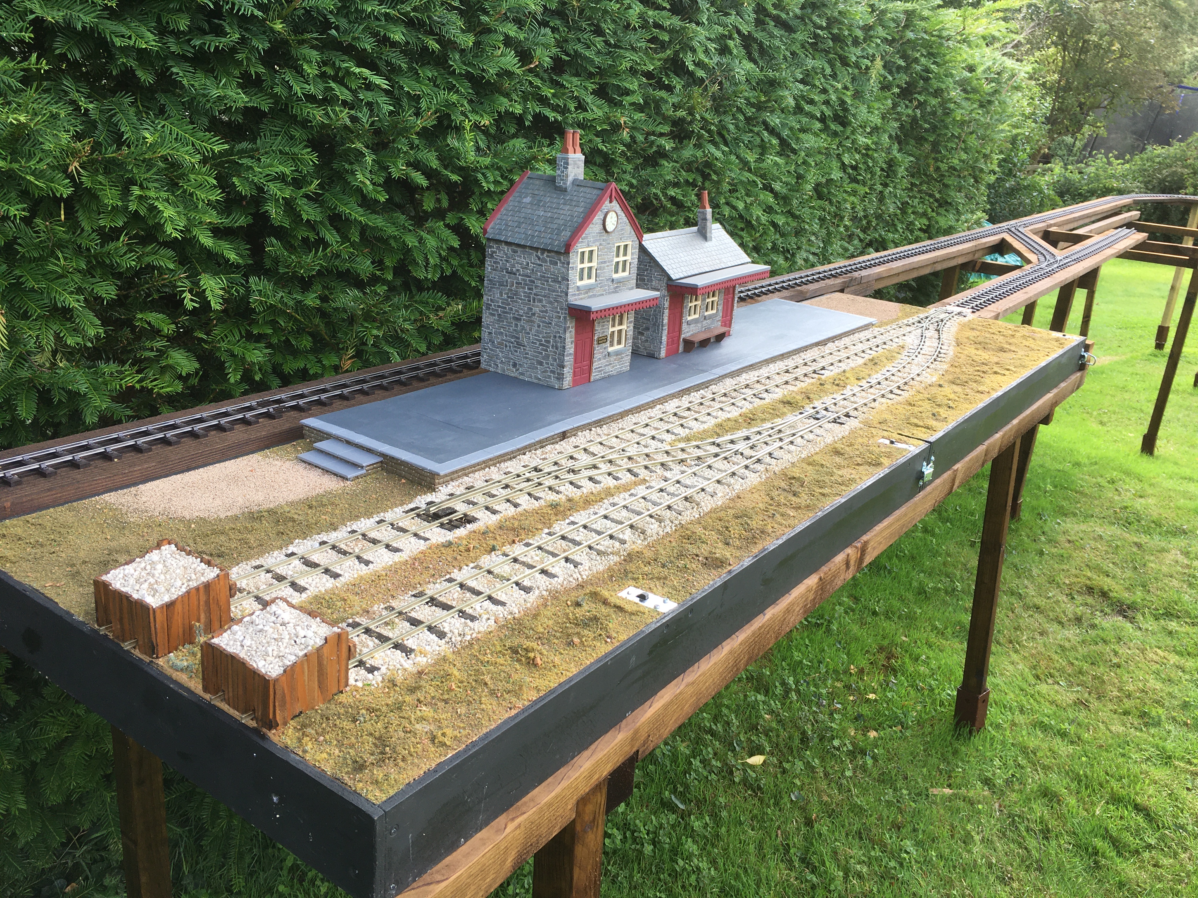

There has been a dry afternoon during which I have re-aligned the joint of the lifting section, completed the loop and added a short bit of track to allow coupling up of the Orsaf Newydd boards.
Clara has done a complete circuit starting from the station, and a second one, three quarters of which I captured on video before she ran out of battery!

Wow you do work fast Phil, that station is looking brilliant and the two sidings work well with the main line for the station.
Nearly 58' overall running, plus the track you are having inside the main loop, I think you are having track inside looking at your plan, is a nice line to run loco's on.

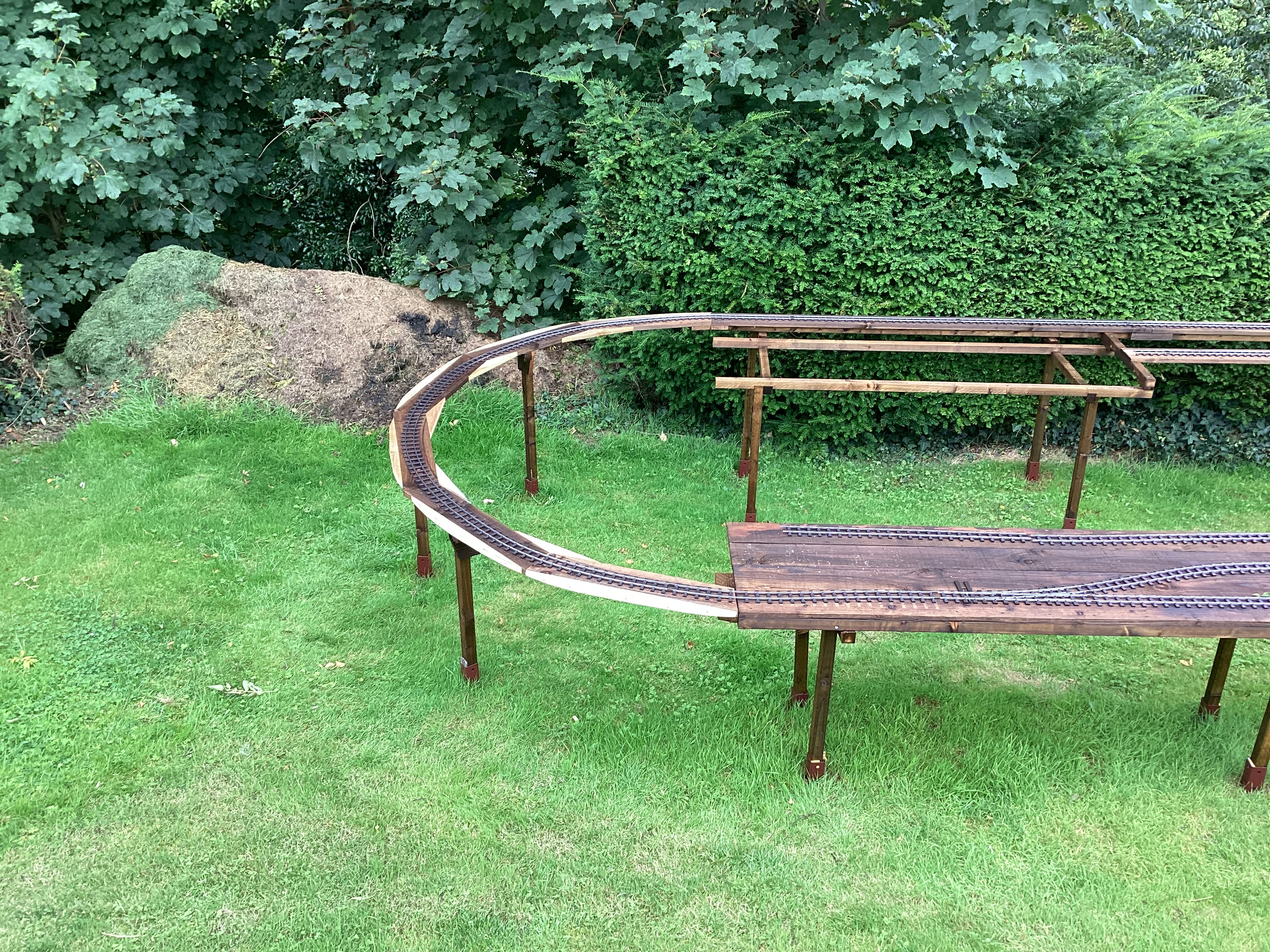

Working towards being able to fence the line I have been adding bits of wood to extend the width of the boards of the curved ends where the track gets perilously close to the edge.
The first photo shows the raw pieces added:-

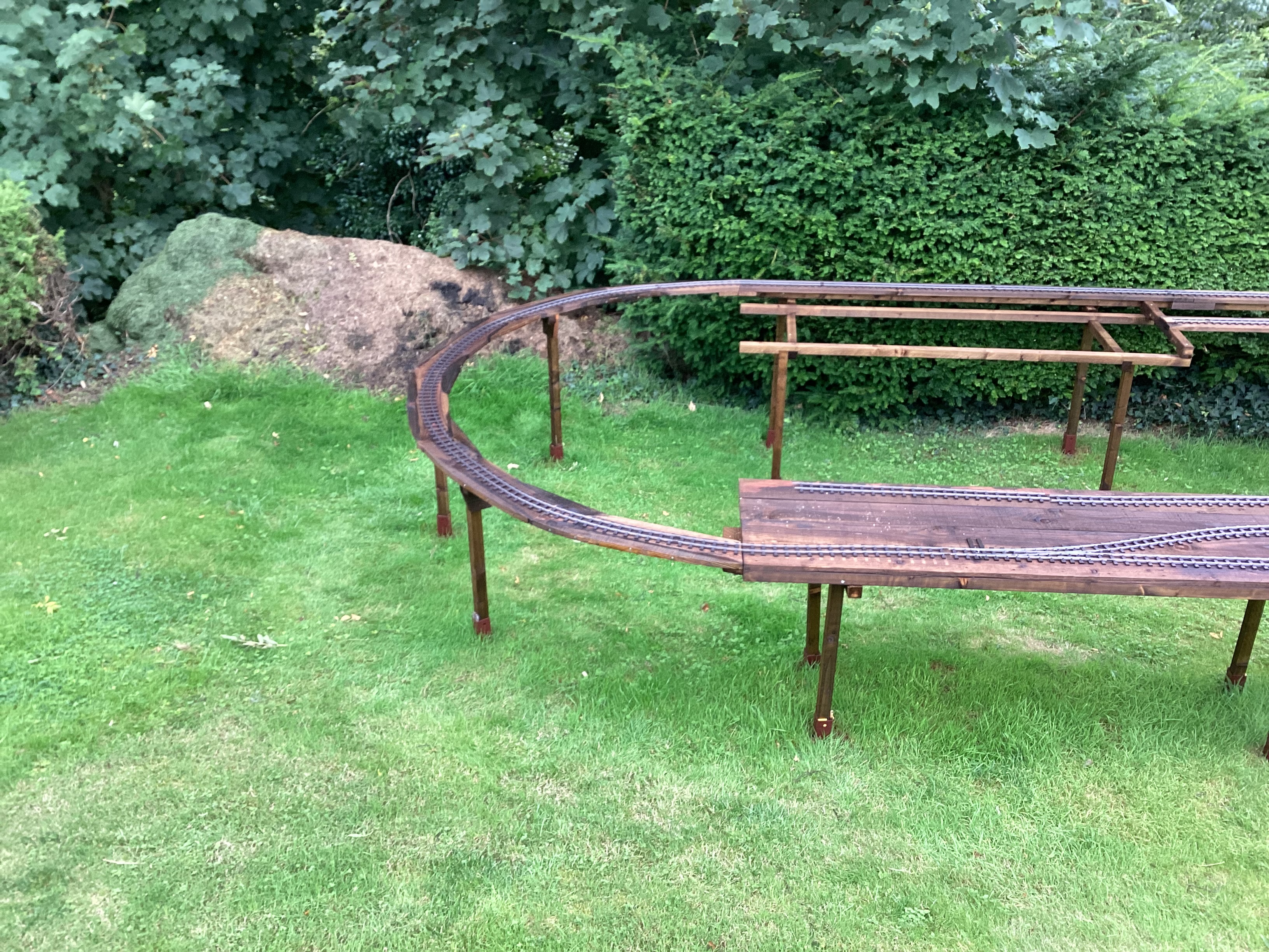

The second after adding a coat of creosote, the extensions blend in much more:-
I have been preparing 12mm square section beech to make the posts. I shall drill the posts to accept galvanised wire once I have cut them to length. There may be quite a lot of them to do! I intend to screw the posts to the outside edge of the boards. Will see if it works.

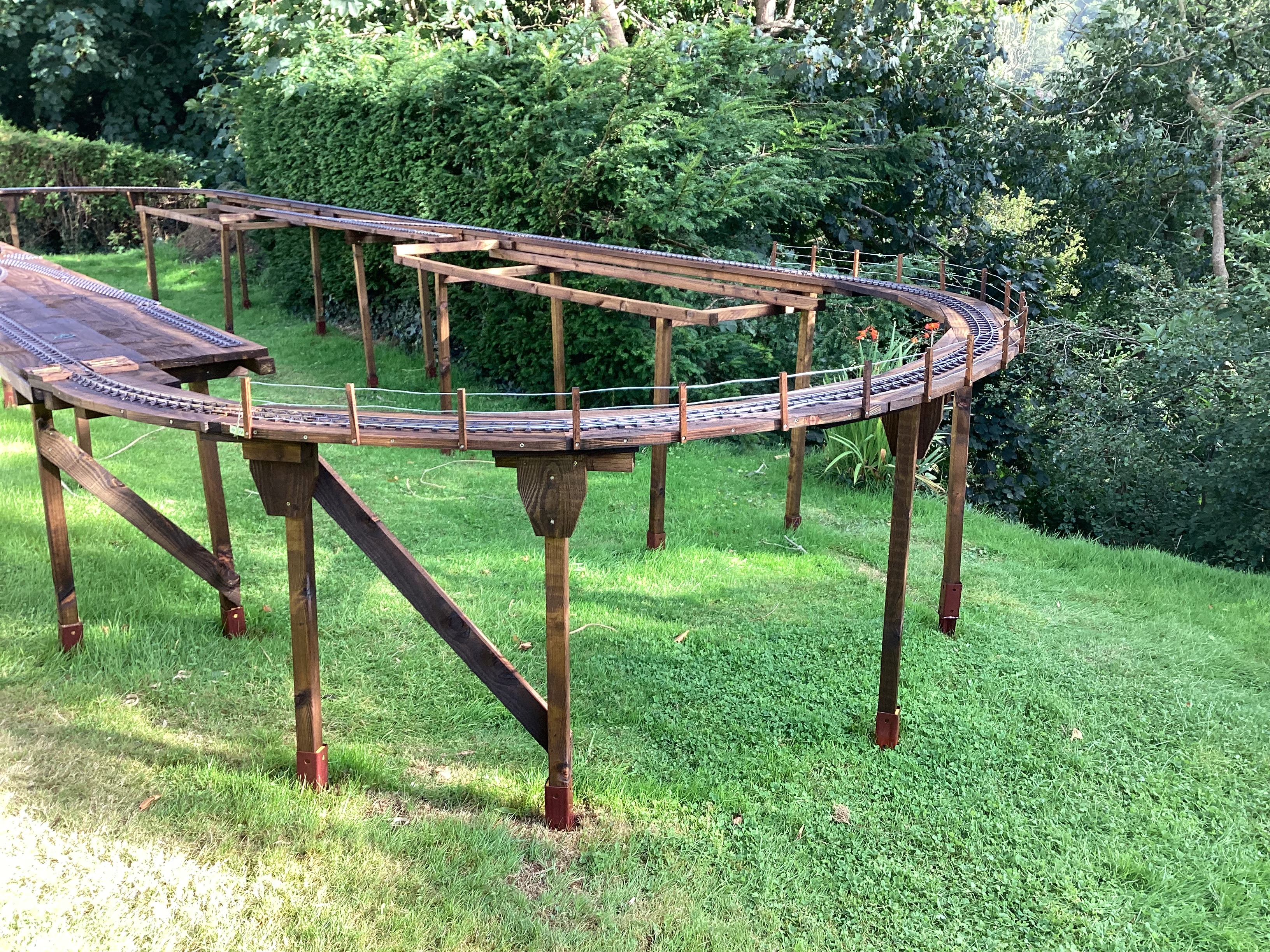

This should work:-
The posts were cut to length in groups of eight using an end stop on the radial arm saw then drilled with four holes each using a jig clamped to the table of the pillar drill, a total of 87 were prepared. They were dropped into a bucket with some creosote and then drained and left to dry a bit.
- Posts: 5671
Looking good Phil... we can do speed trials now on your Wall of Death!
