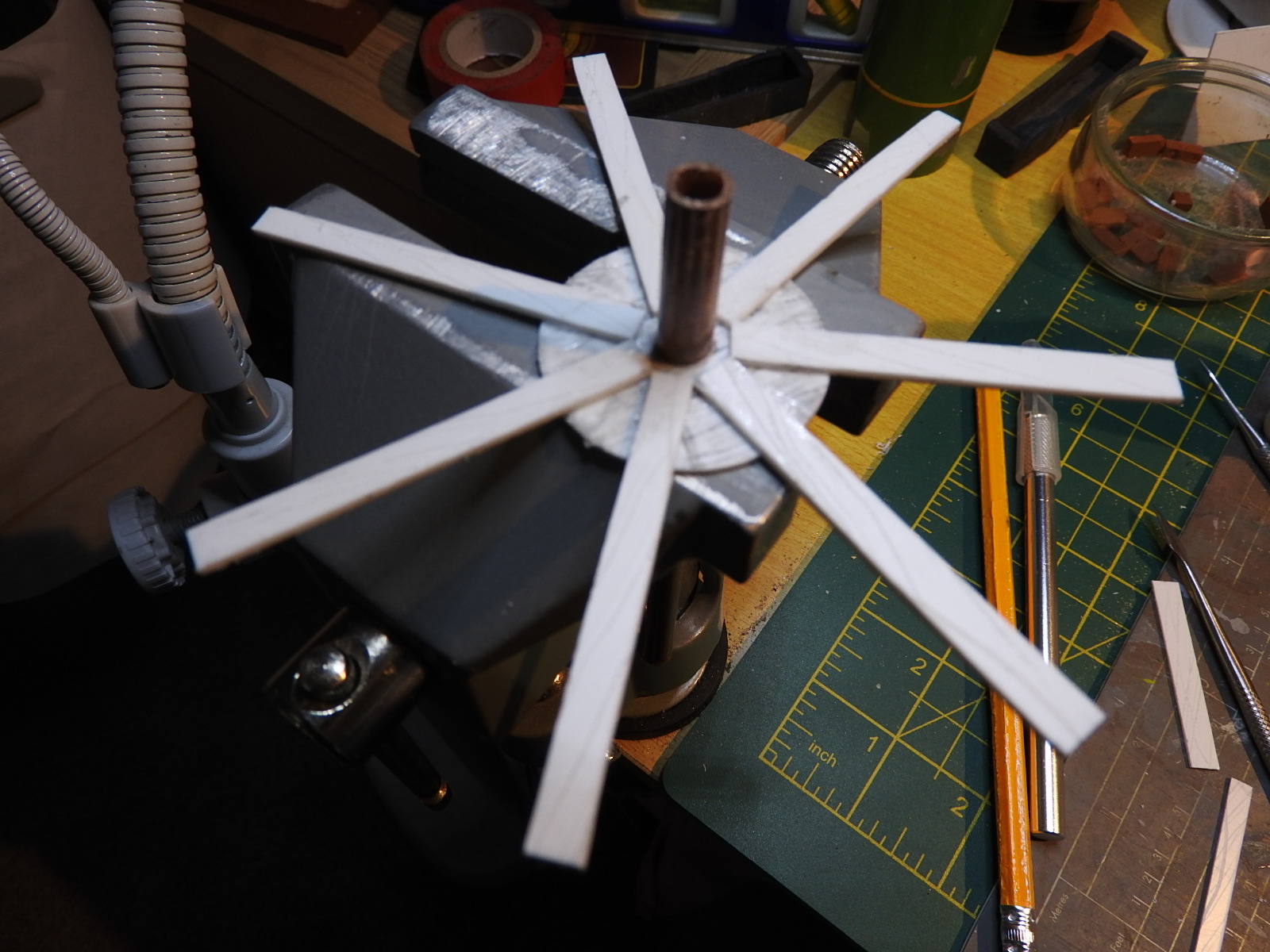

Then the wheel. I tried to cut a perfect circle out of Plasticard, but it was impossible for me. So I asked Nicki from SLR Models if she could make me two circles, she duly obliged. I put the inserts in the two parts with 1mm Plasticard on the inside and the paddles from 3mm card.
Next was to cut two circles out of HIP for the braces for the wheel. I put two pieces of HIP's together and cut them out. It was a fairly easy job with the help of a circle cutter.
Next I cut thin strips of card and fixed them to the small circles. And fixed one to one side of the bigger circles.
For the other one for some reason I just can't remember it's been that long
, it may come to at some point, I fixed the other strips to the other smaller circle whilst holding the part level and straight with some plastic tube and copper tube
The finished and painted wheel.

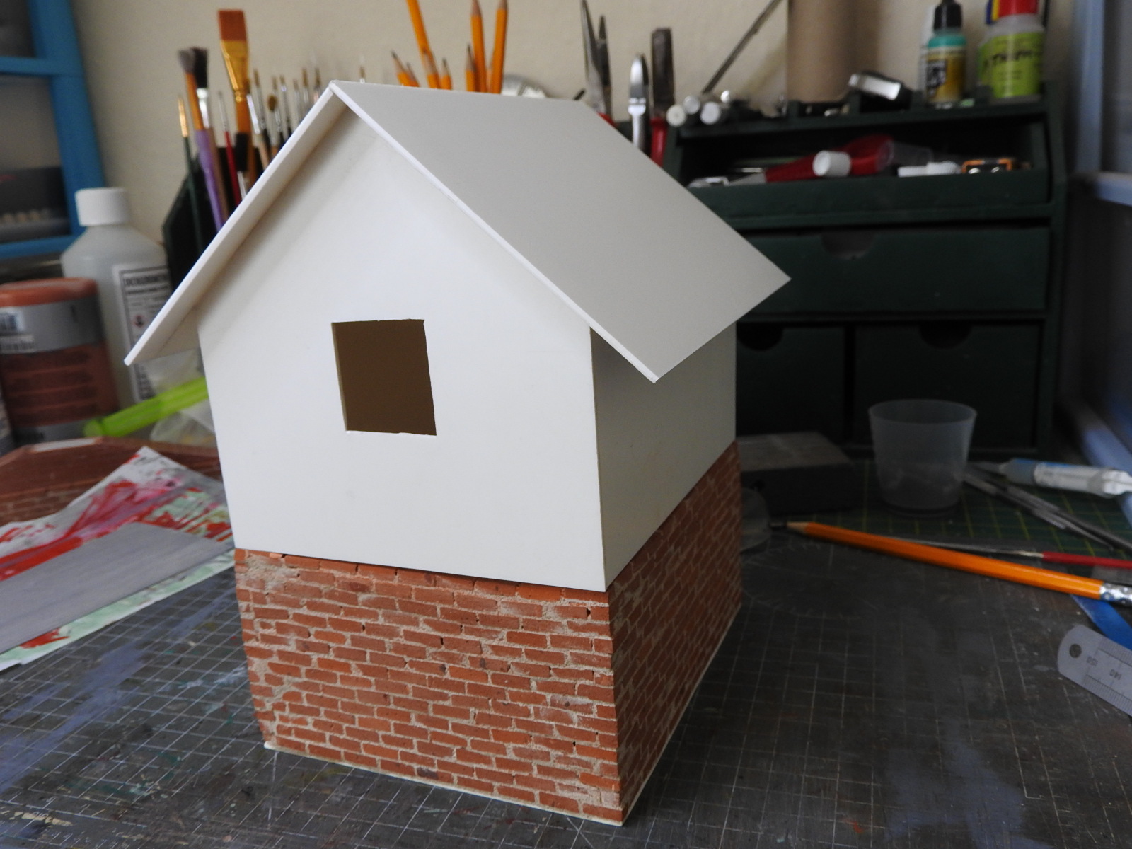

Next I wanted to make the walls of the watermill more realistic by building them with small real bricks. I have done a smaller wall on my water tower if you remember. So off I went with four bigger walls...
Has you can see, even using smaller bricks haven't improved my brick building skills....
But after I put a emery block over them, they turned out somewhat ok..
The reason for using a Plasticard box is to keep the bricks fairly straight has I built up the course's and for added strength, without the box shape the bricks would just not hold up to any handling what so ever.

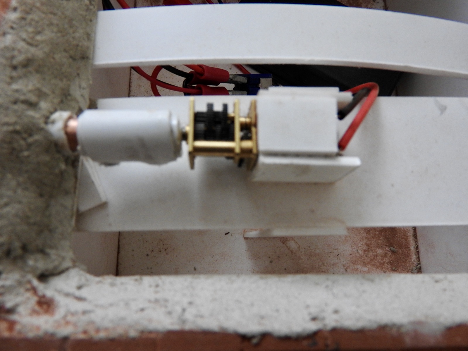

I added a small 12v reduced gearbox, they run about 10 to 15 rpm. I wanted the watermill to turn, so it was decided to fit one.

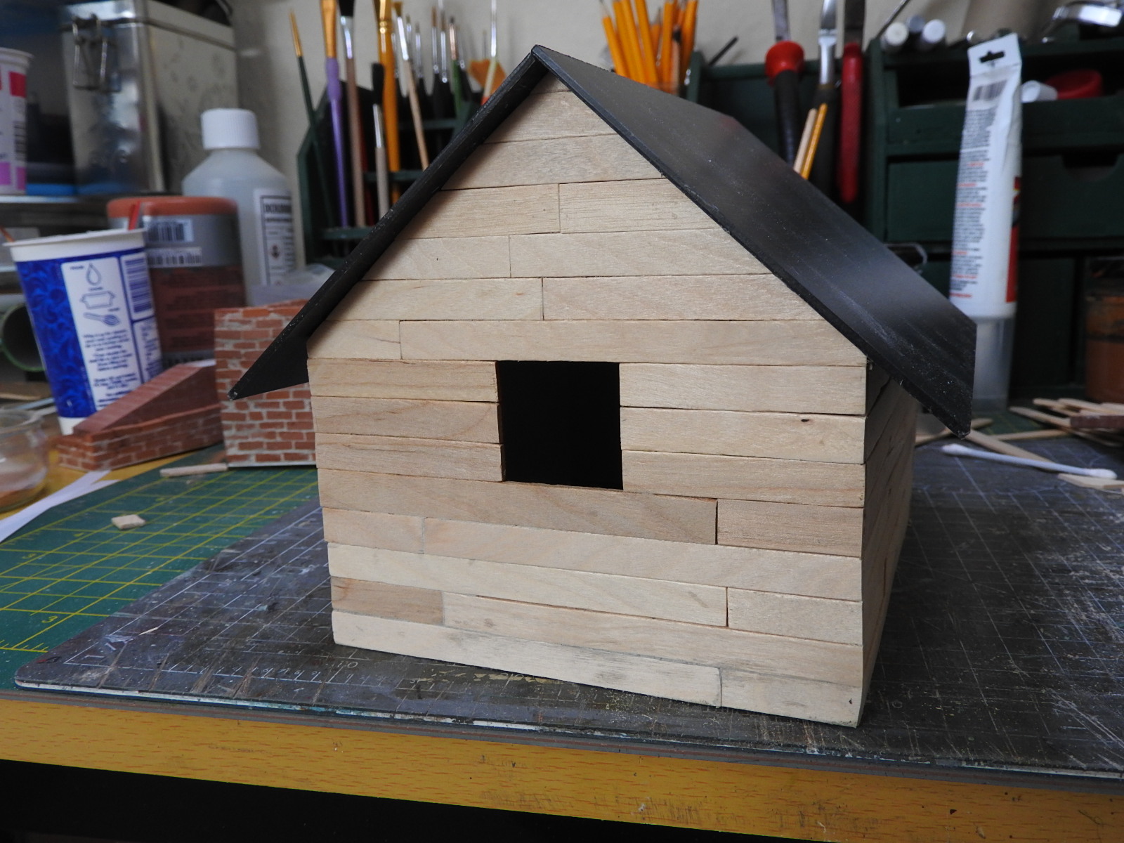

Here is the rest of the build. Unfortunately my laptop had an update and I have "lost" about 200 photos from my folder including about 10 on the start of the top of the watermill. I say lost, they have got jumbled up over 12000 photos in the folder and I just don't want to take the time to look for them, it's far to tiring.......
Anyway these will show you the basic building that most of us do.
Next was to cut to length those coffee stirrers I have loads of for the boards on the building. I have a jig of sorts that I can set to cut the rounded ends of the stirrers so they get to be square. Believe me when you have cut a few dozen of them your eyes go funny....

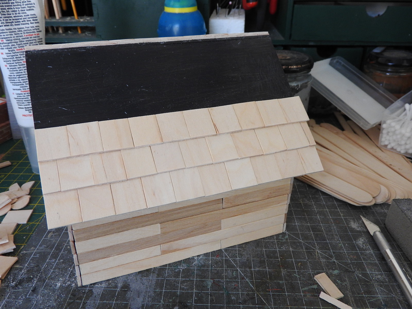

Next came the roof tiles. Now they were a nightmare......
The curved tiles were the off cuts from the stirrers for the roof tiles. I did need to cut a few more because some were just not up for the job..
One side done.

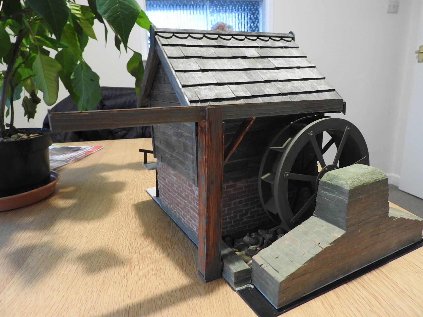

Still I do have the finished build so you can see for yourselves what I did for the weathering and the water chute fixed to the building. It is able to come off with the building so I can get to the switch to turn the wheel on.
The finished build with the steps.
And the rest of the build with the brick support pillar for the wheel and the water chute.
I need to put some more stones around the pillar to finish it off.
I hope you like my take on a Watermill. It as been a labour of love and taken me a very long time, but hopefully when I can get it out onto the line it will look like it's been there for some time.
One side done.

That is a brilliant job Rod, the weathering colours are just right and the speed of the wheel is perfect, you should feel well proud of that.
- Posts: 7965
Re: NEW FWLR LINE
Excellent work, Rod. I especially like the way you've done the brickwork. Very realistic!

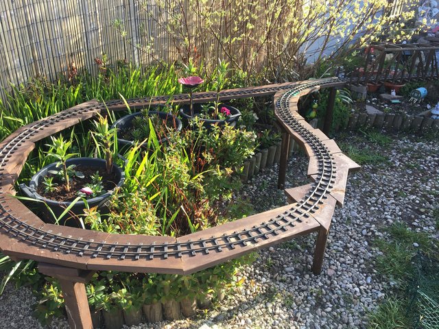

Re: NEW FWLR LINE
It's been some time since I posted about something on our line, mainly because I got myself a 3D printer has a Christmas present for me...
And getting some work done on the line was put on hold because of it. That wasn't the only reason though, I have had a bad start to 2021 with health and other issues, like my youngest daughter having her own crisis. But hopefully most of it is a thing of the past.
Anyway here are a few photos for you.

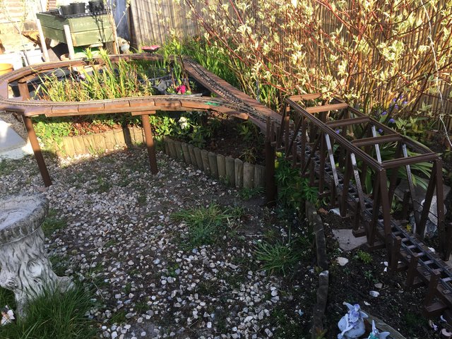

This is the line going from the raised bed over the waterfall. It was a bit tricky because Anne needs to get to her Fairy Garden because the fairies are really lazy and it gets overgrown very quickly.
The bridge is easily took off so Anne can get to the garden.
The rest of the line is now finished, although there still needs some tiding up of the boards....
They do look ugly.........

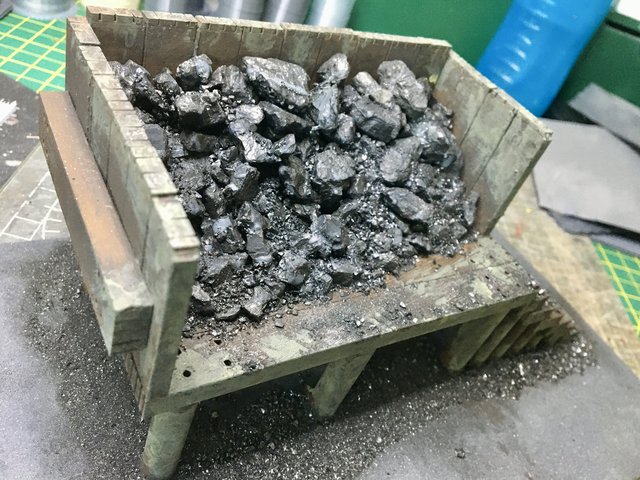

On the 3D printing side of things, I have managed to make something finally for the line. The previous things I have done were for family, like the usual stuff that seem useless to us but for them are brilliant things.
I am digressing, I have tried to print some chassis but getting them to look alright and to fit the axles is proving a little bit of a pain for me.

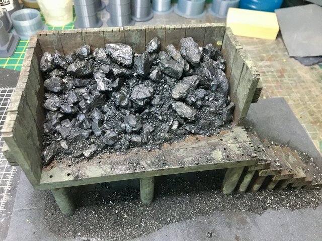

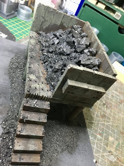

Anyway this is what I have managed to do It has taken about 10 hours to print off the individual sleepers.
The steps I managed to print completely.

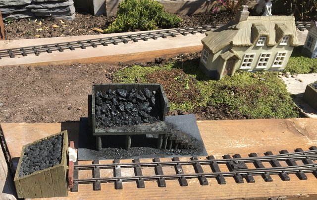

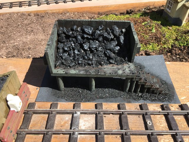

I need to finish the weathering yet, it does look rubbish. I have used real coal and crushed, bashed the bits of coal, that helped me immensely with some problems I have had....
This is were I intend to place the coal stage on our line. It's were the locos will come too when I get the shed made for it.
Hopefully we can start to run some trains this year now, unless other things get in the way.....

- Posts: 7965
Re: NEW FWLR LINE
Looking good, Rod. I hope your daughter is over the worst.

I think the coal staithe looks really good Rod - suitably weathered I would have said

The coaling stage looks great! I wouldn't change much on the weathering either, it looks rather good as it is to me.

Nice work Rod, I really like the coaling stage, you have worked wonders with your printer, I wouldn't have a clue.
