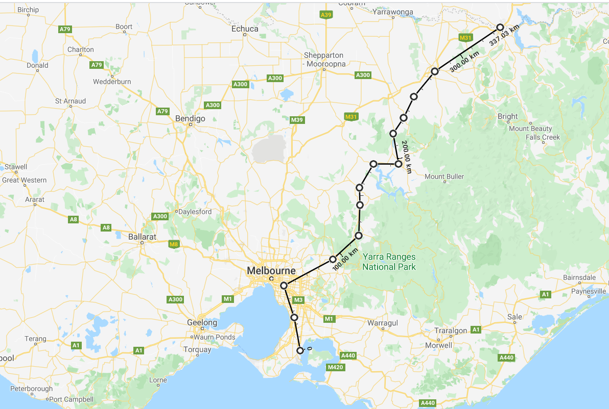

Hastings is the NEVR's only real access to a port (Melbourne was already too congested for port access by the time the system had grown large enough to warrant it) Hastings will eventually get a two track saw tooth workshop, an island platform, electrification along the back road a proper two story signal box and a long corrugated iron wharf shed that will hide the rear mainline and cover 1 road in the dock.
NEVR map.PNG (457.06 KiB) Viewed 16021 times
The NEVR System. Hastings is at the very bottom in the bay with the Island in it. In the real world its home to Esso and Bluescope Steel (BHP) who both have plants there.

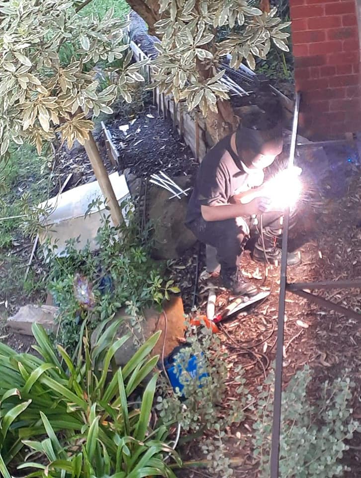

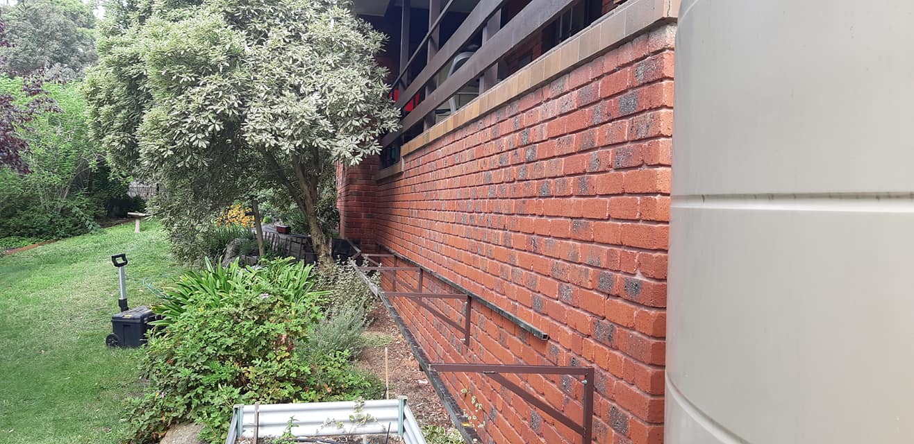

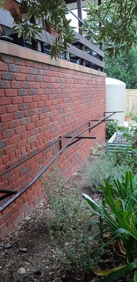

A relative works in a tool store and when they moved their shelving went in the bin. With some welding and cutting I was able to make all the framing for nothing from their scrap.
Yours truly manning the electric glue stick.
Rolling the outer bar over after welding to make sure the whole things painted

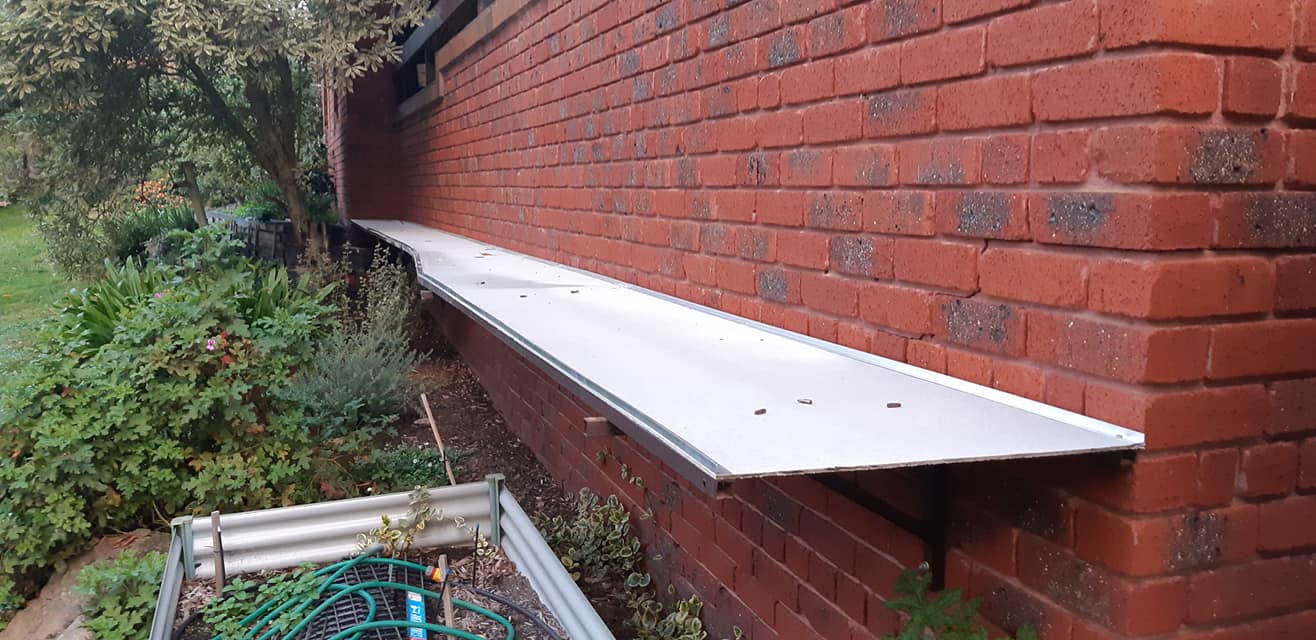

test fit of the board tops. The boards are made from Cement sheeting from bunnings with drain holes drilled into it. Its not what its designed for but ive seen it used successfully before and worst comes to worst the whole thing is removable.

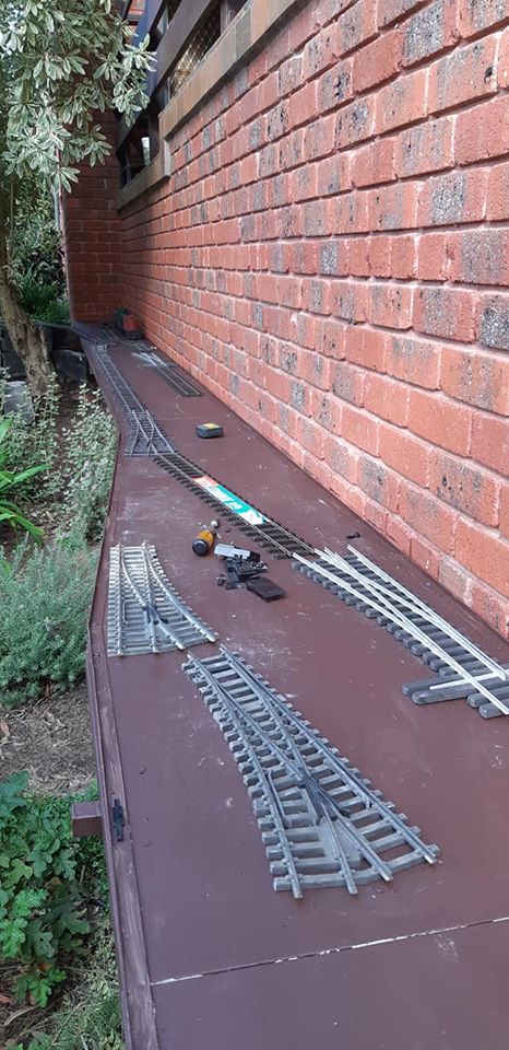

Pt.2
Baseboards finished. the Aluminium angle is to help retain the concrete in the dock area and in other areas it'll retain a thin spreading of ballast. all areas that arent going to be concreted are code 250 to help with photography

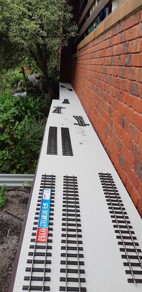

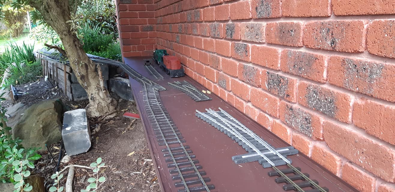

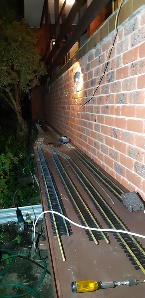

Test fitting track and measuring out the loco roads. each shed road will fit 2 bachmann big haulers or one Garratt if i ever get around to building an ASG

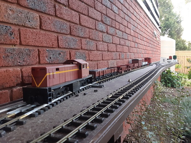

The down area of the yard.

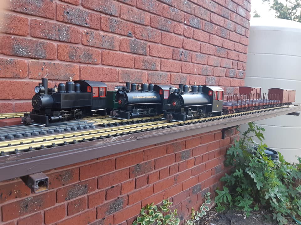

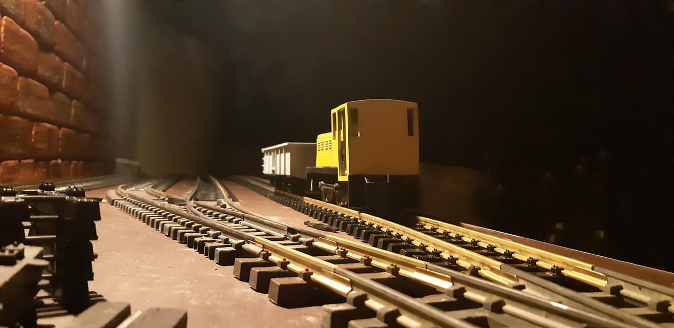

Tracklaying finished at around 10pm but i still got the MM out and some wagons and had a shunt using a lead light!
MM with the ON ore wagon

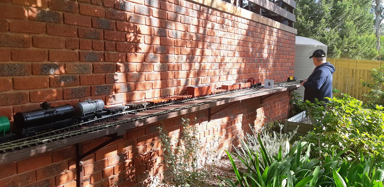

My father and I gave it some testing the next day and even though its still missing the engine roads (I ran out of track and rail joiners) you can still keep two people busy here shuffling wagons with no problems. The railway was designed to run on a timetable with designated shunters at certain stations and staff working so now this stations finished it wont be long before we can have our first session.

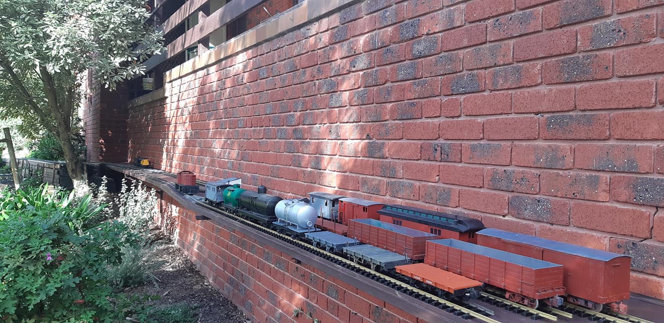

full house, Showing off the formidable storage capacity of the yard.

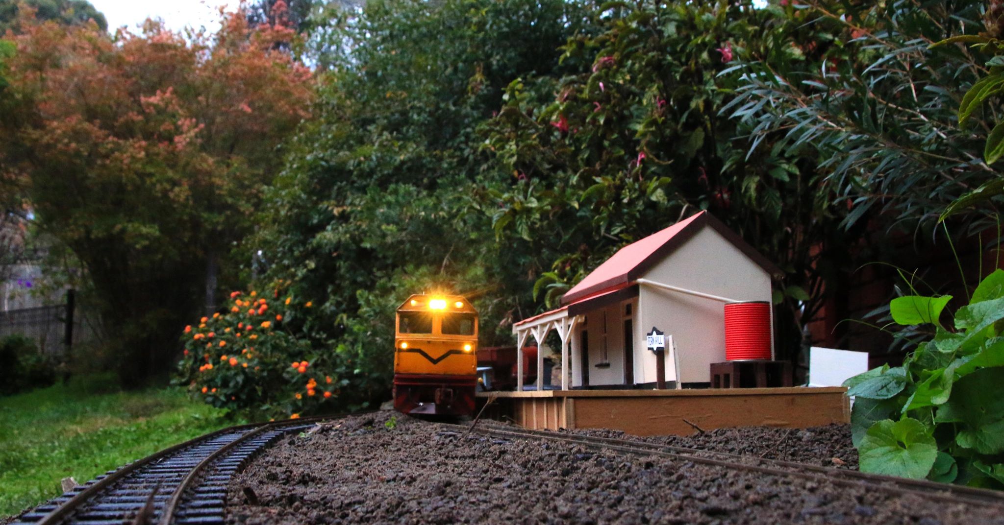

Last week the yard had its first visitor, heres a quick teaser for next time...

That diesel with the lights on looks amazing.

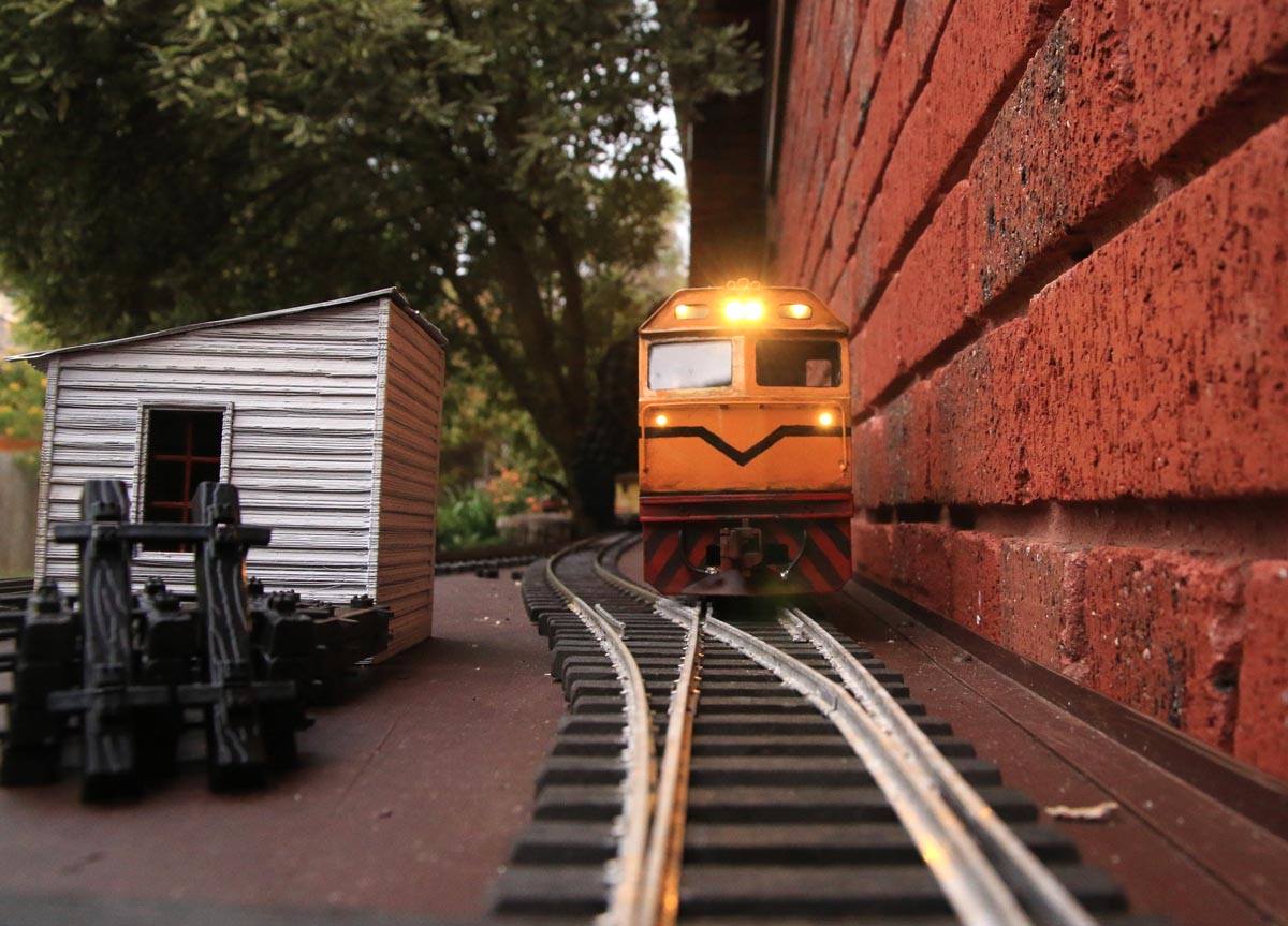

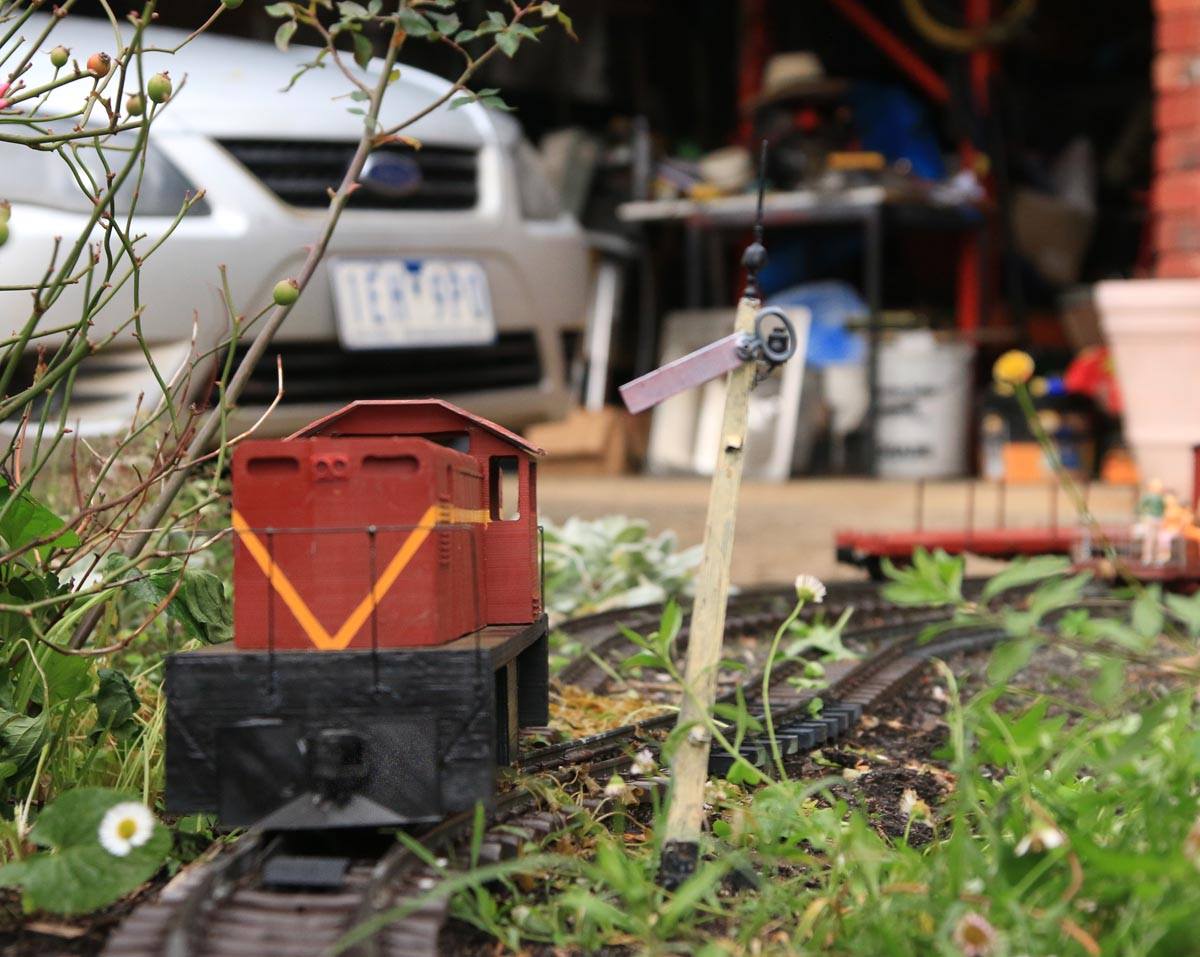

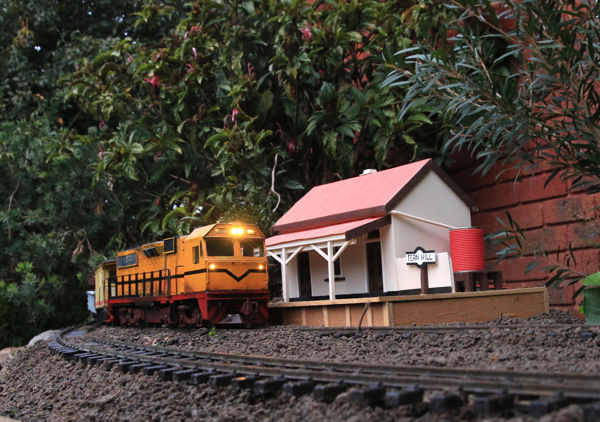

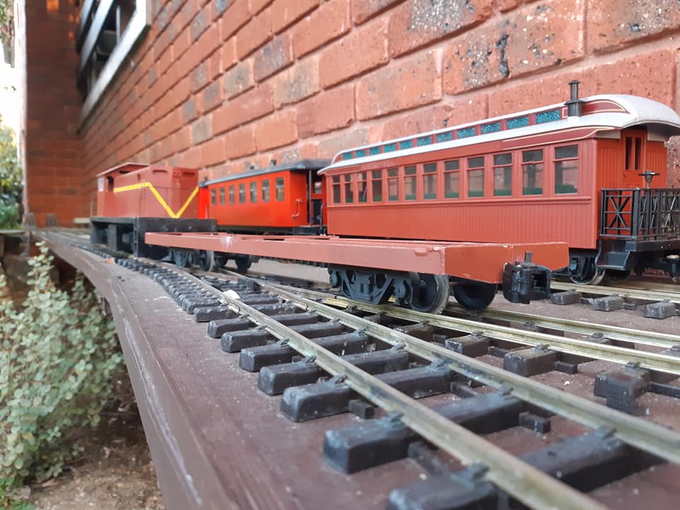

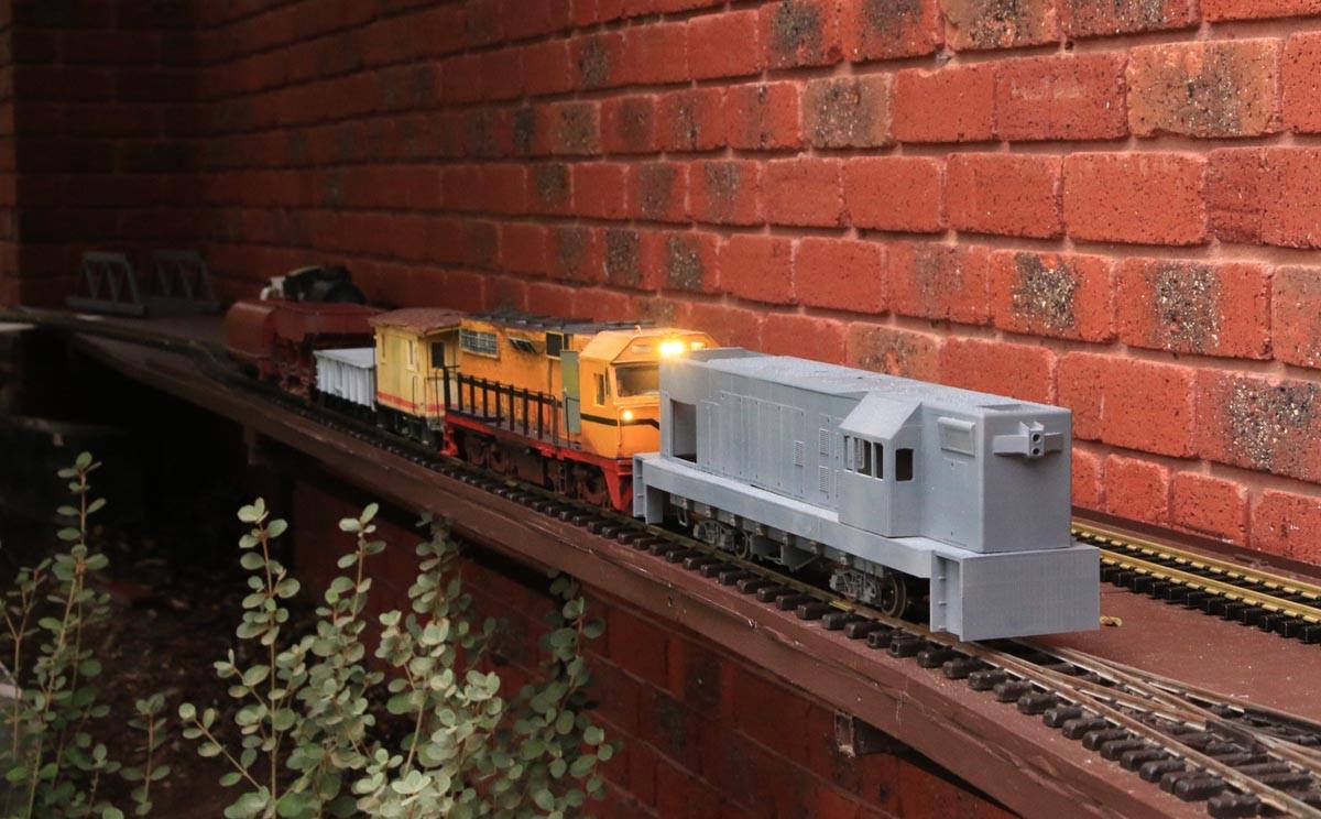

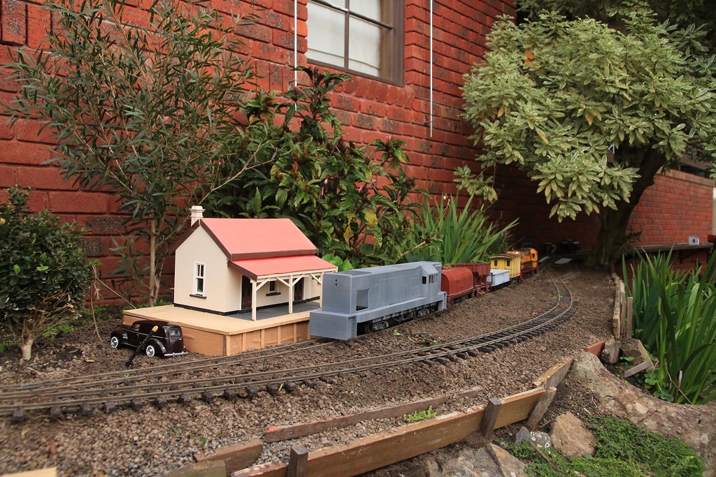

The tramways new diesel electric pulling into the station after rolling off the branchline
also attached to the rear of the train is one of the NEVR's EMD G8 diesels, the tramway was performing the transfer in exchange for some surplus ex WAGR frieght wagons
The DE detaches from the consist and prepares to run around to shunt the T off the train

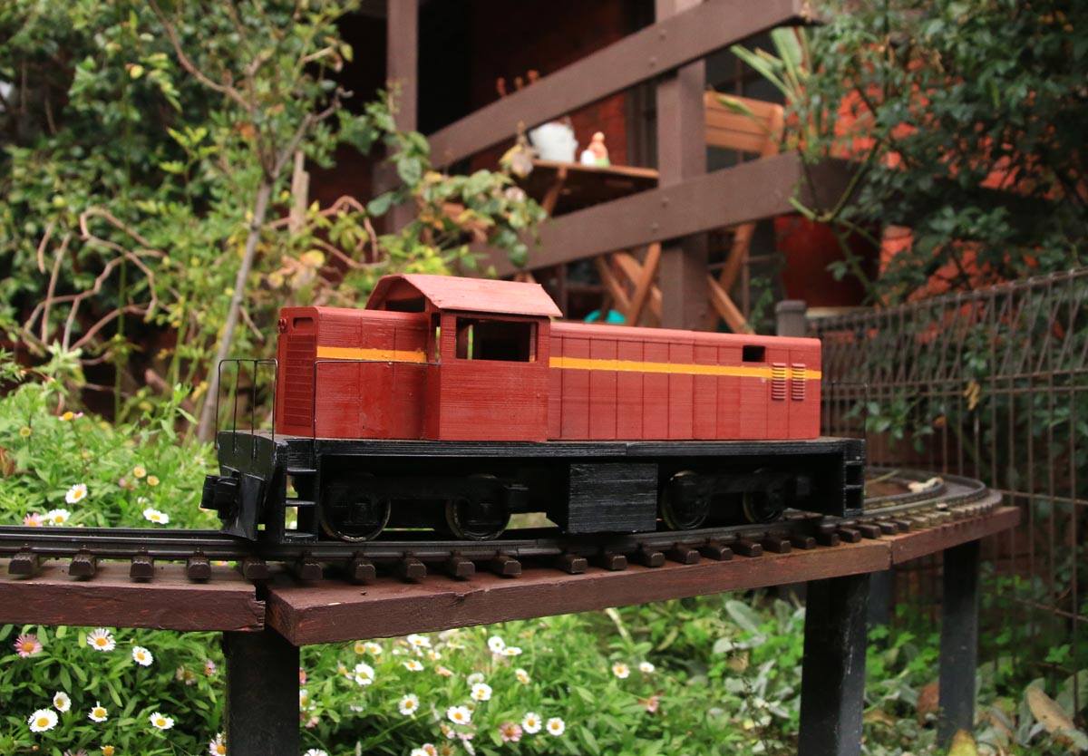

Another quick job before we kicked it off was to finally tape up the DH and give it its stripes. Ill fit the window frames and Cab interior this weekend along with glazing
Having been given the green it rolls onto its next shunt

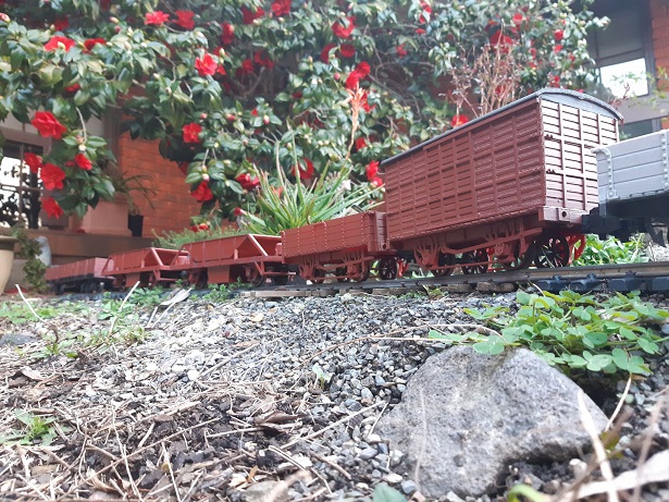

Couple of pictures from last weekends running showing some new arrivals
Prototype Aluminium container wagon. Built from offcuts of aluminium from bunnings with 3d printed bogies im hoping to build half a dozen of these to run as the bulk of the wagon fleet when running "modern day" operating sessions
The stalwart MM is on an down log train crossing one of the Porter saddle tanks shunting
The northwester crosses over the viaduct
New QR F wagon. unpainted and glued together no other preparation this ones straight off the printer! this is the second of 5 so far. there will be more but ive run out of Binnie wheels so more wagons will be waiting on another order of those to come in.
116153955_3201342026624739_6338292282415474236_n (1).jpg (76.52 KiB) Viewed 15363 times

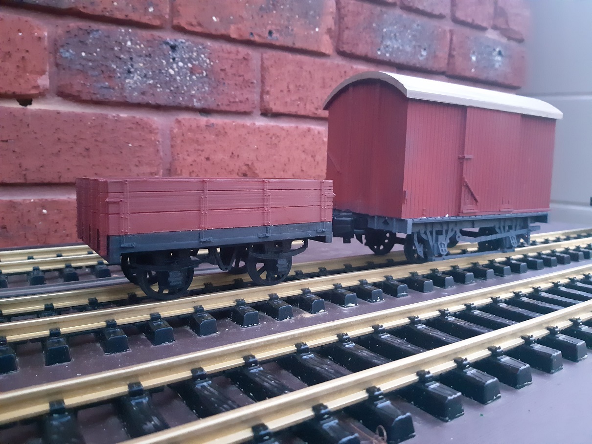

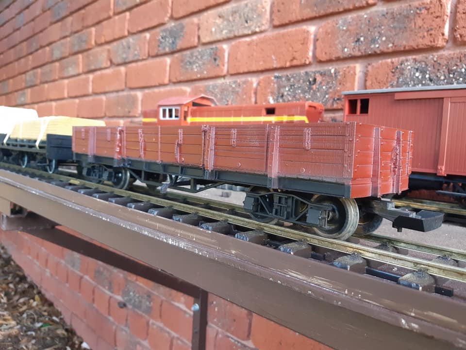

WAGR R open wagon. this ones made out of seconds parts but actually turned out quite nice it'll get a tarp and some proper bogies and couplers in due course

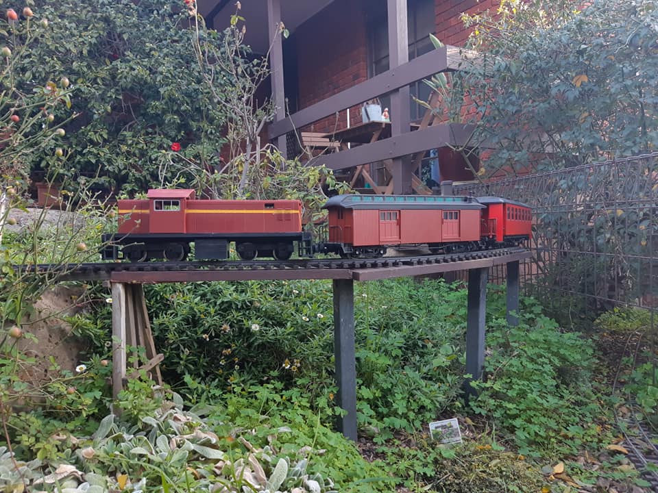

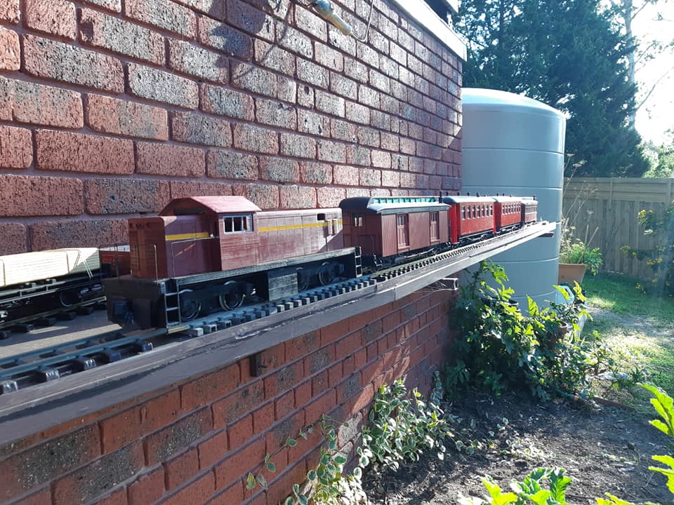

The DH ready to depart with the assembled train.

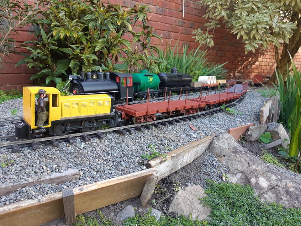

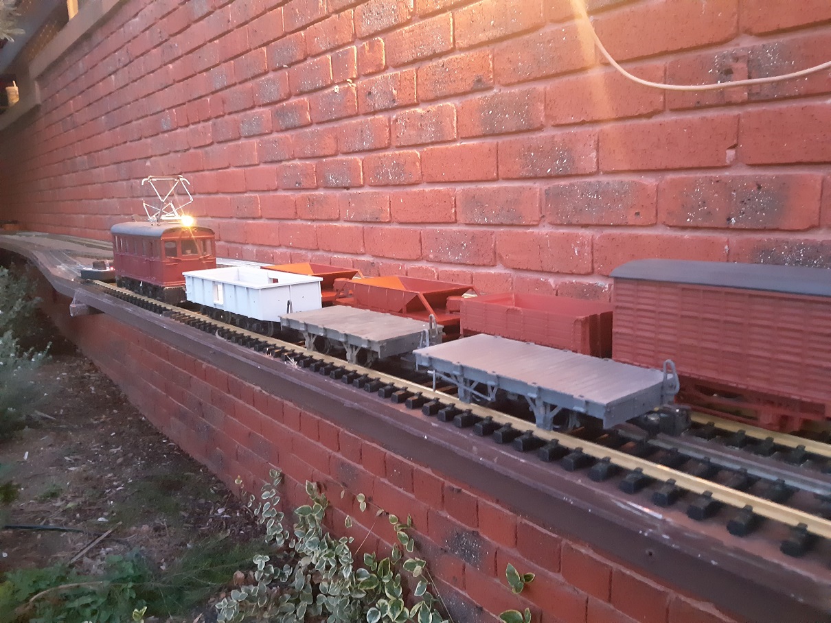

The train parked up at the top of the line showing the selection of Australian rollingstock that we've been cultivating for the last few months. I think we're up to about 15 pieces of Australian Narrow gauge rollingstock now which is more then enough to run an operating session. A disposal program from the LGB stock I bought that was "near enough" will be starting soon!

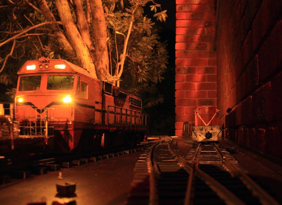

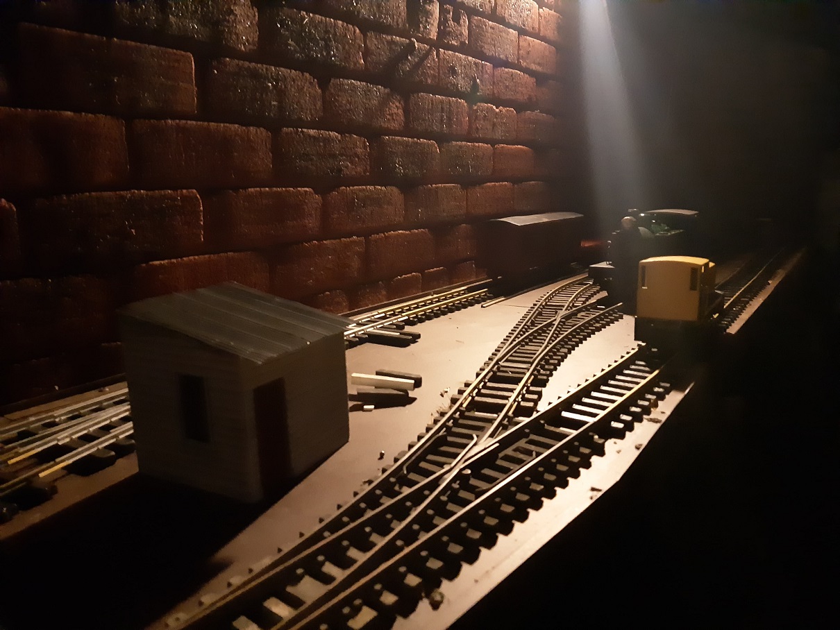

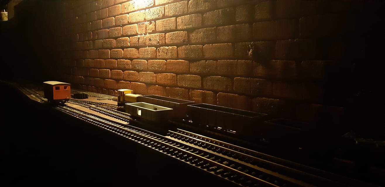

I continued running until late into the night. The line that runs around the water tank to the workshop will come off that track to the far left stretching into the darkness...

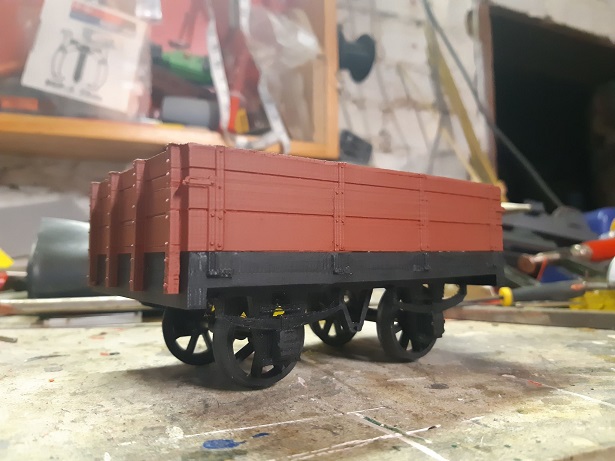

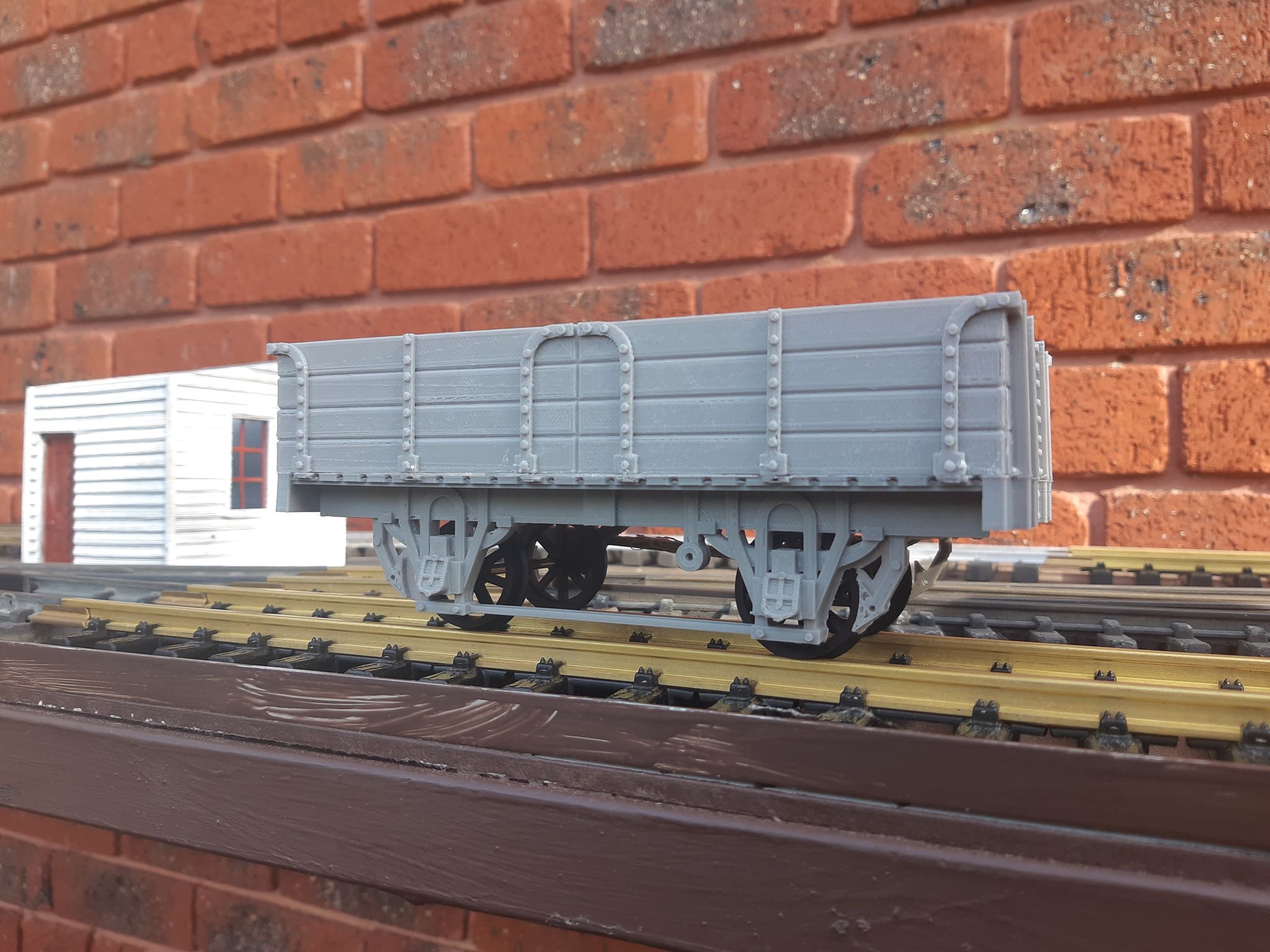

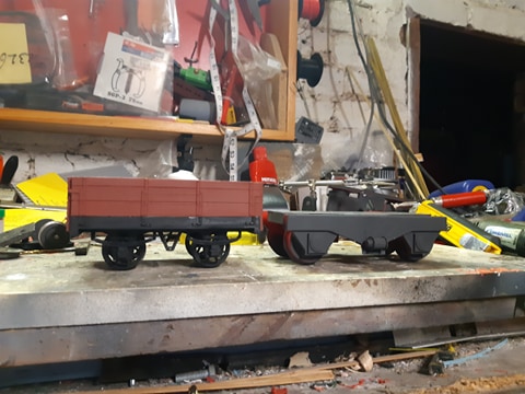

Another new project that I've recently completed to running point is this Emu Bay Railway C wagon. They use Binnie wheels and ill hopefully be selling them and their Meat van variant for around the $35 AUD mark. Ill be making a post about that later.
C wagon Bogie.jpg (51.53 KiB) Viewed 15271 times
These tiny wagons had a wheelbase that is a lot smaller then some modern bogies! Pictured here next to a display bogie for Fyansfords D1 its pretty miniscule
C wagon.jpg (345.29 KiB) Viewed 15271 times
and pictured next to a WAGR D van

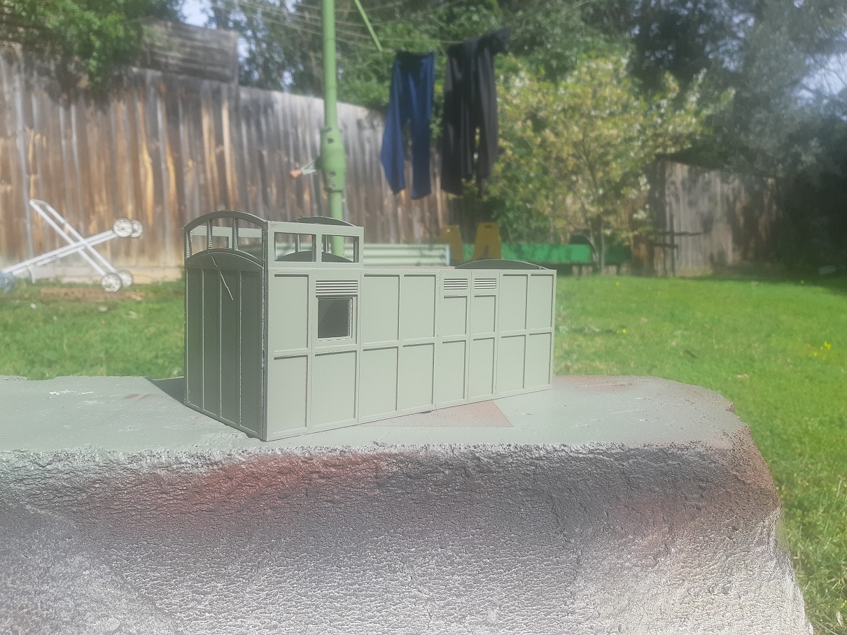

Another project was this 1880's SAR guards van. Built to fit onto the bachmann caboose chassies this ones the prototype
van 2.jpg (287.73 KiB) Viewed 15271 times
They survived on the Port Lincoln division until the 1960's and one still survives at Pichi Richi in the "one day" shed

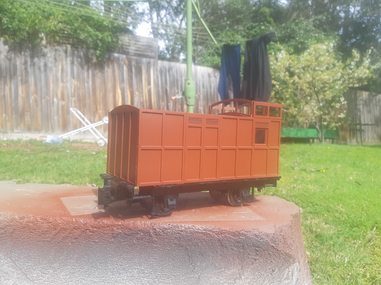

Sitting on the quickly hacked chassies it still needs some more cleaning up and more detail but theres potential there. Ill also be selling these slightly lengthened so they just drop onto the chassies instead of having to chop them down in length slightly.

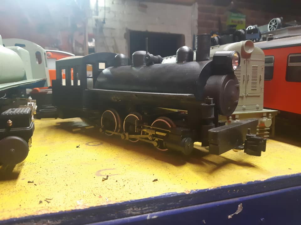

Last ones a teaser of sorts. Fyansford #6 a 1903 Hudswell Clarke...

the ol block of Hebel certainly gets a workout :lol: it'd be nice to have a dedicated spray booth but rattle cans and mother nature is all the line can afford

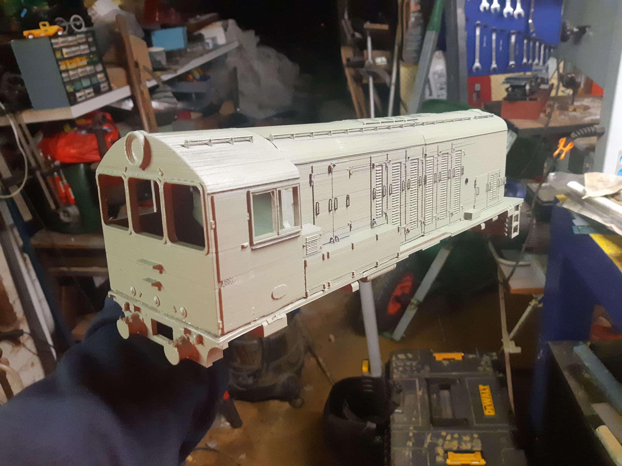

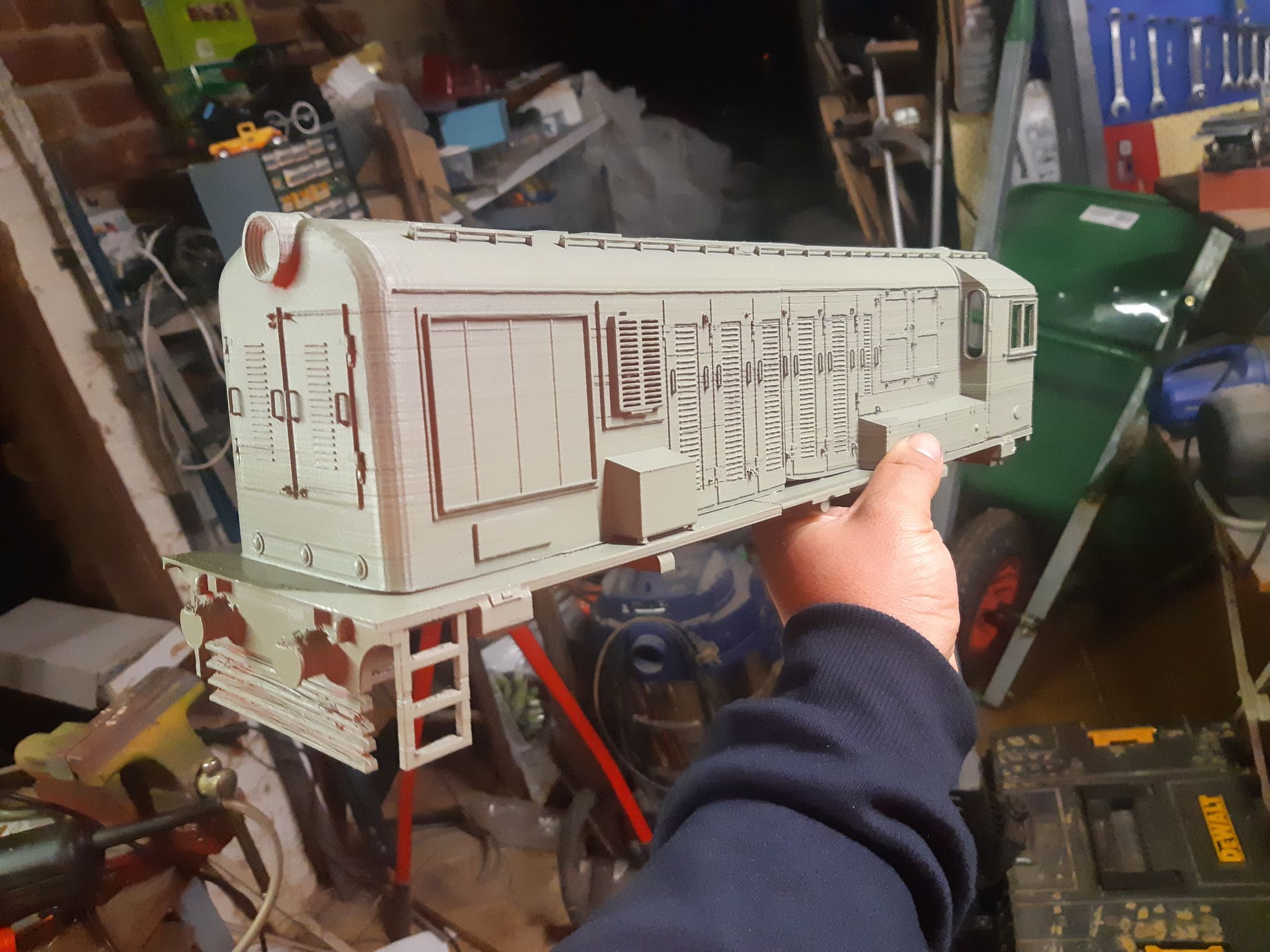

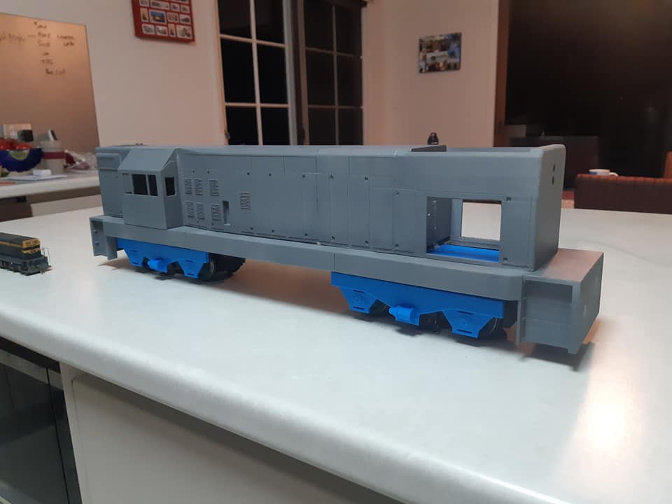

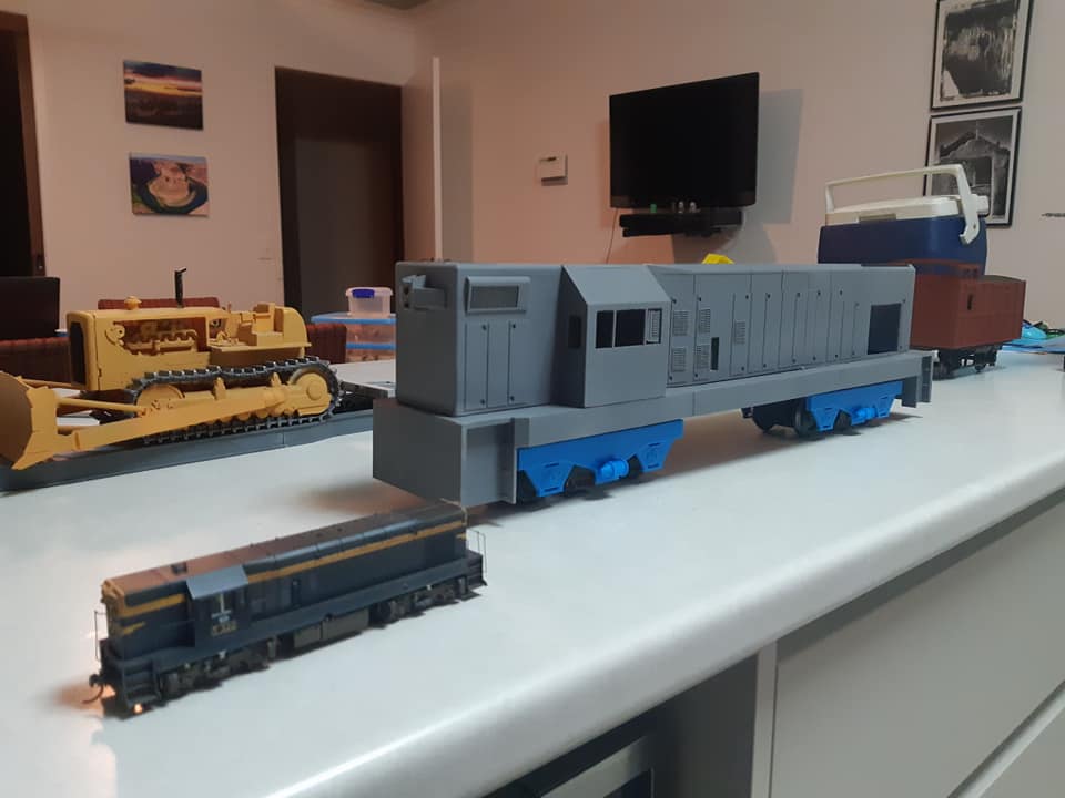

Fyansford D1 (EMD Standard G8 Built to haul limestone at a local cement works) is coming along. I'm on Mk.3 of the side frames and I think there'll be a Mk.4 before the next one is completed. They'll be powered by Piko 218 motor blocks with Deltang Rx65's for control. Im really hoping to figure out a sound card I can use on battery power that'll give me authentic 8 cylinder EMD 567 sounds with notching up but we'll see.
From behind. after some misprinting on the front side I decided the headlights and marker lights will be a separately added detail. You can see the holes for the 3mm LED in the wall though

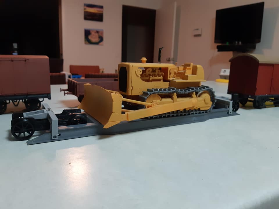

The Fyansford lowloader also got to the point where it could be towed around. Amazingly it goes through my R3 pointwork

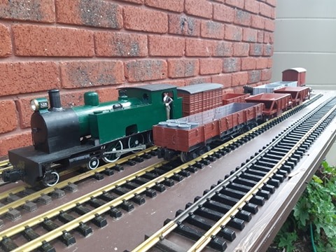

New recievers have arrived from Micron so #4 will get its roof and will also run for a bit until I get enough interest back to finish it off and detail the cab

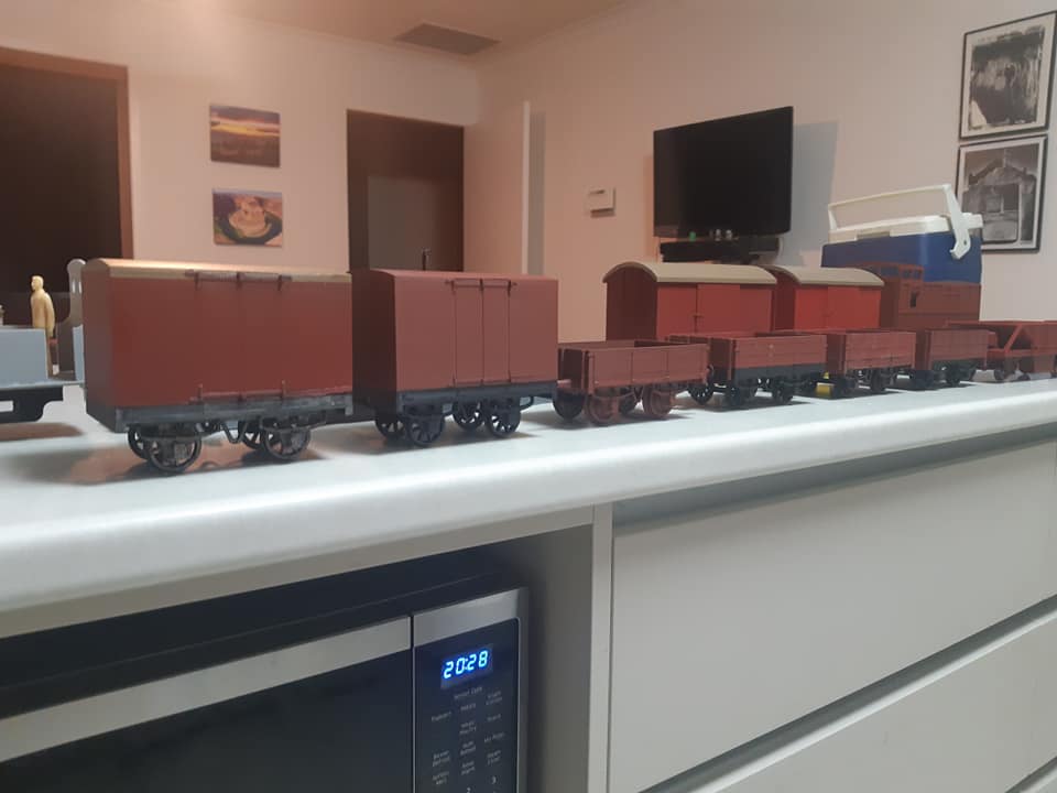

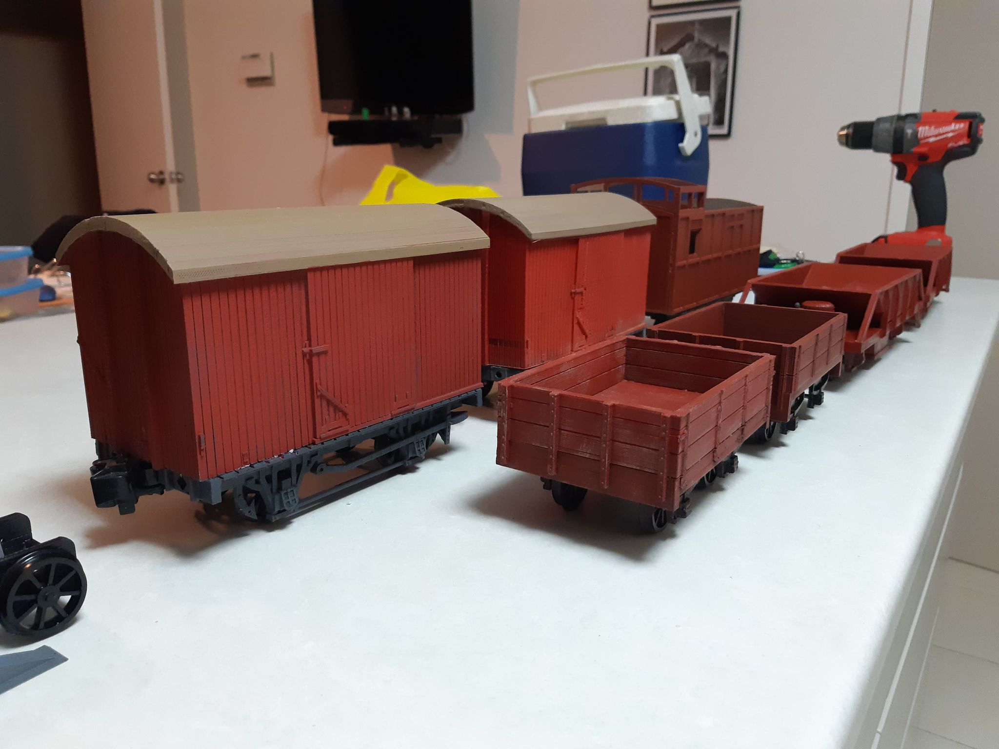

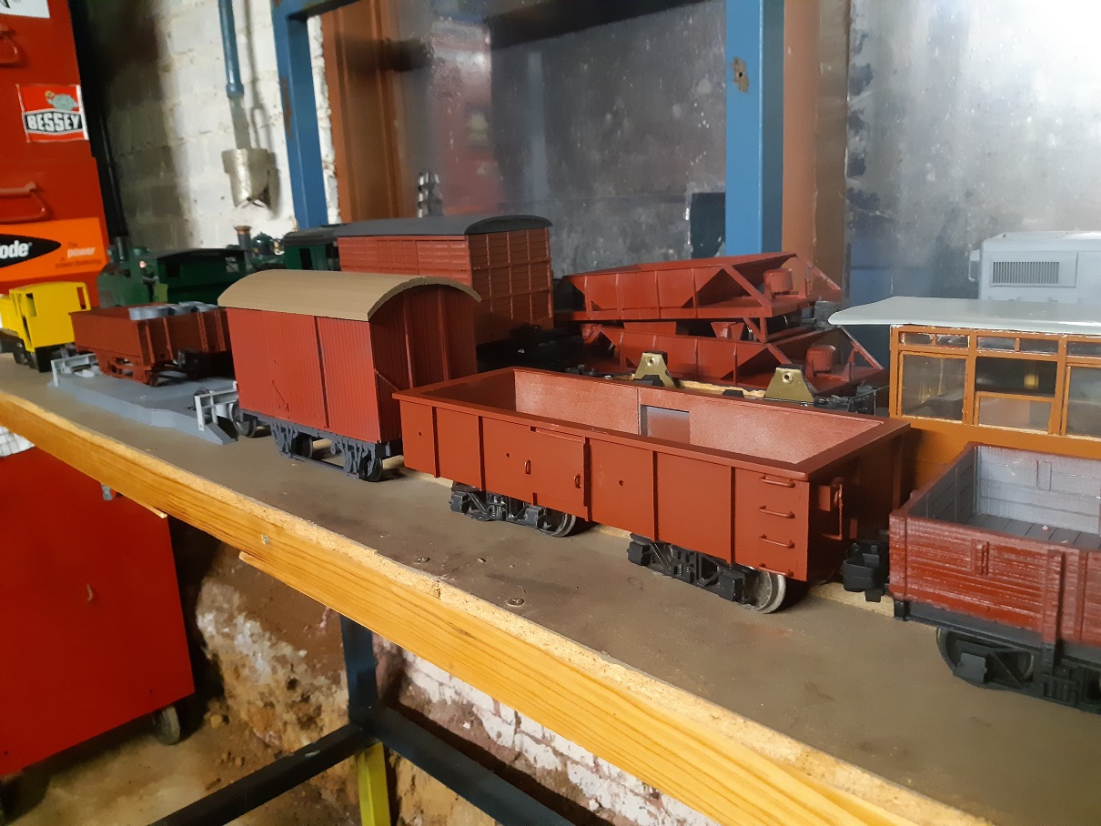

A selection of Emu Bay railway wagons! the one on the far right was the original made as a fathers day gift and on the far left is the production version now available from my facebook page "North East works" in two, three, four and meat van variants

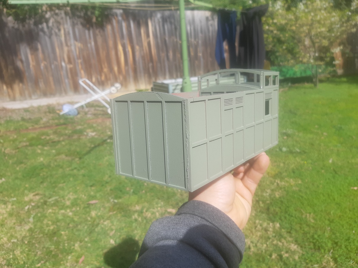

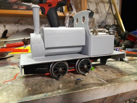

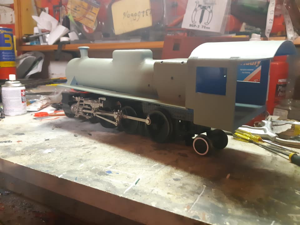

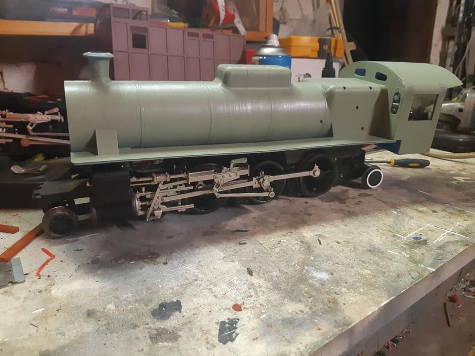

Now that I've got the Barclay to the point where its usable as my big steam power I decided to start on my first large Australian locomotive. I had plans to start with the Silverton A class but theres some engineering difficulties I have to remedy first so the M class it was. For our English friends you have repatriated M10 (M2 originally) at the Tanfield railway. Ive never really understood why given its 3' 6" gauge but there you go!
I talked about doing this on another forum but I have a particular affinity for the TGR X classes being the first mainline diesels in Australia. Ive spent a bit of time in the cab of these now as train crew and a little bit of time working on them and this is the embryo of X20, X3 will come later!
