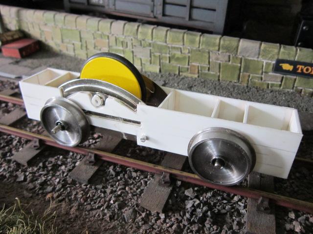

Post by tom_tom_go » Sun Jan 24, 2016 4:35 pm
Inspired by others attempts I pulled my finger out today and got thinking about what type of rolling stock to build around the Zecar.
After coming up with design ideas for a Ffestiniog bug box type of wagon, installing it into a Cambrian models bogie (the distance between the axles was very close!) or a Penrhyn 7/8ths tender I decided on a Penrhyn type of coal wagon as the wheel spacing was similar to the one pictured in the 16mm NGM Penrhyn modellers guide:
The Accucraft L&B axle boxes are a perfect fit for the axles supplied with the Zecar although I have modified them so they fit onto the sole bars directly like a quarry style axle box. IP 24mm wheels have been used.

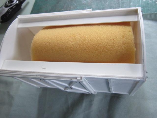

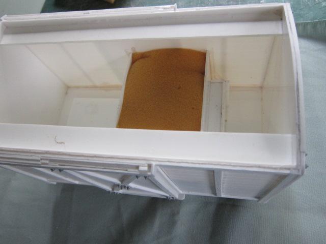

Did anyone add sound insulation to their version as I plan to put a removable cover in my wagon (will be hidden with coal load):

Post by Andrew » Tue Jan 26, 2016 9:07 pm
That's looking really good, I like what you've done with the axleboxes.
They are a little noisy so I can see why you'd consider sound-proofing, but you might find you want the internal space for extra weight - that's what I did.
Posts: 5713
Post by Peter Butler » Tue Jan 26, 2016 9:18 pm

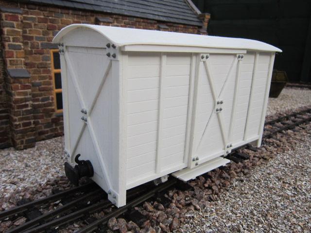

My own van was designed for use with any train combination... in the guise of a box goods vehicle. Only when I had made the unit and tested it on the track did I discover I had built a speaker cabinet which amplified the sound from the flywheel. I made a small housing first to cover the Zecar which I filled with foam rubber sheet. It still needed more so the inside of the van is stuffed with foam sheet which certainly helps. Running outdoors you can hardly hear it but I found the need to keep all moving parts well oiled which also reduces vibration.
Keith S
Posts: 1668
Location: Canada
Post by Keith S » Wed Jan 27, 2016 12:06 pm
I filled the empty space in my wagon with rigid insulating foam. I also placed a large block of steel in there, supported by the foam. The heavier you make your wagon the better it will work. I recommend you find something heavy to fill your little wagon with, like some lead fishing weights if you can get them. Filling the cavity with anything will deaden the sound, and that little wagon needs to be quite a bit heavier than it is at the moment, I suspect. Also some nice thick oil or grease on the gears will make it run fairly quietly.
Crayfish
Posts: 35
Joined: Mon Feb 07, 2011 2:31 pm
Location: GB
Post by Crayfish » Thu Jan 28, 2016 11:58 am
I threw some used dish sponges in to mine to fill up the space inside the van. Most of the noise comes from below the chassis though so making sure it is well oiled/greased is the biggest factor in making it run more quietly.
