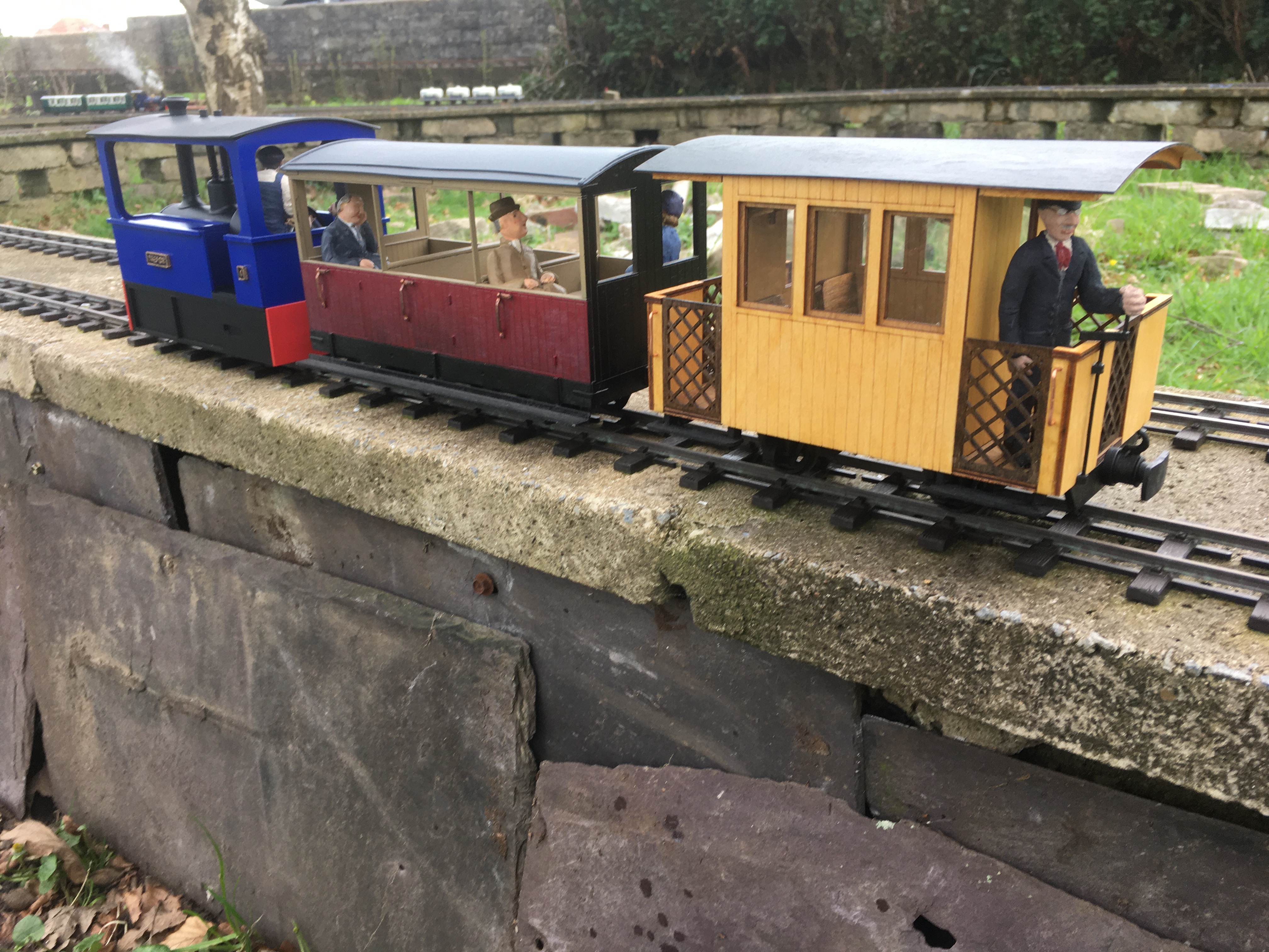

As suggested by Trevor earlier the balcony coach had a run behind Trefor the Tram at the Swansea Model Engineering Society track this afternoon.
A good day out was had by all. Many thanks to all the members there who made us so welcome,
Posts: 5671
Post by Peter Butler » Sun Apr 02, 2023 7:38 pm
gilfachphil wrote: Sun Apr 02, 2023 6:52 pm As suggested by Trevor earlier the balcony coach had a run behind Trefor the Tram at the Swansea Model Engineering Society track this afternoon.
Agreed Phil, it was a very good day to get together for the first time this year and meet such a friendly group of railway modellers. I recommend a visit to their steam running open days on Bank Holidays. See local news for details.

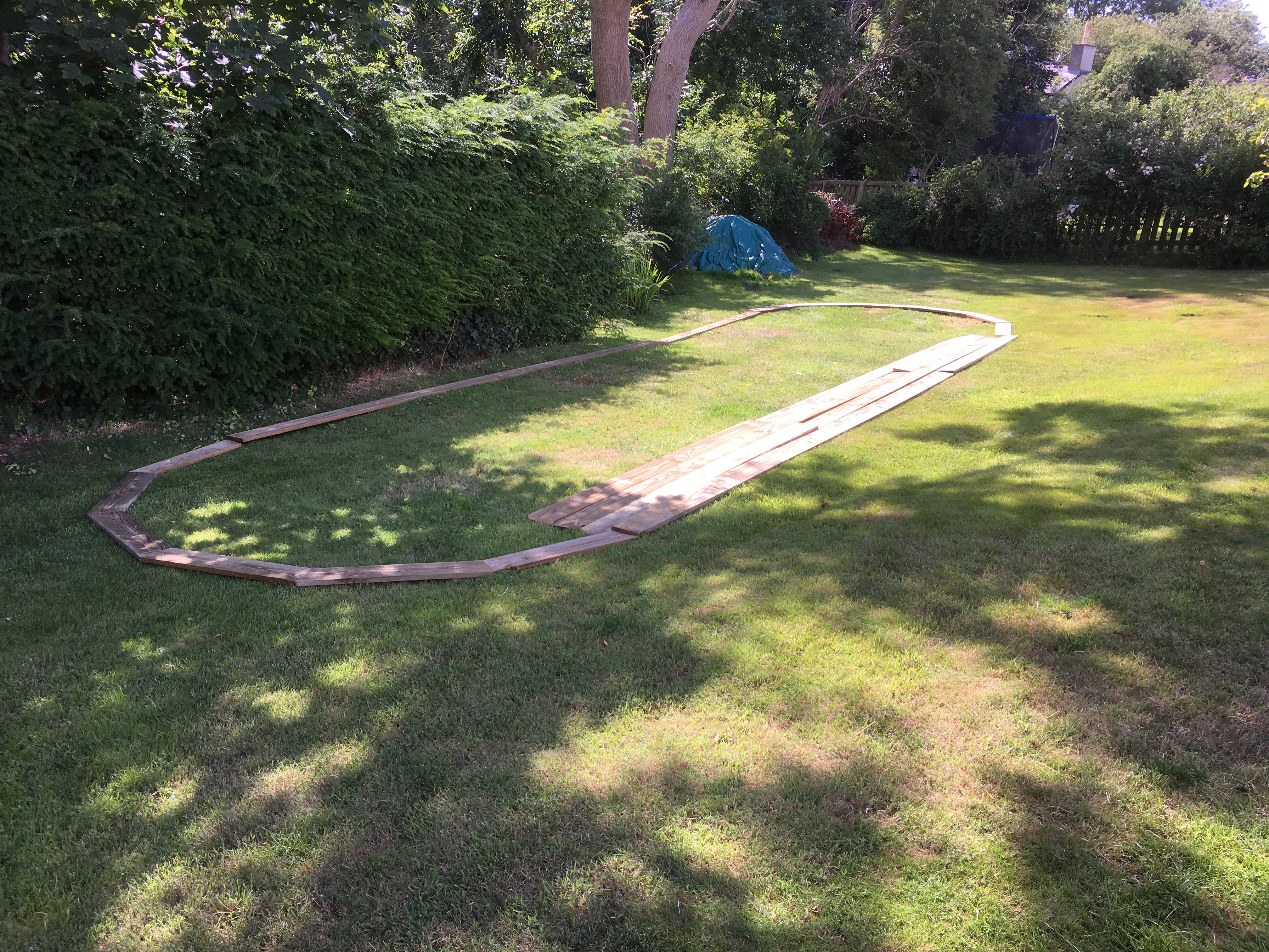

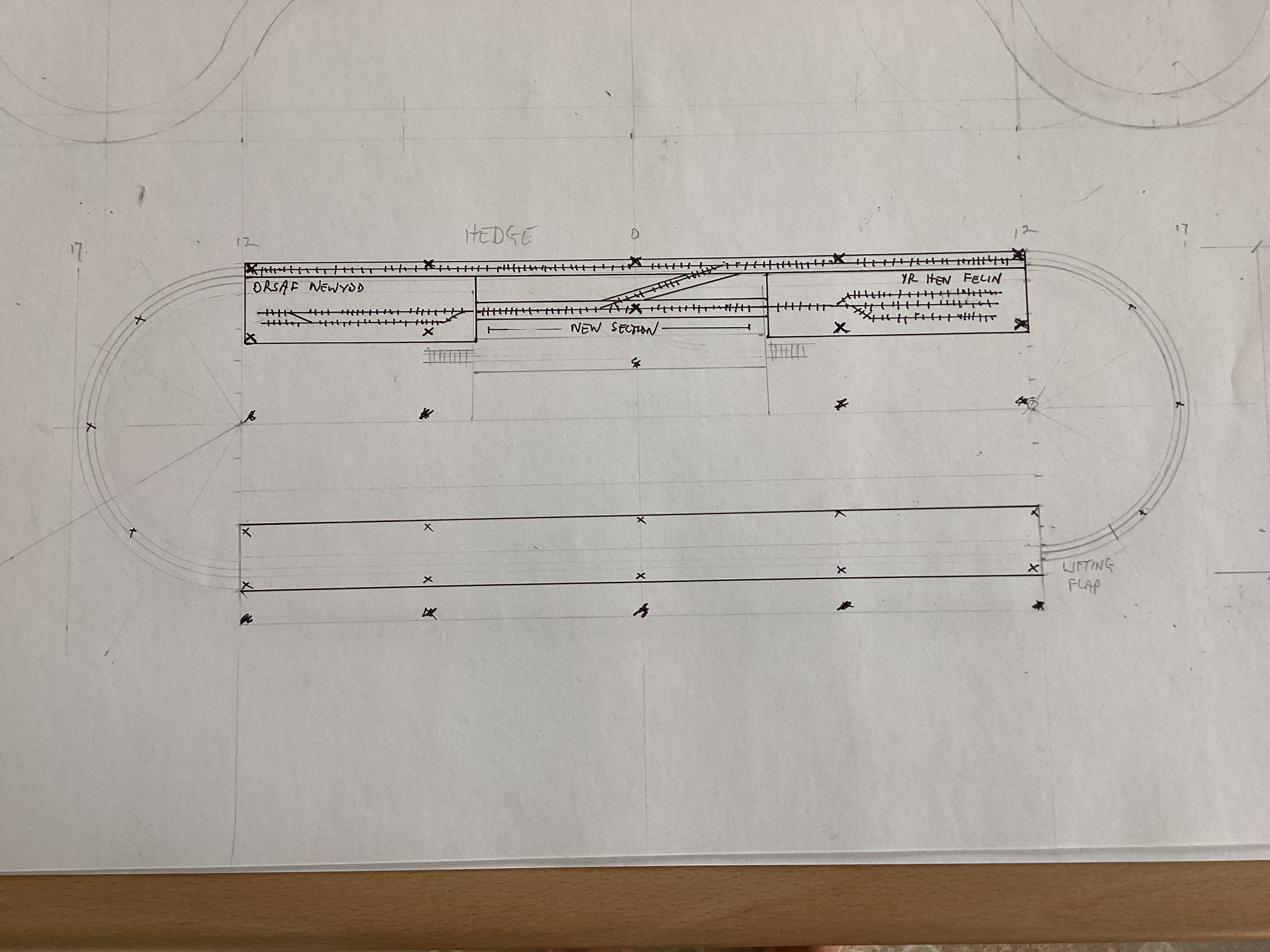

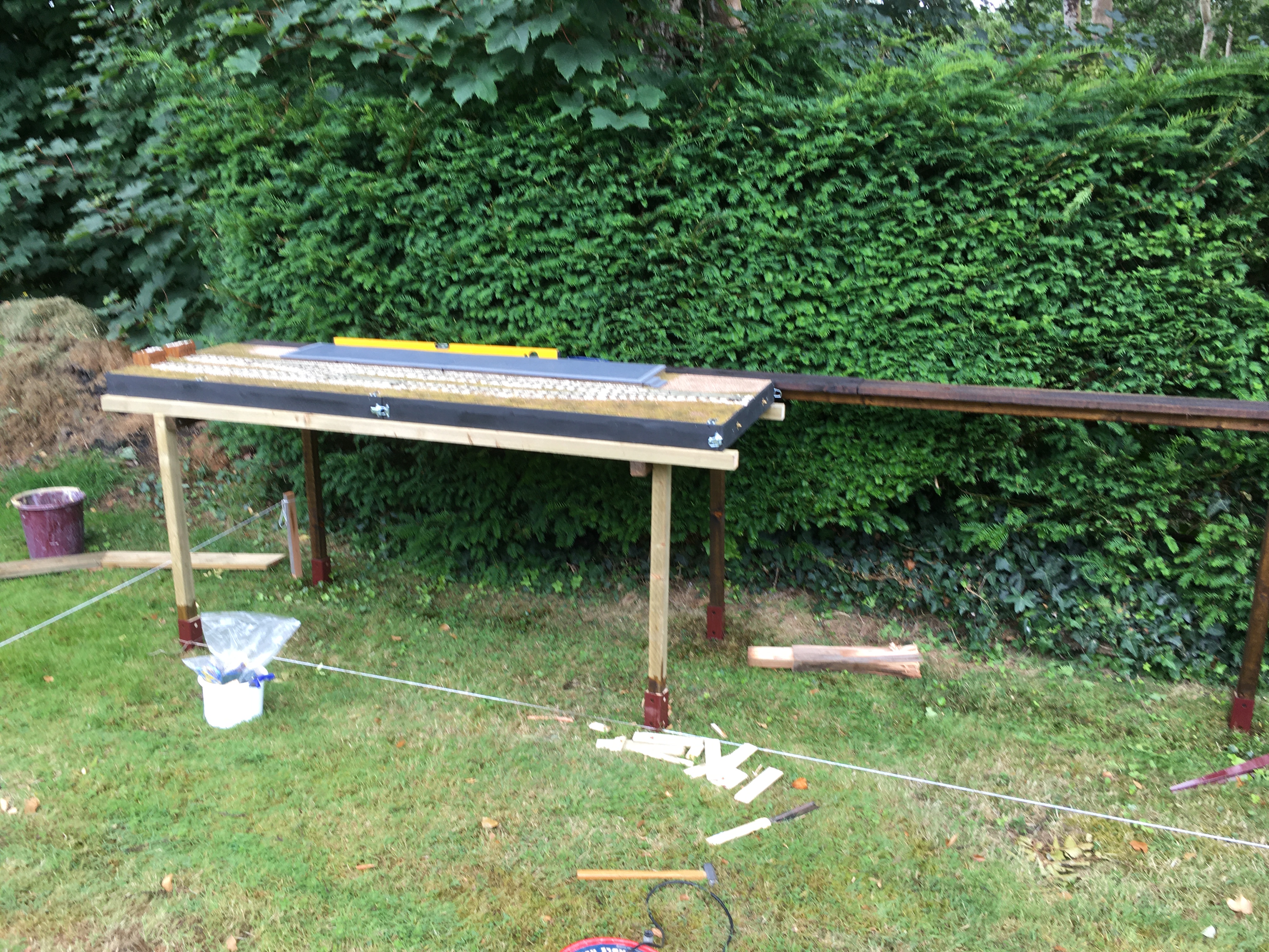

Following visits to running days on local group members layouts, inspiration and friendly discussions/arm twisting, things are afoot to incorporate Yr Hen Felin and Yr Orsaf Newydd into a larger layout.
A plan was drawn up:-

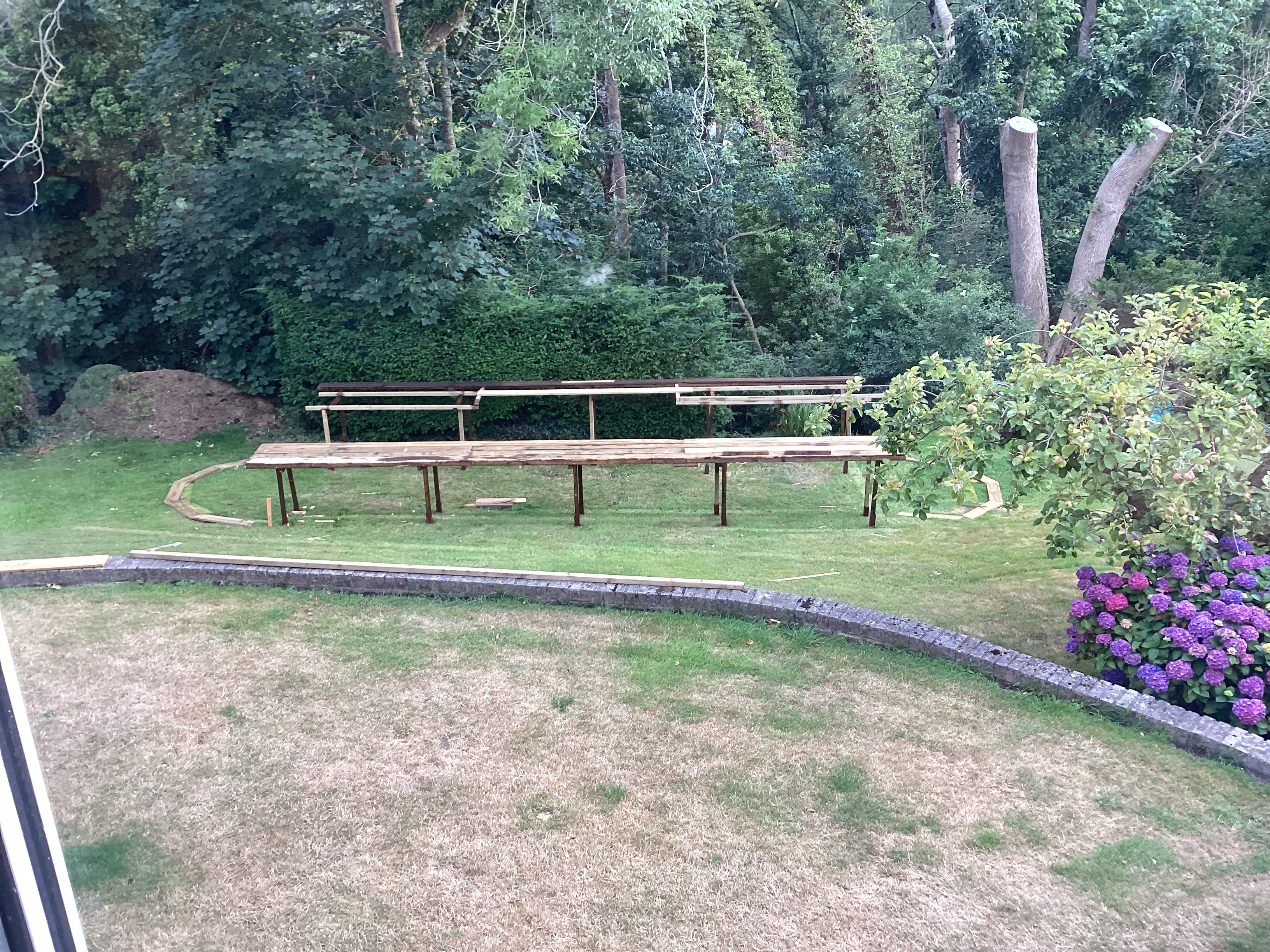

timber was sourced locally and fence post spikes online, the next picture shows the state of things at close of play last Monday:-
gilfachphil
Posts: 429
Post by gilfachphil » Sat Jul 08, 2023 10:17 am
By the end of Friday afternoon, the fence spikes having arrived at lunchtime:-
The spikes are 50mm square ones, though a little oversized, and the timber nominal 50mm square though actually about 45mm. I cut slices from spare pieces of the timber and rammed them into the gaps to hold the posts stable.

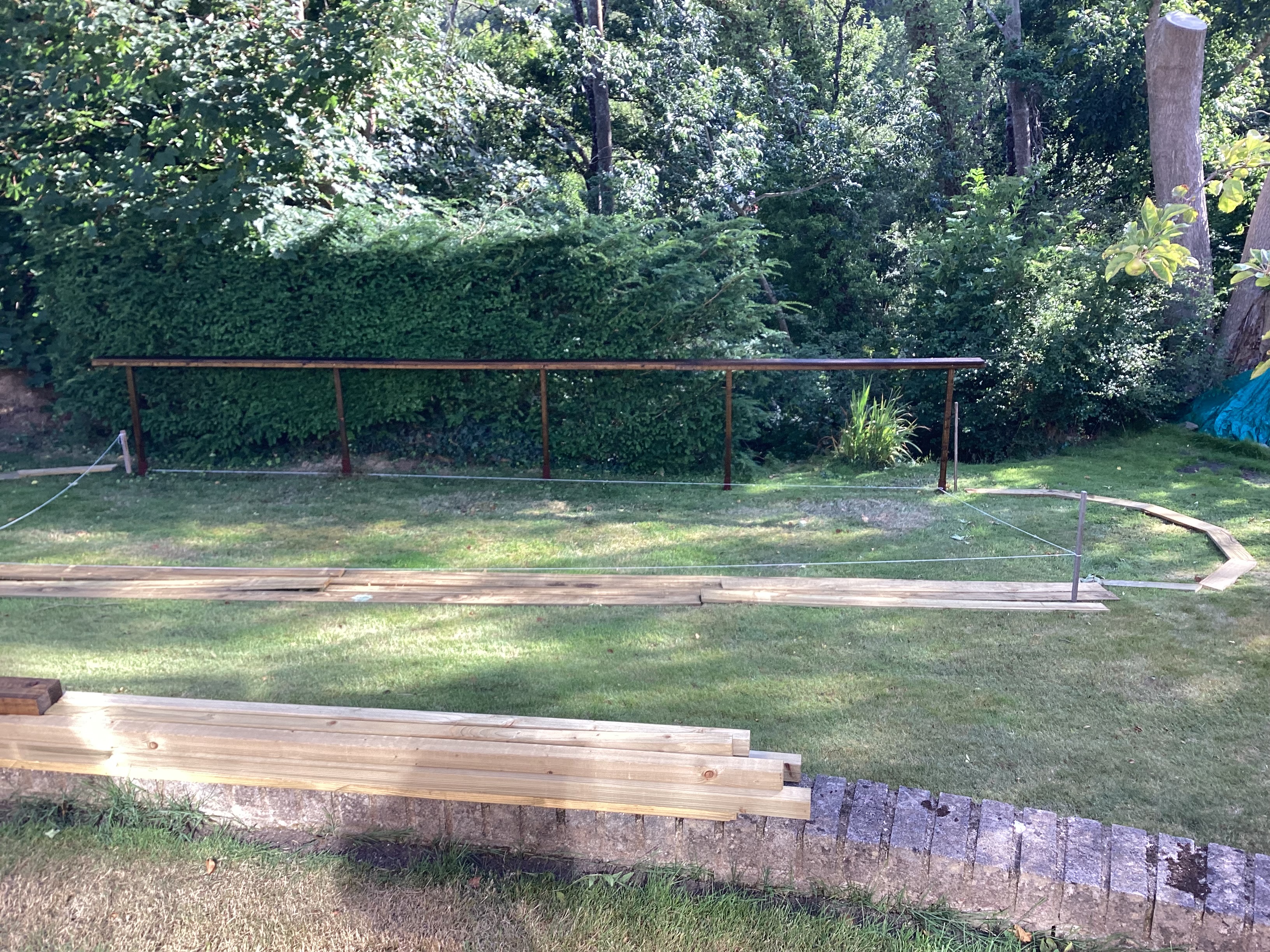

and a proof of concept test:-
it works and the station section is only slightly different in height to the new track bed so no great gradients involved in getting from one to the other.

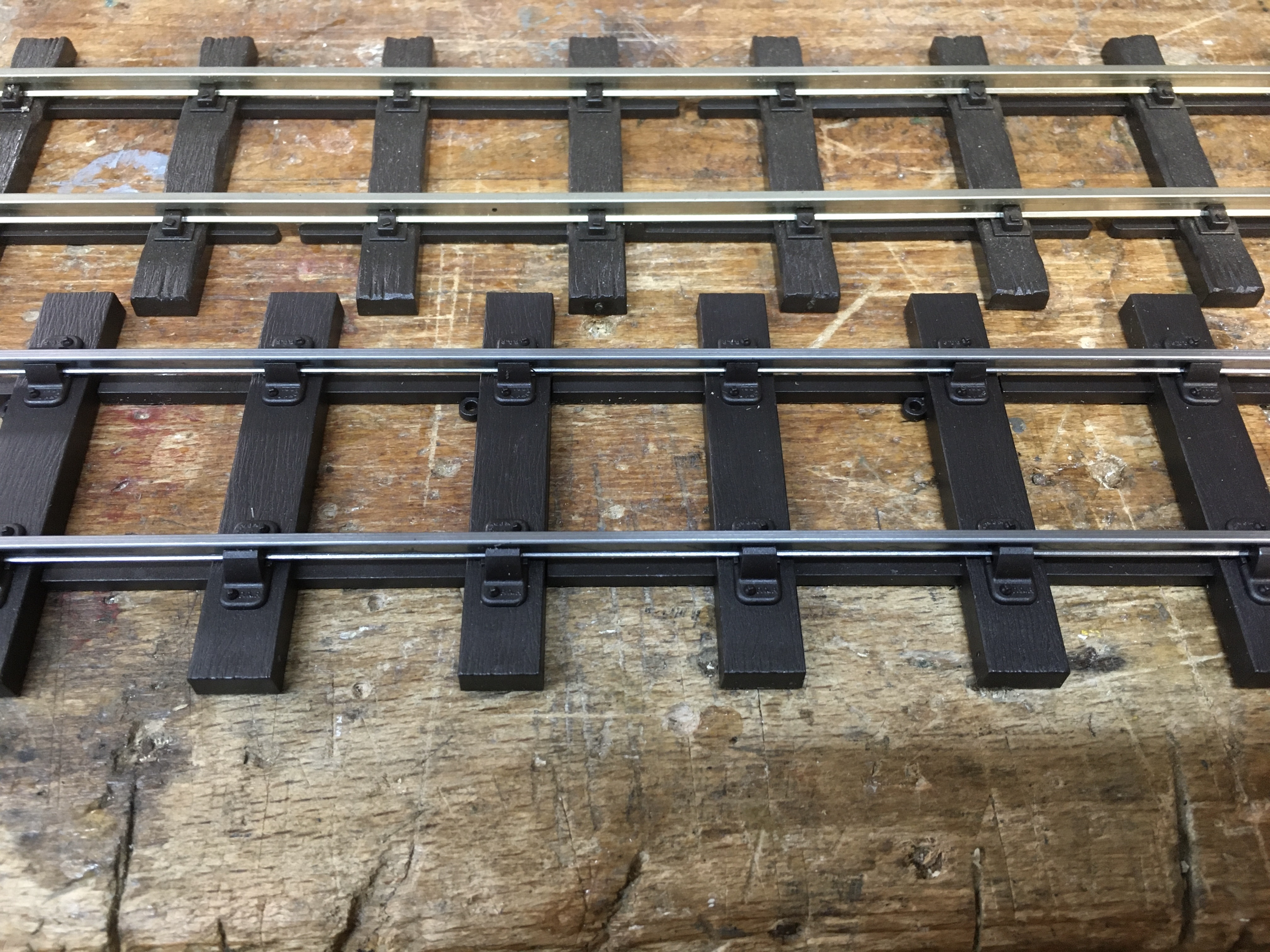

High winds and frequent rain today have driven me indoors so some Cliff Barker track has been assembled. The following photo shows Peco track to the rear and Cliff's track in front:-

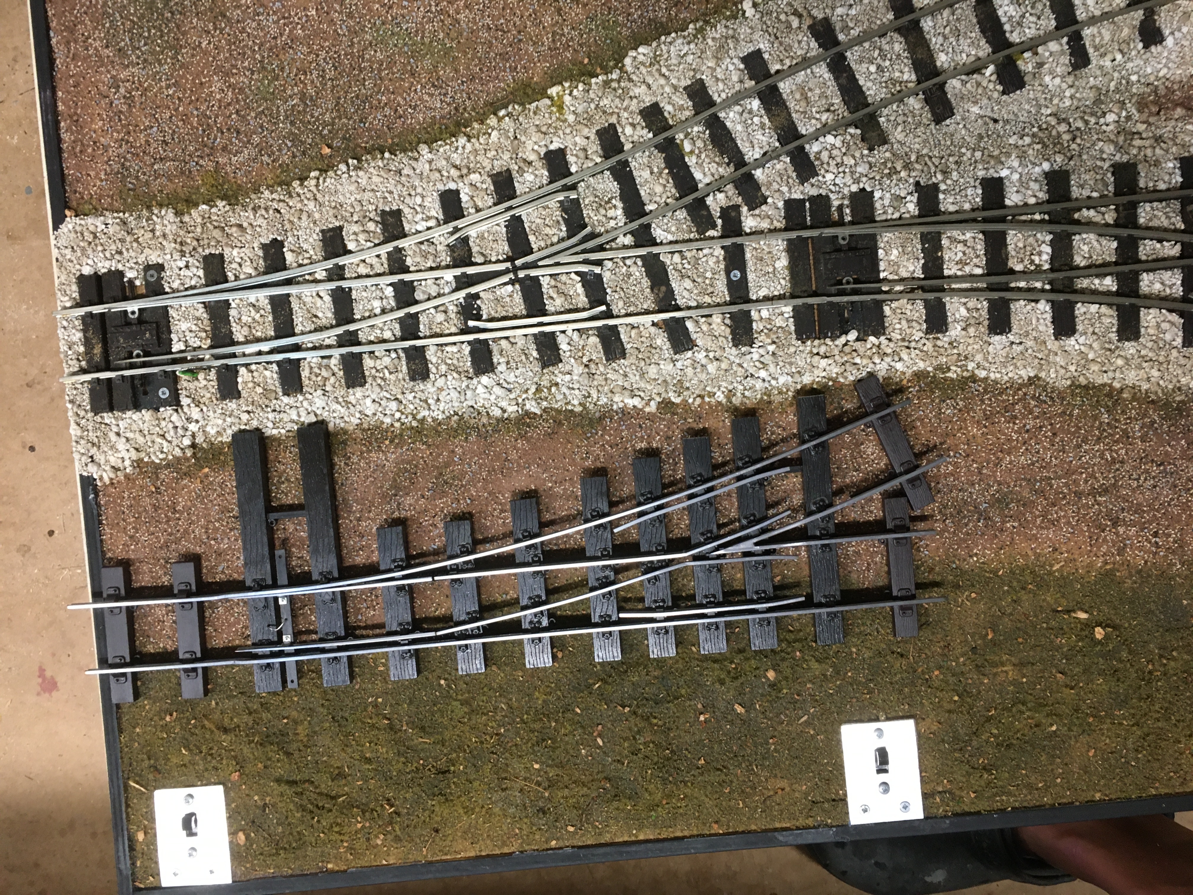

Post by gilfachphil » Tue Jul 18, 2023 11:14 am
for comparison, a Cliff Barker point beside a Peco one set into the ballast on the scenic layout
Posts: 1128
Post by Old Man Aaron » Fri Jul 21, 2023 4:57 am
That's some good looking track - and proper point throw timbers! I might have to get some of those..
