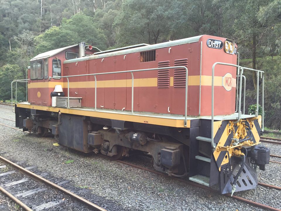

That's an attractive colour scheme which I haven't seen before. Has DH37 been gauge converted yet, or is it still sitting in the yard on it's display track. Hmmm. You won't lose sight of a Cooks DH when it's running, it's a hi-viz scheme on a garden railway.Tropic Blunder wrote: Sun Dec 01, 2019 6:21 am Thanks Graeme this one will be the same as Walhallas DH,
I am a big fan of the 10's that'll be quite a weighty unit if you build it all metal, any idea on what motor blocks you'll use?
Walkers had some sort of technology agreement with North British and the 10 class seems to be based on the Indian YDM-1 class built by NBL in the mid '50s. So the 10 class is an old enough design to have replaced the VR G class in an alternative universe. One where the state govt. had an average IQ over 40........
My Accucraft Walker railmotor is all metal and weighs in at 5kg, so the single motor is working fairly hard to just lug itself around. I'd want to keep the weight of a large diesel model under 4kg, so the bodywork would be polystyrene sheet above the footplate with a steel underframe for strength. Drive would be a Como geared motor in each bogie with bevel final drives to the axles and the batteries and electronics would be up in the plastic body.
A metal body would also be a lot more work with all those louvres and getting rc to work reliably over reasonable distances in a metal body isn't easy. Just been through all that with the Walker railcar.

Neither DH has been gauge converted as far as I know. DH37 was as pictured about 3 weeks ago although I'm not sure about DH72 there hasnt been much news lately other then they're looking for donations.

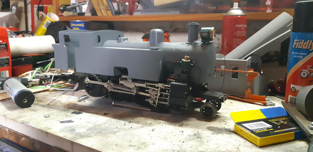

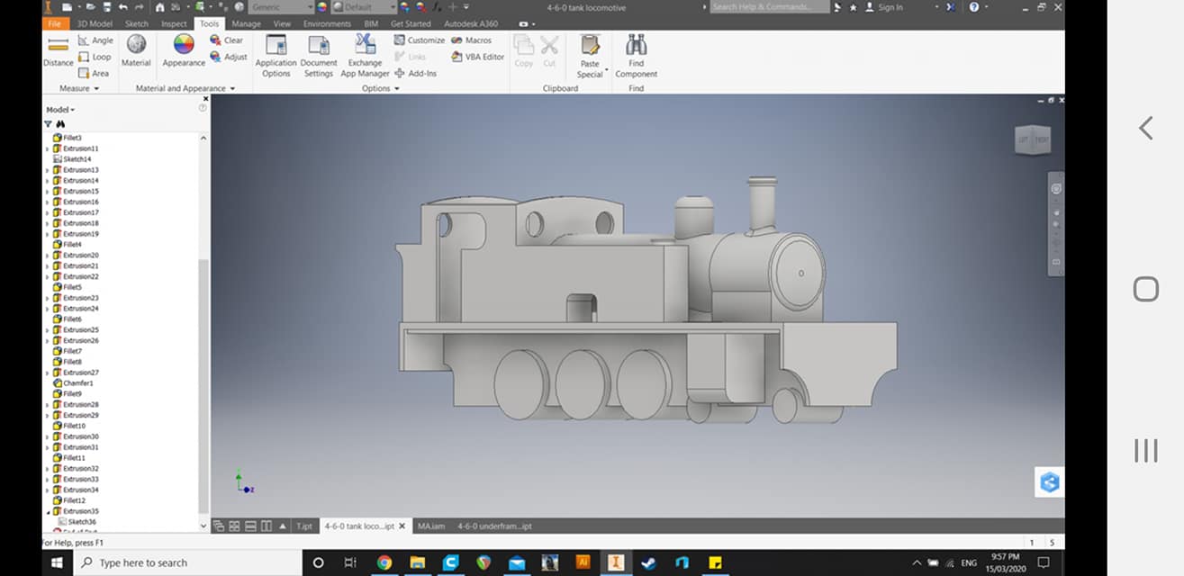

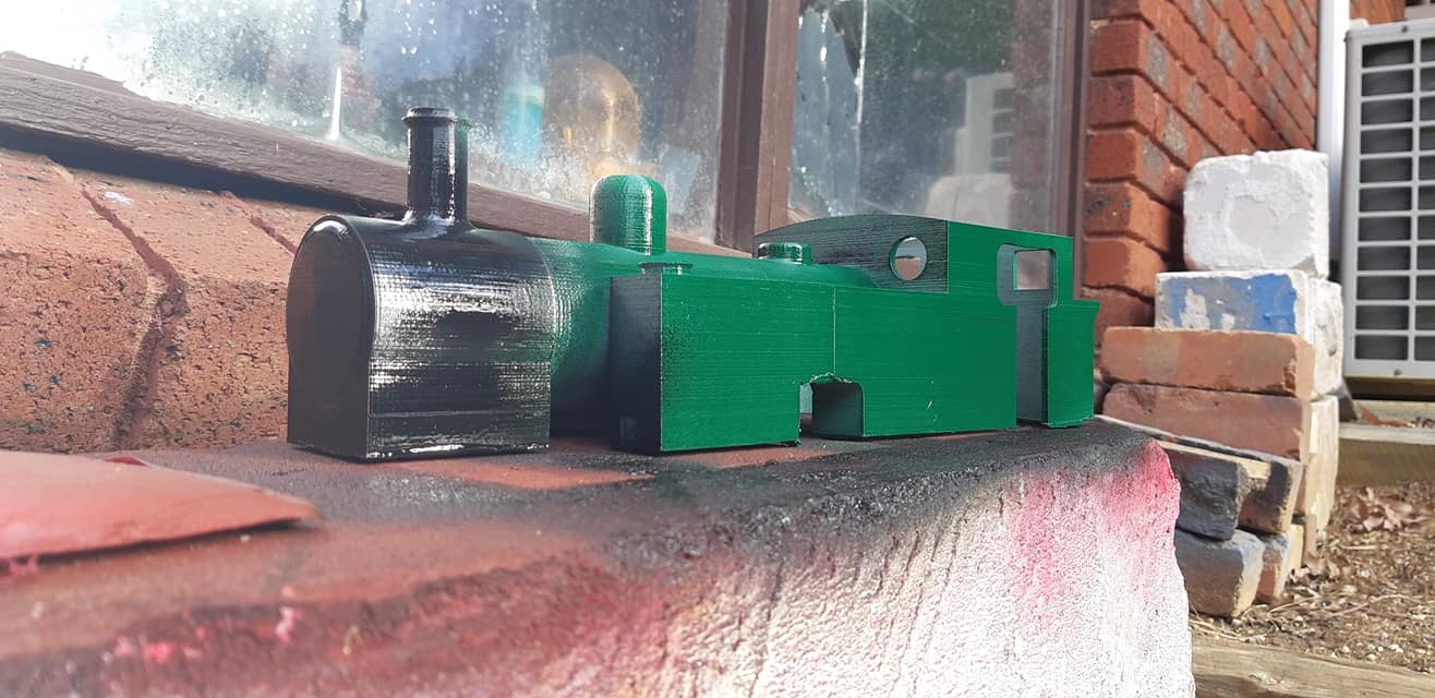

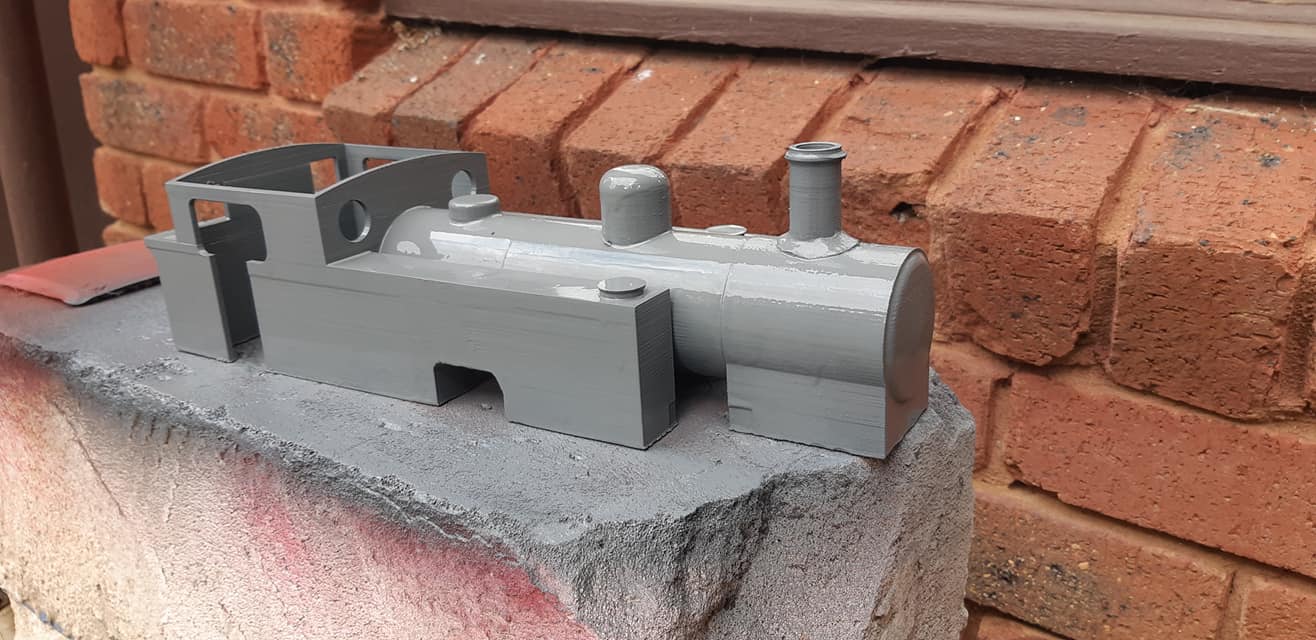

A little project I'm banging out before we all get locked up at home. Based off an Andrew Barclay sent to Norway ive modified it to be 3' 6" and Australianised it as per Pozieres at Queenscliff. I was going to make it stephensons to use another chassies but this one was already cut up so thats sorted.
the backstory is that the NEVR needed some medium sized surburban tank engines for their lines radiating out of Melbourne to the East and South and so after hearing how impressed BHP were in South Australia ordered 6 of these tank engines. the main trunk was shortly electrified displacing these locos to short trip trains and heavy shunting work.
the prototype 8 hours of CAD later testing colours straight off the printer (it was black on the other side) after some sanding/filling and its first coat of primer Im still trying to decide whether ill model it in its early guise (lined green with an oil lamp headlight) or in regular unlined green/black with electric headlights, rerailing jacks etc

Powerful looking loco. Was the body a single print-out? I hadn't realised 3d printers could produce something quite so large.
- Tropic Blunder
- Posts: 228
- Location: Australia
Thanks Rik, I spent a lot of time juggling between Australian prototypes (too modern) or South African Prototypes (wrong wheel arrangement/wrong feeling) but this just spoke to me for some reason.
Its actually a two piece print you can see the split down the centre of the body on photos 2 and 4. it has a spigot designed into it so it all lined up perfectly and assisted gluing which made putting it together a breeze. My two main printers (Cocoon touches) are 200x200 and the Wombot that I'm slowing trying to fix is 250x250x300 so they are capable of small 4 wheelers or smaller locos in 16mm.
