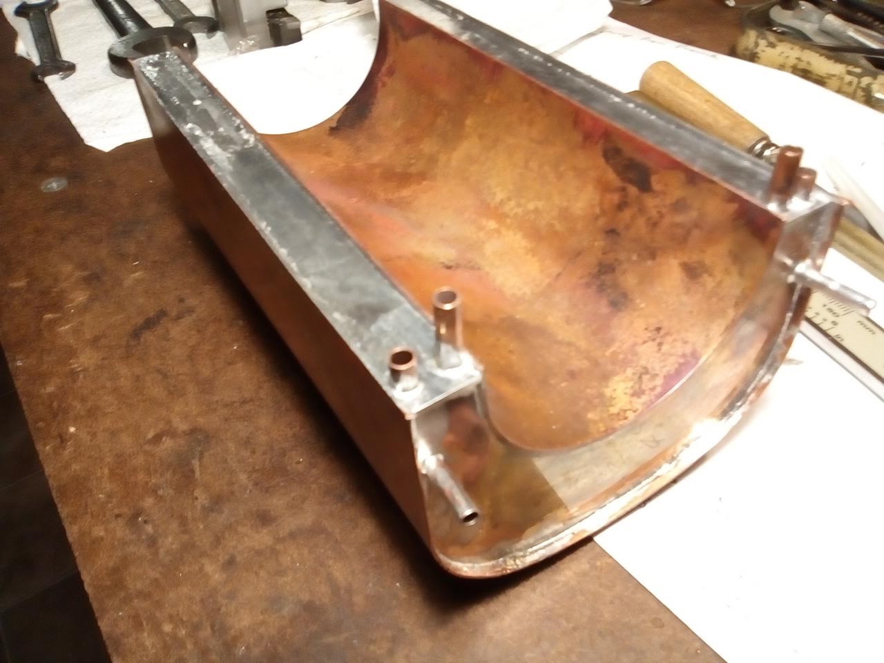

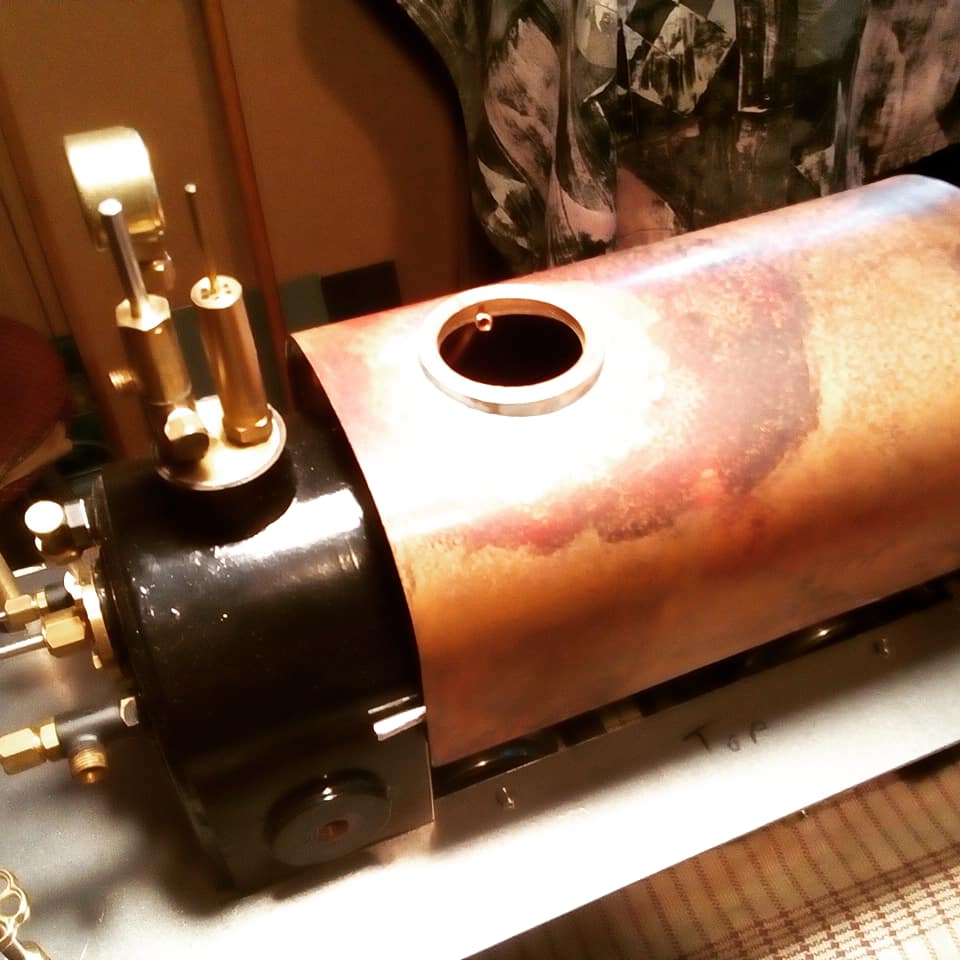

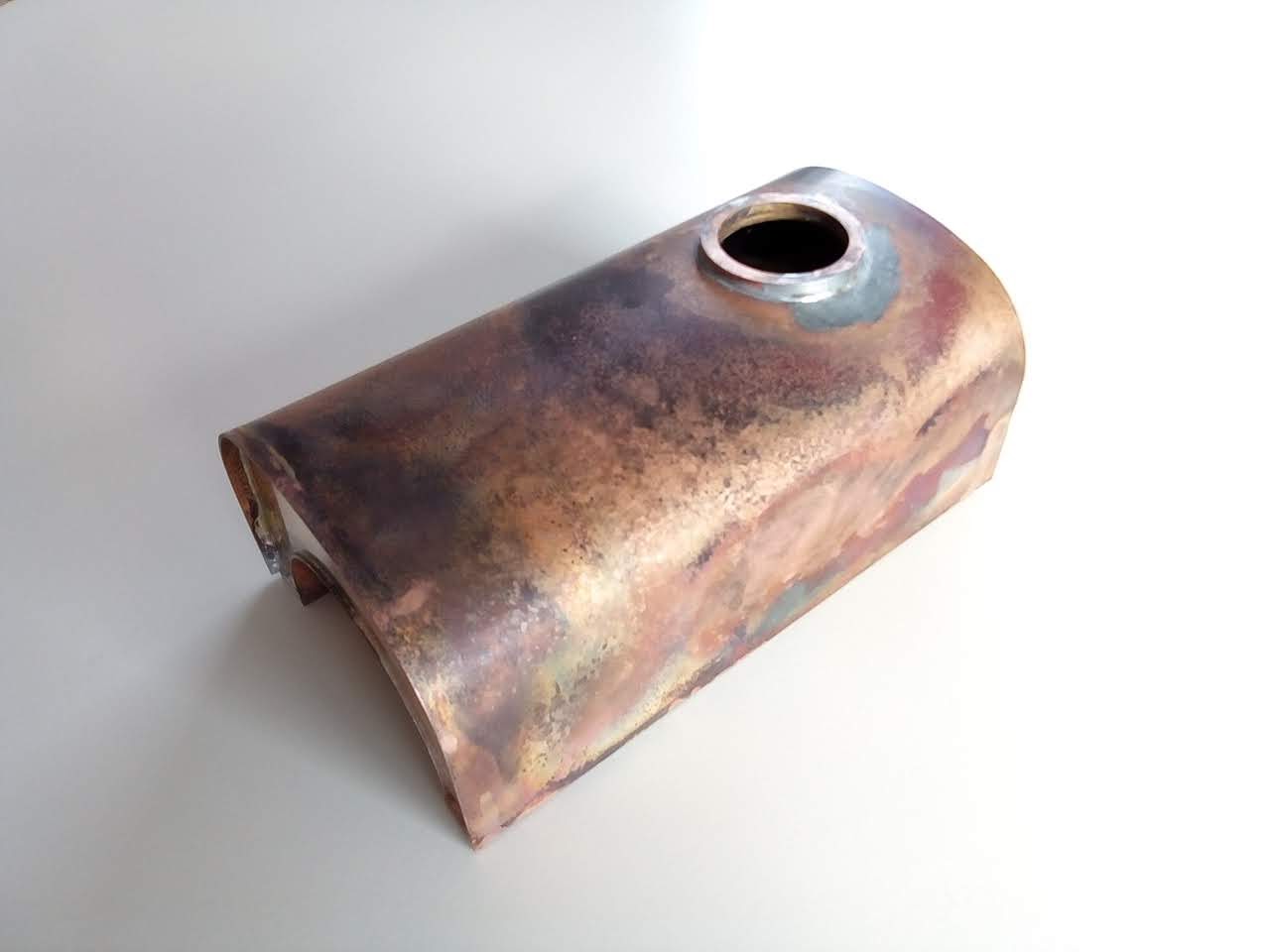

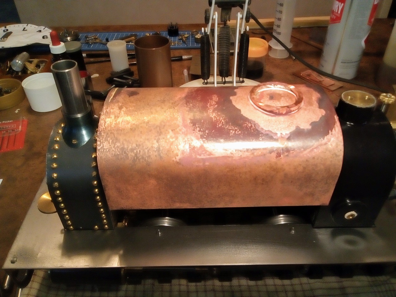

I finally manned-up and started on the saddle tank. Lots of procrastination about formers and bending rolls. But, I used some 0.9 mm copper sheet that I had got in for something else but never used. Once annealed it bent over the brass end pieces beautifully without any former or rolls. The top sheet isn't fully connected yet but I thought I'd see how it all looks. The brass end pieces were first silver brazed to the semi-circular copper tank inner piece.
I think it looks more like the small quarry Hunslet, and if it does, it doesn't need the big large quarry dome :D

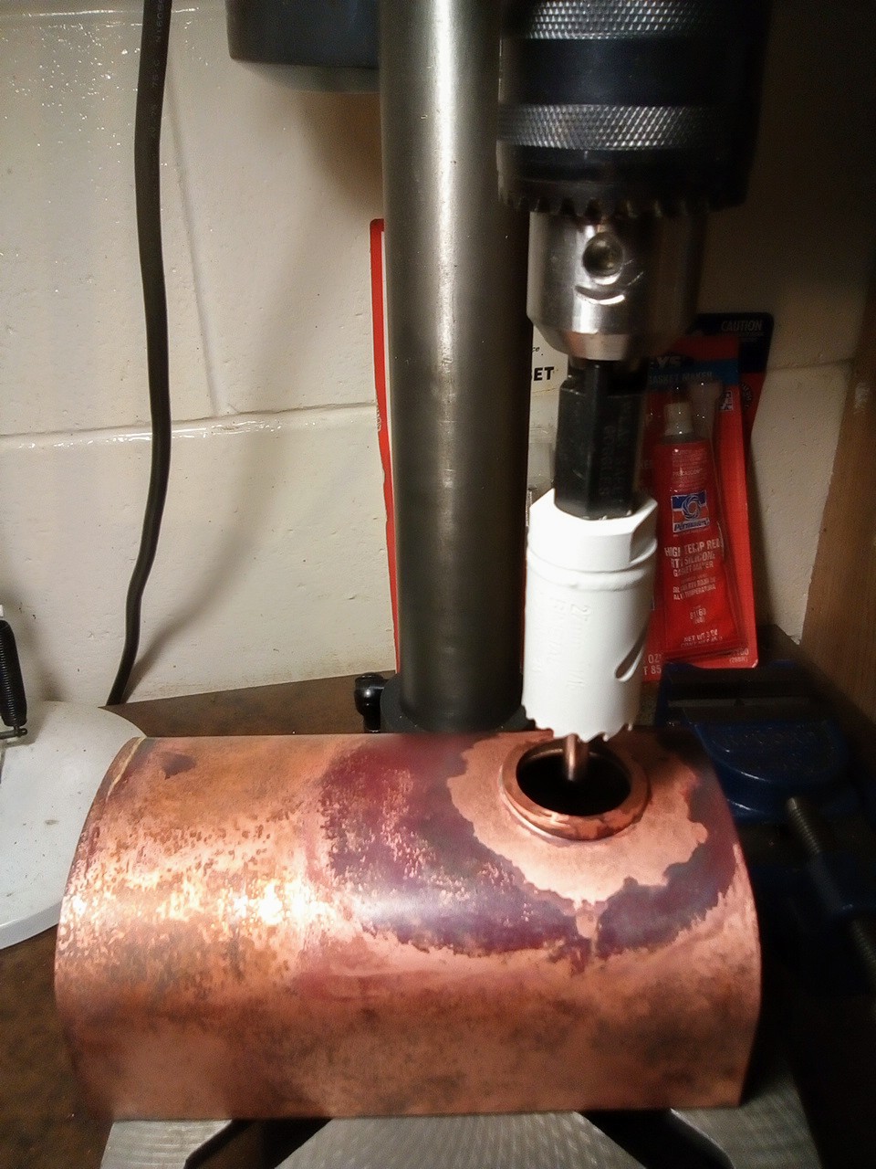

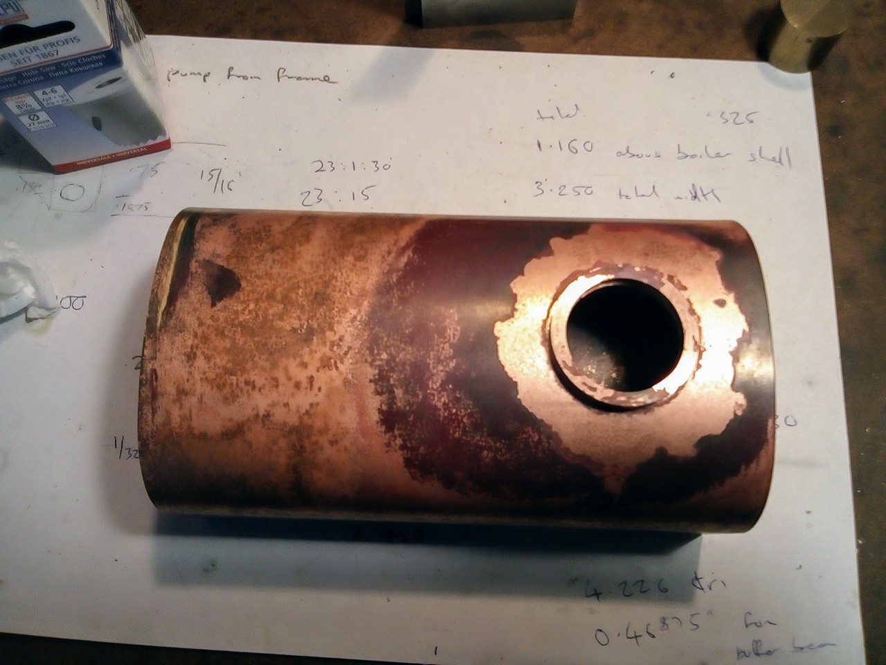

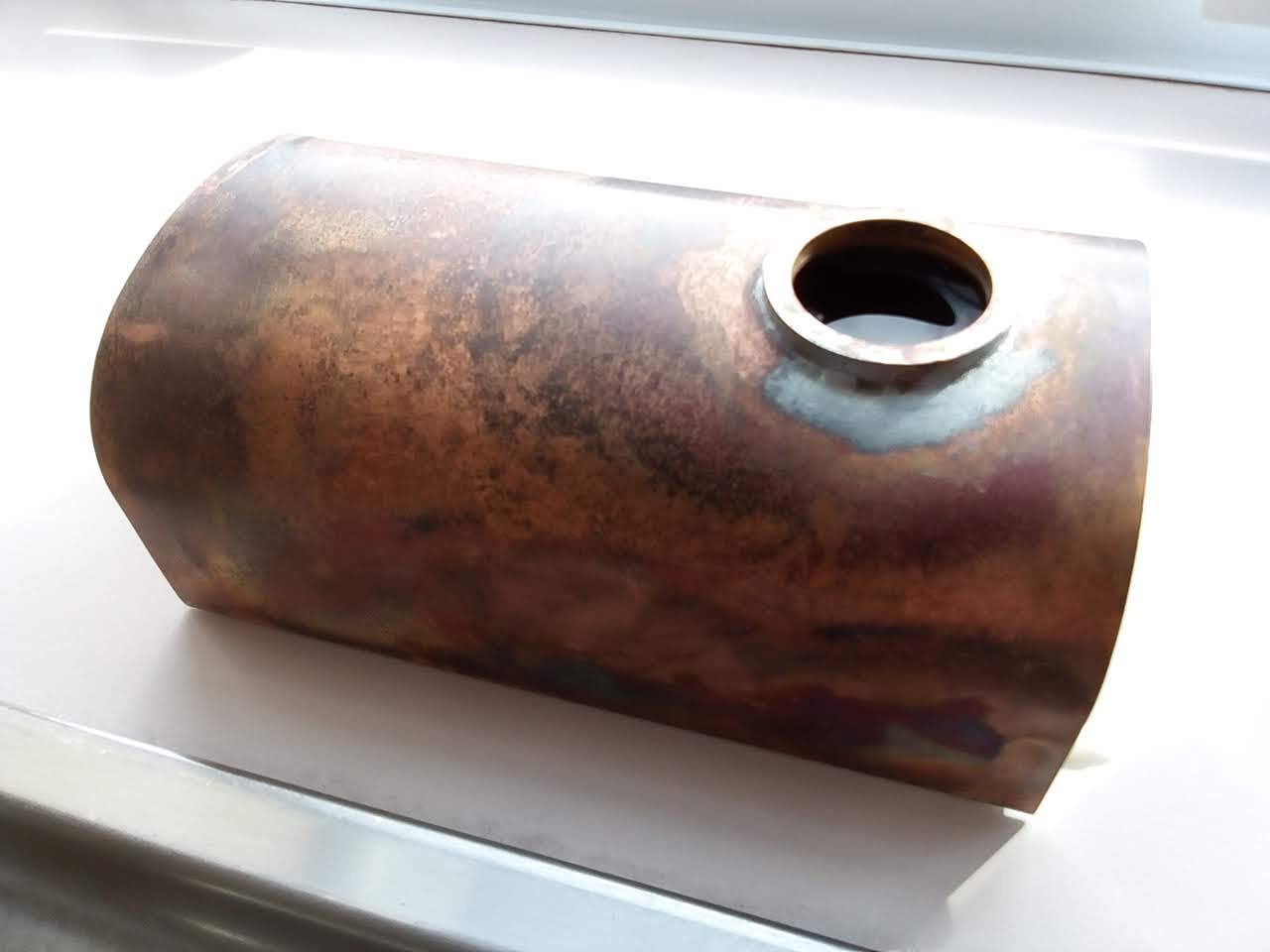

Working on the saddle tank. The filler bush was contoured to the tank top then brazed into position. Then the filler was bored through with my new hole saw. The 0.9 mm sheet copper tank wrapper was sufficiently rigid to take the boring.

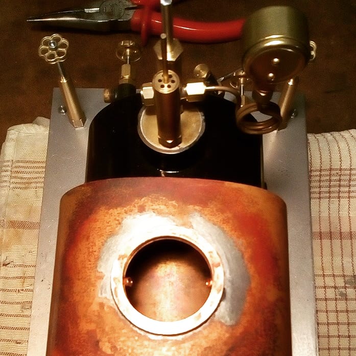

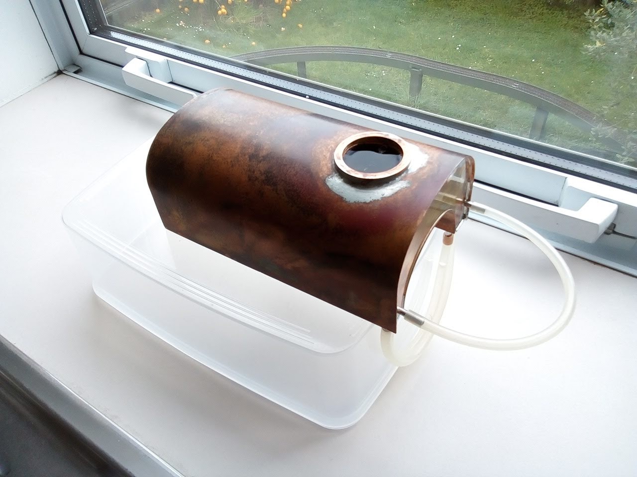

Whilst the tank is structurally brazed together it was not watertight due to some anomalies... So I sealed it with soft soldered, much like how boilers were sealed in the good old days
Best wishes,

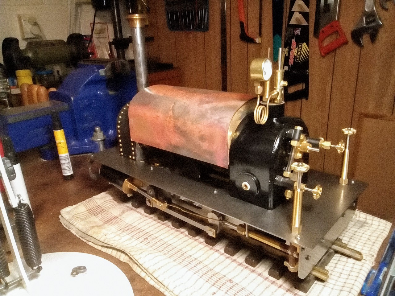

I've just soldered in the water return pipes for the bypass valves. Hopefully the water won't shoot out of the filler :thumbleft:

Post by dewintondave » Mon Aug 27, 2018 2:06 am
The tank is finally finished and still watertight
