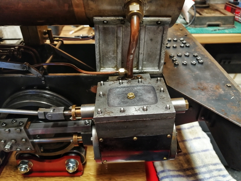

I while back I fitted stainless steel mesh inside the smokebox to stop any hot ashes blowing out the chimney which could set fire to dry grass or hit members of the public while running on the club track.
It was only until I did my last steam test with the newly fitted injector that I realised I could no longer access the exhaust nozzle to squirt oil down into the cylinders and push the engine backwards after a run (cylinders are made of cast iron, if left with condensate inside them the pistons are likely to rust solid - very bad).
If you look at photos of Kerr Stuart Wren class locos some of them have a single bolt located in centre of the steam chest covers. Not sure what function these perform on the Wrens but if I could fit bolts to the steam chest covers on my loco it would give me a way of getting oil into the cylinders directly.
I decided on 4BA brass hex bolts as the steel steam chest cover nuts are 4BA so size wise the hex bolts look alright to me (the brass 4BA nut in the picture shows the rough position of where I wanted the hex bolt to be located on each cylinder):

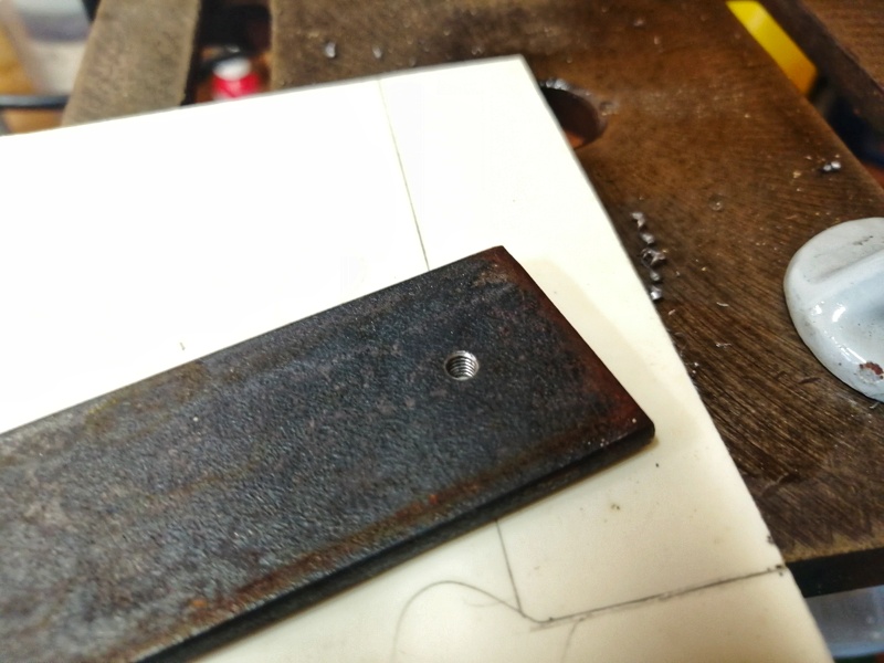

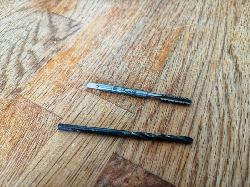

I have never tapped a hole before and given the importance of not making a hash of this I thought I should practice on some scrap steel. I had a raid through my drill bits box and found a 4BA tap and 3mm drill bit (you can Google what size drill bits you need to use for BA thread tapping):
I use to live next door to a retired engineer (sadly he passed away) and he would often give me bits and pieces that at the time I had no idea what to do with but I am grateful now that he did as the brass hex bolts were also from a collection of nuts and bolts he passed on.
I bought this pillar drill years ago and it has not had much use railway wise although it has come in handy for DIY projects:
https://gardenrails.org/viewtopic.php?f ... 1&start=15
However, it would be ideal to drill and tap the holes I needed!
Here is my practice piece:
The pillar drill was second hand and I would not use it for anything that required bang on accuracy, however, it has not done a bad job. When I tapped the hole I did this by fitting the tap in the pillar drill and then rotating the chuck by hand slowly using some oil.

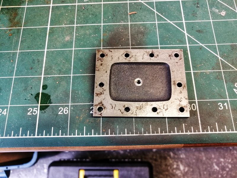

Filled with confidence now that I had popped my tapping cherry it was on to the steam chest covers!

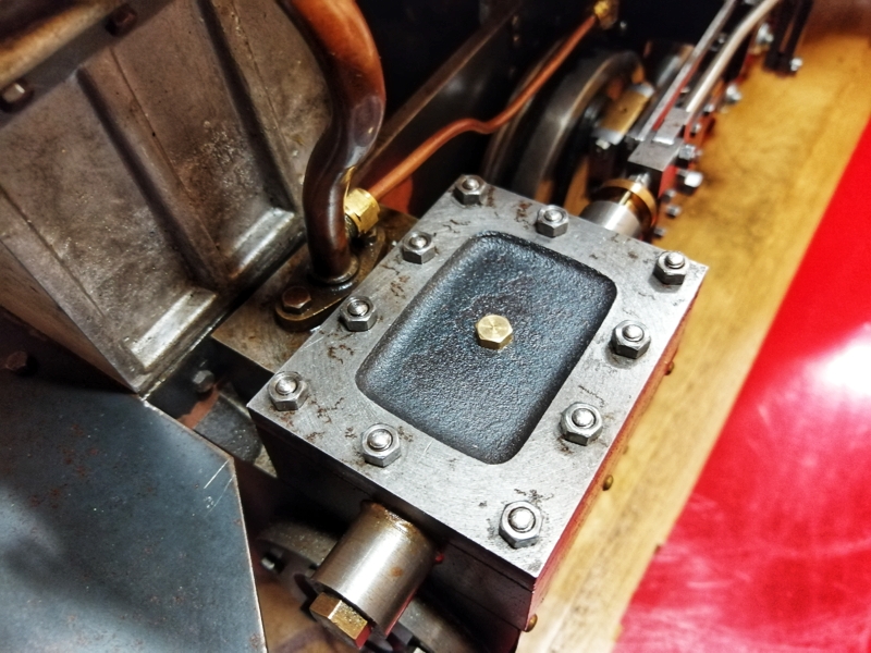

Here are the valve chest covers tapped with 4BA holes and fitted with brass washers and hex bolts (tapping a hole in cast iron is much easier, no swarf is produced just a powder like iron filings):
I liked the look of the brass washers to mimic the look of flanged bolts, however, they leaked slightly when I tested the loco on air with oil poured around the bolts to spot bubbles. I also tried annealed copper washers but I still had leaks.

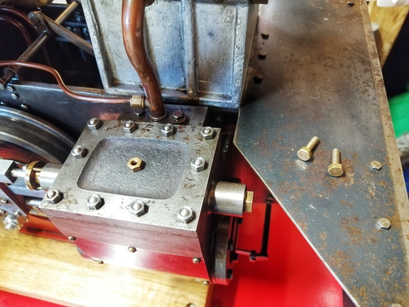

When I looked at the threads on the hex bolts I saw that they were not fully threaded up to base of the hex. Fortunately, thanks to my late neighbour I found a 4BA die he had given me and was able to thread the bolts fully so I could tighten them down against the surface of the cylinder cover (I couldn't do this before which is why I had to use washers). Another air test was performed, however, one of the bolts still leaked slightly and I had to over tighten the hex bolts which concerned me as I did not want to snap a bolt inside either cover!
My engineering friend suggested that to achieve a good seal between the bolt and the surface of the cover I would need to 'spot face' them as the cast iron finish of the covers is pitted.

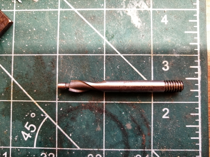

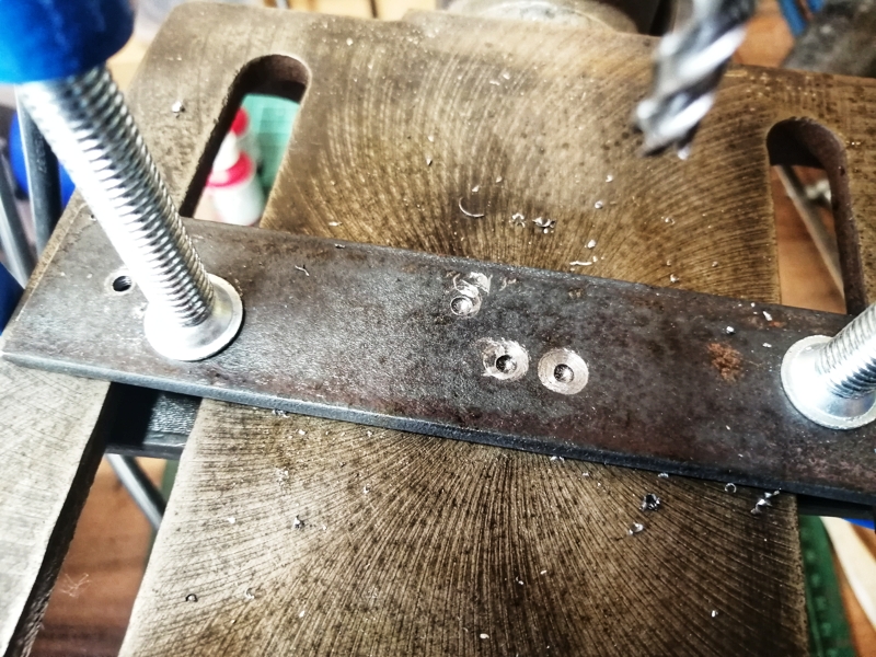

As I don't have a milling machine where you could use a mill cutter bit to face the holes I needed a bit that I could fit to the my pillar drill that would not wander all over the place (this is what I have learned is called 'chatter') when I applied pressure. I found a second hand 4BA counterbore bit with a stub online so that it would could fit inside the threaded hole and centralise the bit:
Unfortunately, when it arrived it was not 4BA sized at all so it did not fit the threaded hole. The seller measured the others he had in stock and agreed they were incorrectly sized so I got a refund but I was back to square one with what to do.
Despite not having a milling machine I decided that I had no choice now but to order a set of HSS end mill cutters and give them a go.
Before trying any of the mill bits on my covers I had a go on some scrap steel, however, the chatter was really bad and the bit regularly wandered off target as can be seen in the below picture (last attempt was not too bad though):
Now steel is harder than cast iron so it was a big ask of my little pillar drill to be able to do this accurately so I moved on to the covers. However, this time I lined up the tapped hole in the cover using a 3mm drill bit and then removed this and fitted the mill bit so it was lined up centrally. I also turned the chuck by hand so I could control the mill bit when it wandered off target.
Eventually, I ended up with a spotted hole!
Not as neat as I would of liked, however, you cannot see the surface finish once the hex bolts are fitted:
I have tested on air with the bolts nipped up and no leaks so far although a steam test will need to be performed to confirm all is well.
Finally, here is the reason why I am going to all this effort (so I can oil the cylinders after a run):

Good job Tom! Endmills in a bench drill tend to be a disaster
