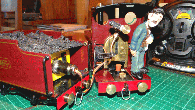

Hi - first post.
I'm running an MSS side-tank which I have modified to include Radio Control. I would love to know how to get hold of a tender apron, as I can't get my 'driver' on the left side of the cab owing to the servo (which operates the steam regulator) being in the way.
I also found that some self-adhesive magnetic strip under his boots keeps him sufficiently anchored.
(I'm afraid it won't let me upload a picture)

jameswmorgan
Cab, Radio Control, Tender and Bloke
Success with the picture. The plan is to further the R/C by adding another servo to operate the reverser, but I'm trying to work out a mechanism whereby you don't have to keep the R/C engaged all the time. We now have a Maplins in Huddersfield, so something might turn up. However, it's way down the line.
As it were.
Jim

Jim,
Thanks for posting your photo. Your driver (a Rob Bennett Busy Bodies?) has wider boots than my Fireman and his feet are closer together. As those neodymium magnets are cheap enough I'm going to order some to try them out.
Your in cab regulator obviously has a coarse enough thread to allow sufficient control using Radio Control - is that a Dream Steam regulator? For your reverser linkage you could use Qwiklinks on the control linkages which are easily removable. As you are using 27MHz it is best to not have metal Qwiklinks on metal control horns to reduce the interference they can generate.
