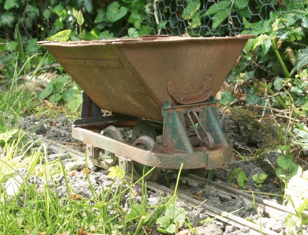

I've just finished the first of a couple of IP Engineering 7/8ths skips. Quite hefty as the bucket is white metal (the chassis is plasticard). I used Accucraft wheels on my 18in gauge version as the axles are a little short on the wheels supplied with the kit - they would need a lot of packing in the axleboxes to stop the axles dropping out.
Next, an 18in gauge IP cabless Ruston...

have you used "Real Rust" or is that a paint technique?
astropsidings
Posts: 24
Joined: Wed Nov 28, 2012 2:17 pm
Location: Salisbury
Post by astropsidings » Tue Jun 04, 2013 1:15 pm
Its paint. The whole lot was sprayed with Halfords red coloured primer, then painted by hand in various shades of rust with talcum powder stippled in to give the texture. The chassis was then sprayed with JLTRT BR Southern Coach Green using a salt mask (the salt retained with a coat of hairpsray). Finally weathering powders were used, and the whole lot sprayed with Testors Dulcote.

What method did you choose to join the hefty whitemetal parts please?
And is the relatively flimsy frame up to supporting the heavy bucket please?
Thanks, David
astropsidings
Posts: 24
Location: Salisbury
Post by astropsidings » Wed Jun 05, 2013 12:00 pm
David,
I used low melt solder, but a non-temperature controlled iron. It wasn't as awkward as I expected. I tacked the bits together first then went back and soldered them properly.
The chassis frame is a bit flimsy initially but fixing the end stanchions to it stiffens it up and it takes the weight of the bucket without a problem. I may use Talisman brass axleboxes on the next one rather than the white metal axleboxes supplied given the weight.

The chassis made of plasticard it doesn't make them top heavy then
astropsidings
Posts: 24
Location: Salisbury
Post by astropsidings » Thu Sep 05, 2013 11:19 am
METHSSNIFFER:87833 wrote:The chassis made of plasticard it doesn't make them top heavy then
Despite the bucket being fairly hefty it isn't top heavy. The stantions and other detail on the frame are white metal castings which help.

I do like these but are iunsure of the chassis
railwaygardener
Post by railwaygardener » Tue Sep 10, 2013 9:58 am
I've made up three of these and they are a bit curate's egg. Top half of heavy metal and bottom half of light and flimsy plastic. Making the chassis in a box section helps rigidity, but I still feel the need to handle them with extra care. However they look and run well behind my quarry Hunslet.
