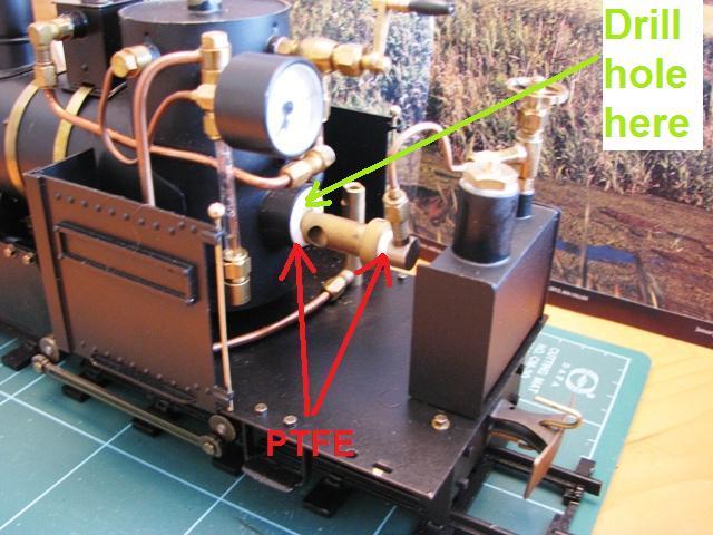

Sorry Mike, I appreciate a photo tells the story better but I did not have access to an appropriate one and it was too late & dark to pull my Lumber Jack out of its box. Hopefully this one will make sense.
As I understood the conversation Mike Ousby drilled a hole horizontally in the position marked by the green arrow to allow the secondary air direct to the burner.
This of course would appear to have the opposite effect to my wrapping that ring with PTFE tape to stop air getting in. I intend putting some filter paper/tea bag material behind my jet to see if I can reduce the likelihood of another blocked jet.
Chris Cairns.
Chris Cairns.
