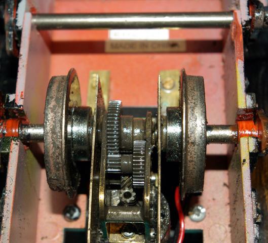

Having got back into 16mm modelling after a long break I bought an Accucraft Baguley to get something running, but was suprised to find how toy-like the mechanism was. It didn't work particularly well, and was allocated the number 2......

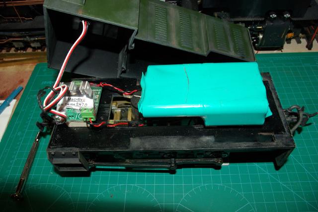

To try to improve matters I built a new chassis using an ABC Gears motor and gearbox originally intended to go into a 7mm scale 9F, modified to take a 5mm axle. All axles run in Slaters axle bushed drilled out from 3/16 to 5mm. As the coupling rods now had to do a proper job they were strengthened by making brass rods and gluing the plastic rods, suitably thinned and profiled, to them.
A Brian Jones speed controller was fitted, with a 2.4GHz radio receiver, and a Strikalite battery pack. The whole lot was wired as per the wiring diagram that came with the speed controller. There's no sound, yet, but it's something I'm looking into.
The motor is relatively small (a Canon I think), but the gearbox is quite efficient and allows the small motor to produce a reasonable amount of power at the rail (it's not a worm drive). I would imagine ABC would make a gearbox to suit a 5mm axle as they're built to order I believe.
Running isn't perfect but reasonably smooth and slow speed running isn't too bad.
I also modified the couplings to an H shape to allow a hook to be used to couple to slate wagons/skips etc.

After a 18 months or so of hard work the gearbox wore out! Or rather it did, but in one direction only.
My line is end to end, mostly on a a falling gradient in one direction only, and I always run locos the same way round. And one day, having gone down the line the Baguley wouldn't come back up again. The gears would no longer mesh in that direction on account of the wear induced by grit, the odd leaf and dragging heavy trains up the hill.
So a new Accucraft metal chassis was ordered, and now belatedly fitted, having had battery powered r/c etc fitted, and the buffer beams modified as per the old plastic ones.
