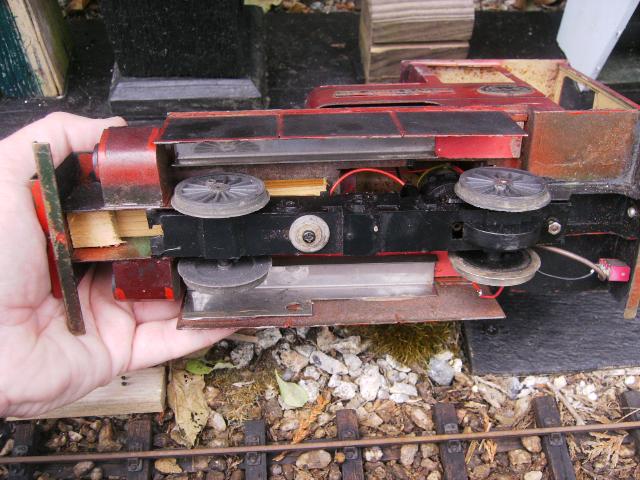

I have 2 chassis , one being as fitted to the Peter Jones Sir John BAKER.
I will warn you the flanges are small, and the wheel base inflexible due to the plastic bushes sticking out of the chassis.
I got around it by trimming the none powered front and middle to float, and fitting top hat bushes to the chassis.
Metal wheels (as with 12v version are better than the 3v plastic (which mine are)
The 12v has a motor similar to those found on the diesels and 3v a vertical motor with plastic wheels (red or black)
12v find the wires for the pick up and connect to speed controller and batteries.

Lima 3v chassis
Sir John BAKER chassis as obtained from late Peter Jones family
front axle floats to allow 2'6" curves..does slip off on occassions as flanges are not as deep as 16mm wheels
Crackingjob
Lima 3v chassis
