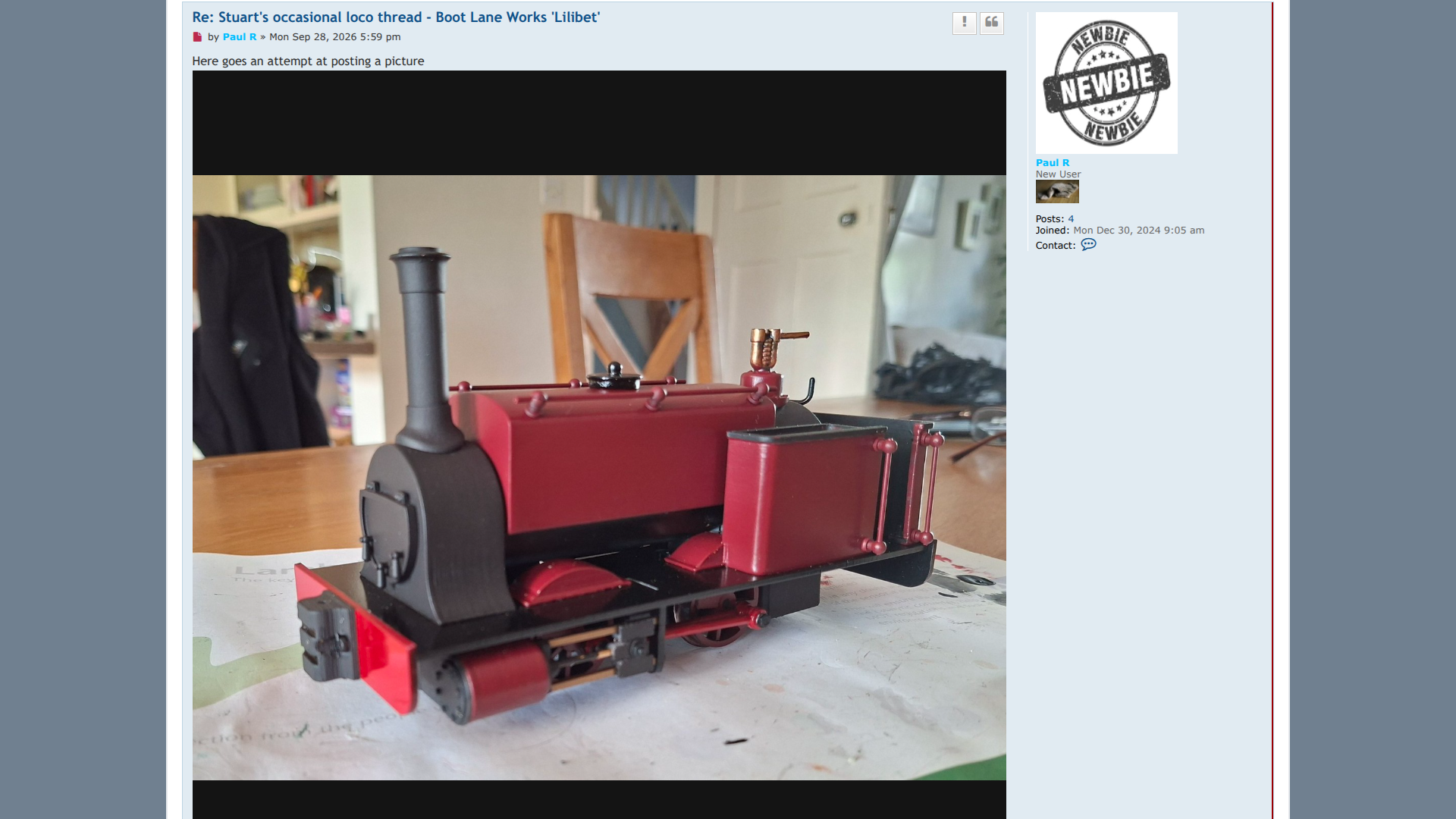

The loco is gorgeous, I like the cab.
I have just completed one, but looks very plain compared to yours! I might try your idea of the plasticard outer layer.
I spent a great deal of time applying filler primer and sanding repeating over several weeks. It did look very smooth in primer but after applying the colour you can still make out imperfections in certain light!
I would have added a picture from Flickr but I don't know how!!

Here goes an attempt at posting a picture

Sorry Paul, whatever you did doesn't seem to work.
I have no experience using Flickr myself. Hopefully somebody else may be able to help.

I'm able to see it?

I can see it.

Thanks guys. I can see it now as well, but yesterday evening I just had a big black square. No idea why.

Hi PaulPaul R wrote: Sat Sep 26, 2026 10:28 am The loco is gorgeous, I like the cab.
I would definitely recommend the styrene method. It saves a LOT of time and brings a much better final finish. I just glue one side and clamp it. Some time later I glue the other side, make the bend and clamp again. It only works for reasonable bends though, otherwise the styrene breaks. I wouldn't go any smaller than the bend on the bunkers.
Your Lilibet looks great though! I do slightly regret squaring off the smokebox; although prototypical for the locos I was basing it on, it did make it look less Manning Wardle like.
