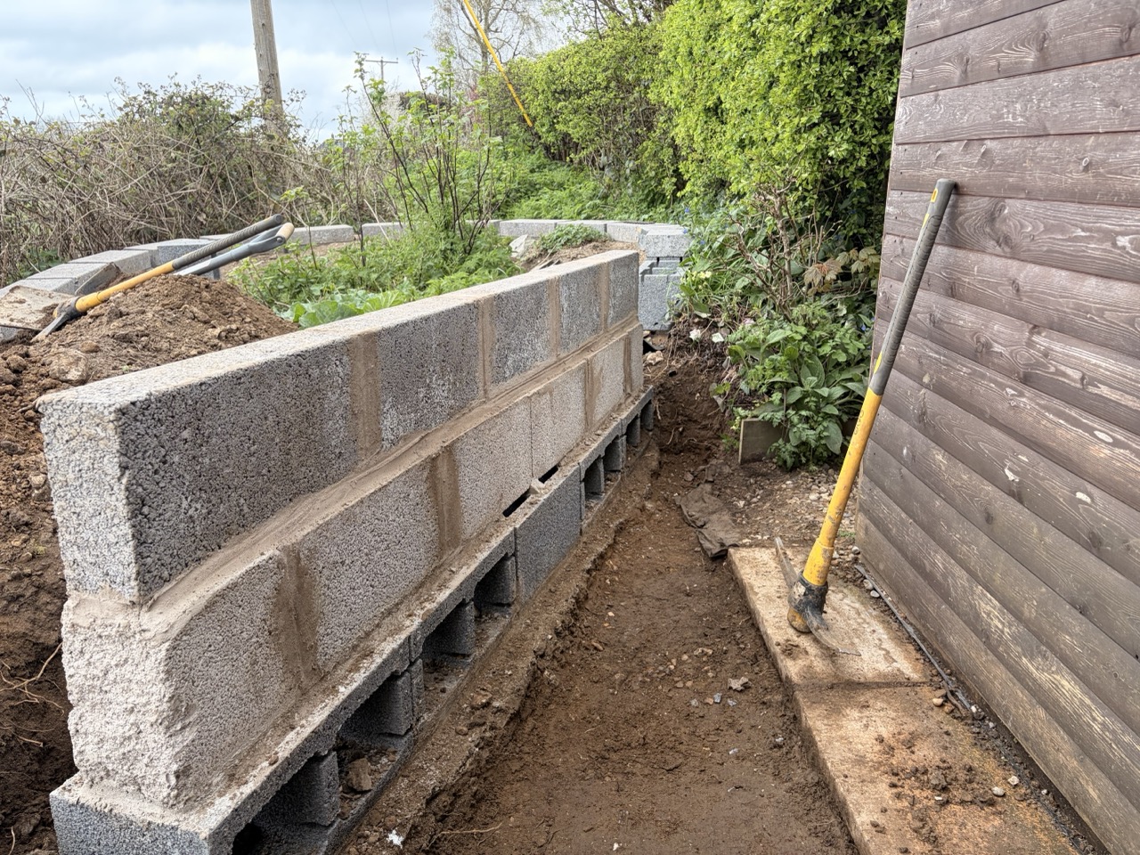

Work could now return to behind the Shed.
A trench was dug, groundsheet placed and then filled with Hardcore.
This was levelled to the nearest inch before compacting.
Carrying blocks gets quite repetitive
Signs of a railway appear at last! The first block has been laid behind the shed.

I have stacked the blocks in doubles rather than like a typical wall on purpose. My theory is, when the ground inevitably shifts or a tree root gets underneath, individual blocks can be relevelled with much less destruction to the rest of the track. Lets hope I don't have to do much of that in the future!

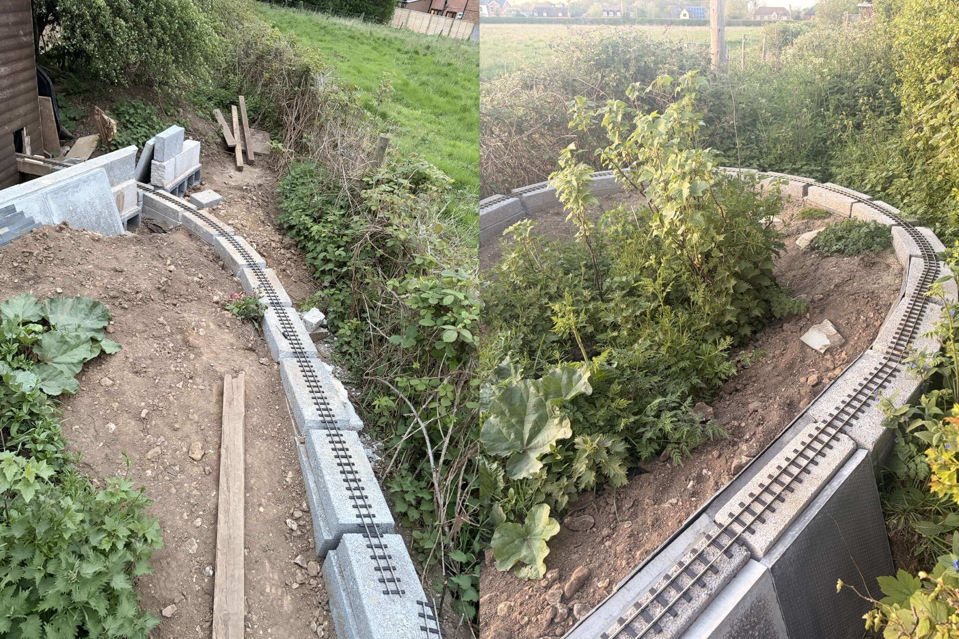

The build continues:
The neighbours must be very confused - more block laying in the dark.
IMG_4007 Large.jpeg (424.01 KiB) Viewed 325 times
All the blocks laid before the next phase.
IMG_4027 Large.jpeg (658.72 KiB) Viewed 325 times
Starting to put soil back. You need twice as much as you think!
IMG_4047 Large.jpeg (484.25 KiB) Viewed 325 times

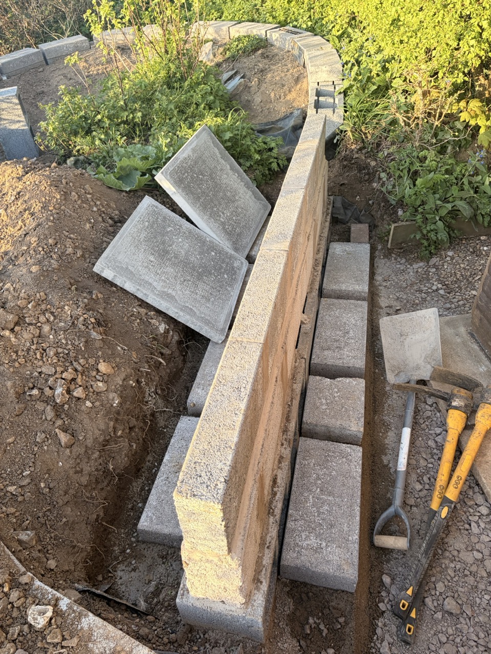

Now time for the main event. Earlier I said how the railway was missing the drama of some serious civil engineering, so I decided to include an interpretation of Cei Mawr — the 60-foot-high stone embankment. https://www.ffestiniograilway.org.uk/ga ... #gallery-2
So here is the start:
A foundation was laid. 2:2:1 aggregate - sharp sand - concrete
The wall will be constructed with blocks in descending widths to make the base sturdier.
mock up on the patio:
IMG_4250 Large.jpeg (268.86 KiB) Viewed 316 times
Blocks in - I do house extensions at your own risk.
IMG_4275 Large.jpeg (621.47 KiB) Viewed 316 times

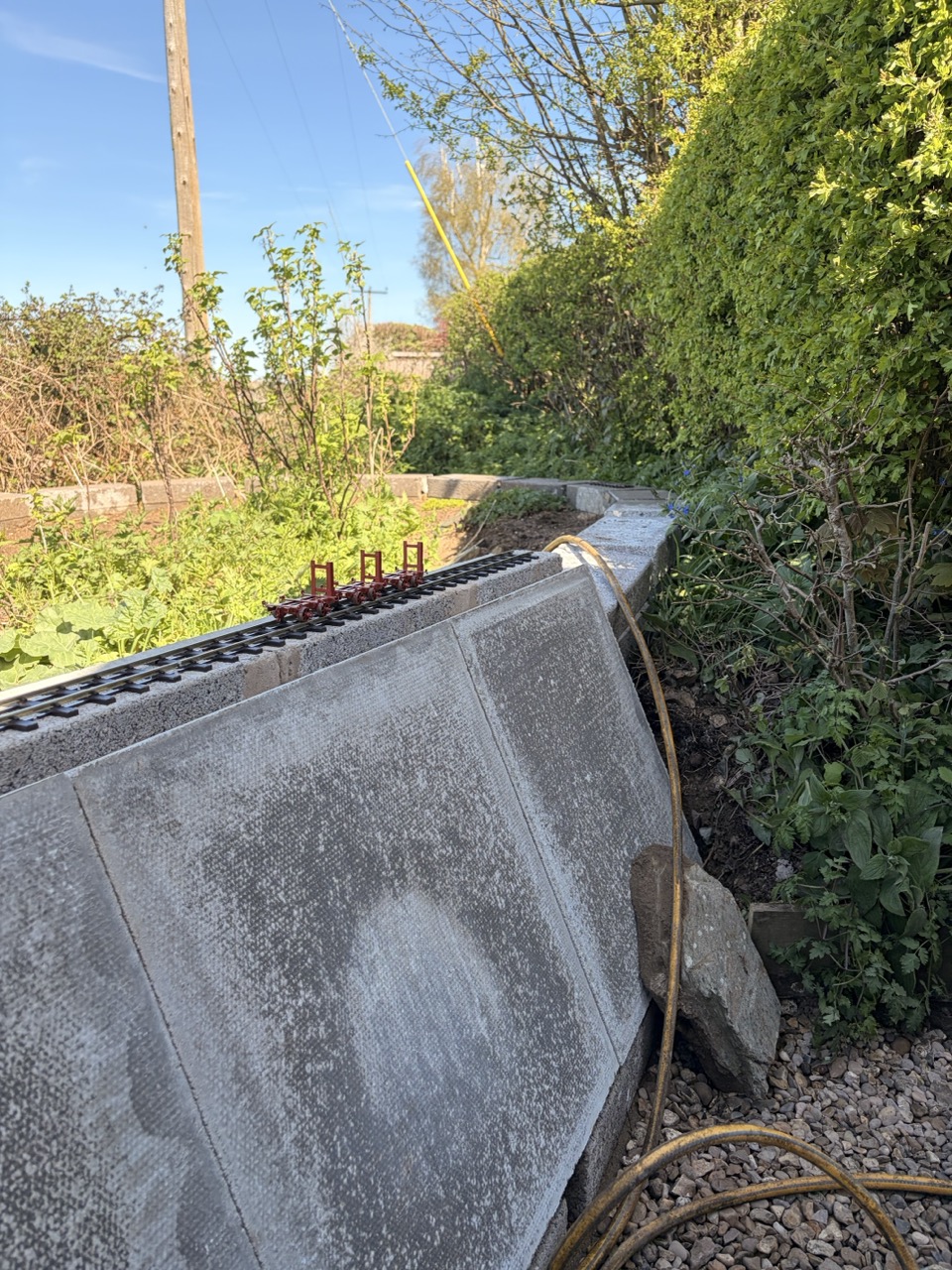

The slabs create the angle of the dry stone wall. The gravel has been laid to join up with the existing garden path.
Note how the thickness of the slabs and the block on end is the same as the blocks laid flat.
IMG_4352 Large.jpeg (537.9 KiB) Viewed 39 times

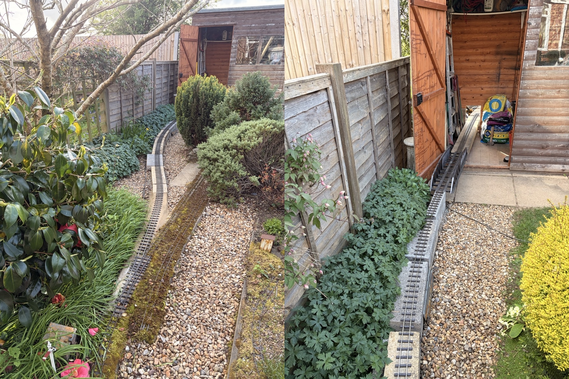

From the existing line and through the shed:
to the shed.jpg (1.85 MiB) Viewed 36 times

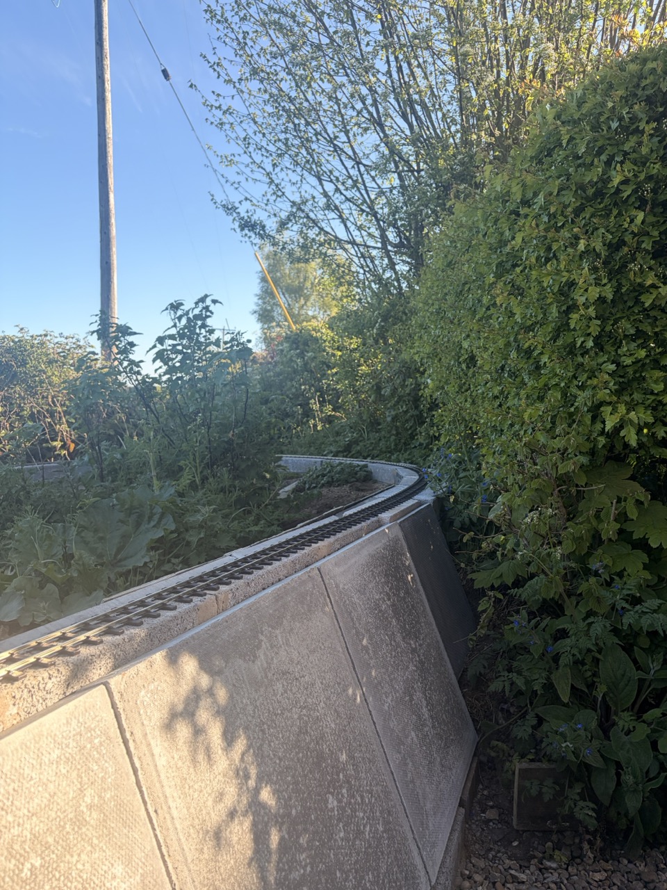

The line continues to climb:
after the shed.jpg (1.8 MiB) Viewed 36 times
