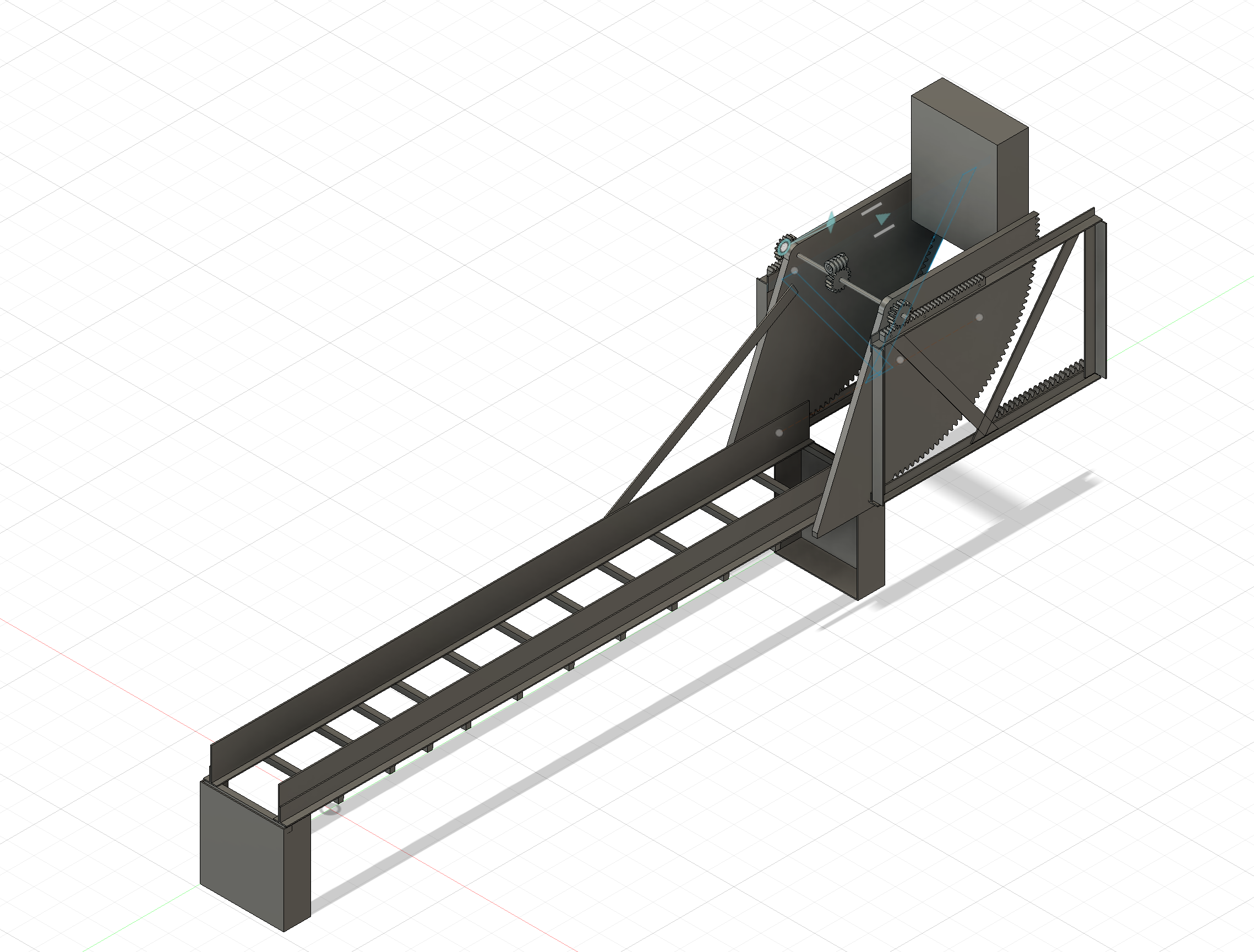

I have started yet another project! (to add to all the other things I have yet to finish)
Dinah has been complaining for a while that it is difficult to get into the garden when trains are running, and David inadvertently gave me the idea behind this.
So I had been wondering how I might make the bridge easily openable. What about an automatically opening Bascule Bridge?
Daft idea - overly complex - it just needs a hinge. I know! It isn't even model of a real bridge.
Anyway I have designed it and started to build it.
So the design:
Autocad Fusion has a built in gear generator - which made it easy to design this bridge - and I have explored how to make assemblies which actually move as they should. That sounds like a gimmick but is actually quite useful. I can see that the rack and pinion motion actually works as an assembly before actually building anything.
So an animation of it actually opening:

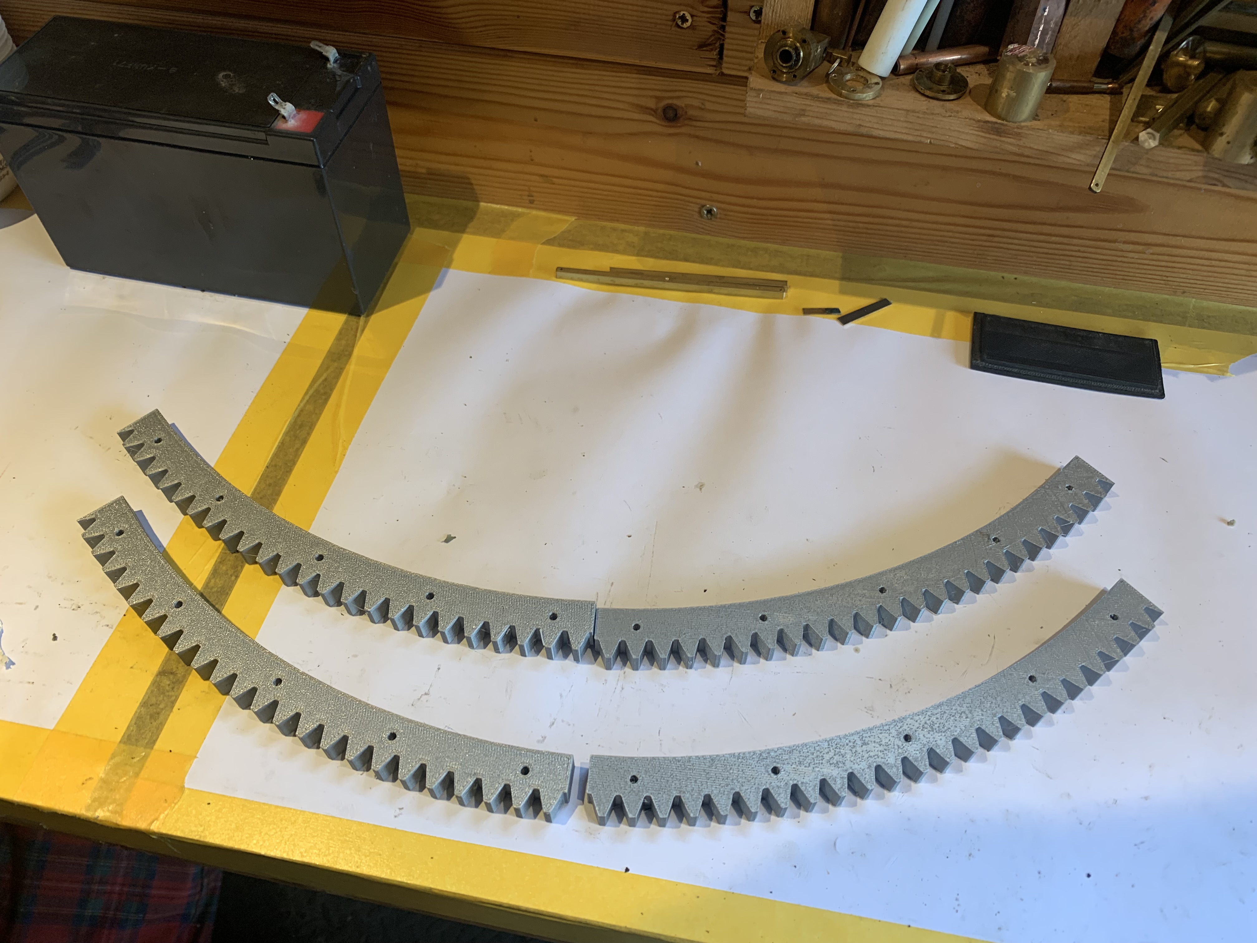

While much of the existing bridge will be reused I will have to make a few more alloy parts. All of the gears and racks should work as printed components which will bolt to the aluminium:
Here are the first components, the segments of large gears printed in two parts, upon which the bridge rests. They will be bolted to aluminium plates.
- SimonWood
- Posts: 814
The best sort!
Glad you can result the existing bridge which is very nice - but it will be really convenient to be able to lift it to pass.While much of the existing bridge will be reused I will have to make a few more alloy parts. All of the gears and racks should work as printed components which will bolt to the aluminium
- Posts: 5729
Nice idea Trevor. My first thought was of the Bascule rail bridge crossing the Towy in Carmarthen. Although built for standard gauge, it still carries the Carmarthen-Pembroke Dock trains several times daily. No longer in working order it was built to allow sea going ships to dock in Carmarthen quay, which was first established by the Romans.
An AI search has confirmed many Bascules were built for industrial, military or regional lines, crossing rivers, docks or canals, so you have prototypes to fall back on.
