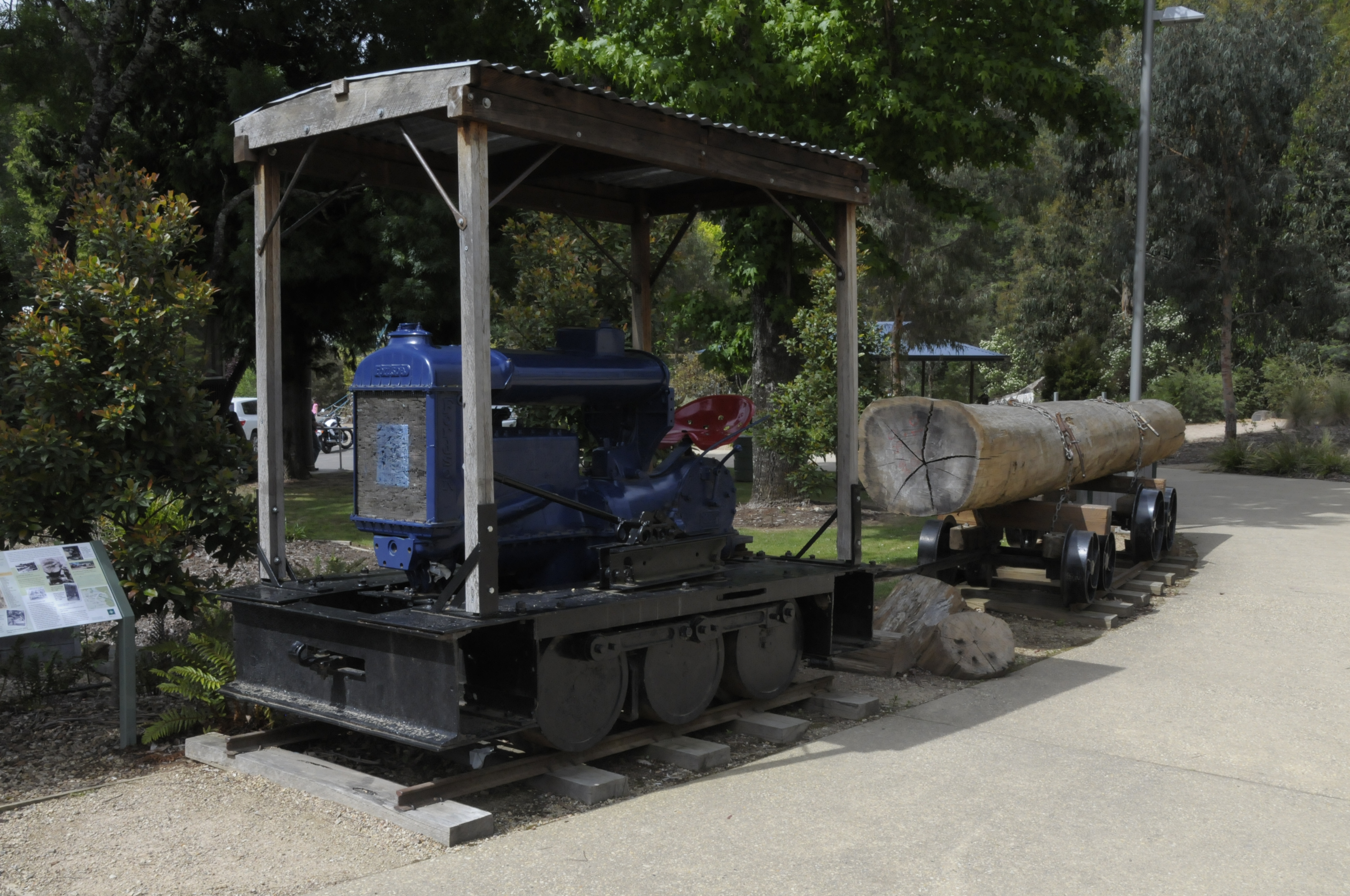

A Days Tractor has been on my list ever since I saw the Marysville one back in 2002. Very nice!
Timber Tram by Stuart, on Flickr

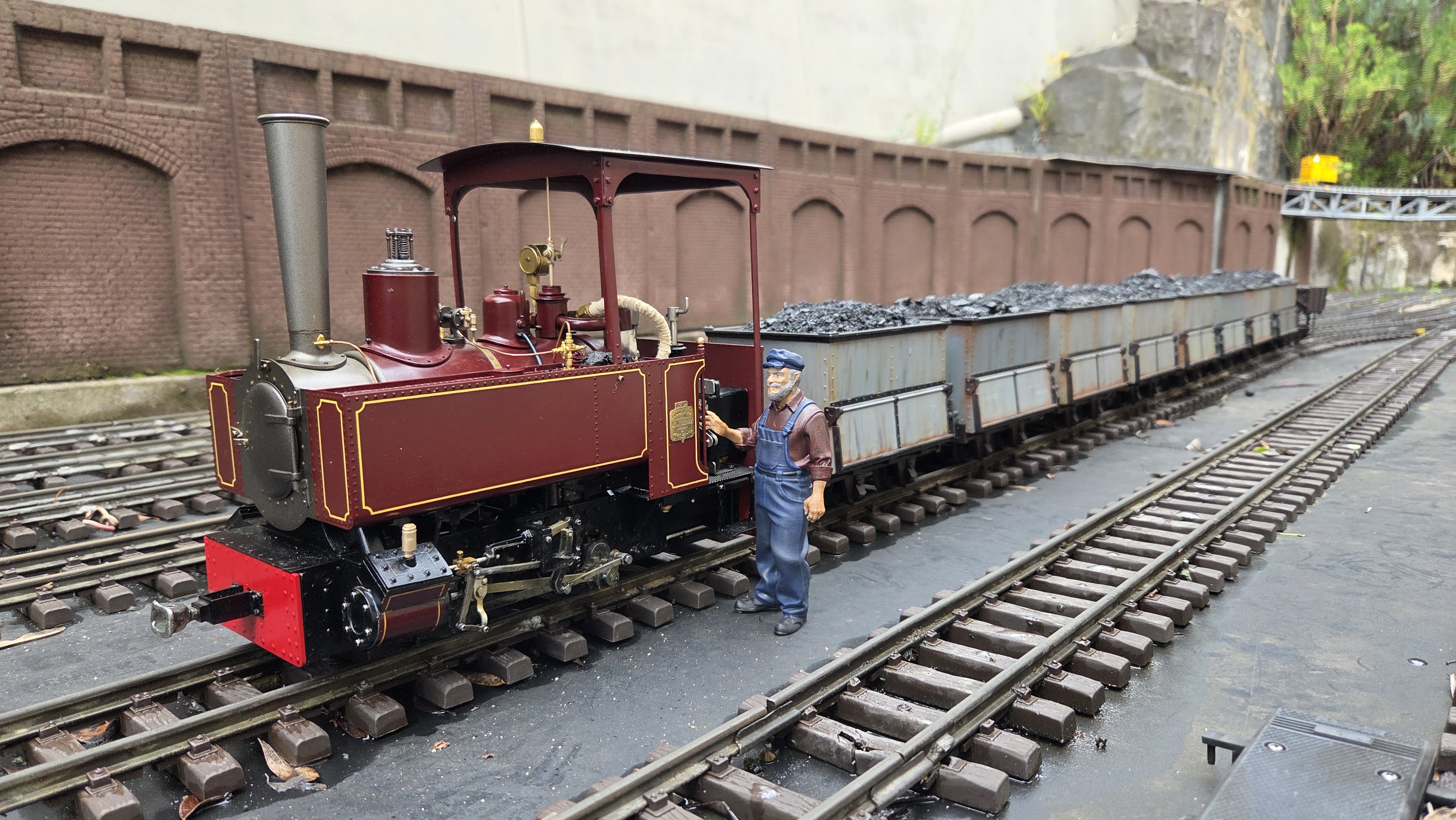

We have a pair of Fordsons at Woodford from a colliery. They ride on 2' gauge converted leading bogeys from 3'6" 4-6-0s.

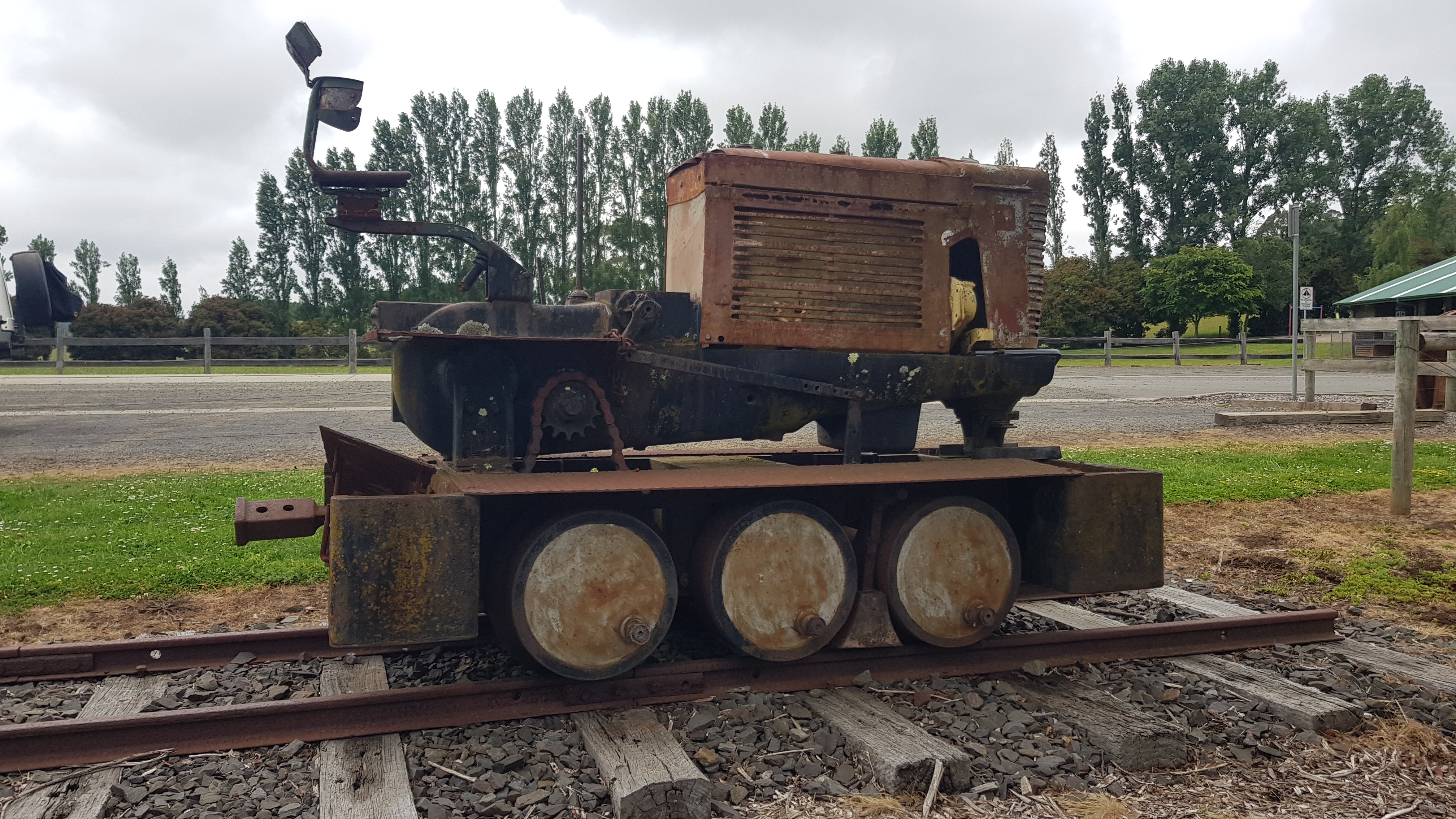

The Days tractor at Marysville was in the 2009 Black Saturday fire that destroyed the town along with the loss of 15 lives but has been refurbished and is now located behind the new visitors' centre.
The remains of Ezard's McCormack Deering tractor are at Erica in South Gippsland - as it is unrestored it might give an idea of original colours?
