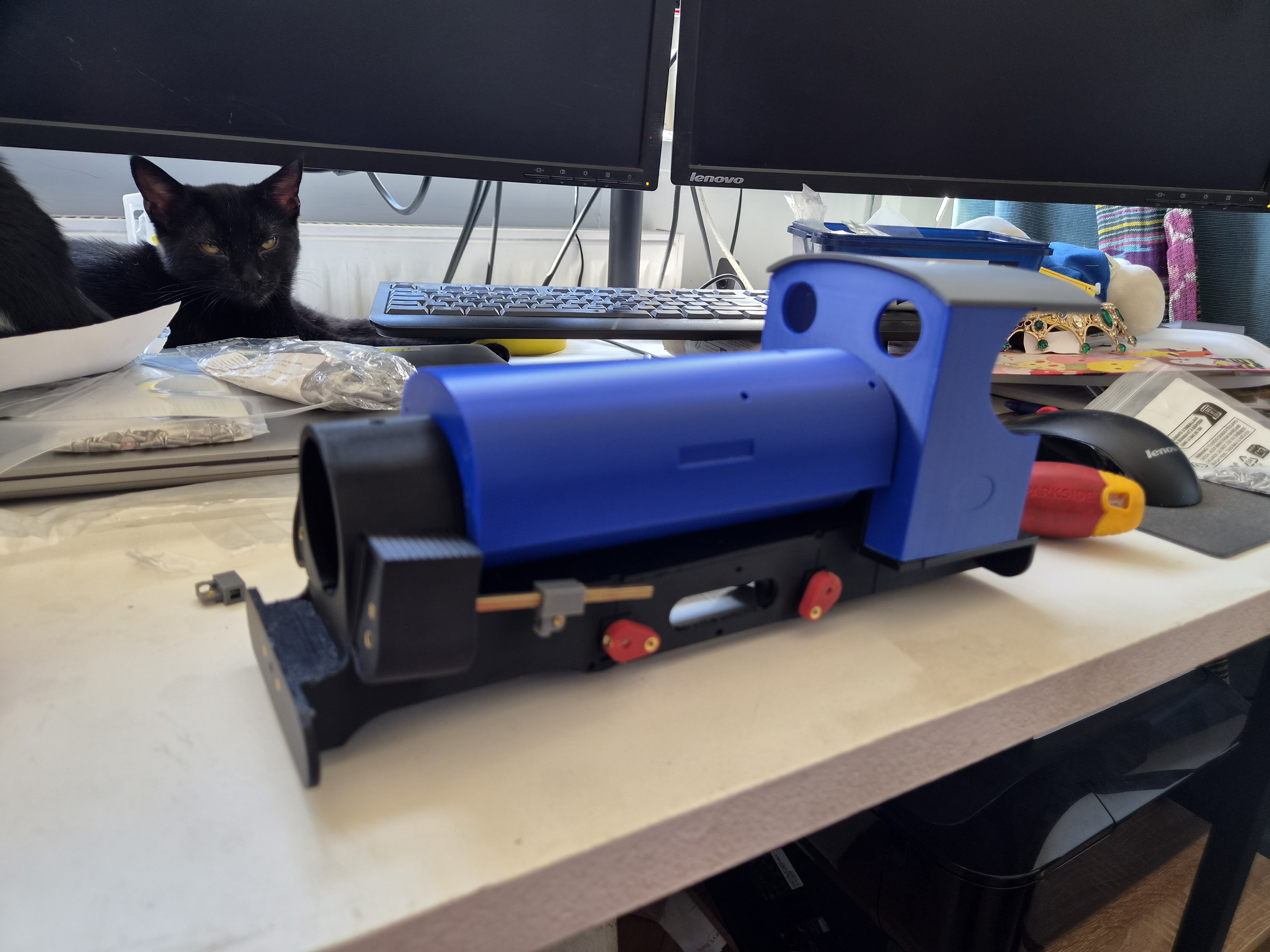

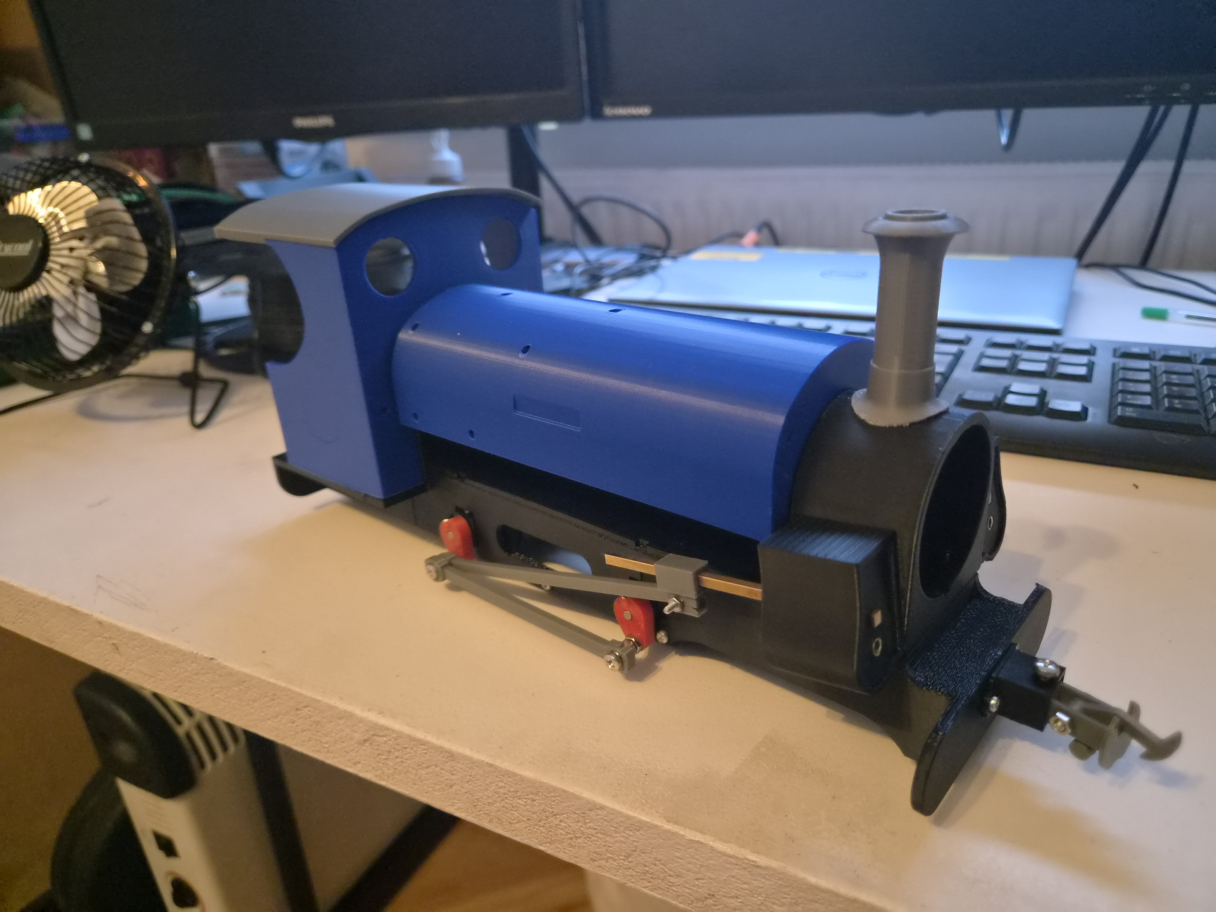

Here is my latest model, Linda.
All printed in ABS with roller bearings and sprung axles.
I've tried to stick to as close Ffestiniog form as possible.
The tender is drawn and ready for a trial print.
I will update as I progress

Thanks all.
I've got a fair bit to do yet, as I'm not happy with the print of the main frames, and the springs are a bit stiff, so i need to add a bit more depth to the spring holes in the frames.
The bearings came from a Chinese online website and had the description 3mm roller bearings. They run nice and smoothly so I'm happy.
I've just left a 10mm slot in the frames, the axle box is printed 0.2mm smaller so that it slides up and down easily. It took a few prints to get the clearance just right, and ive found that tollerances are different on my new bambu printer to my old ender3.
I will post some photos of the set up this week.
I only tried the sprung arrangement as I found the bits online and it worked well on my precious model, the Cheese-06.
Not convinced it brings much advantage in an 0-4-0.
Neil.
