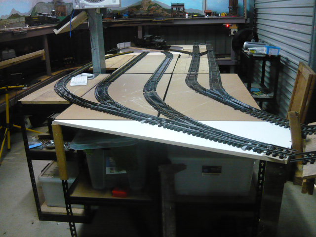

I used racking to build part of my layout, it is sturdy but light weight.

The steel is powder coated straight out of the box, it is workshop racking.Wet Woking Neil wrote: Thu May 14, 2026 12:31 amI like that idea, and will look into it. Have you put any form of cover or protection on it?GAP wrote: Tue May 12, 2026 10:24 pm I used racking to build part of my layout, it is sturdy but light weight.
The timber will get a coat of paint and as it is under cover it will be OK.
If I was doing this on a verandah/porch I would paint the timber with exterior paint.

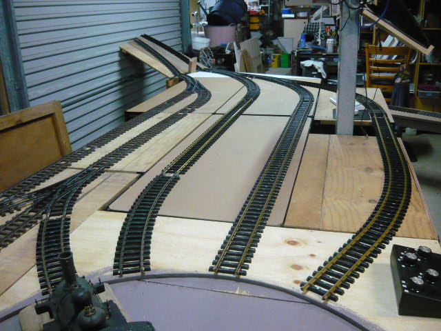

Hi, I’ve just noticed your post about raising a garden railway to waist height, which is what I had to do when I downsized with a small garden and a large patio around the conservatory. My railway stands 32 inches high and is built from recycled timber posts, pallets and new decking boards for the baseboards. From the attached pictures you will see the posts sit on kitchen cabinet legs to help protect the posts from rotting and also for levelling the baseboards. I should add that I built this 5 years ago.
Ok, I was fortunate in having to replace some fence posts which had the rotten bottoms removed and the remainder was cut in half to provide 2 posts. Also, my daughter & son in law had a new bathroom suite delivered on a very large pallet that once broken down provided some decent length boards to space the legs lengthwise apart with smaller pallets providing timber for the width. I was therefore able to build 3 baseboards each approximately 8 foot long and 2 foot wide.
The layout is end to end with the boards on the patio being joined by a smaller width baseboard supported on 4 legs that are buried into a flower bed.
Just something else for you to consider but it may not be everyone’s cup of tea but having a garden railway at waist height, I find is a blessing.
Good luck with yours.
Ray
PS I’m busy laying some dual gauge track if you think the boards look a little sparse
Ray

Clever idea to use the kitchen cabinet legs - not only for adjustment, but also to discourage the dreaded rot ....
