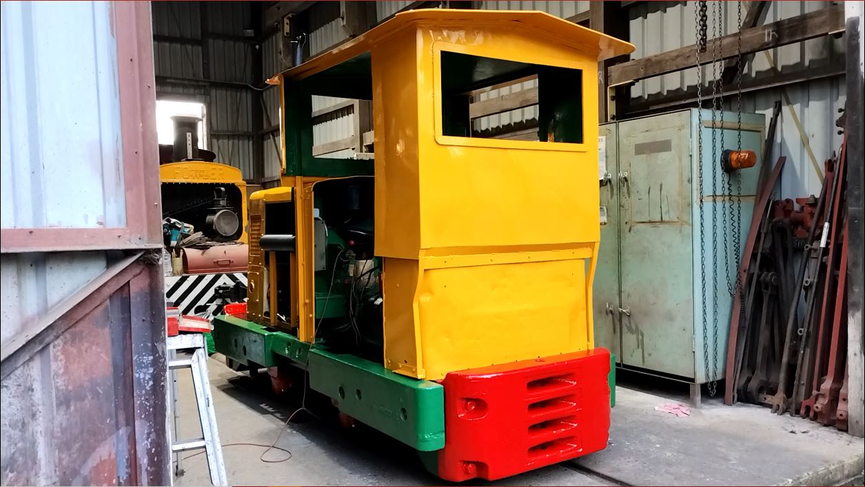

The 3mm steel intended for the cab rear had been pinched for another job, :roll: and replacement sheet was to be added to some future order.
However, the large wheel lathe we've just acquired, has a guard of 1.5mm sheet, fitted over it's existing (and very tall, almost two stories) drive belt arrangement.
As we may well end up redesigning the drive (or build the next workshop annexe around the lathe!) we have little need for the guard.
Once removed from the lathe, I realised it had some stiffening creases in it. After some time with the club hammer, and those angle iron loco stands in the background as anvils, the sheet was flat and could be cut into more manageable halves.
The rest of the day was spent stripping the surface rust, and scuffing back any paint that didn't have rust bleeding through.
23/03/25
By the end of the next weekend, the rear wall of the cab was finished. Along with the original front/rear window frames fitted and cleaned up.
I will admit, there's no small amount of heat warpage, and half my welds look like sh**.
But I learn by doing, and the original mill job wasn't brilliant either. Besides, there's no-one else to get it done.
Bog will disguise all sorts of things.. :lol: :lol: 8)

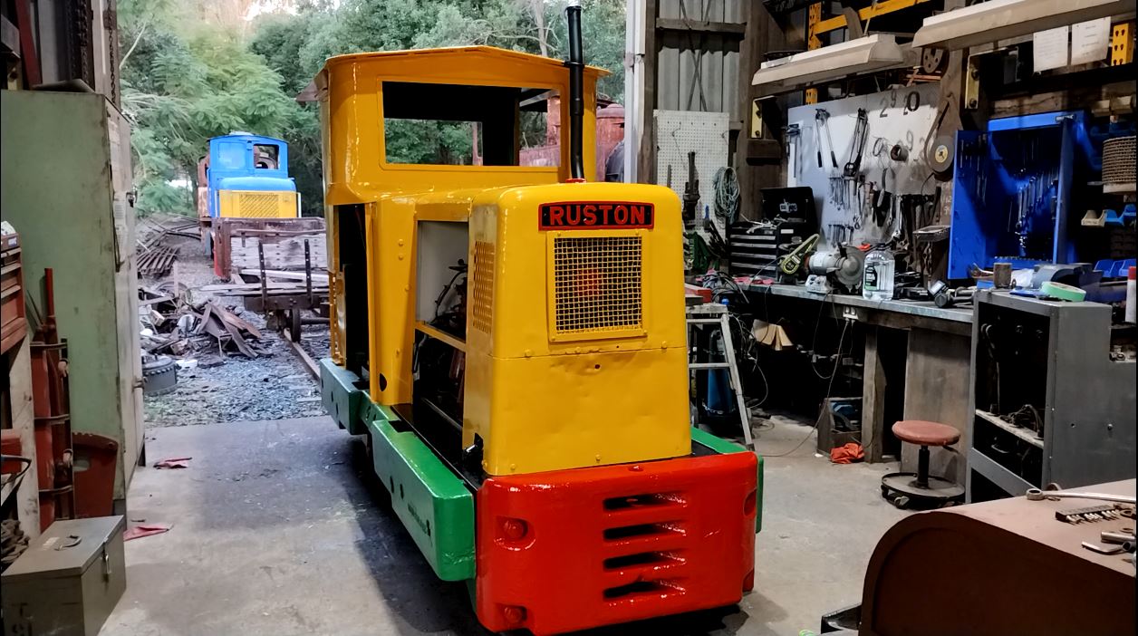

Thankfully the steel for the roof hadn't been stolen for some latest calamity, and was (with great difficulty) dragged into the workshop to have the corners rounded off, and all surface rust removed. It was then cut almost through with a grinder, so it would bend at the crest of the roof frame.
06/04/25
The roof is now fettled and welded on. A "bead" edge was bent up from 10mm round bar, and welded onto the front and rear ends of the roof.
The grey primer ran out midway through. :lol:
14/04/25
After fixing and refitting the crooked exhaust on Saturday, I could finally start my favourite job - painting.
During the period we're "modelling", this loco was painted in the usual shade of golden yellow, and John Deere green - the latter I suspect Condong Mill had laying around..
I'll be brush painting this loco for two reasons:
  • 1. Ryan had already painted the engine compartment, and I can't be bothered masking it off.
  • 2. The loco was likely brushed by that point in it's life anyway.
  • 3. I felt like using a brush.
I prefer to leave painting toward the end of a project. Partly as a reward, seeing it finally come together. Though mainly to minimise damage, touchups and repeat painting. You wouldn't paint the bonnet of a car, only to stand on it while you weld holes in the roof..
The yellow is covering surprisingly well over the grey primer, should only take two coats. :shock:
Will be back for more brush slinging on good Friday..

From Good Friday through to Sunday, the Ruston was painted. Only a low timber step along the RH side to remake, horn/headlights/finish wiring, refit the chain drive. And lots of paperwork..
A week later, Ryan and I spent the second half of yesterday, scouring the workshop and loco shed for a large, vital castle nut (almost 4" across and hard to lose) that retains one of the drive sprockets.
Considering the unworkable shambles I found the workshop in a year ago, parts of all and sundry mixed and scattered far and wide - nobody here cleans up after themselves, and everything is left where it is dropped - this does not surprise me in the slightest..
I threw out a lot of junk in the 3-month cleanup, but never something like that.
Unfortunately for Ryan, he will likely have to machine a new one from scratch.

While operational, the loco was badly in need of a general refit, and the bonnet was full of rust. Restoration began in the late 2000s, with the bonnet extensively rebuilt, but once again fell on the backburner due to the usual reasons.
08/07/25
After clearing the loco of leaf litter and debris, I decided to start with the cab. Stripping out the controls, sandboxes, interior wall lining and fibreglass insulation. Mulgrave was planning on fitting doors and air conditioning to this loco, and had already insulated the cab with fibreglass. However, the loco was phased out before this work could be completed. The problem this poses for us (besides suiting up for removal) is that the insulation retains water and causes rust. The damage wasn't too bad, and by the time of writing, I've now fixed most of it, stripped it all bare and painted everything white.
02/08/25
The roof needed numerous repairs - some due to rust, others because we are backdating the loco to it's 1960's livery. Between warpage and welds cracking when ground flush, repairing this 3mm steel is proving very difficult. After a month's work to get nowhere, I am deferring this job to our engineer. It's also possible that the post-war steel itself may be the problem - we could end up replacing the roof entirely..
17/08/25
