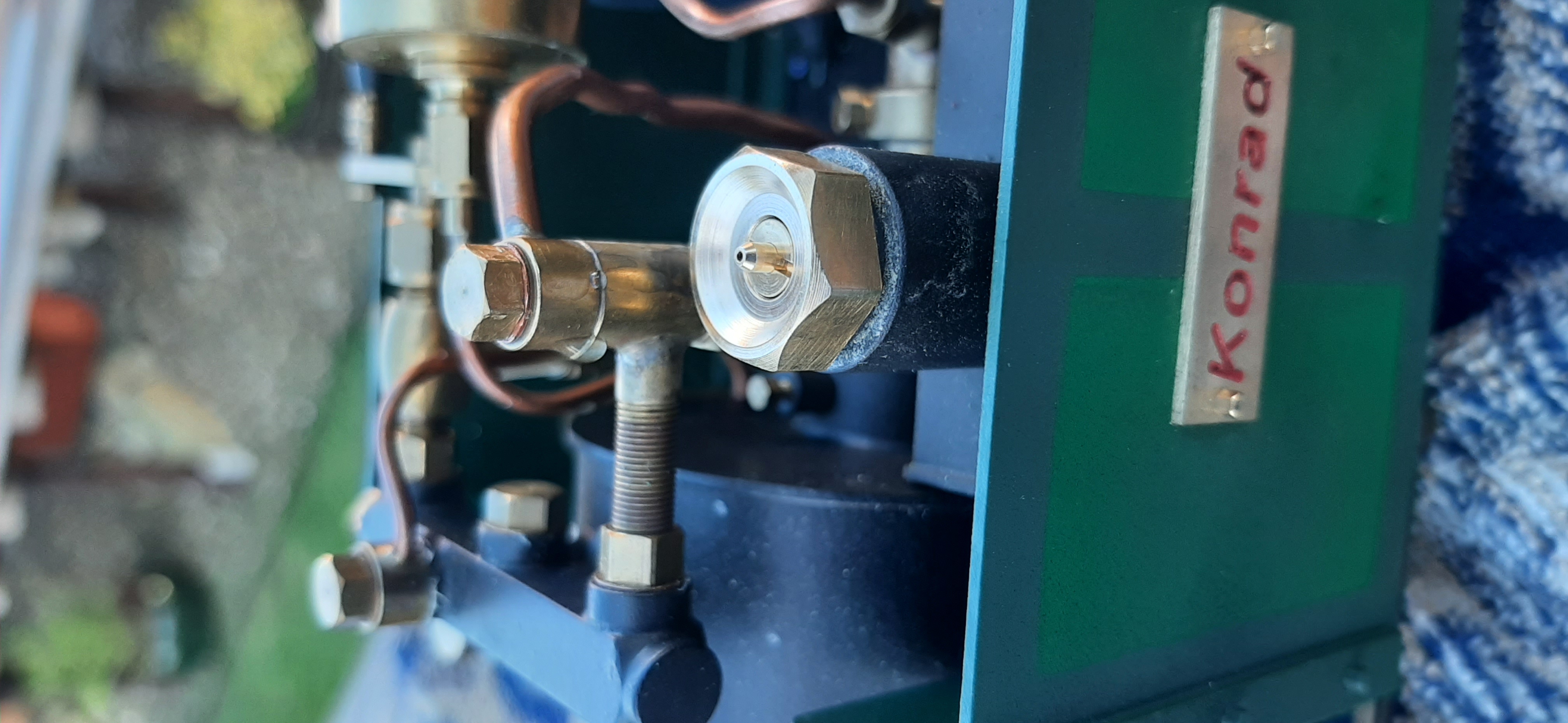

Would a slight leak of water escaping from the sight glass union affect the water level reading? The loco in the image is my second attempt at owning a Konrad. The first one ,an ebay purchase was a shelf queen in good cosmetic condition but the gas valve and or the burner were blocked so that one went back as I couldn't fire it up .Bit of a pity as it sported a cab front with brass spectacles.
At least this one fires up and runs . But I am not hp about the leak If I have to return this one, I will bite the bullet and purchase a new Vincent.

I Have a roundhouse loco with water top up facilities with a sight glass which is accurate . Why would Regner fit a sight glass if not for the purpose of checking the boiler level . Although rudimentary these locos are of quality construction and of course German . I have just checked the loco again by filling the boiler via the water top up . there is no pressure in the system as the burner isn't lit yet it is already leaking see image .

Post by Preseli Chris » Wed Jul 09, 2025 8:27 pm
it appears to be leaking from below the union . maybe who ever fitted the water top up valve caused the damage . It also has been filled with hard water as there are bits of lime scale floating about .
Notice nice shiny new gas filler valve that I fitted that will be coming back off if I have to return the loco :(

Post by GTB » Thu Jul 10, 2025 3:04 am
Preseli Chris wrote: Wed Jul 09, 2025 8:27 pm it appears to be leaking from below the union . maybe who ever fitted the water top up valve caused the damage . It also has been filled with hard water as there are bits of lime scale floating about .
The top fitting seems to be a banjo fitting and it looks like the bottom washer is missing. Which is why the joint is weeping.
Looking at the photo it appears there might be two washers at the top, in which case the banjo fitting has been assemble incorrectly at some time in the past. I prefer to use fibre washers on boiler fittings, but it looks like Regner may use copper washers.
Copper washers work OK, but require more force when tightening up to be leak proof and it's very easy to break the glass.
Regner use brass boilers and the instructions suggest running them with a mixture of tapwater and distilled water. The theory is that the tapwater forms a thin scale layer that acts as a barrier to minimize dezincification.

GTB wrote: Thu Jul 10, 2025 3:04 am Looking at the photo it appears there might be two washers at the top, in which case the banjo fitting has been assemble incorrectly at some time in the past. I prefer to use fibre washers on boiler fittings, but it looks like Regner may use copper washers.
Good spot. I think you are right.

Other than perhaps leaving a watermark, is the leak enough to worry about? - Might it not seal itself, as the loco warms up and develops a little bit of scale?
But if a washer is missing, probably worth sorting that.

I always drain out my boilers after use, the leak is more apparent when under steam, so as GTB spotted :thumbup: the copper washers are together as to one being on top and one below the union along with the lime scale in the boiler ,sight glass and copperwork . I came up with a solution .
I returned the loco to the shop this morning . I will save up some pennies and buy a new loco with a clean slate .
