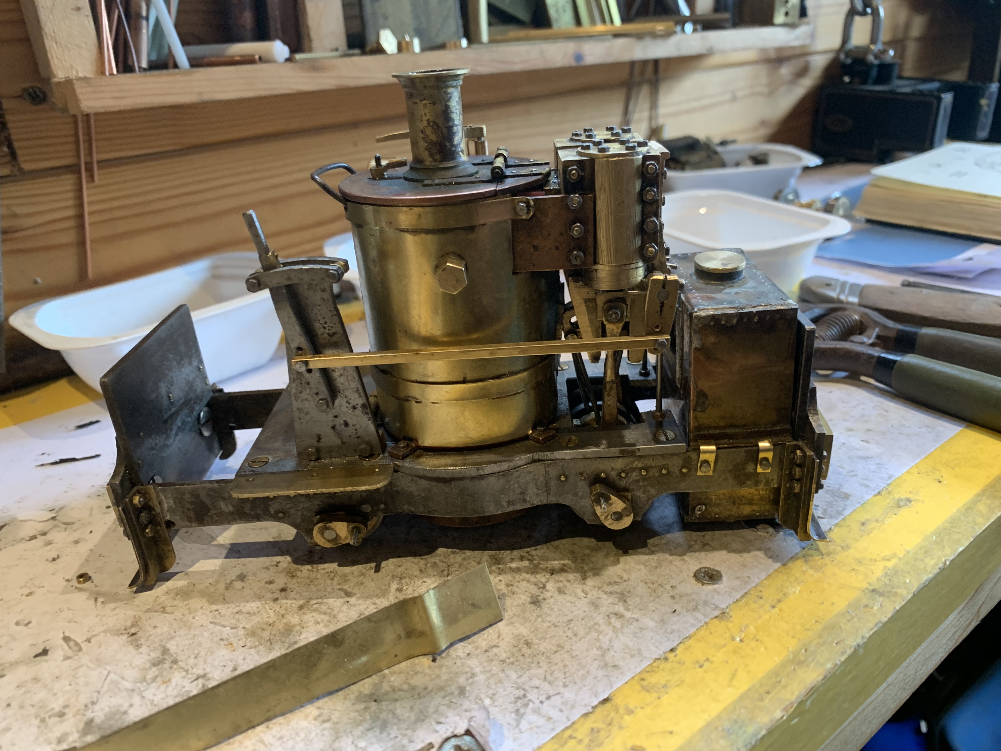

I have picked up a project I abandoned about 8 years ago - really because I didn't know enough to make it work. It came about after building a 16mm scale "Idris", and I really wanted to make it again - but much closer to the original in appearance and function.
So photos of where I got to:
My original attempt at Stephenson valve gear in the confined space sort of worked but bits of the motion kept breaking. So it was abandoned. It distracted me from track building last week, and the video of the result is at https://www.dropbox.com/scl/fi/awj46nxb ... akwe8&dl=0
I will share details of its workings later, and follow on as I finish it.

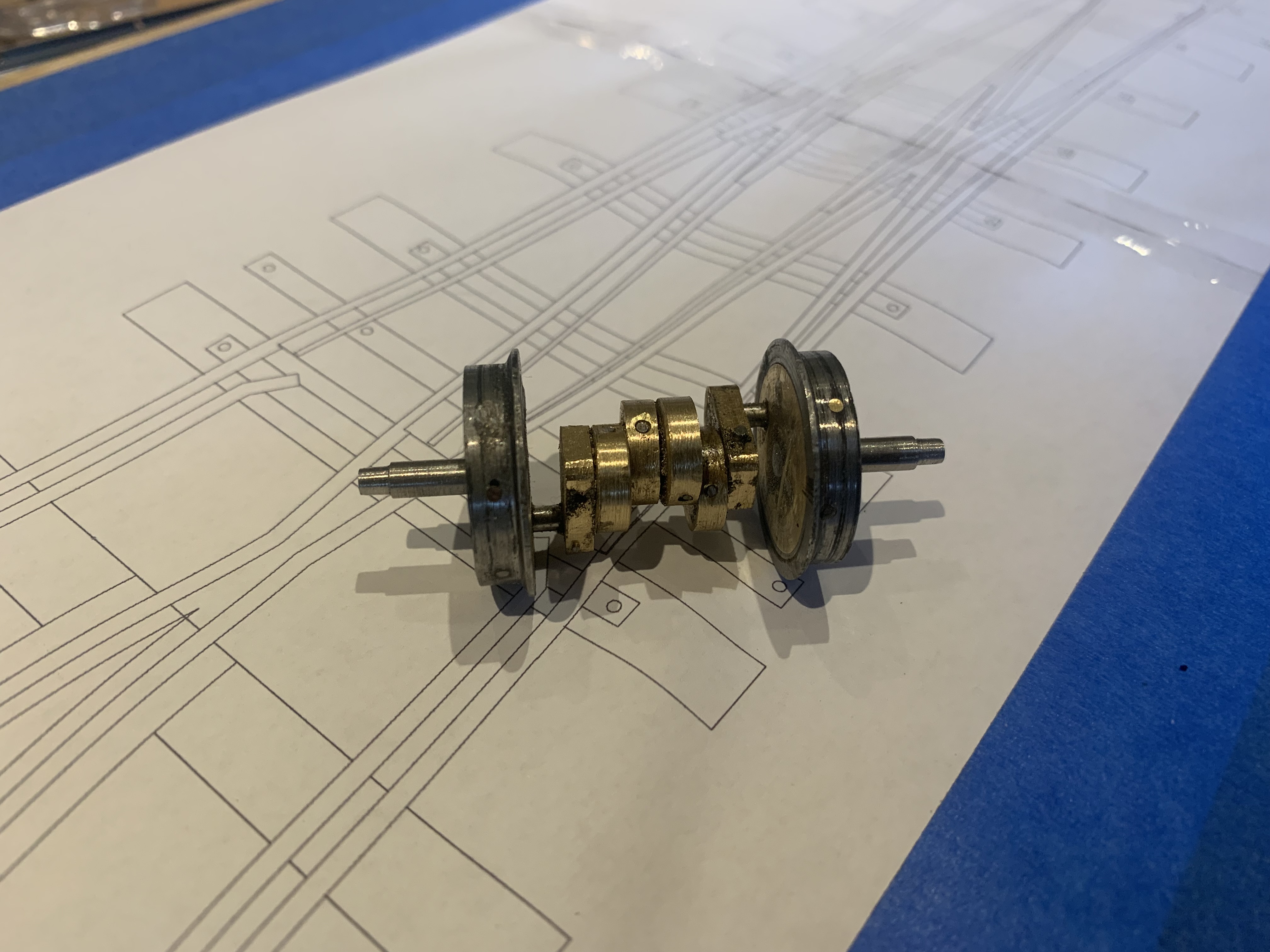

When I came back to this I started to find the errors that I had made the first time around. Firstly the cranks and eccentrics on the axle were loose. So the first thing was to cut the axle apart (to reuse the wheels) and remake it.

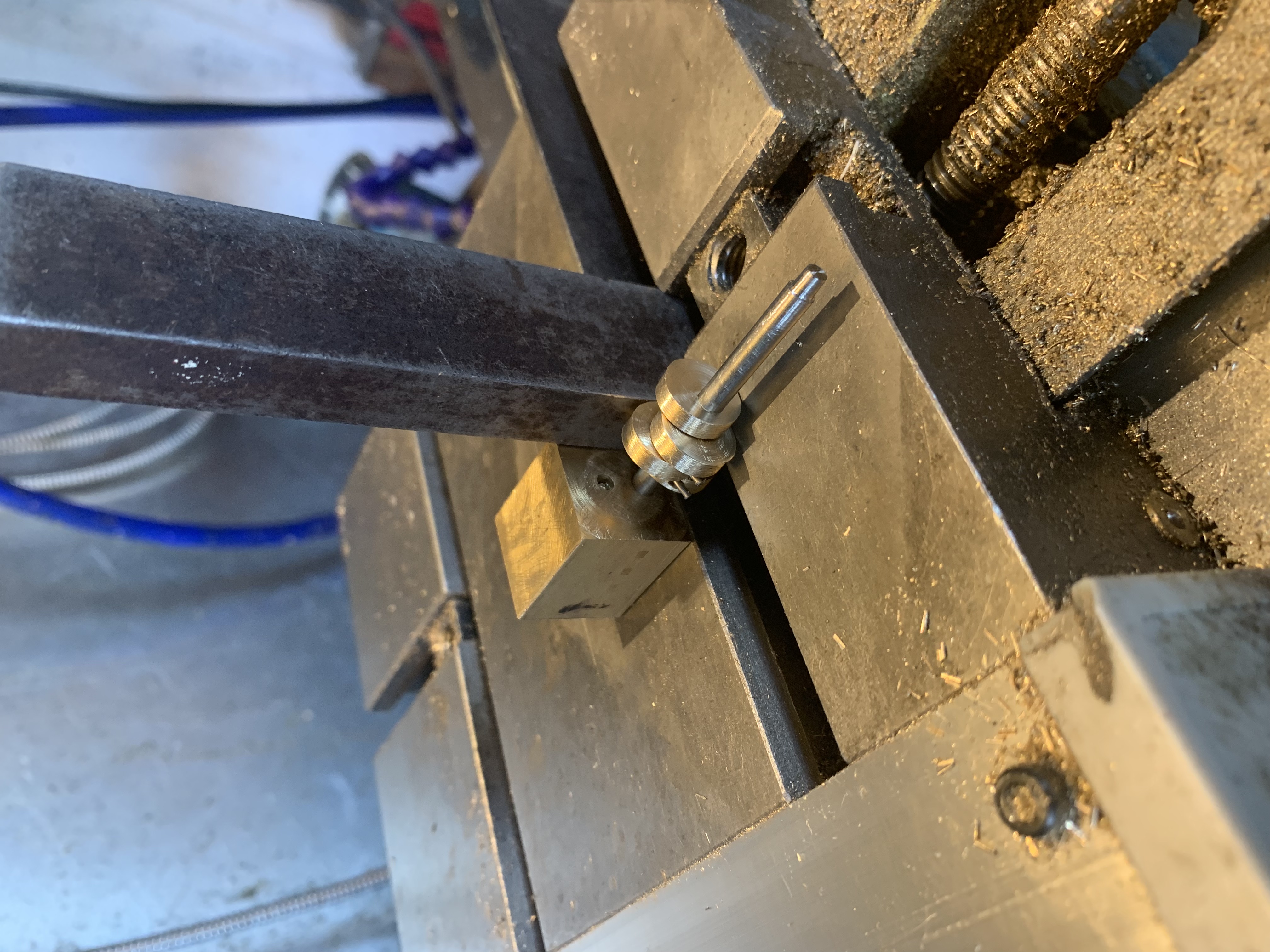

To get the Stephenson valve timing correct I made a jig to set the eccentrics onto the axle. It consists of a block of brass with a hole in it. The distance between the hole and the edge is slightly less than the radius of the eccentrics, so that when assembled the valve will open just after the piston reaches the end of its travel. So the jig sets the 2 eccentrics on the axle, offset not 180 degrees apart, but about 170 degrees apart. Using the jig, the lathe carriage and a set square the two sets of eccentrics are set 90 degrees from each other, and as in this photo :
In a similar way the crank can be set at 90 degrees to the eccentrics.
This is the axle assembled:

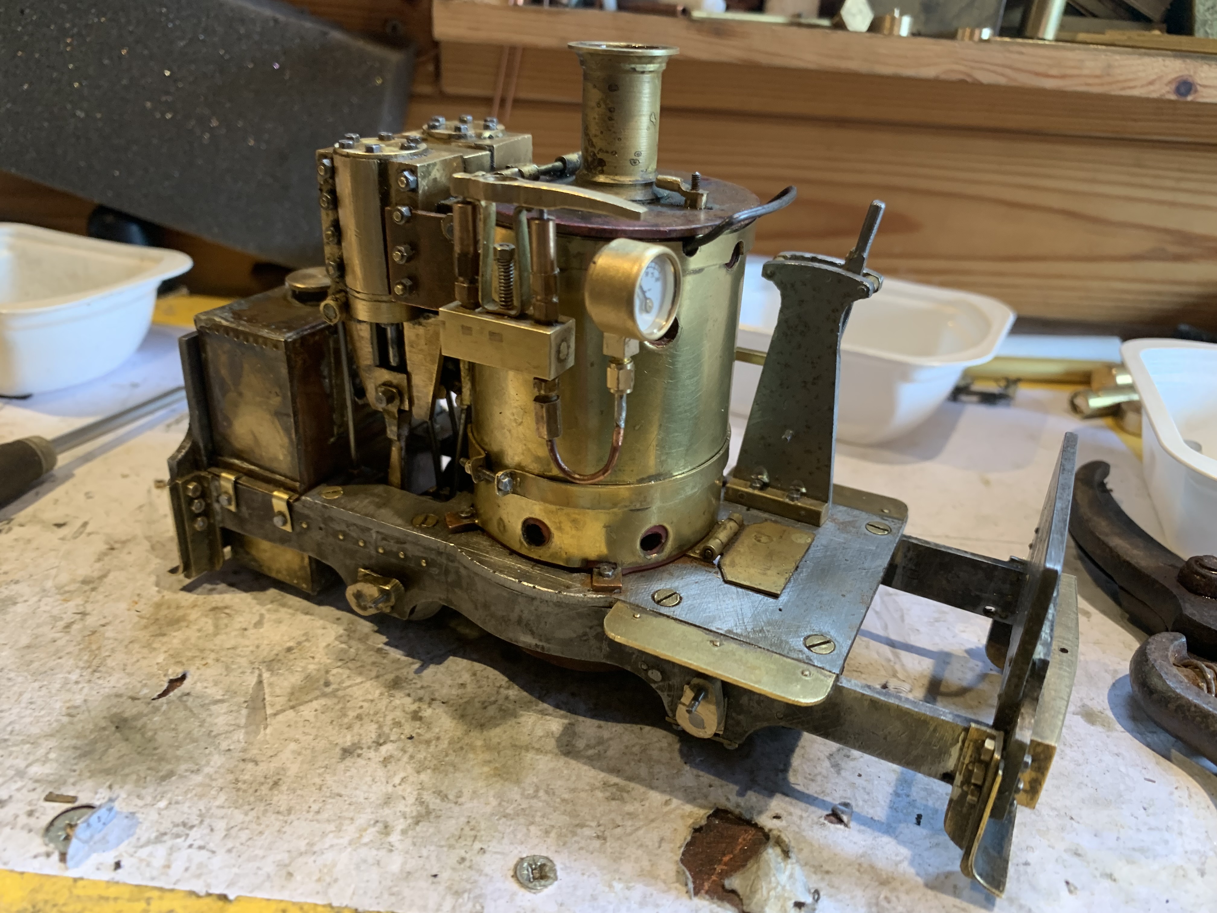

You can see from the photos in the first post that the boiler follows the real practice - in that it has a smokebox with a hinged lid, the double safety valves on a block to one side, There are 4 boiler tubes in the boiler, rather than the single tube in "Idris". The regulator is largely hidden inside the smokebox. It is to have a ceramic burner and gas tank, in the bunker. The water tank is made, and holds water, I hope to be able to add a crank driven water pump in due course.
I am now working on the bunker and the gas tank.
