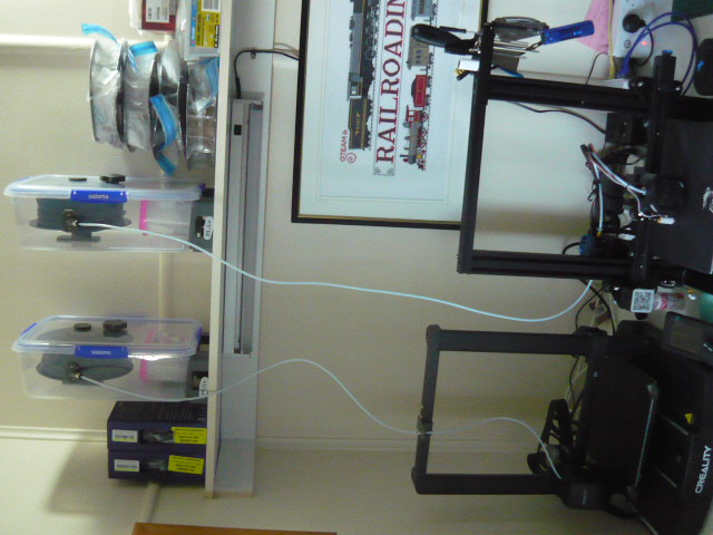

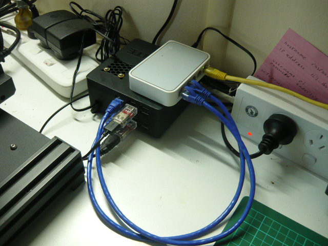

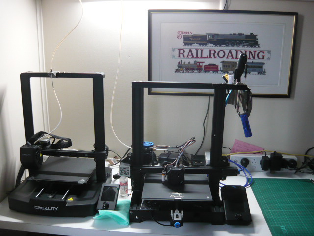

This is my new printer setup.
I managed to a real estate grab after SWMBO decided not to do card making again and get then inside out of the shed
Dry Boxes
Octoprint Raspberry pi box and Etherent hub
Printers

Nice setup Graeme. Similar to mine ( without the ethernet ) but much neater and tidier! :lol:
