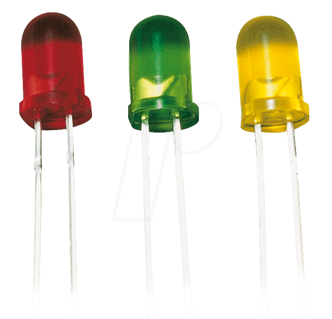

When you say LED bulbs, do you mean the sort of bulbs which are put into car lights or the small individual LEDs which we use for our models? When you mention those in Jerry's coaches, I'm assuming you mean individual LEDs like these:
If so, you can put virtually any voltage through them above 3v (and some will take less than 3v) but they need to be protected with a current limiting resistor, which is what you get with pre-wired LEDs - the resistor is wired in. You can get pre-wired LEDs which will take less than 12v
