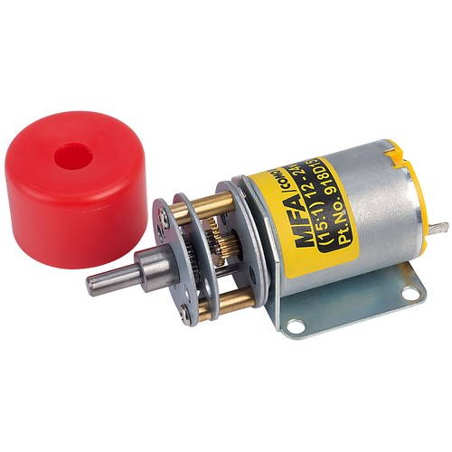

Rik, just for information, I am currently re-building a locomotive, which is based on a GRS chassis. They use a MFA Como 12-24v motor with built-in 15-1 reduction gearbox. I already have another identical chassis and can vouch for its performance. I found this one on eBay. 125733073221, priced at £10.39 + postage.

ge_rik wrote: Sun Feb 19, 2023 6:22 pm I can find a 280 and a 385 MFA motor. Just wondered which one you used and which voltage.
A 285 would be a 5 pole version of a 280 motor. MFA Como don't sell them, but they do sell a RE280/5, which is the 6v version of their RE280.
I assume Steve chose the 6V motor as it would be a tight squeeze to fit a 12V battery pack in a quarry Hunslet, even using 14500 Li cells.......
Hadn't realised GRS used MFA 918D 15:1 gearboxes in their chassis. Too fast for my taste, I'd be using 30:1, which is what was fitted in my old Merlin Motor Mule and I note that Essel mostly use MFA 918D 30:1 gearboxes.
I've not yet got around to seriously making my own chassis (apart from a couple with were based on LGB and Bachmann motor blocks) but I'm interested in moving in that direction
Hi Rik
You are quite right it is indeed a 280 motor, just me forgetting things as per usual.
I use a 3-6v motor in this and this allows me to use a 2 cell li-ion pack (7.2v) which obviously never gets to run flat out so I have found this to work very well.

GTB wrote: Mon Feb 20, 2023 2:35 am
Bang on Graeme, it's a RE280/5 which as you say is the 6v version.
I have also used the same 918D motor and gearbox in loco's. I found that the 30:1 gearboxes scream if you try and get any speed up, I use the 15:1 and it sounds much better and surprisingly doesn't effect pulling performance which is usually restricted by the weight of the loco and it getting traction. However, I did use the 24v version on 3 or 4 cell li-ion packs, so approx 12v to 16.8v Note every loco I own is radio controlled.
