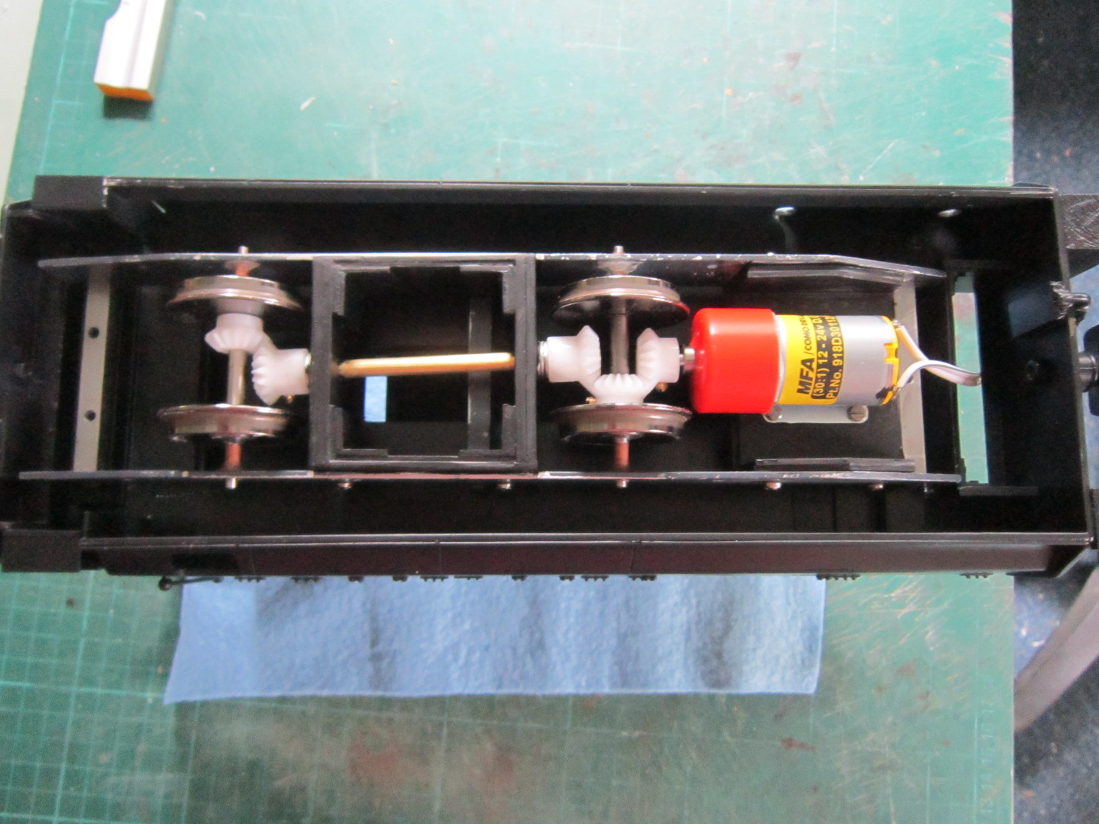

Just finished off my second 3D printed motor block for my GVT Glyn loco. The Bachmann block I used originally was underpowered (seems to be an issue for me with Bachmann blocks), so I 3D printed my own using the ubiquitous MFA Como 918D 30:1 gear motor.
It was no better in terms of hauling capabilities than the Bachmann block. So, to coin a phrase, I "went large!". I adapted the motor block to take an MFA Como 942DLN gear motor with 50:1 reduction. Somewhat of a beast compared to the 918D, but I managed to squeeze it into the capacious body of the GVT Glyn.
I would imagine this loco (with sufficient ballast weight) now has the capability to haul almost all the stock on my railway. Overkill, maybe, but I certainly can't complain about its pulling power now.
I think these blocks are probably have somewhat of a niche appeal, but would be happy to upload the files if there is any interest.

Hi Rik, I watched your video before seeing it posted here, another triumph for your chassis construction method. That seems to be a huge motor and needs to have a large space to conceal it inside a loco, there is an alternative which I have used in the past.....
The same motor is also used by GRS in their SM32 chassis unit and just fits between the wheels on a short chassis.....
It can also be used to drive two axles via a 1:1 bevel gear system, similar to the one you have done.....
This requires an extended chassis.

Hi Peter
Thanks for the ideas. I do like the way you've used the bevel gears to provide four wheel drive. The motor you've used is the same as that I used in my first motor block (ie the MFA Como 918D with 30:1 reduction. Although it worked well, I found it didn't have enough power at 12v for some of my longer goods trains which is why I opted for the larger MFA motor.
I've since sourced a smaller Polulo gear motor (at Graeme(GTB)'s suggestion) which is nearer in size to the 918D but is supposed to be more powerful. It should fit between the frames of a 32mm gauge loco. I'll have a go at designing a motor block for it and let everyone know the outcome.
