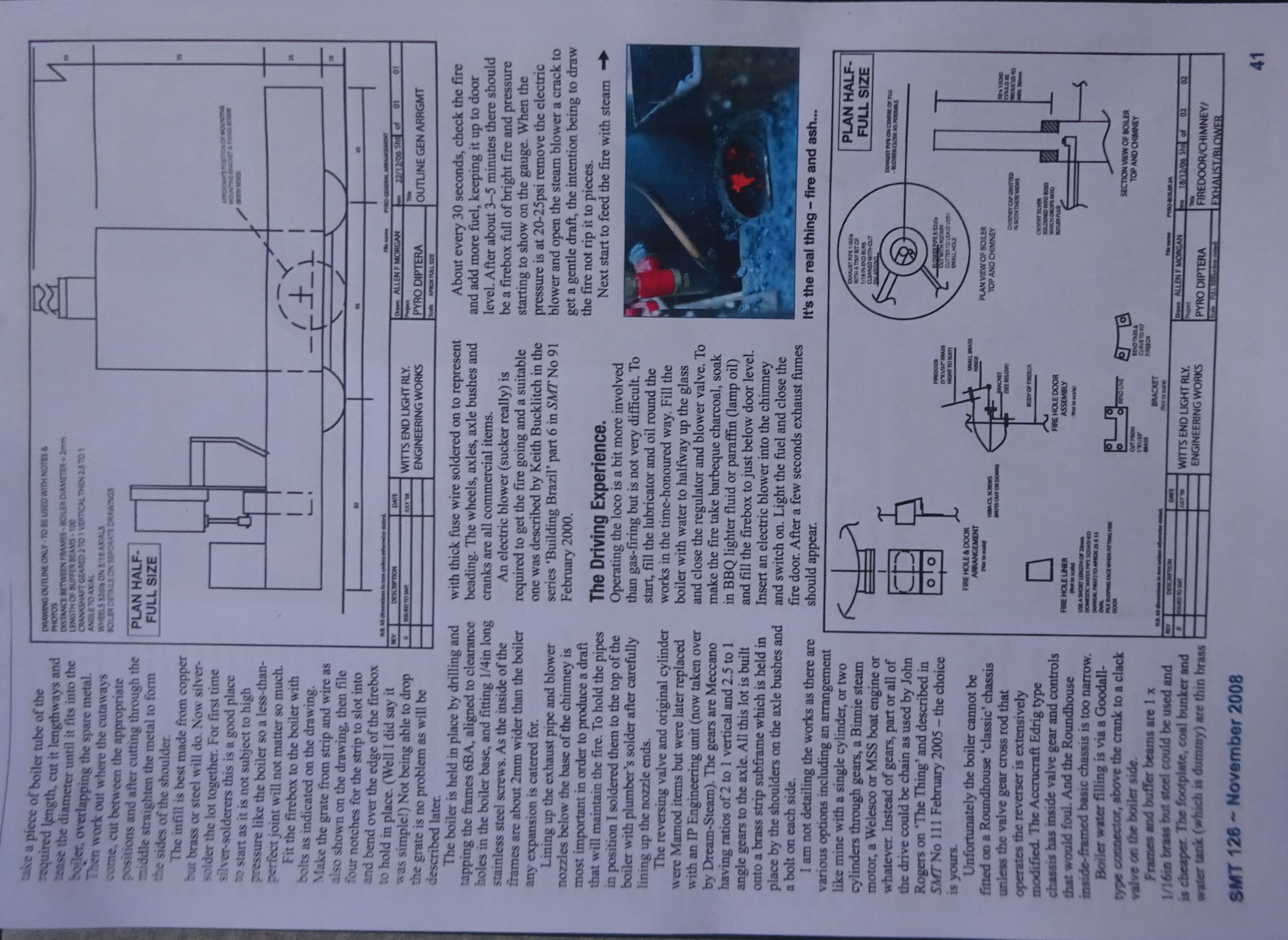

Tony
I’d seen the original and later video on YouTube and am also tempted by its simplicity, particularly as I have a two cylinder engine looking for a home. This is a non oscillating 10mm bore x 10 stroke engine which I think would look good in a open De Winton style engine. The boiler appears very simple and I assume uses just one centre flue and doesn’t have a water jacket to the sides of the firebox. Do you have any constructional details, dimensions etc that you could share? If your concerned about publicising a non standard boiler design perhaps you might consider providing these in a personal message.
Mike

Re: Model coal fired vertical boiler locomotive
Hi Mike,
The boiler is a none standard design in as much as it is a modified commercially produced one, the original builder wrote an article about its construction in SMT and the present owner has a copy, he is due to visit me tomorrow and if I can contact him before then, I will ask him to bring his copy, which I will forward to you, it will have to be a photograph as my copier has decide to give up on me.
Take care Tony.
Take care Tony.
- Tony Bird
- Posts: 601
- Joined: Thu Jul 29, 2010 8:25 am
- Location: Cardiff, South Wales, UK.
Hi Mike,
Contacted my friend who reminded me that he had left a copy of the article! Found it and photographed it, if the result isn't good enough let me know and I will try again.
Take care Tony.
Take care Tony.
Sekim
- Posts: 6
- Joined: Tue Sep 06, 2022 8:09 am
Tony
Thanks for the details. I hadn’t appreciated that it had been in SMT. It’s a very tempting concept.
Mike
