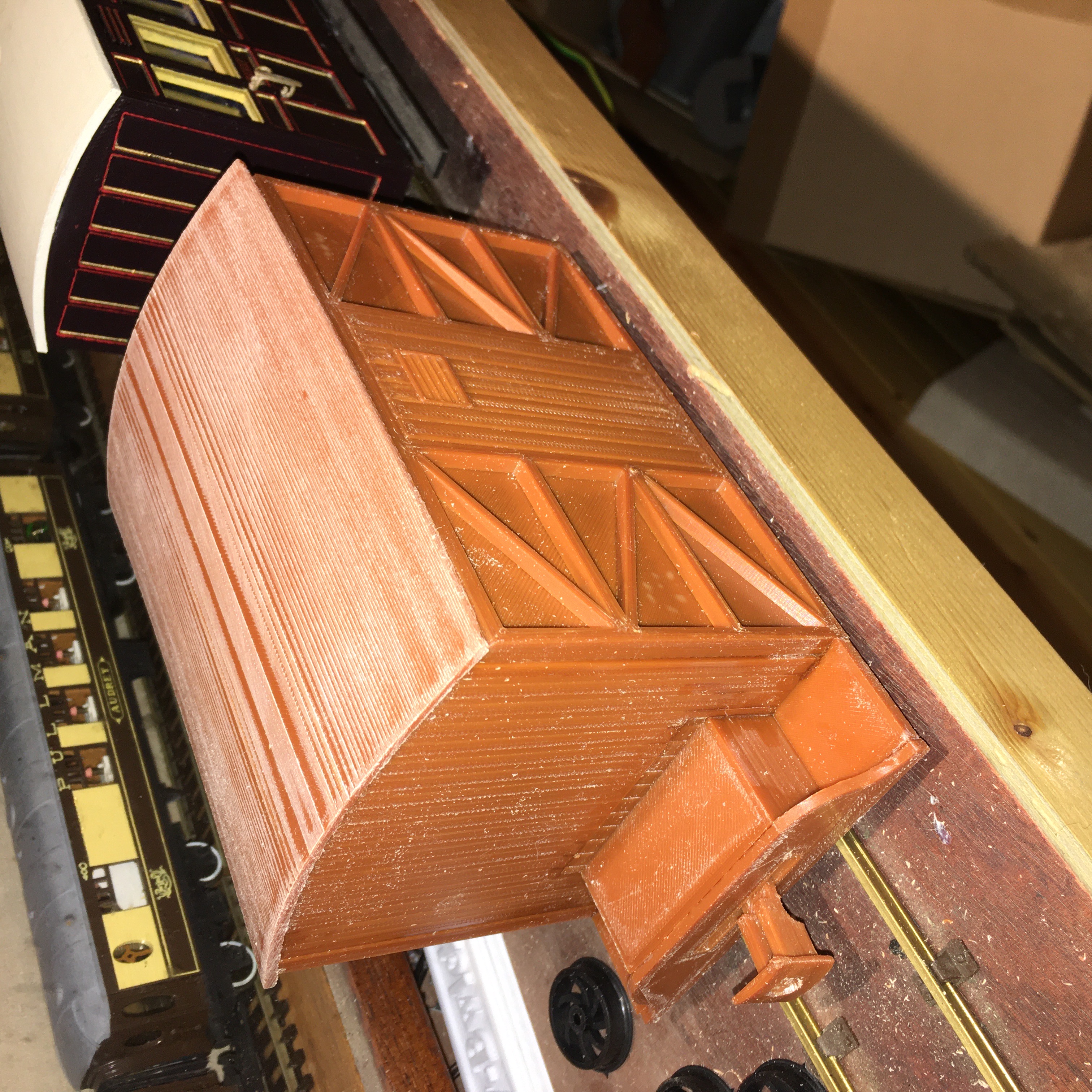

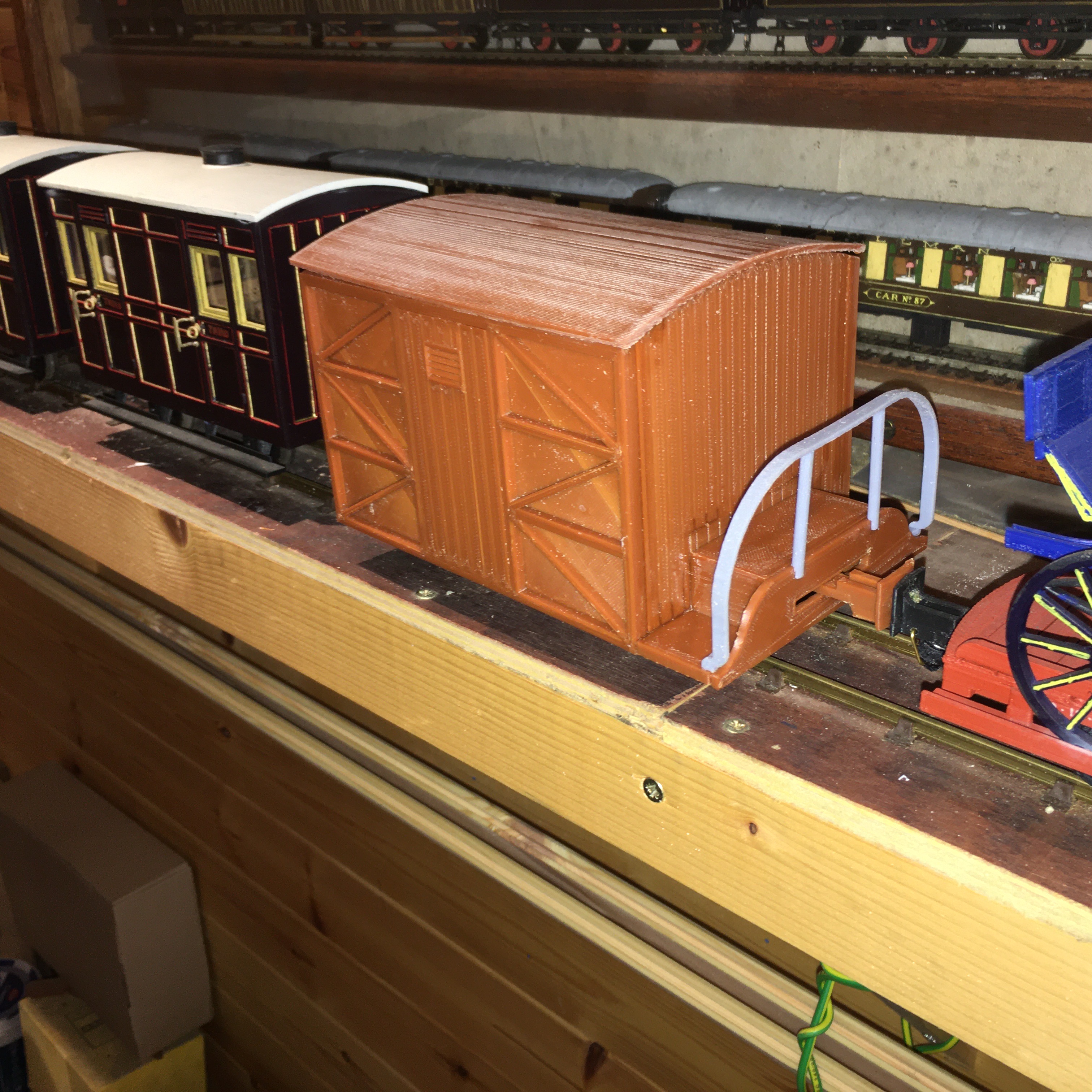

The printed model:
From the down hill end (which takes the brake stand and sentry box):
and from the uphill end:
Excuse the sanding dust on the model. I have been sanding the roof to reduce the ridges. I am making two of them, this one will be "as built", without the sentry box, and the other "as modified" to give the brakesman some shelter:
apart from wheels this one just needs its handrail, which has just come out of the resin printer:
More photos as it's finished.
The stl files will be in the 3 D print files section shortly.

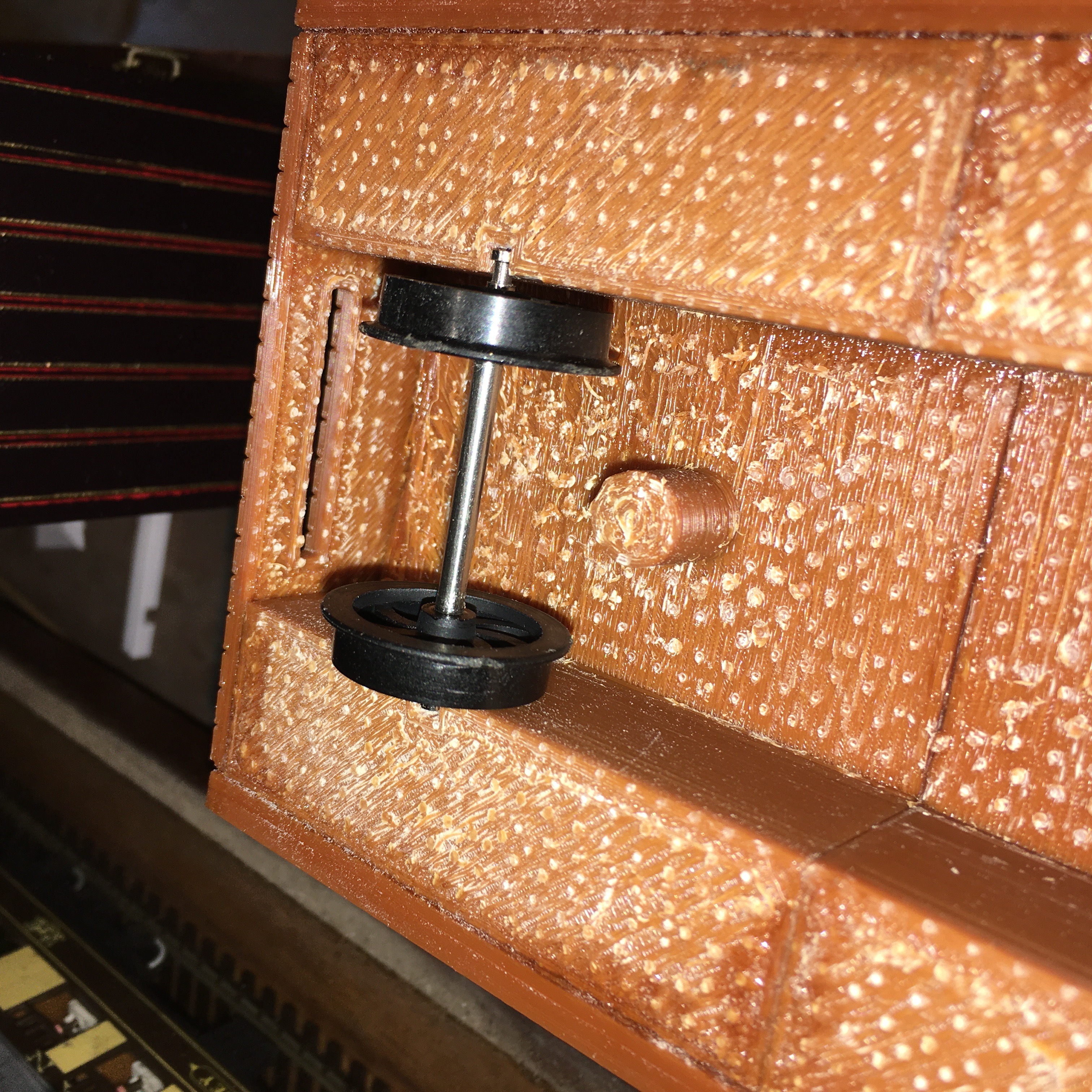

Wheels.
The first axle with wheels attached:
It isn't necessary to use ball bearings - but they don't half run sweetly if you do. I used the 1mmID 3mmOD bearings I have described using previously. The axles slot into the printed in half round recesses. In this case just pushed into place:
There will be keeper plates to make sure the axles don't fall out - and I will add these to the stl files in the print files section.

Couplings.
I have drilled out the 6mm diameter holes in the faces of the couplings and drilled the pivot holes 1.8mm. Also drilled the holes in the base of the van 1.4mm and tapped 10BA. So the wheels and couplings ready to run:
And coupled into a train:
The printed handrail is slightly flexible but hopefully that will help to prevent it breaking in use!
- Posts: 7788
Re: Festiniog Railway Sentry Box Brake Van
Just out of interest, why has it got a spotty bottom?

- Posts: 239
- Joined: Fri Nov 25, 2011 4:13 pm
- Location: Vancouver, BC, Canada.
Guessing that's where the base was printed slightly off the bed, & the supports removed?
This looks excellent, Trevor. I had a look at the files but can see adapting it to 45mm (sacrilege, I know...) is going to take a bit of work...
- Posts: 1157
- Location: South West Wales
The answer is to do with printing in ABS. It is lifted off the bed by 1mm, and "tree like" supports added. Printing directly on the bed results in enough adhesion to damage the bed sticker. A raft provides the correct amount of adhesion to the bed and the tree like supports keep the component firmly attached to the raft. Its a compromise but provides the best results I can get with ABS. So the spots are what is left of the trees.
The couplings were printed using a different type of support (long strings running back and forth) and they don't have the spots. This type of support works if the component is smaller.
- Posts: 7788
Thanks. That makes sense. Having never used rafts, I'm not familiar with their after effects.

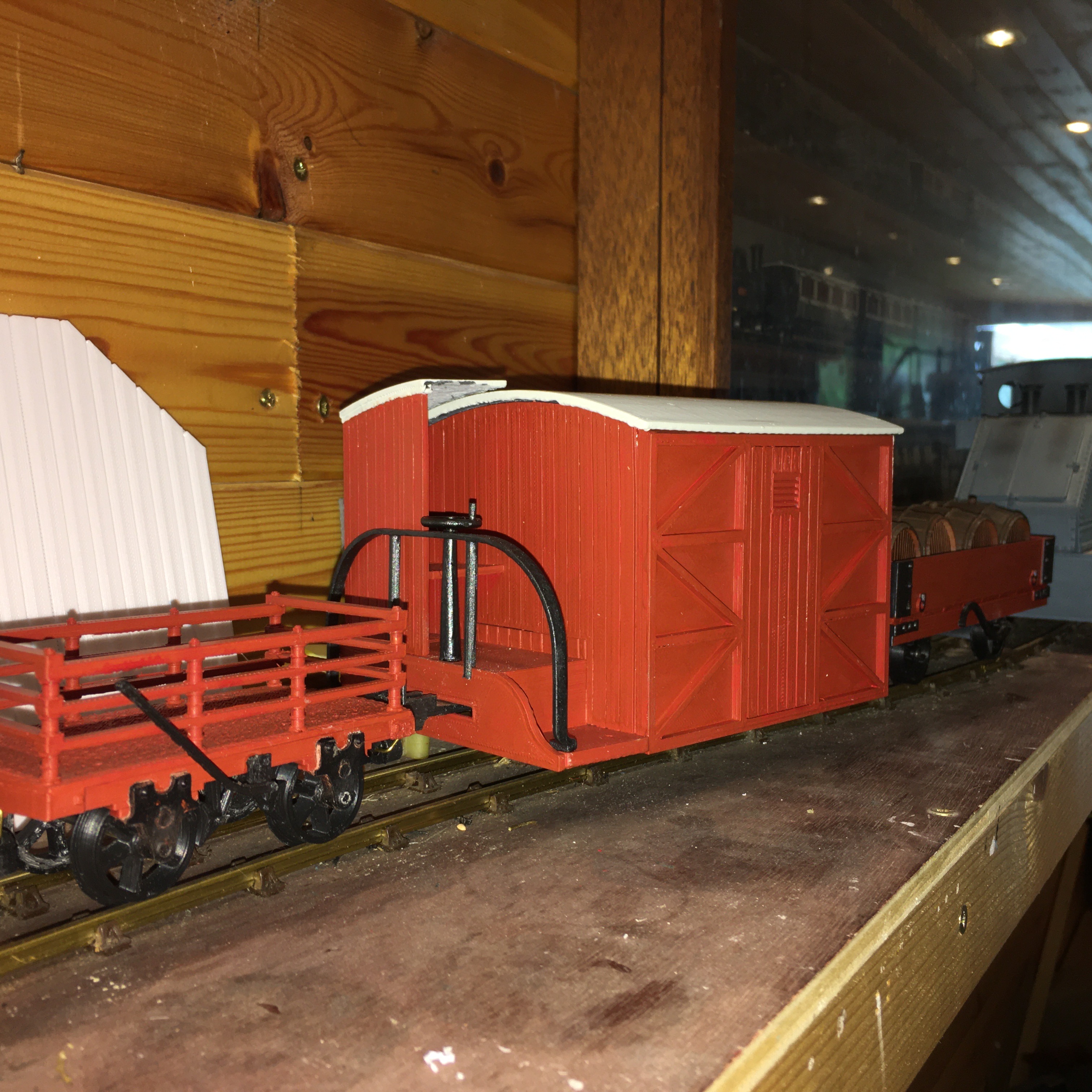

Two versions of the finished brakevan.
One without the sentry box:
and one with it:
I will update the .stl files to take into account a few improvements shortly.
and one with it:

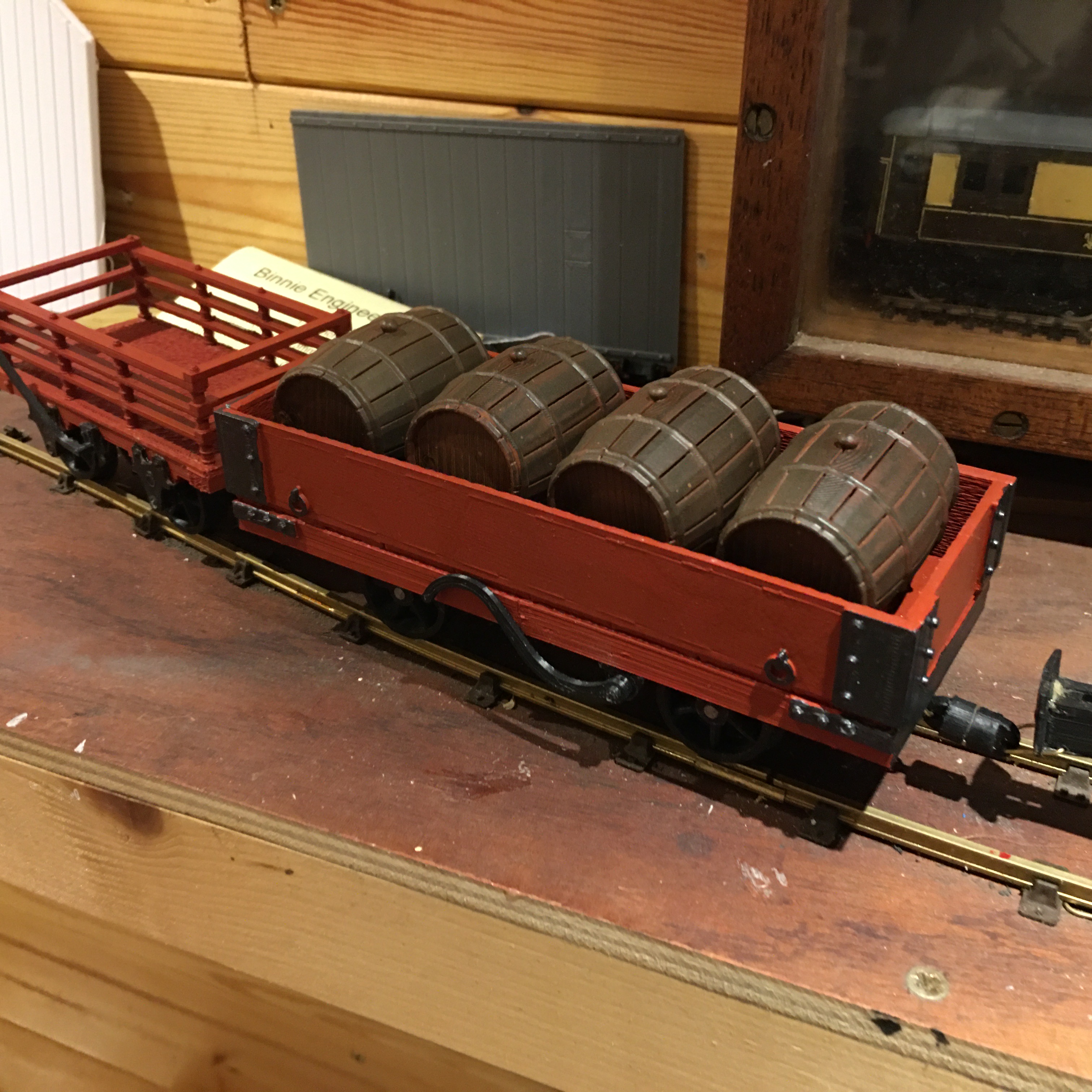

In the background of the last photo is my version of the Ffestiniog "Beer" wagon:
and:
I will add that to the 3 D printer files as well.
and:

Did you create or 'find' the barrel files? Whichever, they really do look good!
(Thinks: A few on wagons to and from Beeston Brewery would look good ......
- Posts: 5933
Don't know where Trevor got his from, but these are in the 3D Print Files
https://gardenrails.org/forum/viewtopic ... 55&t=13829
- Posts: 1157
I got the barrels from thingiverse.
However I think the ones in Plilips photo are better - the hoop spacing just seems more realistic.
