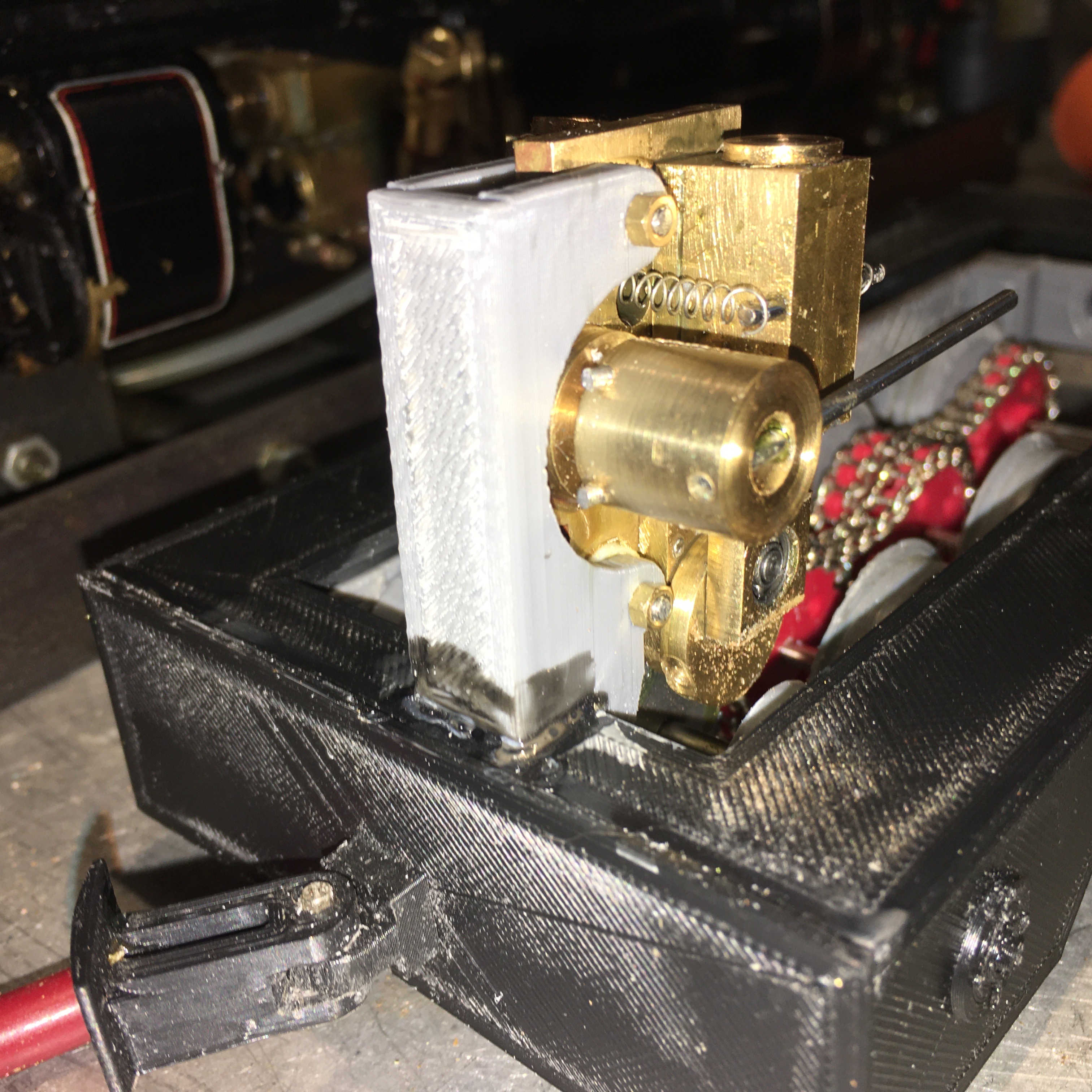

I have made a first stab at fitting it into the chassis. My efforts so far have led me to fix the motor to the back of the cab. I was trying to find a way of holding it firmly so that I can position the intermediate shaft. It isn’t going to lead me where I wanted to go. In that if I continue this way it will be difficult to attach steam pipes or service the motor. So I will persevere as far as using the back half of the cab to locate the motor temporarily. Use that position to fit the intermediate shaft and then remove the moto and cab. I can then make a permanent bracket which holds the motor to the chassis in such a way that the whole cab can be removed for access. I have a mental picture of a chassis with a boiler and motor attached, and a separate body which just slots over it all. Photos when I get somewhere!

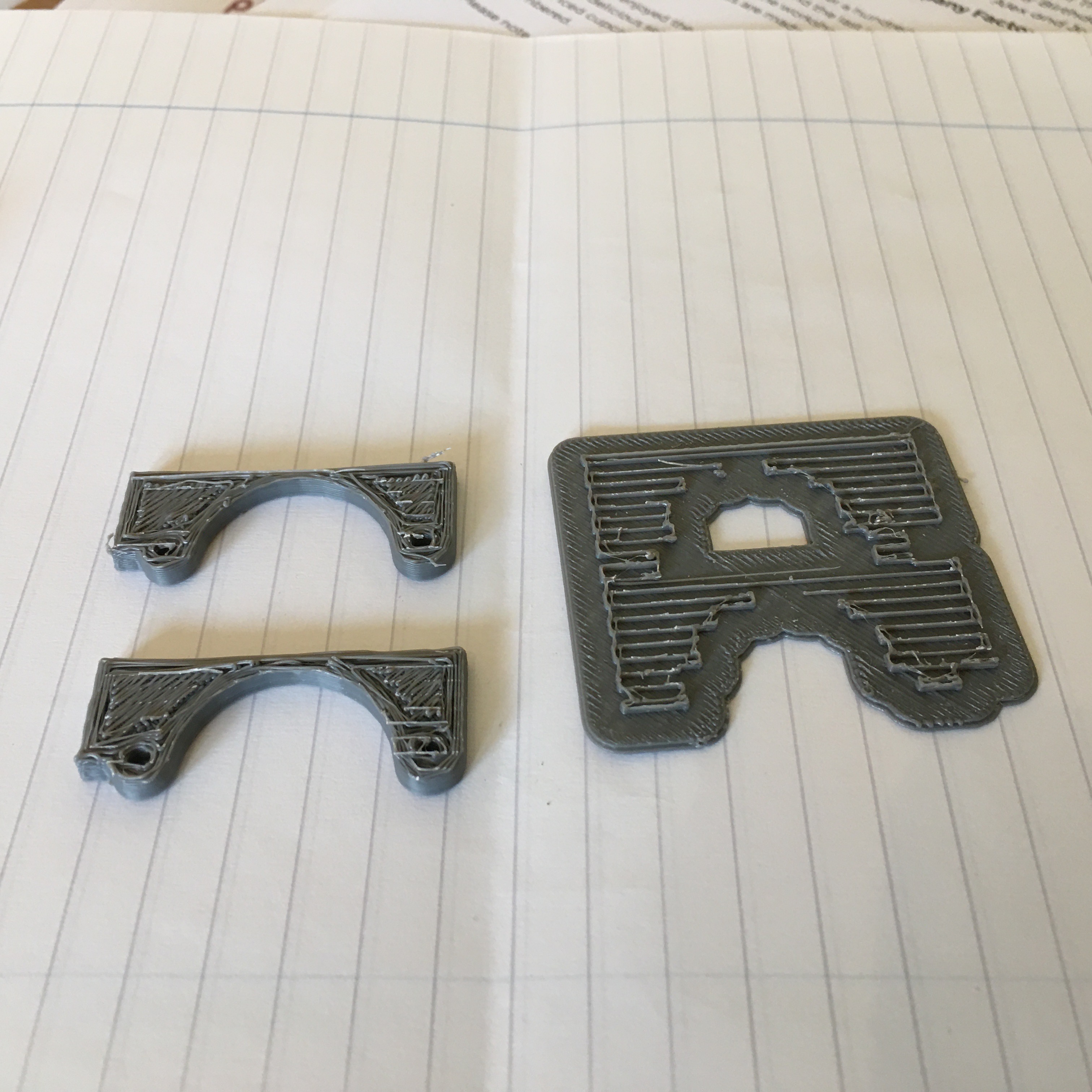

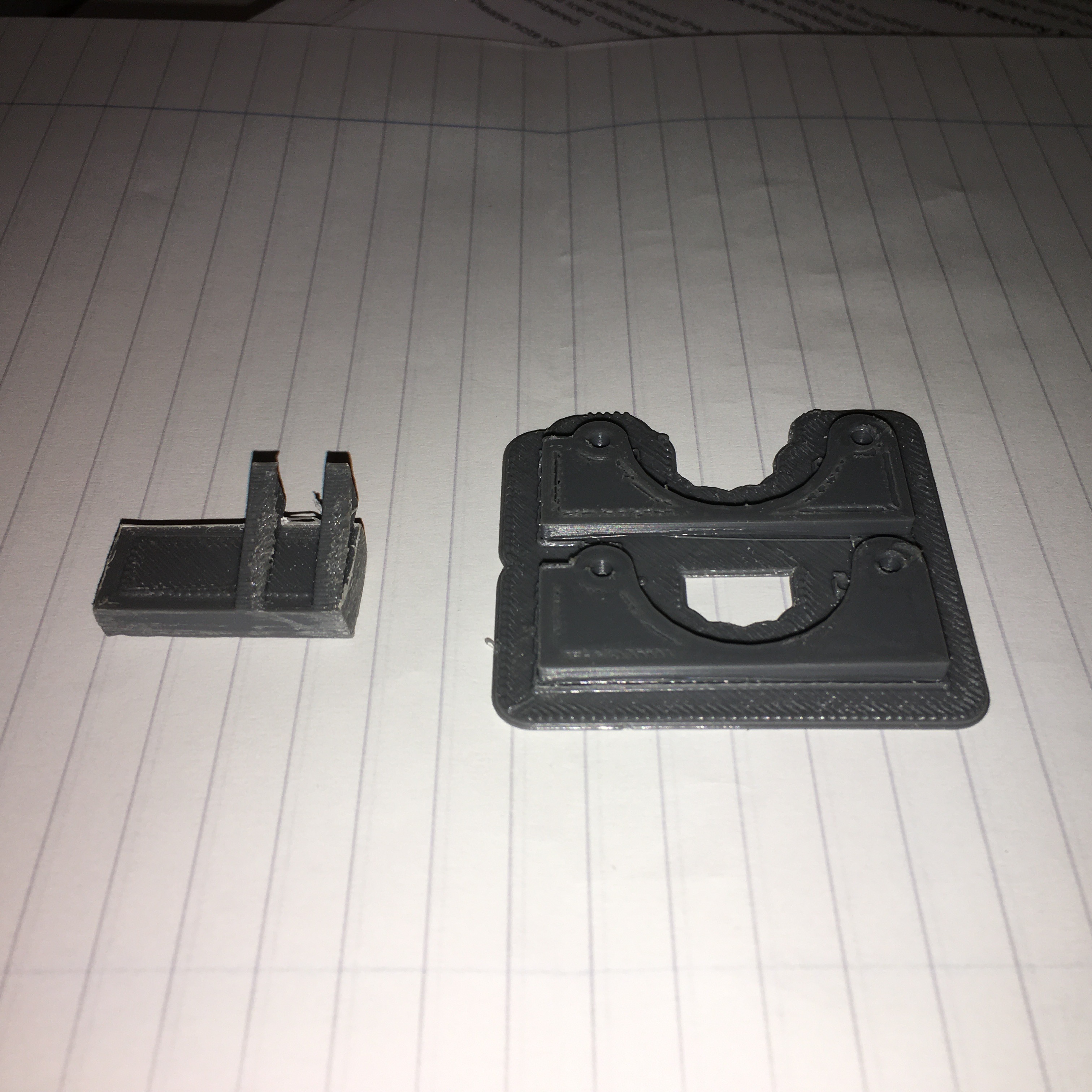

I have been printing off components to mount the steam motor. So far I'm on the second iteration of the components.
I have been discussing off forum some issues with printing the components in ABS - which I thought I should share.
ABS has good heat resistance - which is particularly relevant for this model.
Firstly you need to know that Simon and I both have Flashforge Adventurer 3 printers. These come with a removable flexible plastic build plate, and an alloy underplate which is heated. The flexible plate has a replacable self adhesive film on it.
Initially when you have a new build plate ABS does not stick to it - or at least the components come free too readily to be useful. The accepted wisdom to solve bed adhesion problems with ABS is to wash the surface with a mix of acetone with ABS dissolved in it. That works - but if you do it you won't be able to get the model off the bed without destroying the self adhesive film. So a light wash of acetone should be sufficient. If not try a SMALL amount of ABS dissolved in it.
I have the bed plate on my printer nicely conditioned at the moment so that the raft comes free readily, and nothing comes off until I want it to!
So I have just mentioned using a raft. My experience is that I have to print ABS onto a raft. The photo shows 2 of the components for mounting the steam motor:
The part on the left I printed without a raft - but with a brim. Printing it ALMOST destroyed the self adhesive film.
The right hand part is as it came off the printer - with its raft still attached. It came free from the bed easily by bending the plastic plate (as you are meant to). The components will come free from the raft easily. The downside of this is that the underside of the component isn't a nice clean flat surface. You can see here:
However the remains of the supports sand off easily.
One thing I forgot to mention is that I raise the component by 1mm when I set things out in the slicing software. The software adds supports which you can see on the raft as a thread of plastic running back and for across the raft. By raising the component above the bed like this I make sure that it is easy to get the component off the raft. Not so much a problem with a small component like this but it is with something bigger like the sides of a building.

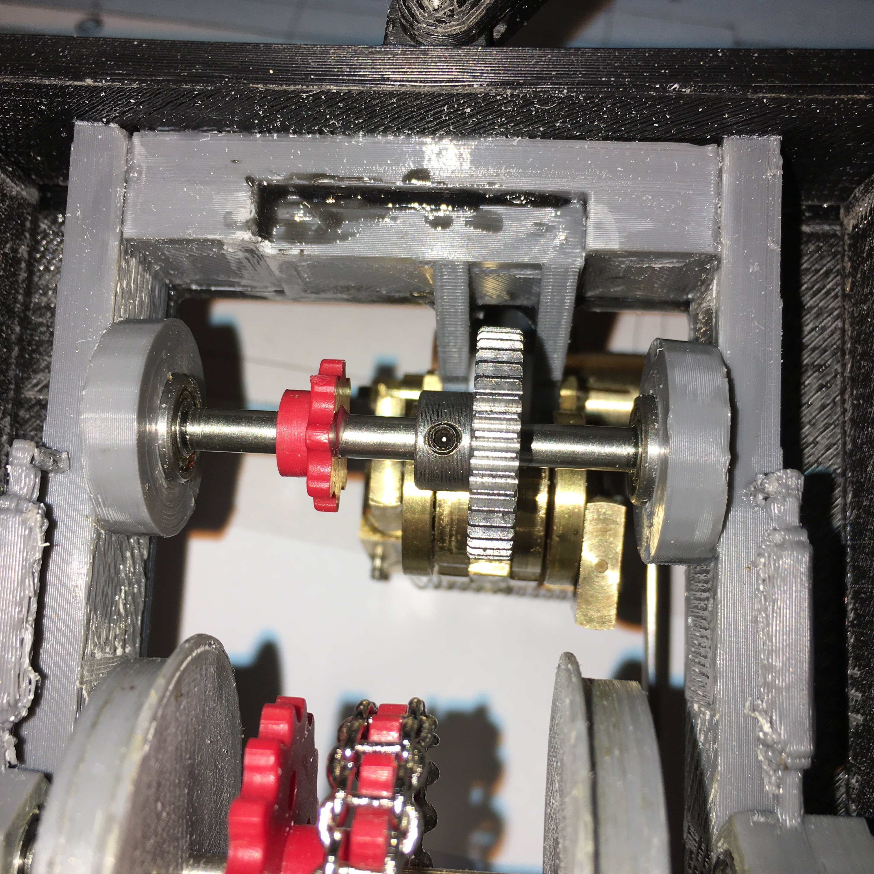

I have finalised the method of holding the steam motor on to the chassis. It uses a mounting bracket to hold the steam motor in place. The two holes in the port block are fitted with top hat bushes made of PTFE, 4 of them two in each hole. This should ensure that the heat is kept away from the plastic. Of course this is all experimental - so we will see if it works - when it gets hot.
The view from the top:
You can see that the steam motor is off set to one side. I did that to make the operating lever for the reverser more accessible for manual control, and to give more room to connect steam and exhaust pipework on the other side. I have modified the reverser control by making the bracket longer so that the lever can extend forwards into the cab - rather than out of the back of the cab.
The view from below:
Two printed bushes hold ball races (3mmID, 10mm OD, 3mm wide) and are bonded to the inside faces of the inner chassis. Lining up was by eye. The shaft is 4mm OD to suit the gear, the chain wheel was bored out to 4mm, and the ends of the shaft turned down to 3mm diameter. I have yet to tighten the grub screws on the gear - which will be done when the acetone bonding the parts together has finally evaporated, and the joints are secure. I await chain to complete the drive - but I will be able to test it as it is tomorrow.
I think that the moving parts will clear everything.

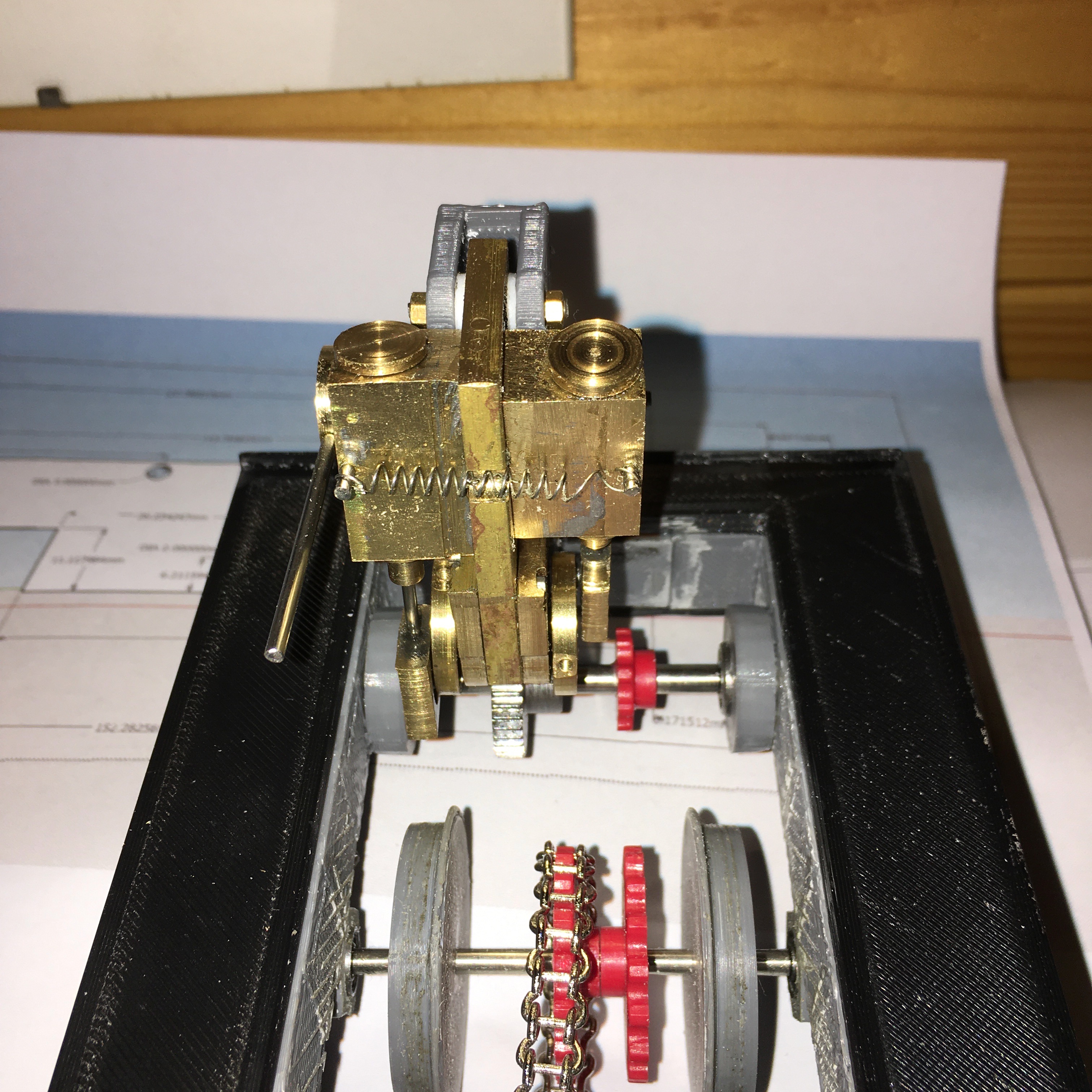

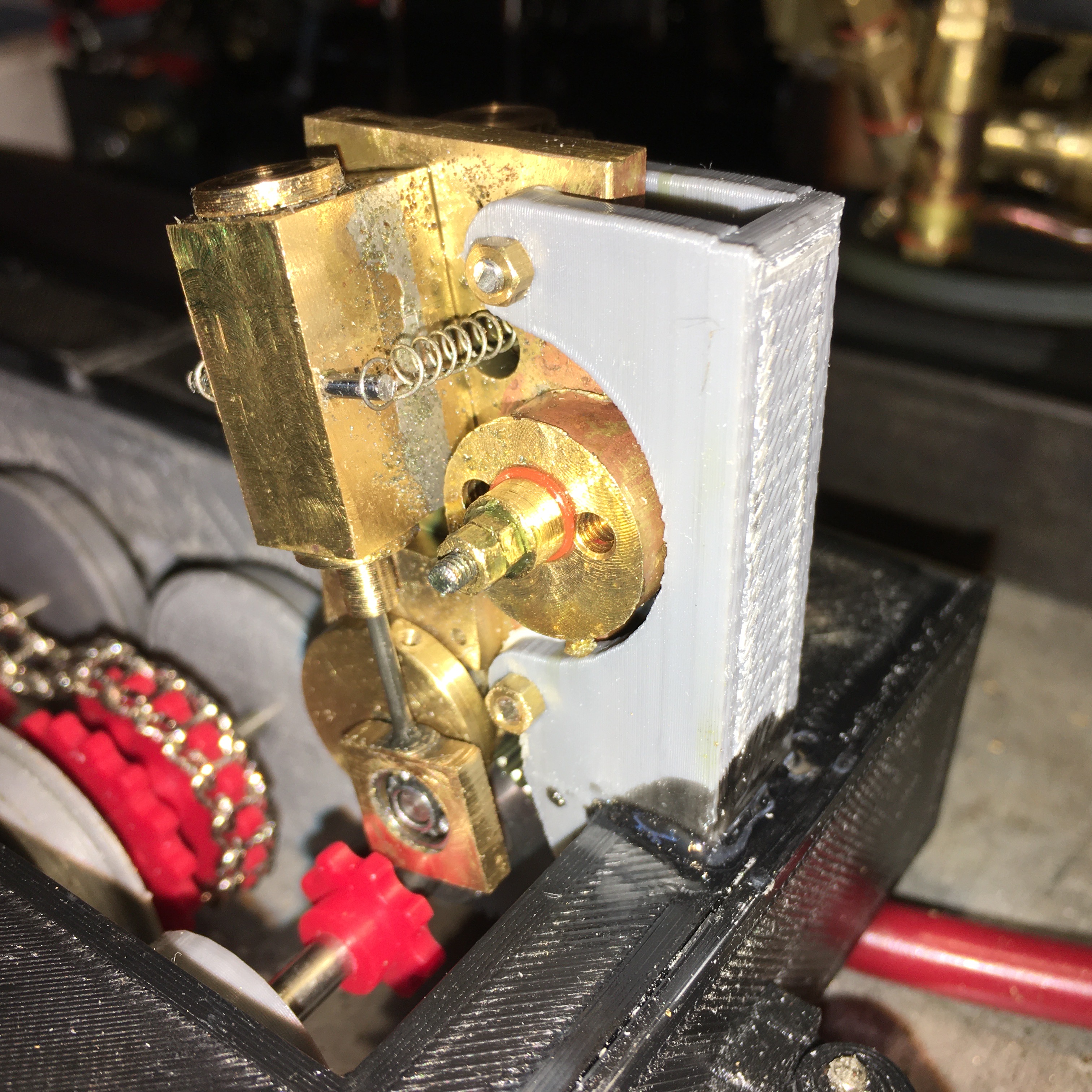

The steam motor is now firmly located on the chassis and it runs on air. The drive shaft rotates freely, although one crank just catches the ball race and the other may well touch the chain when its fitted. To be rectified when the chain arrives.
The reverser is tending to leak as expected. I didn't use a spring to hold it onto the port block but an O ring:
I thought it would provide more pressure. So you can see the red O ring, and a spacer which has a slight depression in its inner face to take the O ring. Two nuts are locked onto the stud with lock tight and by locking the nuts against each other. The faces on the other side are well coated in steam oil. The arrangement for controlling the reverser is shown here:
A brass ring, with a saw cut top to bottom, and 10BA bolts pinching the cut section onto the reverser. A long stainless bar protrudes forward, to control it by hand.
I will add the components to mount the steam motor to the 3 D printing files section.

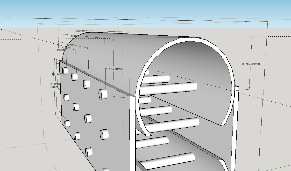

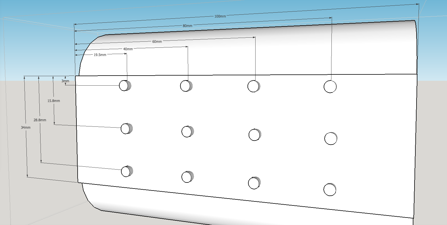

I have started to build the boiler.
An unusual design I know. Two tubes one on top of the other with slots to allow steam and water to pass through, as well as to allow for the cross stays:
Rather than cut the copper tube longitudinally as per the drawing above I decided to make 6mm slots across the tubes, to allow for the cross stays etc. Just seemed a "better" way to do it. The end plates are not shown in the views above, but I will describe those later.
Starting with two tubes.

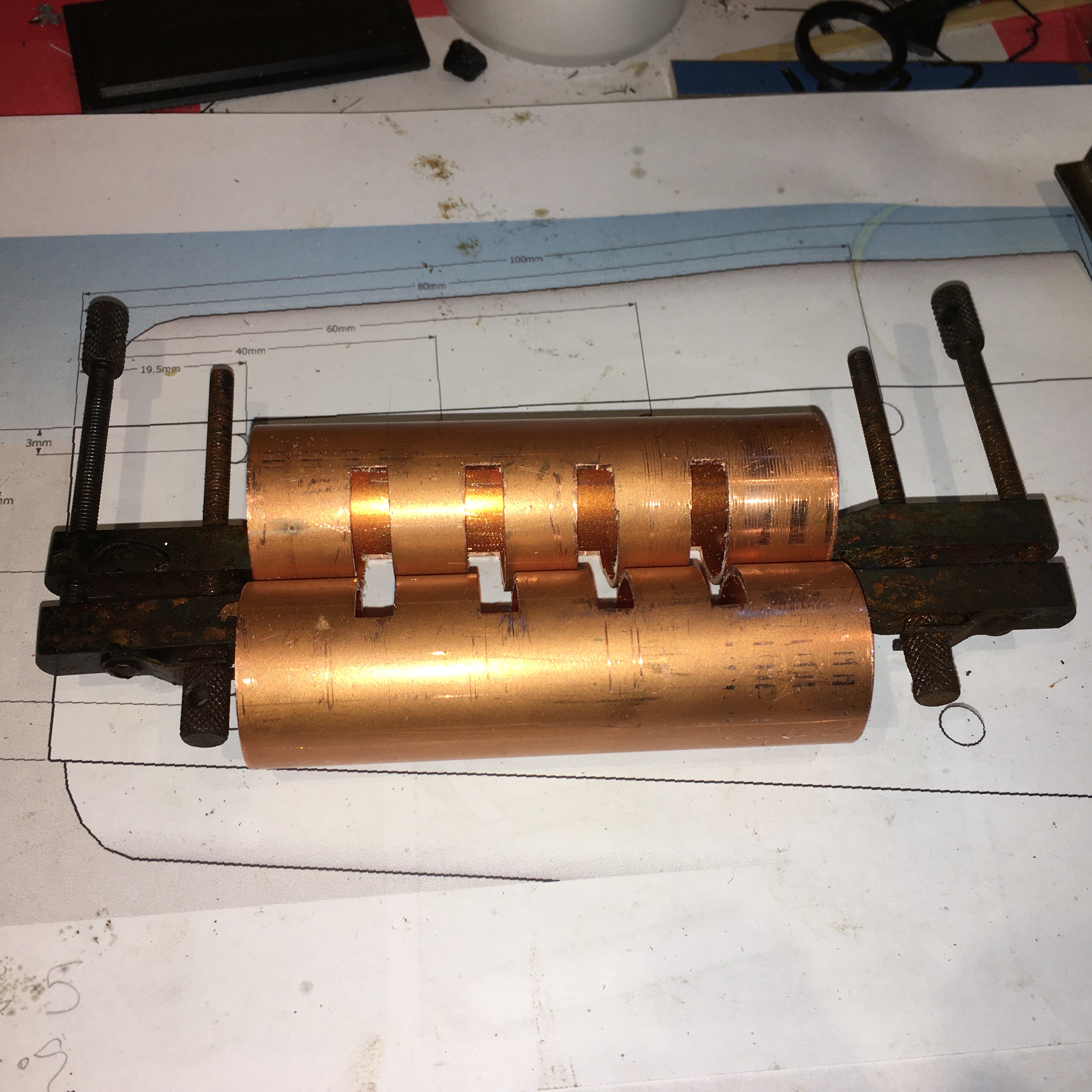

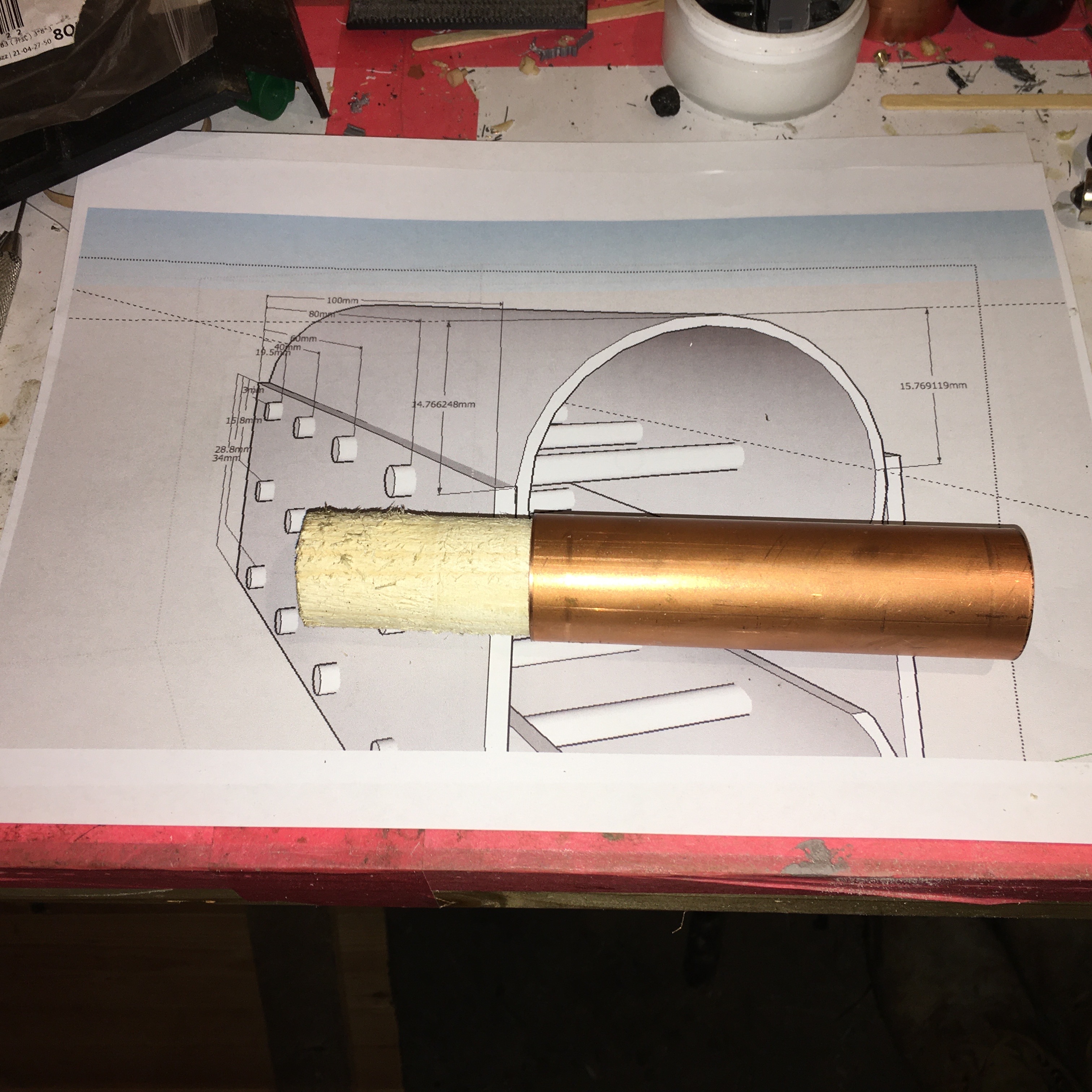

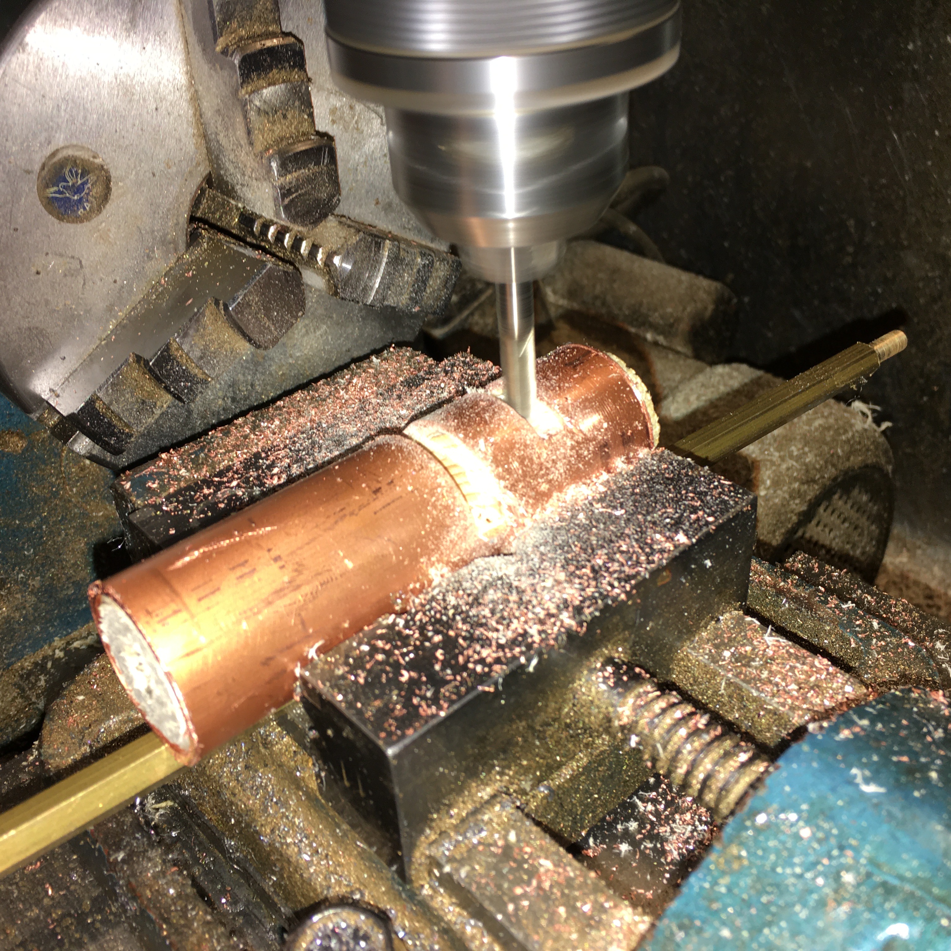

Making the boiler.
I have turned lengths of softwood to be a smooth sliding fit inside the two lengths of copper pipe - so that they support the copper while it is being machined:
and cut 4 slots 6mm wide in each pipe where the cross stays will go:
I also drilled 2 6mm diameter holes in what will be the top of the boiler to take bronze bushes for safety valve and filler.

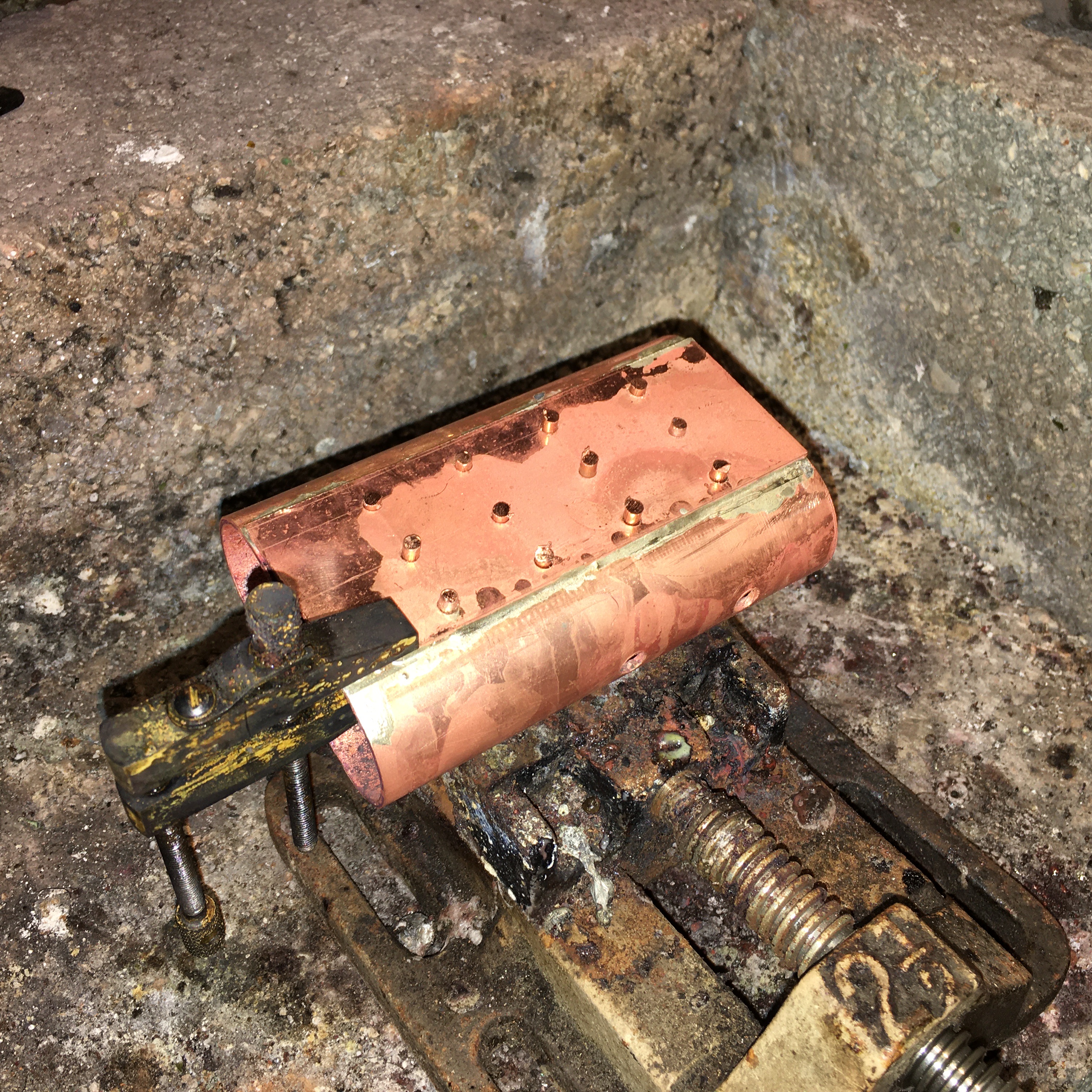

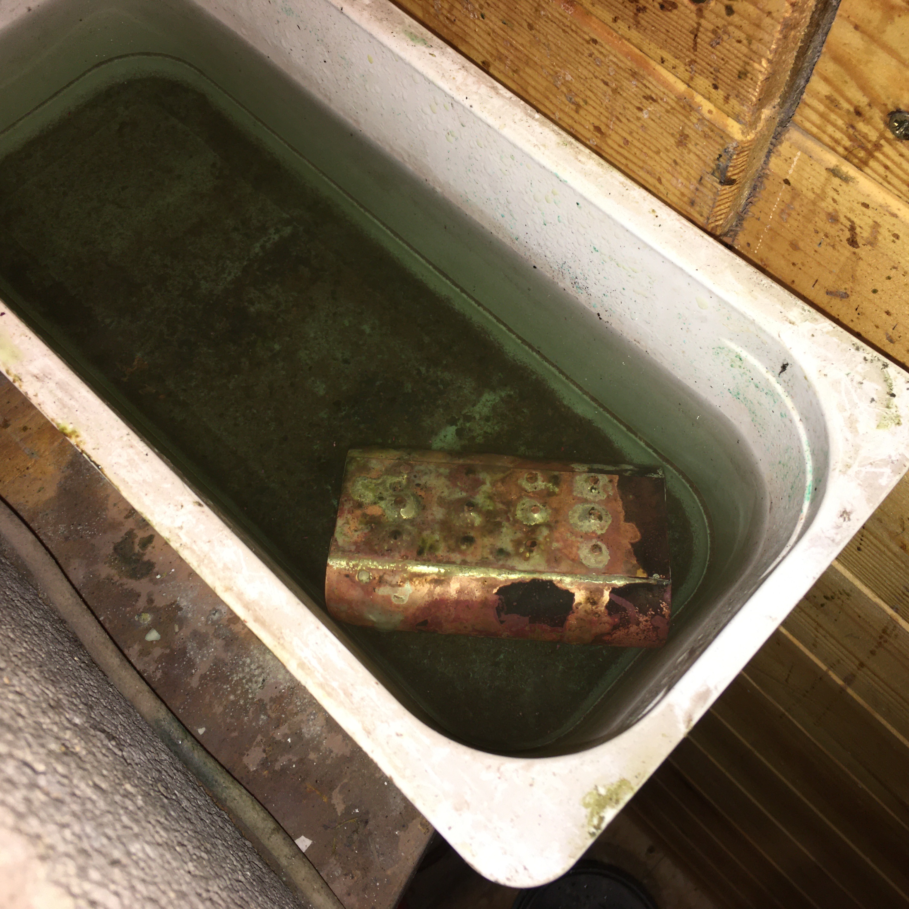

The side plates silver soldered and the cross stays fitted ready for a second silver soldering:
Cross stays silver soldered, and the assembly in the pickling bath to remove the flux residue:
As the assembly gets more mass the heat required to solder it increases. I am now having to use my biggest torch, with the gas pressure turned up high to solder it. It took about an hour to get those cross stays soldered up.
