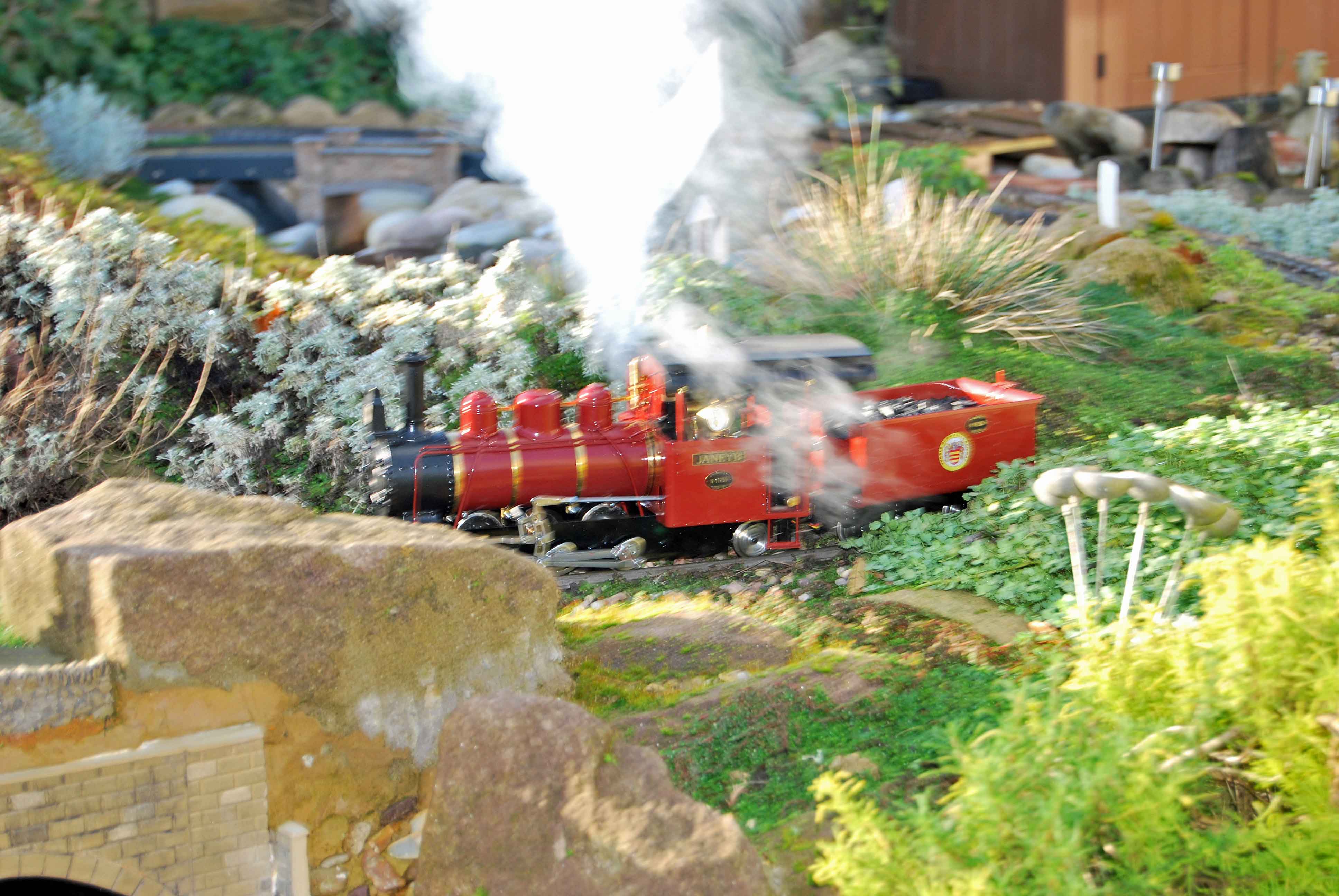

Had my Fowler out for a run at the weekend, when first bought it would not pull the cane wagons and molasses tank (which are all metal and very heavy) up my 1:25 gradient, now after some gentle running in no problems at all. I appreciate this is not quite to Aaron's standard, but I am happy with it.
- Posts: 1193
Re: Roundhouse Fowler
Looks great, Jimmy. Again, love the colour. Long as you like it, that's all that matters. Good to hear it's running in nicely. I wonder how much a fully run-in Fowler could pull..
