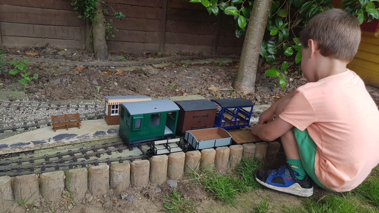

I've got a small loop and station that's keeping myself and the kids happy, with an electric Quary Hunslet. I'd like to start a journey with some live steam.
The loop is pretty much flat, so thinking I could start manual with an idea to add remote control later. Looking around I was smitten with the idea of a Roundhouse Bertie, with a view to adding and detailing in the coming years. Then I found a comment that you need to push it first in the direction you want it to go, is this correct? This means remote control wouldn't be able to control the direction? I could never run round my coaches without nudging the loco first.
I'd like to expand the loop with some operational interest, so not being about to drive it properly would put me off. But then I'd also need a bigger bank balance!
Thanks for the help.. I'm sure many people have been down this slippy path.
My son getting the workman's special ready to depart.
