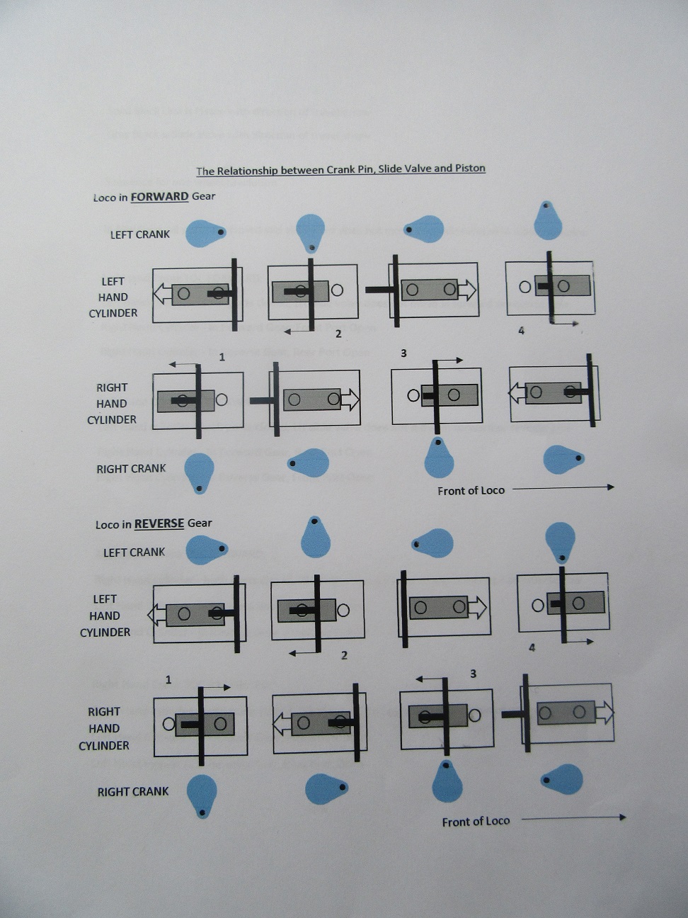

Haven't had a chance to try further, but have drawn out the sequence of events for crank, slide valve and piston for one wheel revolution which helps clarify where everything is and which way it is travelling for any given wheel position.
- TonyW
- Posts: 1357
- Location: North Wales
Re: Roundhouse Valve Timing
That's a help but it would be better if it showed the valve positions at just past back and front dead centre rather than AT back and front dead centre. So, instead of showing the three and nine o'clock positions for example, for the right-hand side show four and ten o'clock for forwards and two and eight o'clock for backwards, and the corresponding opposites for the left-hand side. The crucial thing is: When does the valve open the port? And it should do that just past the dead centre positions.
Thanks Tony
The drawing helped me with what was going on, rather than specific valve opening timing, but I'll do that when I get the chance.
