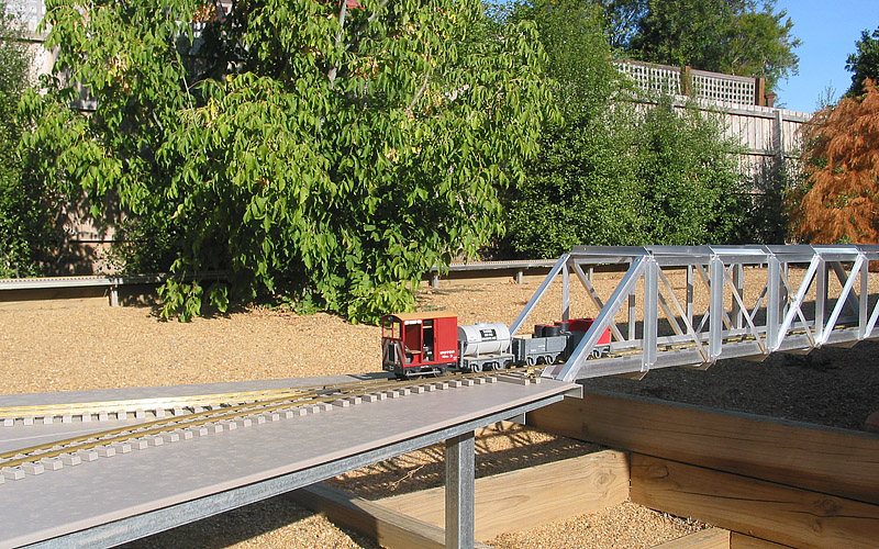

The circle is now closed. The last lengths of track on the bridge approach and the bridge were fitted on Friday and the first train has run the full length of the mainline, including crossing the bridge.
The photo shows the inspection motor and the weed killer train running over the bridge on it's first run. Normal scale running speed for this motor is about 5 mph and it took about 6 min. for a complete circuit of the track........

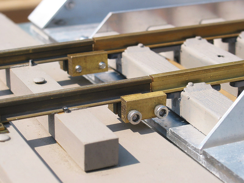

Someone asked how I was going to locate the bridge accurately. The next photo shows the arrangement I used to maintain alignment between the rails on the removable bridge and the fixed rails. They are a rail clamp with part of it milled away, so there is a recess for the rail on the bridge to sit in. This keeps the rails lined up horizontally and isn't particularly affected by movement in the abutment posts, as the bridge has enough clearance in the mountings to move around.

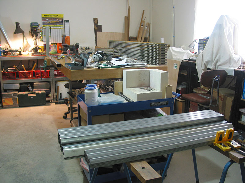

By mid-February I had managed to finish the track and turnouts and my workspace was rapidly diminishing. The next step was erecting the steelwork and this time I had it cut to size, which was cheaper than having the full lengths delivered. The cut pieces fitted in the car boot and it also saved time and effort manipulating long bits of steel into the bandsaw.
The photo shows the bench top covered in turnouts and track, while the floor area had been further reduced by the steel stacked on sawhorses in the foreground.

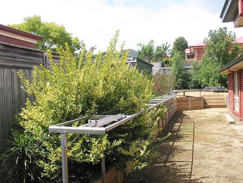

A couple of weeks later and the steelwork has been fabricated and the first supports have been installed, in between rain storms. This time around the 40mm galv RHS is bolted to the retaining wall rather than sitting on a star picket and the wider deck means the cross beam needed a support brace.

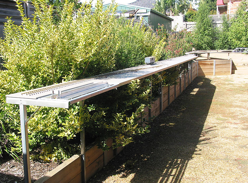

Another week or two and the rest of the supports and the longitudinal angles have been installed.

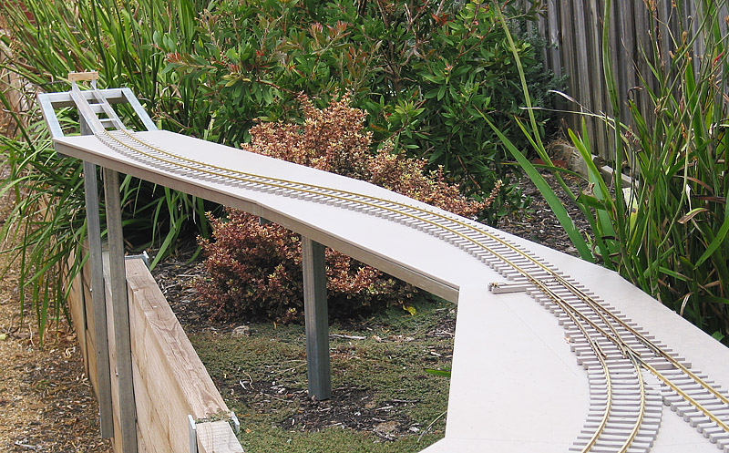

Fitting the decking only took a couple of days, including cutting the bits to size. The decking is the same material as the rest of the track, 10mm thick Weathertex.

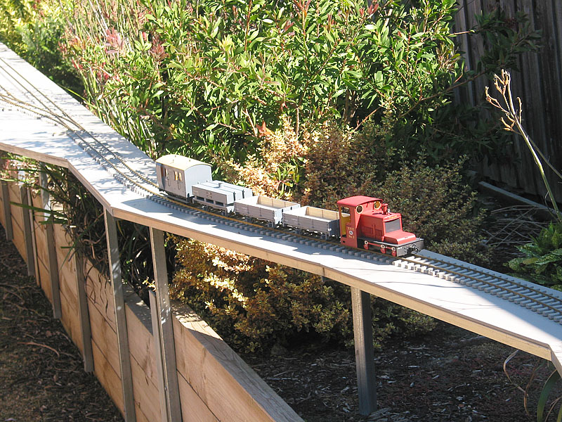

Today dawned clear and hot, so a morning run with the Fowler Motor Mule and a small work train to test the track laying was all that was attempted. The train is shown leaving the station and heading for the mainline.
The station track work and the operation of the mainline and wye junction were tested and worked as planned. So the next step will be a steam run on the weekend when the weather has sorted itself out again.

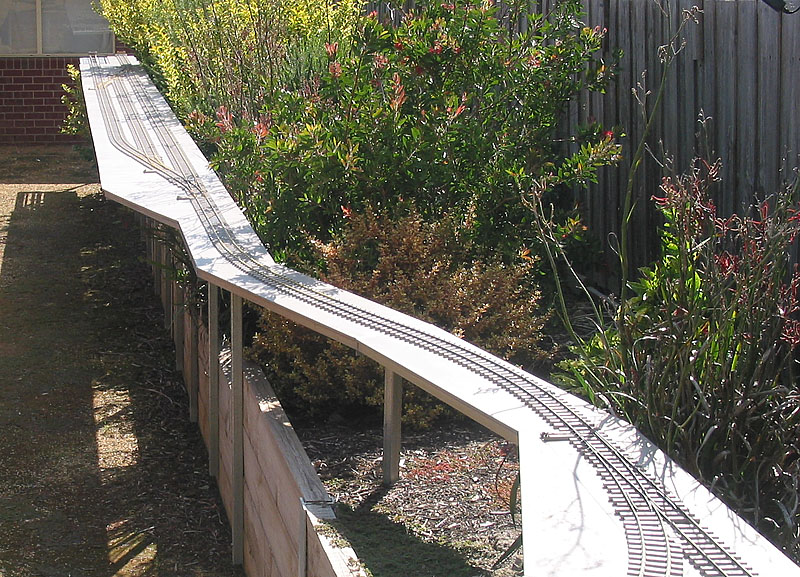

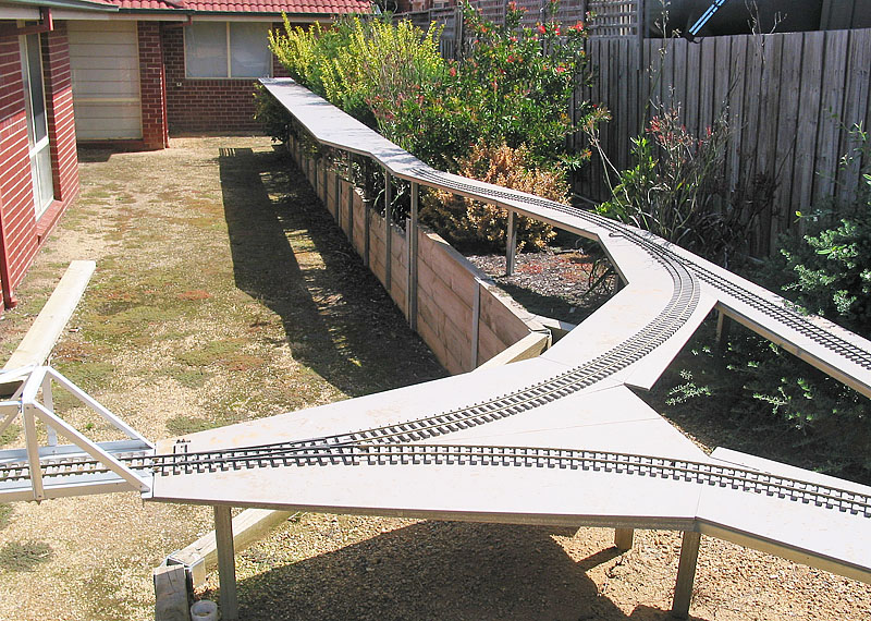

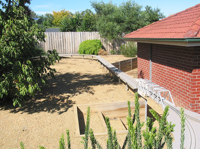

The final two photos. show the mainline as it is now, as I realised no photos of the mainline loop in finished condition were shown in the previous instalments of this saga.
The first is taken looking south and the junction to the station is out of shot to the right.
Track Supports-31.jpg (286.13 KiB) Viewed 10689 times
The second is taken facing the north and the junction is visible in the distance just past the truss bridge on the right. The angle of the fence compared to the roof line of next door's shed shows what the ground contours are like.
