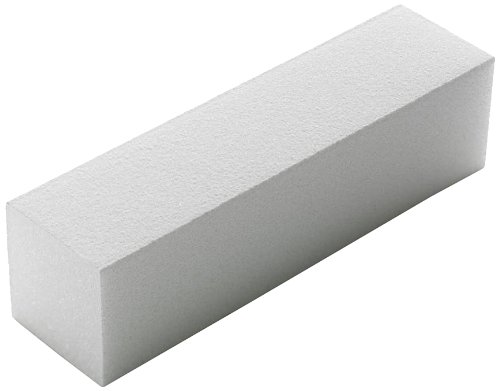

This is how I cut my Plasticard Rob, no matter how big the sheet is....
This is a scrap bit just to show you.
And this is the stuff I use, you can get it off the Bay....It goes a long way and it's what is used in the making of liquid solvent glue, well in the UK it is....
I have just bought a 2 1/2 Lt bottle and that will see me well into my real old age.....
For oblongs and round, I use my cordless drill, it can run at very slow speeds, virtually stopped
The oblong is done by drilling four holes just inside of where I want the oblong, then it the same principal with straight cuts. For tiding up any rough bits on the card it's those files your other half has for their nails, I admit I use them too....
Like these...You can get different grades up to 240 grit, also the second photo of those blocks are far better than cutting sandpaper and using a wooden block. They also come in different grades.
I have been doing a scratch build in-between Grandkid minding duties, but until it's finished and I get the time, it's not going in a thread yet. There you will see how I build with Plasticard. They main thing Rob has I have mentioned is to take your time and don't get over awed by it and people. It's great stuff to work with and I am so glad I now use it, no more stuck fingers with that other thick stuff you need for other materials...
Don't get me wrong I do use Foamboard and it is also great stuff to work with and I have made and will continue to do so with it, plus coffee stirrers and all kinds of material, but Plasticard is my favoured material for now...
The thing is Rob, use what is best for you. I have and these are all I need, nice and simple.....
