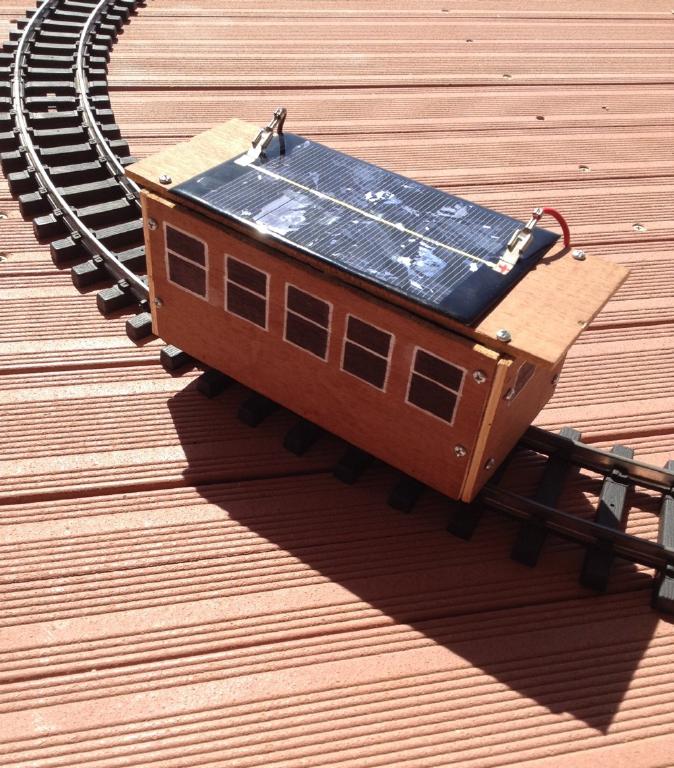

Post by steam Technology » Tue Dec 22, 2015 9:47 pm
A scratch build model to harness the free power of the sun for running
This was the first test run to prove the concept works
It ran really well
Annie

I had not seen the steeple cab Loco before. It also runs well. Mine does not rely on any cells at all, but I can connect in batteries for indoor or cloudy days.

I liked the idea of a solar tram so much that I built my own.
https://www.youtube.com/watch?v=MyiBZ1v-xPc
As you can see, it runs just fine in the sun, but the shadows stop it dead.
I have now modified it so that the solar cell charges two Ni-MH cells via a diode and then the motor is fed from the cells. Works just dandy and its free electricity 8)
