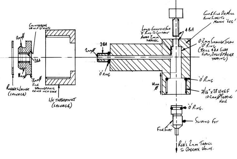

I have a great big tank full of really cheap butane and yet here I am buying camping stuff at over a fiver a tin. So the obvious question is; how do I get the calor gas into the loco?

There are some details of an adaptor for the 4.5kg gas bottle on the 16mmngm Yahoo Group (attached here).
Suggest you get in touch with Keith Bucklitch for more details (contact details on the 16mm NGM DVD).
I use the camping gas canisters with an asian converter for EN417 fittings - B & M currently selling 4 for £3:99.
Chris Cairns
Edit - appears we can no longer attach PDF files here?
-gas adapter (machined).jpg (53.53 KiB) Viewed 6854 times

Thanks. Looks like I will have to make one.
