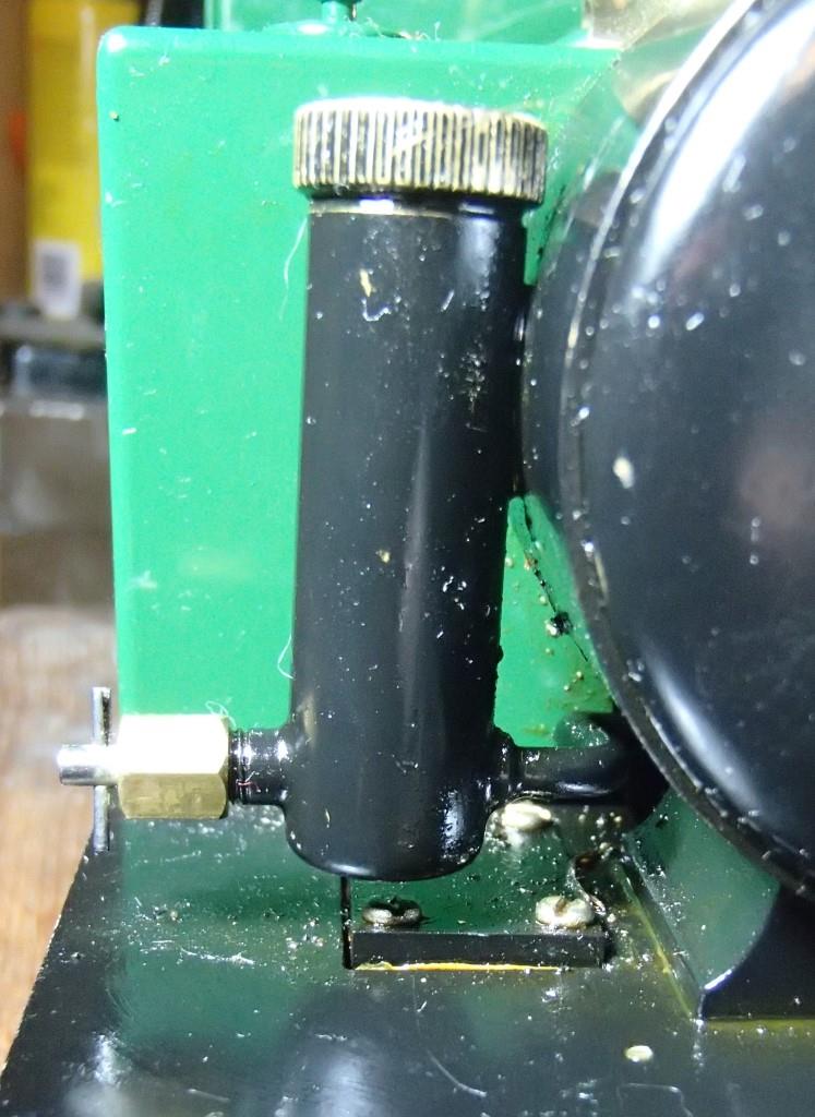

Post by Boustrophedon » Thu Jan 05, 2017 8:31 pm
LNR:122046 wrote:I would love to see a pic. of the lubricator in question.
This is it.  There is no riser inside, the oil exits at the bottom. The valve controls the flow.
Last edited by Boustrophedon on Fri Jan 06, 2017 12:58 pm, edited 1 time in total.
Posts: 1902
Post by LNR » Thu Jan 05, 2017 11:43 pm
Thank you for the pic., that's very interesting. I know the Samson has a hole in the side of the smokebox adjacent to the lubricator. Is that just a mounting hole for a screw.
I'm wondering if there's more of a hydrostatic principal used, by simply pressurising the tube, an "ooze" of oil finds its way down the tube. How it still manages to pass oil once condensate reaches the level of the valve that low down, I don't know.
Boustrophedon
Posts: 241
Joined: Wed May 22, 2013 7:43 pm
Post by Boustrophedon » Fri Jan 06, 2017 8:39 am
Yes the hole in the smokebox is just for mounting. There does not appear to be any condensate in the lubricator at the end of the run, it just empties. Any remaining oil does appear to be emulsified though. My theory is that there is pulsating flow in and out of the lubricator, perhaps with changes of throttle openings or with piston strokes that gradually empties the oil out.
Posts: 1902
Post by LNR » Fri Jan 06, 2017 11:19 am
And because steam oil is miscible in water even if the lubricator is passing condensate, it would be oily. Our small engines use pretty wet steam and we are probably over lubricating to some extent. Your pulsing theory brings to mind Bourinelli' (spelling? it's a long time ago!!) law, something about the turbulence in the boundry layer around the inside of a pipe depending on velocity!!!. I guess the important thing is, it works and obviously works well if you consider the reputation Cheddar locos have earned.

Post by KNO3 » Fri Jan 06, 2017 11:58 am
I'd also like to know how this lubricator works. Does anyone have a good explanation?
In my Samson it is always empty at the end of a run, I gues I keep the valve open too much.

After Boustrophedon mentioned there was no condensate left in the lubricator at the end of a run, I got to thinking that it's a little unusual to find anywhere in a system open to steam with no condensate. I wonder if this indicates a venturi effect in the lubricator line?

I am at a los to know how it works. I suspect that it stays too hot for water to condense. Having said that I am surprised at how cool Samson stays during a run, Both Katie and Ragleth are too hot to handle all over after a run, but Samson stays very cool. Samson does not use superheated steam which may have a bearing on how the lubricator works.

The only thing that comes close to Samson's lubricator is a Furness lubricator.
We have these fitted to our Andrew Barclay 0-4-0ST. They are mounted on the front of the cylinders and rely on a vacuum effect during the exhaust stroke or when coasting to open a non return valve allowing some steam oil to be sucked into the cylinder.
Boustrophedon wrote:Both Katie and Ragleth are too hot to handle all over after a run, but Samson stays very cool.
An classic example of thermal conductivity. Samson is an all steel construction, whereas Katie & Ragleth Mark II have brass bodies.
