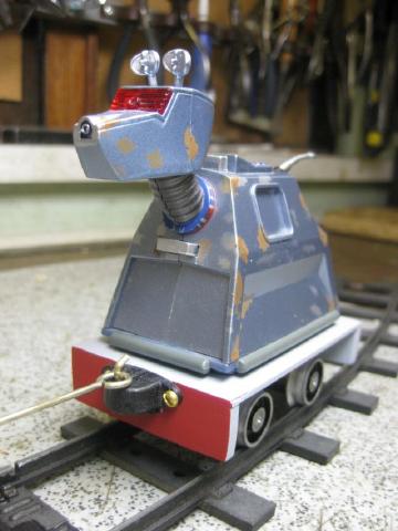

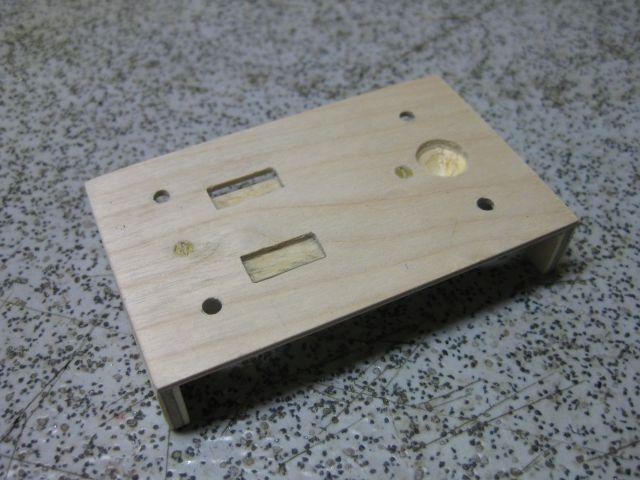

During the Winter I overhaul and make new stock to entertain the public at the CMES open days. One of the new wagons made is to transport a toy; another Charity Shop buy. There have been many of these simple wagons made some that have been used for maybe 15 years. These wagons are quick, simple and inexpensive to make often in batches, though this one is a one off and smaller than the others usually made, but its construction is the same.
The load.

The wagon body made from four pieces of wood.
The axle wheel assembly glued in place.
Load fitted; the couplings are modified Binnie 'Carmarthen' which are reasonably priced and I find work well.
Wagon and locomotive?
Any question pleas ask.
Regards Tony.

Great, can you fit sound? Maybe use the recorded message chip posted on the forum to record 'Exterminate' and a K9 reply.

Hi Roby,
Alas no: beyond my technology I am afraid.
Regards Tony.

Testing on the GR. First run this year! at:
https://youtu.be/yhrEQGQvhos
Regards Tony.

Would I be correct in assuming the hole in the brass tube is for lubrication. And what glue do you use to stick the brass tube to the wood chassis.

Hi Barry,
Yes and Super Glue but I have used Aradite.
