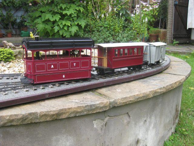

Post by Tony Bird » Wed Aug 05, 2015 10:55 am
Hi,
I have just finished painting the tram engine and I am quite pleased with the results.
Regards Tony.

As i said in my email Tony, amazing! I'd love to know how long it took you to solder in all those cross tubes :)

Tony Bird
Posts: 601
Post by Tony Bird » Thu Aug 06, 2015 9:24 am
Hi Alan,
Not as long as you think. The cross tubes, as is the rest of the kit are extremely accurately made.
First some sums were done to work out the space between the cross tubes and some spacers made. Then the four longitudinal tubes were made the same length and marked out for the larger spaces, two cross tubes were soldered in place about 50mm from each end (where one of the cross tubes were to be positioned). The end tubes were then soldered in place. The remaining cross tubes were introduced diagonally and soldered in place using the spacers to correct the distances. All the tubes are soldered to the top tube about every fifth to the bottom tube as well. There are about 40 cross tubes I think I had 5 left over. Some notes on the way I soldered the kit together bearing in mind I had not assembled an etched kit of any kind before so there was a certain lack of knowledge. I rarely use soft solder and except for wiring my skill with a soldering iron is at best poor. Most of my working live was in the jewellery trade were we used gas torches and hard solder. The instructions in the kit specifically say not to use a gas torch as it will create distortion of the model, which I agree with. However if you are very experienced with using a torch it is possible. I used plumbers solder and Baker's fluid as a flux but it would probably be easier using some of the low melt soft solders that I didn't know about. I might even manage those with an iron!

I didn't know that the Schull & Skibbereen used tram locomotives, my knowledge of railway lines is not very great. However my late father about 25 years ago built a number of Pearce kits based on the 1st. class carriage of the S&S, I still have a number. The original kit as was the prototype was 4 wheel which alas wouldn't negotiate the tight curves of our layout so they had bogies fitted. It was the colour that these coaches had been painted decided the colour of the tram; Ford Burgundy. Though fictional they are still a Celtic Tramway.
The lining on both tram and carriage is Trimline tape lacquered over.
Regards Tony.
