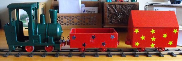

I decided on an IP Engineering budget chassis in the end - seeing how simple it was has decided me to make my own in the future. The wagons have been made bomb proof (hopefully) as my grandson is only 28 months old. Colour scheme of the wagons suggested by his 5 year old cousin! The battery is going to have to go on the floor of the cab.
