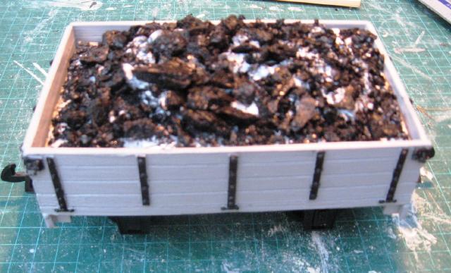

Post by ge_rik » Mon Dec 29, 2014 12:06 pm
I use crushed coal - to my mind it's the most realistic even when scaled down.
I make my loads removable so I can run the wagons Down the line loaded and return Up the line as empties.
I'll happily send you a bag of coal for the cost of postage. Since we've replaced our fireplace with a multi-fuel burner which only burns logs or smokeless, I still have some real coal left over which I'll happily bag up for you.

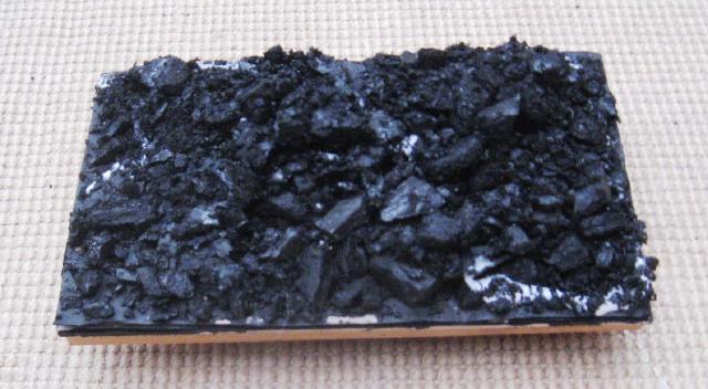

planty:106892 wrote:How did you secure/seal the coal to the removable base?
Plenty of PVA. A base layer of coal, then a couple of increasingly smaller layers rising to the centre of the wagon.
In hindsight, I should have given the plywood insert a coat of matt black before applying the PVA. The PVA dries clear eventually.

If you make the base of the insert convex it will be easier to remove. Just press one end and the other will lift to be picked out of the wagon. :)
