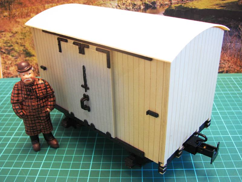

2. Test model of the L & B 4 wheel van (£15)
The roof has yellowed & the gray sides faded. There are no data markings & there was no chopper couplings (just the back mounting plate from one on one end – I've obtained the L & B chopper couplings, just need some screws/bolts to mount the 2nd one). The wheels are interesting and I guess an earlier attempt at insulated wheels.
These were very wobbly running and initially I was going to get replacements. However on taking the van apart I found 2 of the axle box’s were misplaced (one was loose on the horn guide, and the other had been pushed up to one end of the horn guide), so after gluing them back in the right place the van runs OK on 45mm track. Just need to get a set of L & B 32mm wheels.

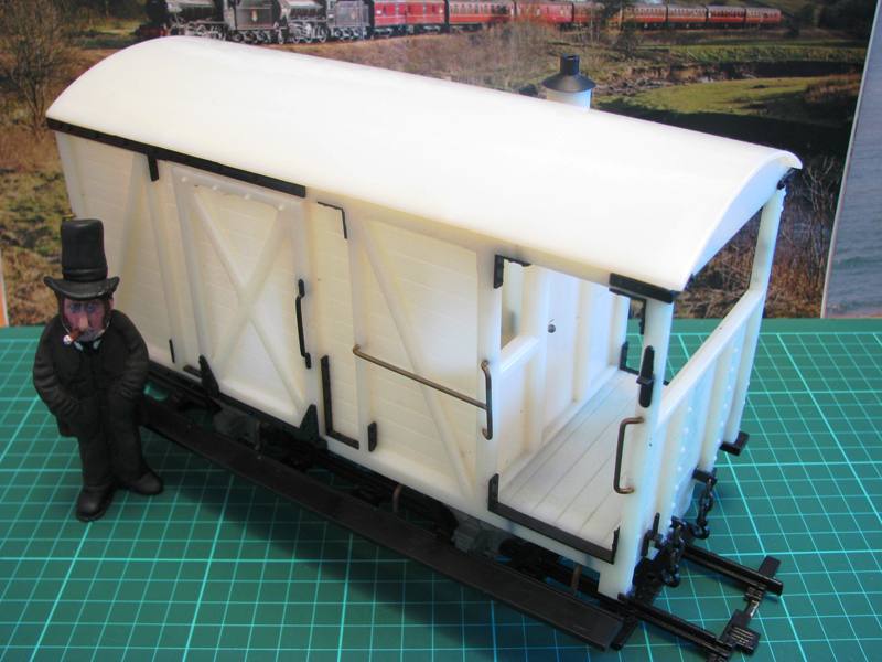

3. Unfinished W & L Brake Van (£25)
Unpainted, missing some of the detailing, no window glazing, no chopper couplings and 32mm wheels only but no bearings in the axle boxes. I’ve obtained W & L chopper couplings (just need mounting screws/bolts), axle bearings which need gluing in, and need to get a set of W & L 45mm wheels.

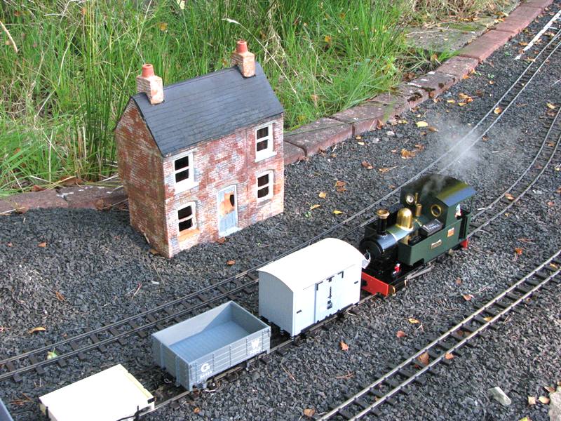

Originally these wagons were going to get their first outing on our 45mm indoor layout next Sunday. However an e-mail invite to the SMET 'Visiting Engines Weekend' saw the plan change and I went through the process of changing the wheelsets to 32mm for running at Methven yesterday.
Started off on an L & B 4 wheel wagon. Removed one axle box, removed the 45mm axle, inserted a 32mm axle and replaced the axle box only for the 32mm wheels to fall out. WTF! Turns out that there are two length axle's of L & B wheels available, 63mm & 77mm. Whilst either length axle works OK in 45mm, the smaller length axle in 32mm is not compatible with the L & B 4 wheel wagon & 4 wheel van.
My working solution to the shorter axle was to mount nylon washers as spacers, ending up with 16 washers fitted per axle.
There is nothing obvious in any of the online listings for Accucraft Z3 - Wheels – L & B 25mm DIA, Gauge 'O' to state the axle length. I guess the different axle lengths may be because of the bogie L & B rolling stock.
I had no problem changing the W & L wheelsets.

Yesterday was our last Steam Sunday for this season so I got to run 7 of these wagons on our indoor 45mm layout. Picked up a set of Z3 L&B 32mm wheels from a fellow volunteer, so just a set of Z6 W&L 45mm wheels required for a complete dual gauge rake. Fitted axle bearings to the W & L Brake Van axle boxes - one set painted up and re-fitted so far.
