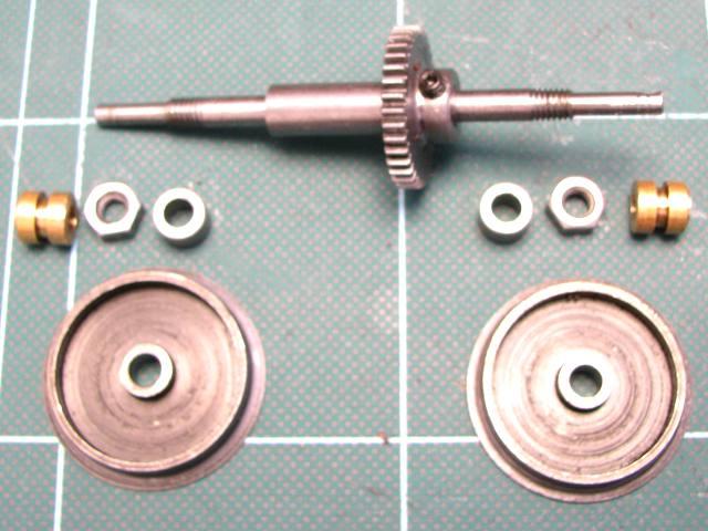

I'm correcting myself. Its not the driving axles that have have been raised but the screw holes for the fixing plates that have been lowered because the layshaft is also lower. The locos ground clearance is the same as before.The "Mk11" version has the same axles as version 3 but the fixing plates are shorter as the driving axles have been raised by around 2mm or so as the cog on the axle is a slightly smaller diameter than the Mk1
Have just about completed re-gearing of the Brunel and have test run it on both the rolling road and the part of the garden track that isn't under construction. Seems OK but not yet as free running as before.Of course some parts, including the layshaft bearings are completely new, so there will be a degree of running in to be done.
Have discovered one of the driving wheels has been drilled off centre so the wheel moves slightly up and down as it turns. I only noticed it today because the new Peco track is far more level than the old Mamod track I'm replacing. Its a bit embarrassing as I've owned my Brunel since 2012.

I'm sure they will sell you the necessary items, but it will be expensive as the loco with the new gearing has had other alterations as well. In particular the cylinder is lower. The boiler has also been redesigned with the pressure gauge now at the rear, the chimney flair at the top removed, the regulator location reversed and the drain for the steam oil lubricator moved, although these latter changes aren't necessary for the re-gearing.
You'll need:
* new left and right side frames
* new rear plate with different cut out.
* new boiler support plate with different cut out.
* new con rod
* new slip eccentric rod
* 4 new plates to retain the axle bearings
* 4 new cog wheels for the new gearing.
and, if your existing axles are retained by stretched O rings, you'll also need:
* a new driving axle
* two new driving wheels.
In other words, the only things you'll retain from your existing Brunel are the boiler, the burner plus gas tank, the cylinder assembly and the cosmetic bits plus buffers at either end of the loco.
The most expensive items are the 4 new cog wheels. Naturally I've no idea what they cost Mamod but I do know how much it costs me, as a clock restorer, to purchase replacement wheels. As you'll see if you search the internet for "spur gear wheel cutting", it will cost you upwards of £25 per wheel.
I've therefore concluded that, unless there's a good reason to want to keep the existing loco, it would be cheaper to sell your old Brunel and then purchase a new one from Mamod.
