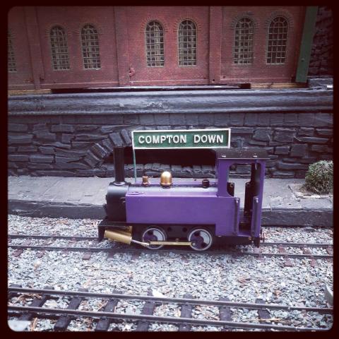

PeachBottom
Post by PeachBottom » Mon May 05, 2014 8:41 pm
Her name is Paloma! :)
Pics coming....I have a bunch on my real camera, but this one off Instagram will have to do for now:
dougrail
Posts: 1535
Post by dougrail » Wed May 07, 2014 9:41 pm
It's purple....but works with the brass and black :) Any news on the repairs or upgrades yet?
PeachBottom
Post by PeachBottom » Thu May 08, 2014 9:34 pm
No time to even sort out what we want to order, let alone do any of it! :(
DLRdan
Post by DLRdan » Thu May 08, 2014 10:43 pm
Looks an interesting colour though I think you could use a day in my workshop.
