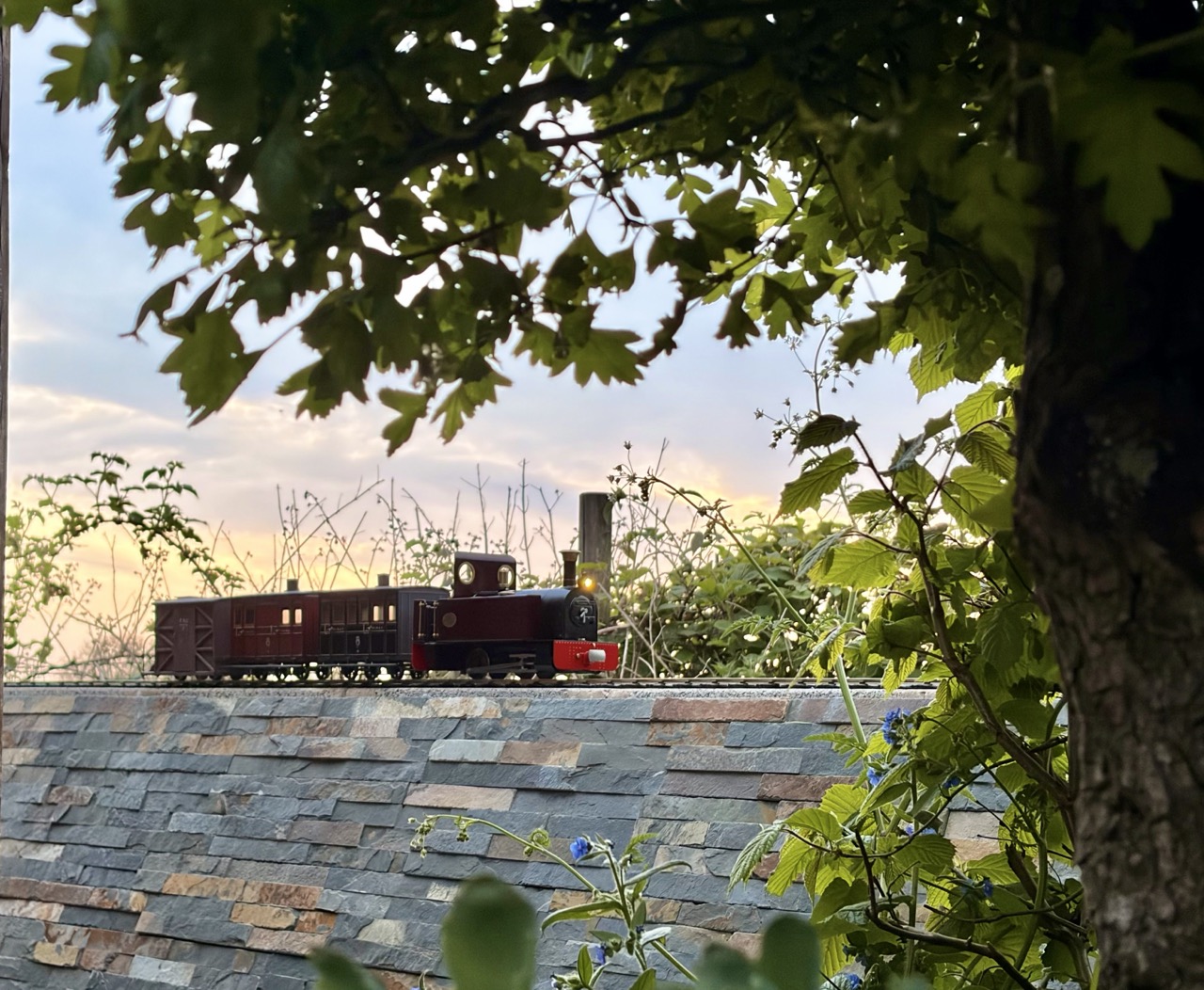

I've always liked the view from the back of the garden, so I thought I would extend the railway in a way that capitalises on it. Here is a recent sunset:
S Large.jpeg (285.23 KiB) Viewed 634 times

I can see many pics being taken in the location of that first shot, just perfect with the sky as a background.
Re: The WDLR extension
Posted: Sat Sep 05, 2026 5:51 am
by Allu
Really nice! Beautiful atmosphere! Excellent example of how natural background can be used to create really life-like scenes :thumbup:
Posted: Sat Sep 05, 2026 7:52 am
Red sky at night
Modellers' delight

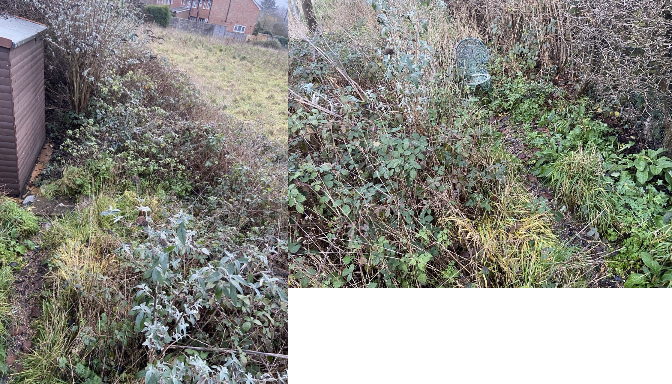

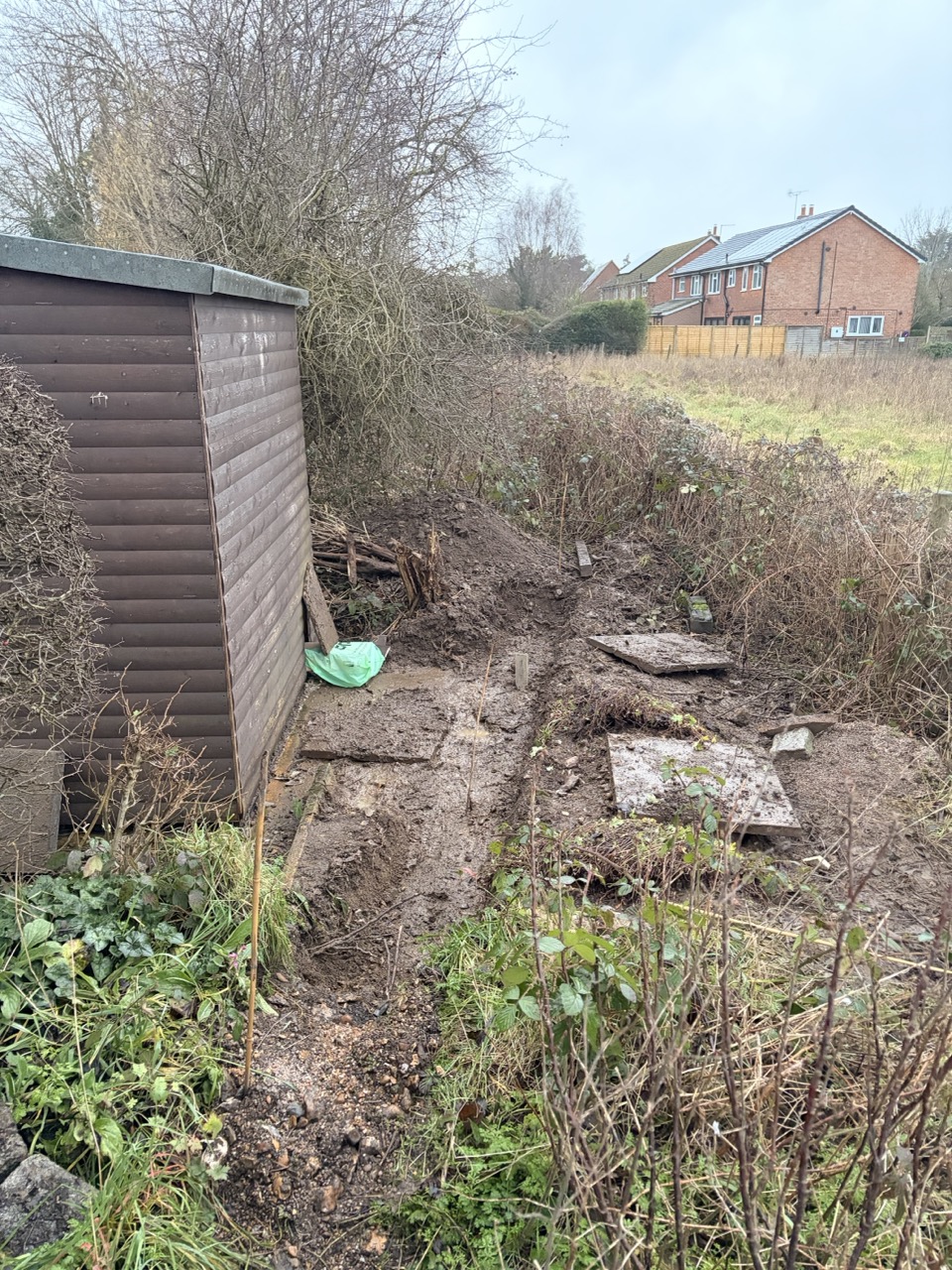

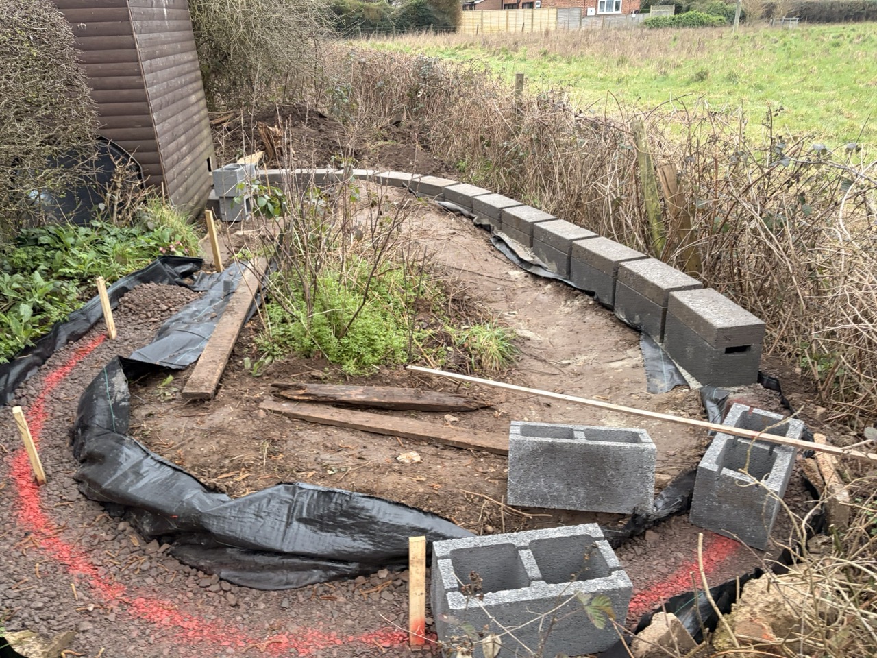

The first challenge was to tame the jungle that had been left to grow for years.
Here is the site - a lot of bramble roots:

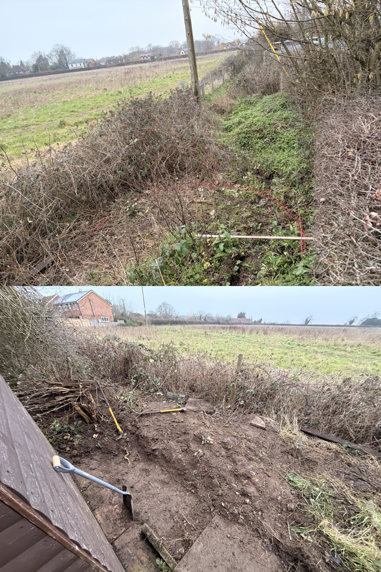

A Mess was made. Aerosols were useful for marking out.
step 1.jpg (1.72 MiB) Viewed 502 times
The Mud got worse. Digging is not that much fun.
IMG_3754 Large.jpeg (608.72 KiB) Viewed 502 times

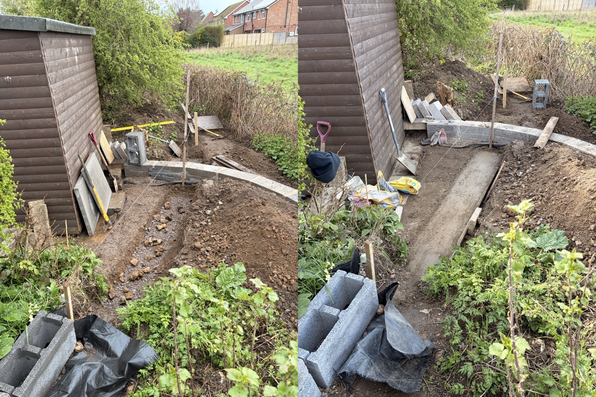

Having made a start behind the shed, I turned my attention to the first section that would connect to the existing railway.
I proudly cut a hole in the shed. The Oak sleeper will carry the track bed. There will be a removable bridge for the shed door.
IMG_3753 Large.jpeg (527.83 KiB) Viewed 436 times

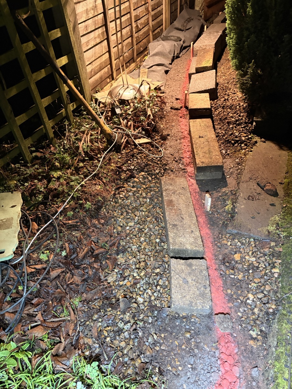

The blocks here will sit on the existing hardcore foundation from the gravel path. As it gets dark here by 4 pm in February, most of the work had to be carried out after hours by candlelight.
Stakes were used to get the 1:37.
IMG_3811 Large.jpeg (610.64 KiB) Viewed 436 times
Point in.
It was a shame to remove the moss - hopefully it will grow back once ballasted.
IMG_3797 Large.jpeg (629.36 KiB) Viewed 436 times
stay tuned...

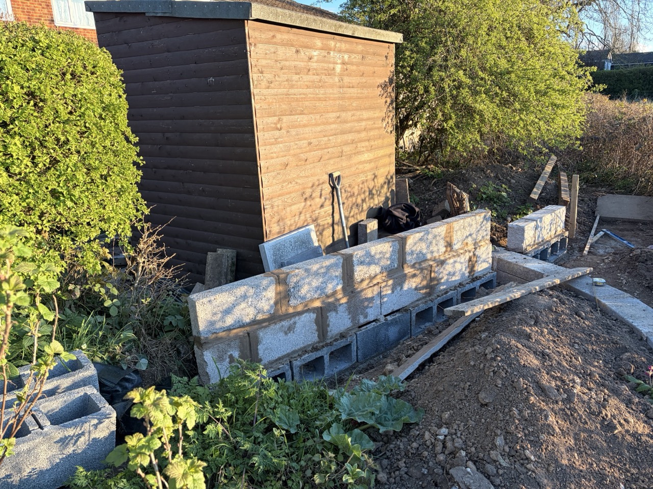

Blocks laid up to the shed:
IMG_3857 Large.jpeg (516.69 KiB) Viewed 368 times
Work could now return to behind the Shed.

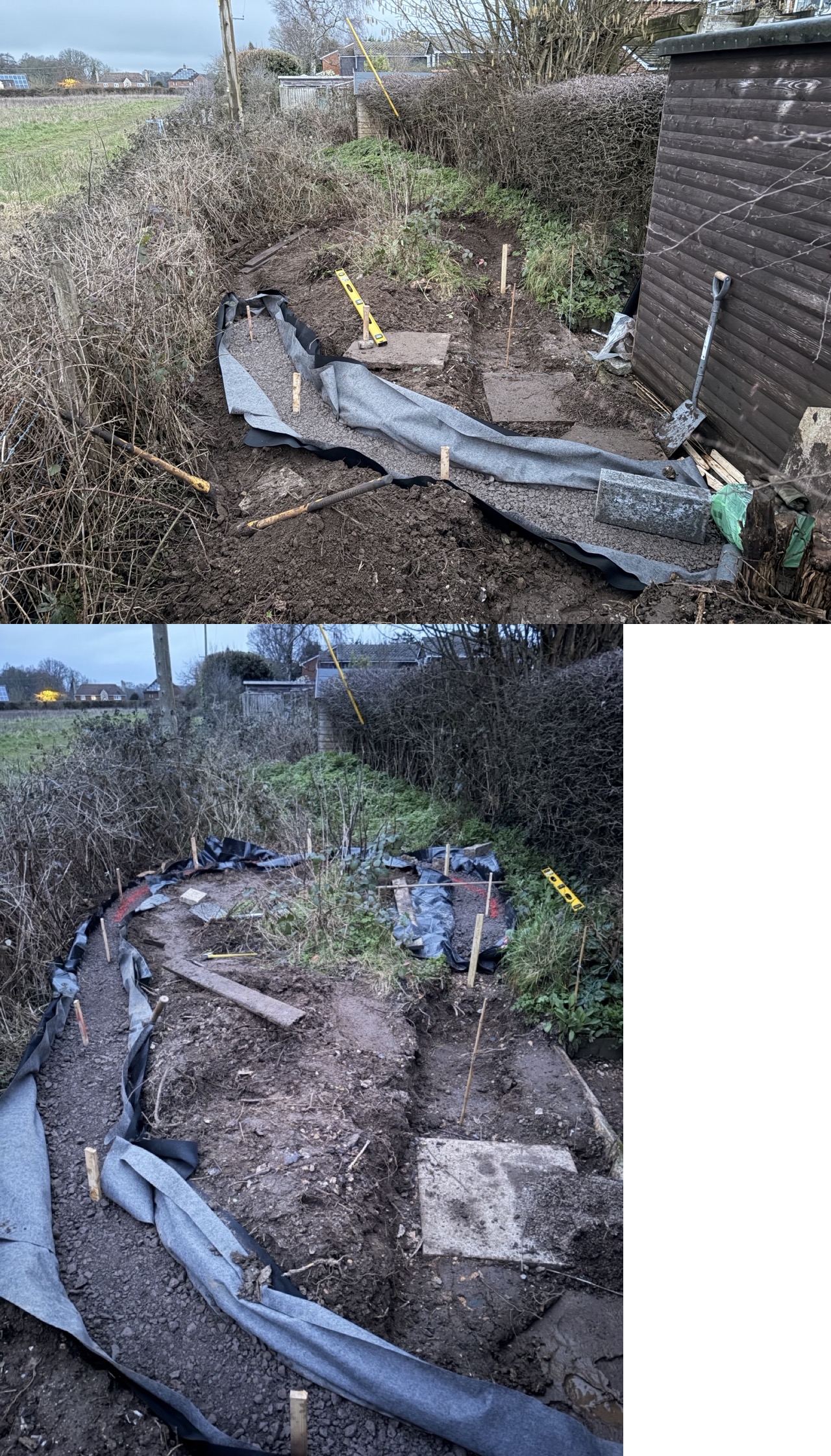

A trench was dug, groundsheet placed and then filled with Hardcore.
This was levelled to the nearest inch before compacting.
Carrying blocks gets quite repetitive
Signs of a railway appear at last! The first block has been laid behind the shed.

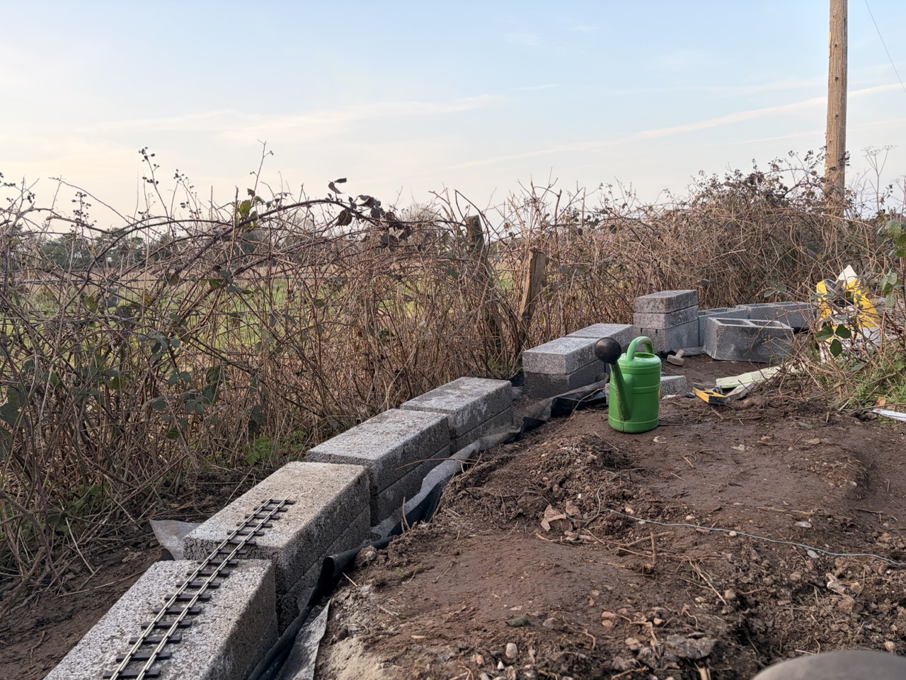

Post mix is very useful for laying blocks. You have plenty of time to make sure the block is exactly level before watering it in - unlike mortar.
IMG_3978 Large.jpeg (593.1 KiB) Viewed 363 times
I have stacked the blocks in doubles rather than like a typical wall on purpose. My theory is, when the ground inevitably shifts or a tree root gets underneath, individual blocks can be relevelled with much less destruction to the rest of the track. Lets hope I don't have to do much of that in the future!
IMG_3987 Large.jpeg (486.09 KiB) Viewed 363 times
Progress is good!
IMG_3992 Large.jpeg (564.6 KiB) Viewed 363 times
more to come...

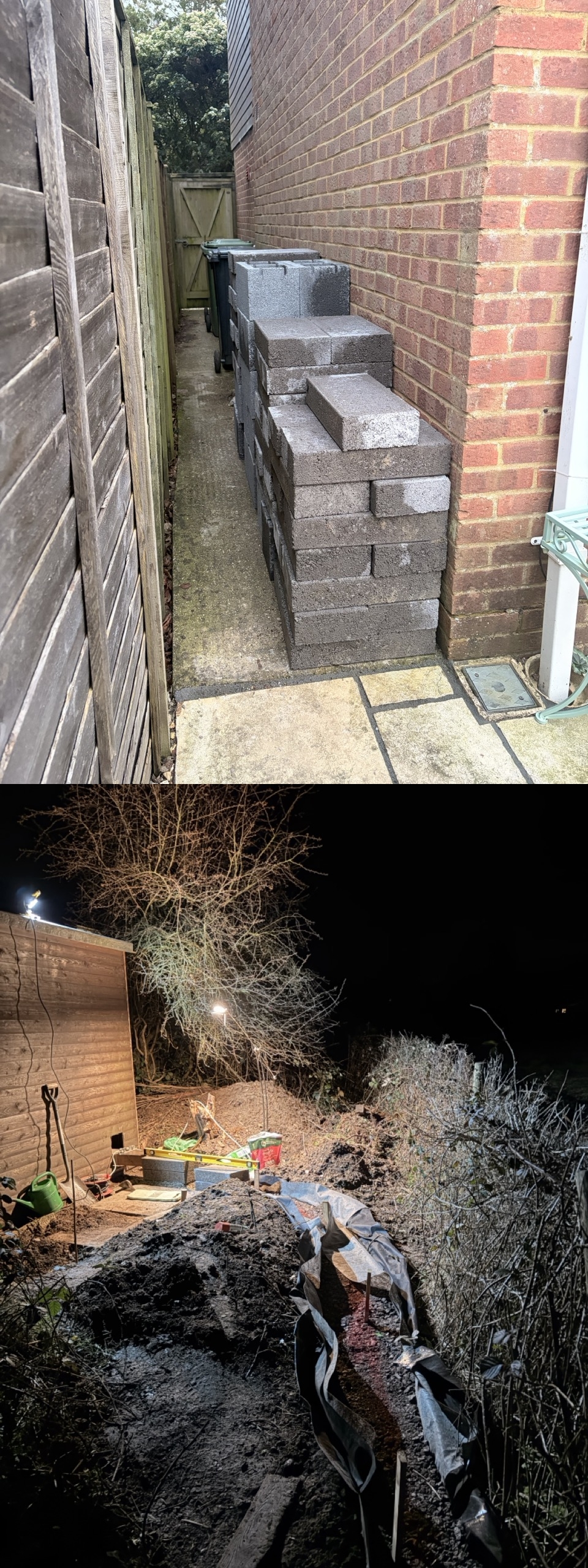

The build continues:
The neighbours must be very confused - more block laying in the dark.
IMG_4007 Large.jpeg (424.01 KiB) Viewed 223 times

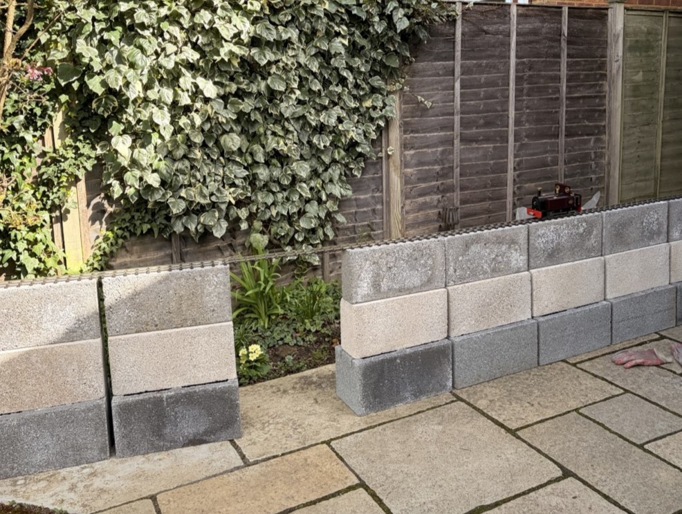

A foundation was laid. 2:2:1 aggregate - sharp sand - concrete
The wall will be constructed with blocks in descending widths to make the base sturdier.
mock up on the patio:
IMG_4250 Large.jpeg (268.86 KiB) Viewed 214 times
Blocks in - I do house extensions at your own risk.
IMG_4275 Large.jpeg (621.47 KiB) Viewed 214 times
