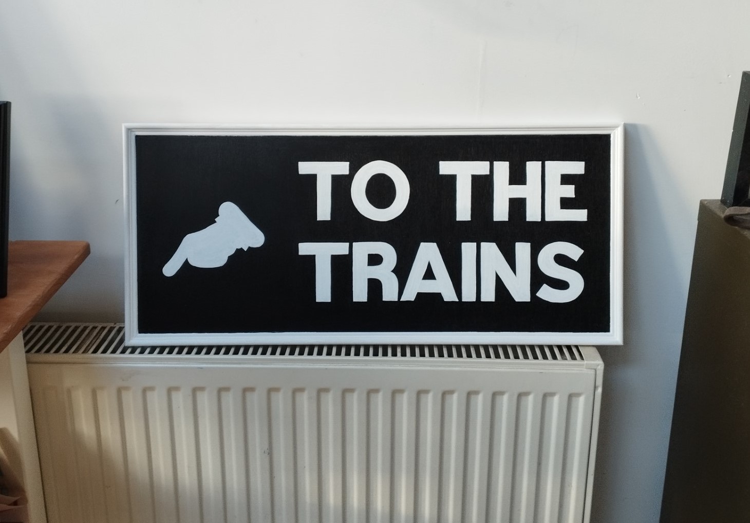

Hi all,
Last November, I went on Joby Carter's excellent week-long signwriting course and, since then, I've knocked up a handful of signs, with more on the way. Naturally, some have a railway theme - here's my latest example:
It's a tricky art to master, and with a san-serif font and no shading etc, there's nowhere for mistakes to hide! Nonetheless, I'm pleased with how it turned out...
I plan to put it up outside, and wonder whether anyone could off any advice on varnish? There seem to be two, opposing, schools of thought - either that varnish helps protect the sign, or that it doesn't, because the weather gets underneath and causes it to deteriorate faster. Any thoughts?
The sign is made of exterior ply and softwood mouldings, treated with Cuprinol wood preserver, and painted with stuff intended for garden use.
I think I might try and do some fancy carriage style lettering next, maybe "FIRST CLASS", although double letters are a challenge, because it's glaringly obvious when they're different, and it's really hard to get "S"s to come out the same!

That's really good, sign writing has always been a skill I have envied, simply because it's something that I have tried and just can not do, well done

That looks excellent, Andrew.
I'll have a word with my signwriter mate in the village to find out how he protects his handiwork.
PS Particular congratulations on the S. I'll bet that letter can be a signwriter's nemesis

Hi AndrewAndrew wrote: Thu Apr 18, 2024 12:46 pm I'd really appreciate it if you could ask your friend, thank you!
Sorry about the delay, but I've not seen him recently and it seems he doesn't check his emails regularly.
His reply ......
Peter was a professional signwriter (and artist) and quite of few of the shop signs in the neighbourhood are his handiwork. They've been there for years so he presumably knows what he's talking about.Hi Rik if he has used good enamel paint it does not need Varnish , the Varnish becomes Brittle after so long and starts to come off
He has made a brilliant job of it. Peter
Re: It's a Sign!
Brilliant, thanks Rik!
Not having a separate workshop, I can't use enamel paints, on account of the need to avoid filling the house with white spirit fumes. I'm using "Alphakrylik", a water-based substitute, but it's supposed to have the same qualities as enamel in terms of coverage and durability, so I'm going to go varnish-less and see what happens. The downside of acrylic is that it doesn't replicate the glorious gloss sheen on enamel - which is where varnish could help. Not much of a problem on this utilitarian sign, but it would notice on something flashier...
I'm very grateful for your friend's kind words about my efforts too - that means a lot!

Beautiful work! It's not easy to do, but very rewarding.
I'll admit to cheating by making my designs in the computer, then tracing it out. Drawing it by hand isn't something I can do too well on 16mm scale shopfronts. Haven't yet tried it on something larger..
Looking forward to seeing more.

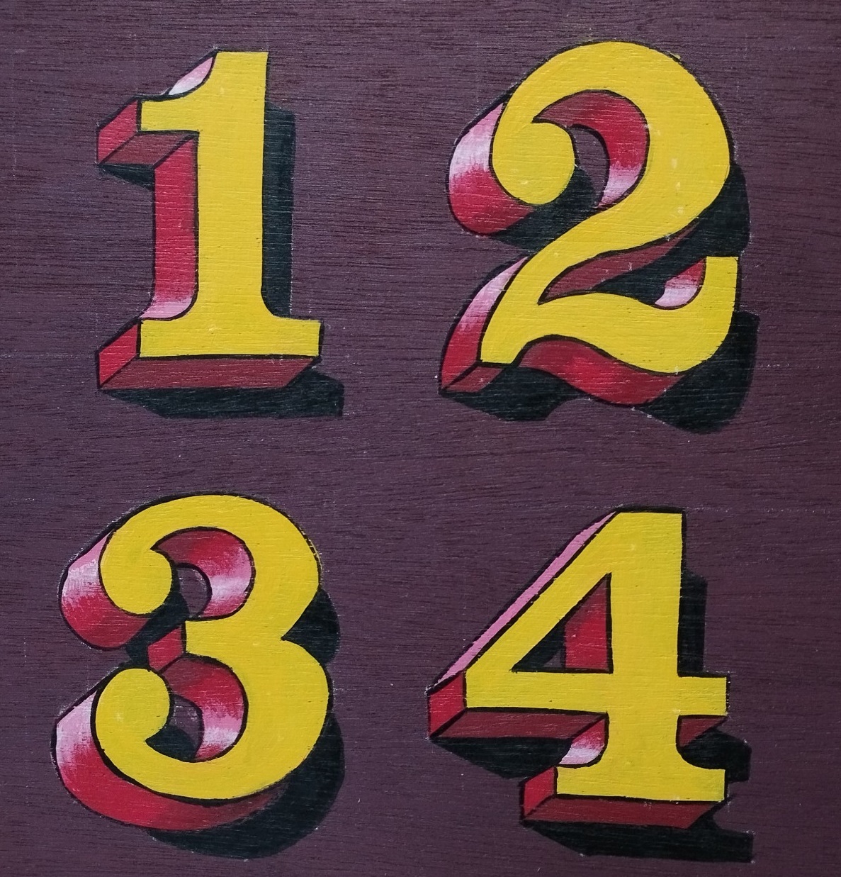

I'm planning to some numerals next - I haven't done any before, I've got some friends requesting house numbers, and the Clarendon font is calling me! I'm going to try to do a Victorian railway style, with golden yellow numbers on maroon, with a red "block" shadow and a black cast one - I'll post the results here if they're presentable!

Hi all,
I think I mentioned that I fancied painting some more railway-style signs? These are based on carriage and locomotive numbers, and were a test run on some scrap wood, with the idea that I'd use this style for some friend's door numbers. I think they're actually a bit ornate for that, but I might do some bigger ones (say 12", these are about 4"), just for the fun of it. I learned lots from doing these that I can incorporate into future ones.
Hope you like 'em!
