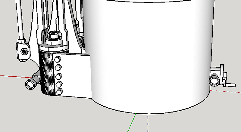

Sketchup drawing

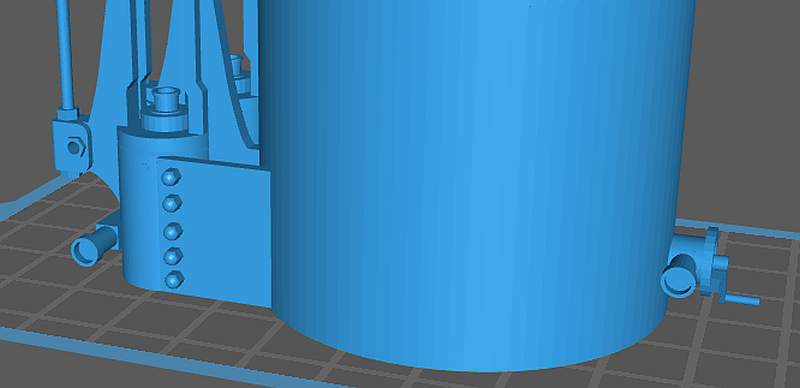

Chitubox slicer
Screenshot 2022-12-12 17.21.10.png (115.21 KiB) Viewed 87821 times

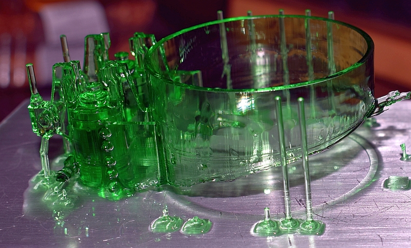

Failed print number 7

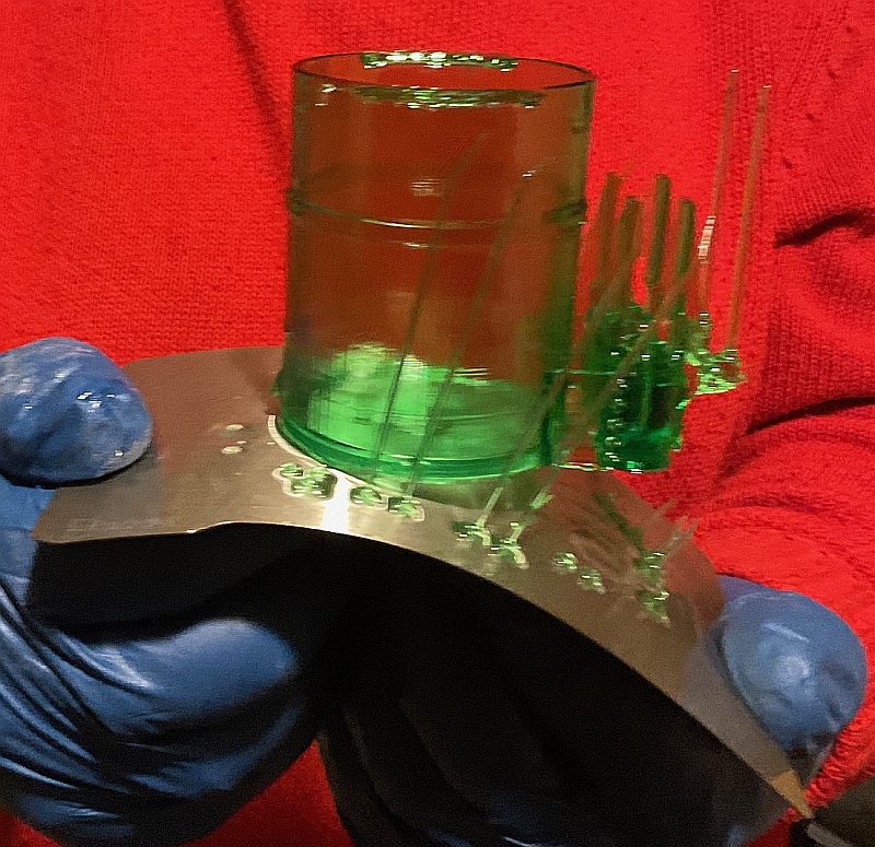

Thought it might be of interest to show a print coming off the flexible plate. I have literally just flexed the plate and swmbo managed to grab a piccy as I did so.

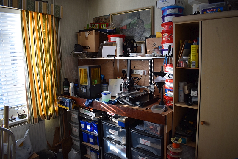

How are you getting on with resin printing in the temperatures we are experiencing? You must have it set up in a comfortably warm area!
Re: Print splitting
Posted: Fri Dec 16, 2022 11:01 am
I have both printers set up in the small spare bedroom that I use as a workshop and general dumping ground. Atm, the radiator in there is off, but the door is open so it gets some warmth from general heating in the house, although that is also turned down significantly!
