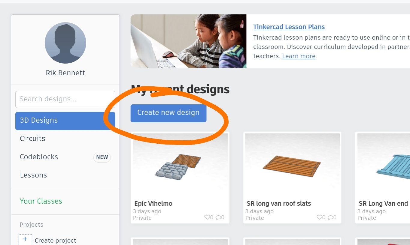

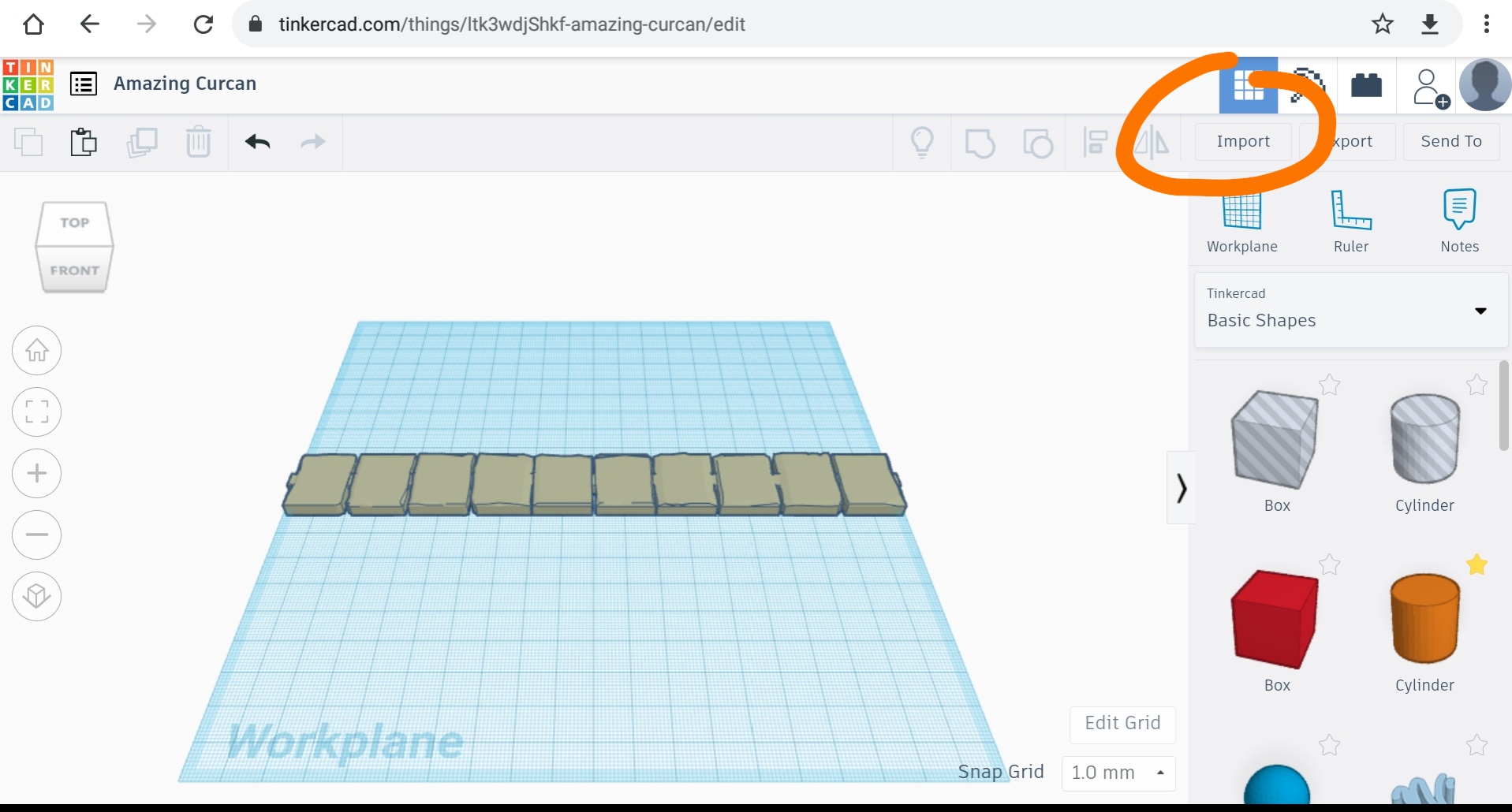

Hi Rod
Start a new design ......
...... and then click the import button. Find the .STL file you downloaded from the forum and open it.

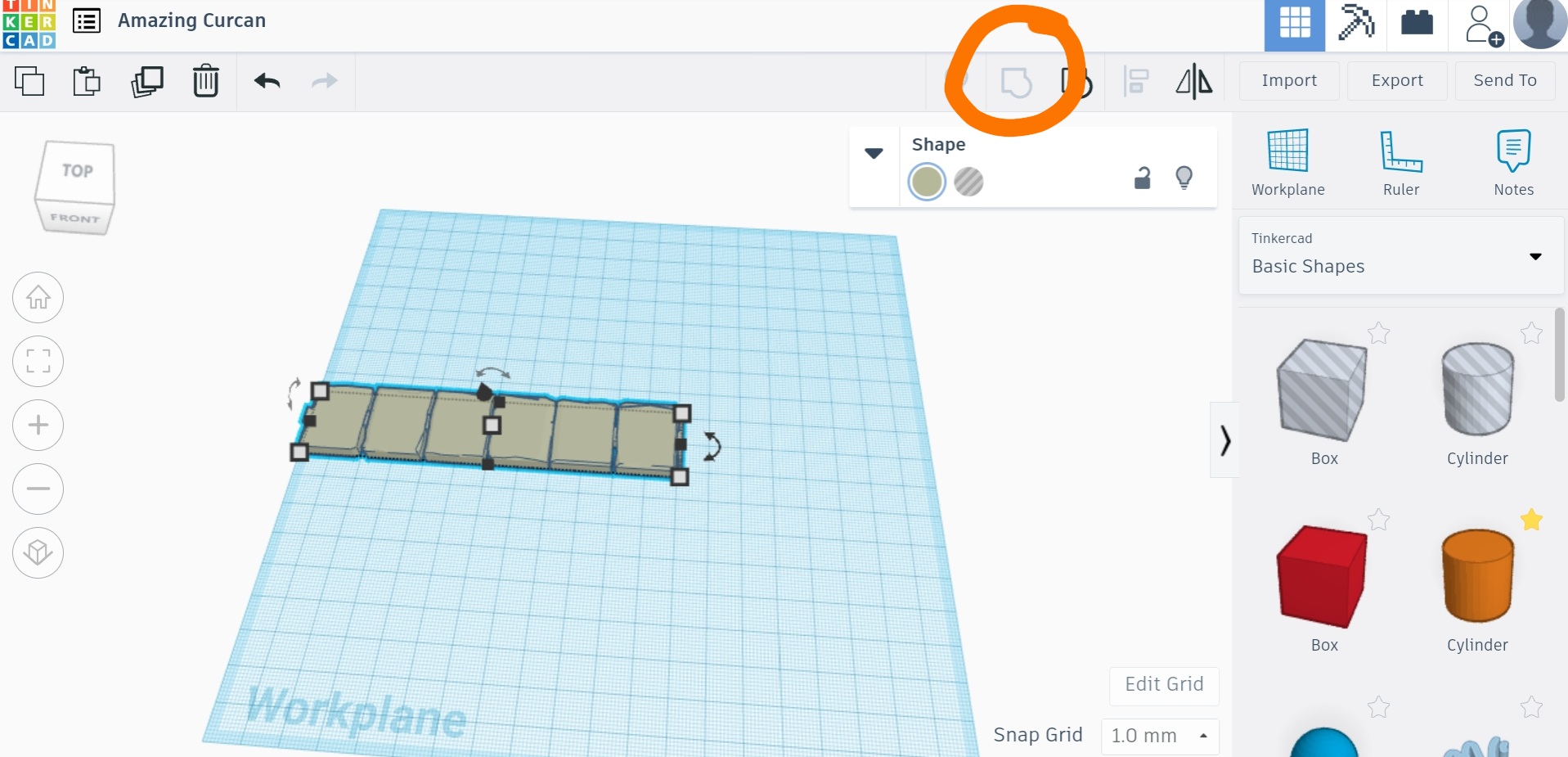

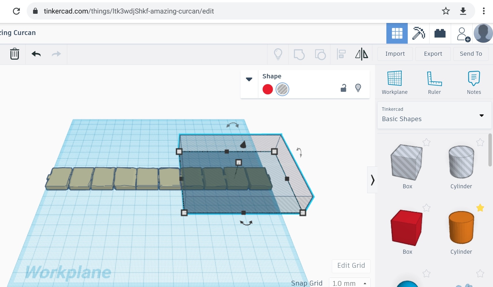

Place a Box shaped hole over one end of the part you want to chop and then resize it to cover as much as you want to chop off. Then select both the hole and the part (either by dragging the dotty box or by shift-clicking).
Then click the Group button to combine the hole with the part.

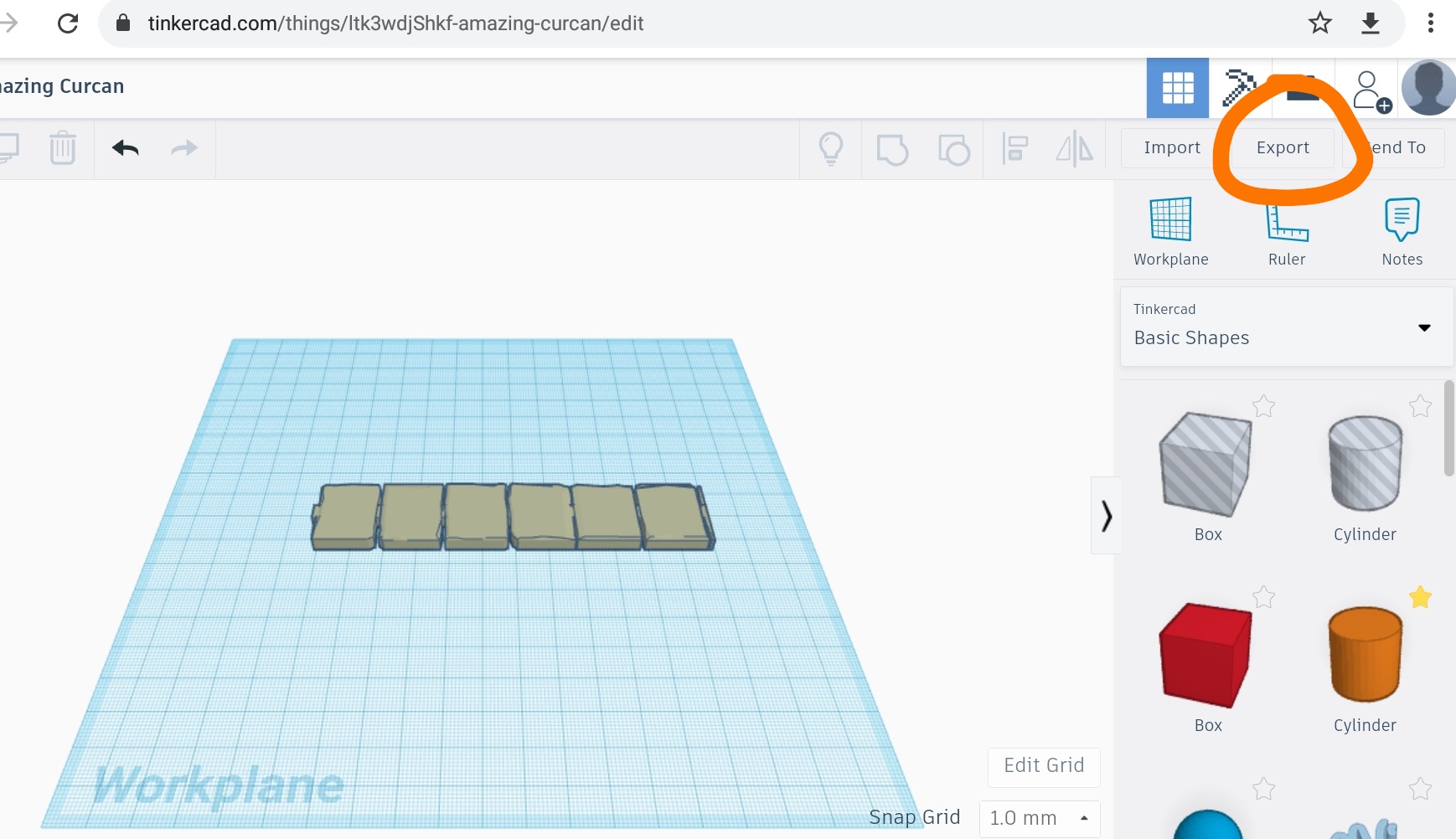

Finally, click the Export button to save your trimmed part.
